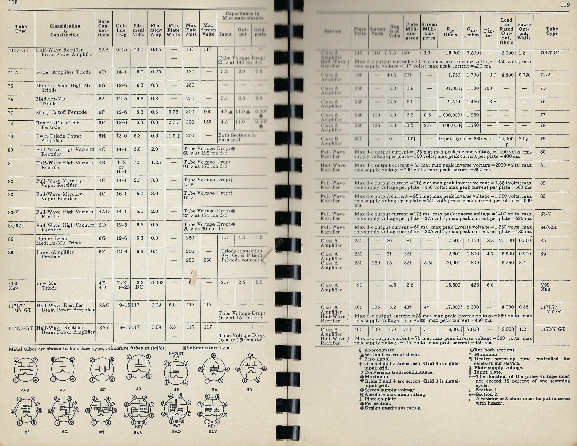

Blitz,
That's interesting. Here is a look at some of the specs for 80 series rectifiers. Check out the voltage drops between the tubes.
Now I know why they were putting mercury in them to keep the voltage drop at 15 Volts versus 60V or 91V for non mercury rectifiers.
Some other tube specs say you can mount the mercury vapor tubes in different ways; e.g., my B&K700 tube tester has it mounted horizontally to keep the case thickness smaller. It is also lined with asbestos cloth to keep it flame retardant.
Blitz pg 75, right column, 1st para. describes Fig 60 as having three rectifiers tubes and delivers three current pulses per cycle.
I wonder how that stacks up against one of them there
high-fa-LOOT-en ZTX/MUR/HEXFRED diode thing-ies?
Cit: General Electric. (date unknown). Tubes, Essential Characteristics: Receiving tubes, Television Picture tubes, Special-purpose tubes. General Electric, Electronic Components Division, Schenectady 5, New York, U.S.A.

Thanks Rick,
and 120 degree phase difference too.
Question: With UF and Freds etc., wasn't too clear, with each switch on/off being a small step of the 60 Hz AC wave. there would be very very small increments that increase or decrease according to the phase angle as opposed to a rectifier having one long pulse per 360 pulse?
Wondering how many for the Freds. Now that I think about it, it's in their data sheet and is the 1/time, i.e., frequency.
