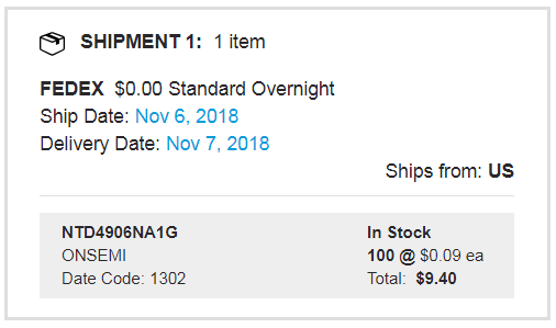

1) The spec'd output device(s) really needs to be a MOSFET. Otherwise the result will disappoint. Remember you're hitting a 'hard' circuit, forcefully, with a 'hammer'. A bipolar device cannot turn on as fast or hard -- single-digit-milliOhms -- and requires a completely different drive circuit.
[t]Arrow.com still has 41k of NTD4906's, at prices so cheap you'd have to buy 25 ($3.70) or 100 ($9.40) of them just so the shipping/handling charges don't swamp the component cost! You could have them in ~5 days, and sell the extras to your friends -- our other members! DigiKey.com and Mouser.com have fitting subs, as well.
2) Whatever you decide to use for output(s)(the 'hammer'), dig out a PNP for the driver. 555 timers provide 4 to 5 times higher current Sinking than Sourcing, and you need to multiply that by PNP current gain to have any reasonable chance of turning on ANYthing hard enough. An emitter-follower NPN (such as the venerable 2N2222) simply won't do it.
Maybe it's my ego showing but, I suggest that you just surrender to the 4 or 5 day wait for the right part, and you'll be a lot happier with the result. Plus, you won't have to spend a few hours redesigning the drive circuit!

I noticed a pretty good deal at electronics distributor arrow.com just now. They are selling the Thru Hole Quasimodo ("V4") power MOSFET for a very low price: USD $0.0094 each, in quantity 100. So I bought 100 pieces and got free shipping too!
Take advantage of this while you can. They only have forty thousand pieces in stock.

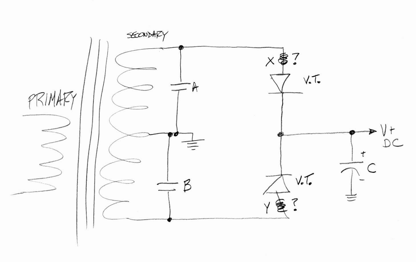

Mark, May I ask you for your thoughts on the following:
When you use mercury tube rectifier (which can sound extremely nice), you can find in the old data sheets the advise to have
- a cap from sec.winding / anode to CT in the magnitude of 1n to 10n
- and / or a choke between secondary and anode of the rectifier in the magnitude of 1mH or more (see https://frank.pocnet.net/sheets/021/8/82.pdf)
The 10nF is part of your standard snubber setup...but what about a 1mH choke ? Put it on the secondary and fine tune the snubber including the choke I would guess, no ?
Blitz- it is worth noting that Mercury Vapor recruiters emit very, very high amounts of UV. Enough that you may want to consider if you want them where you are exposed to the glow.
If its a lot of UV, I guess it would be good for disinfection duties. Just as long as the rectifier doesn't break when operating.Blitz- it is worth noting that Mercury Vapor recruiters emit very, very high amounts of UV. Enough that you may want to consider if you want them where you are exposed to the glow.
