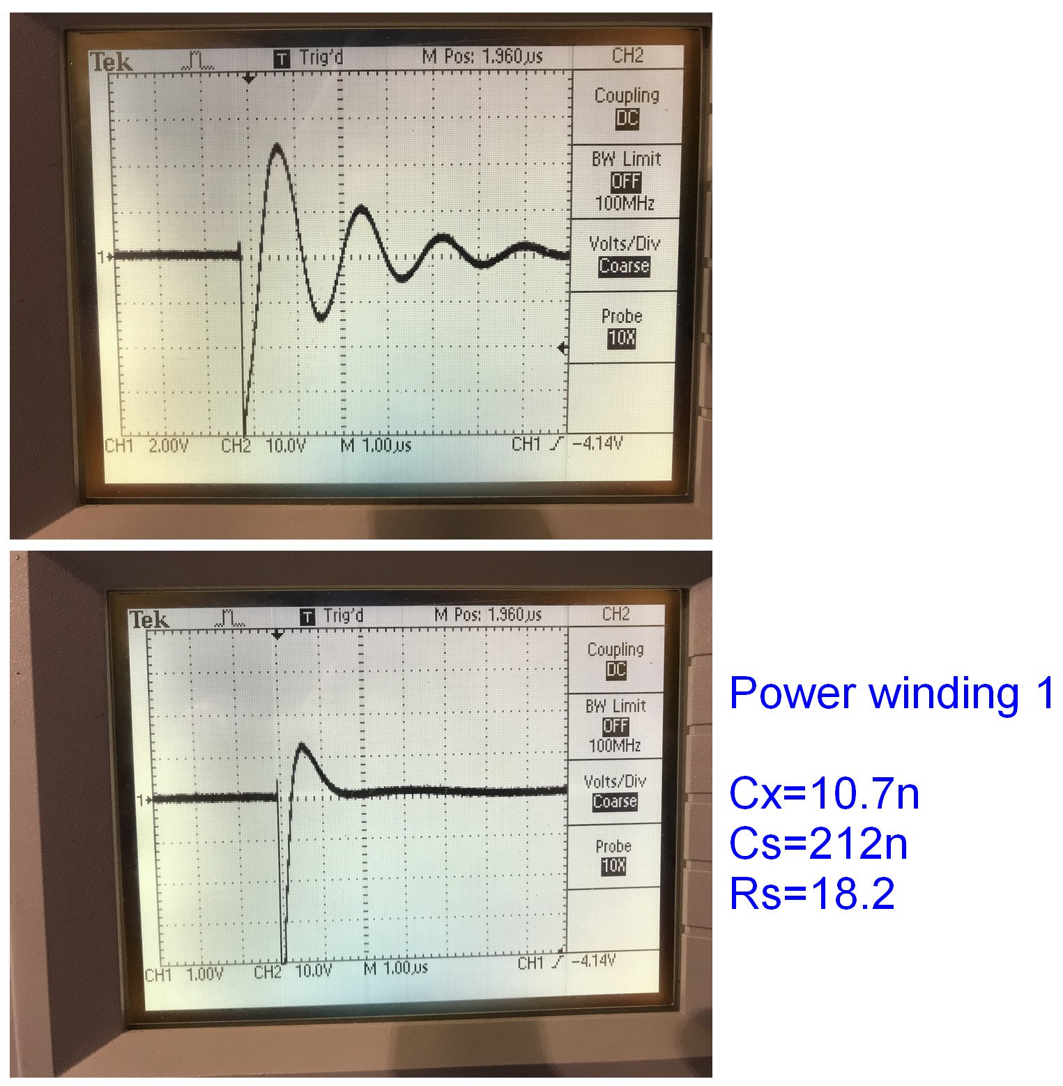

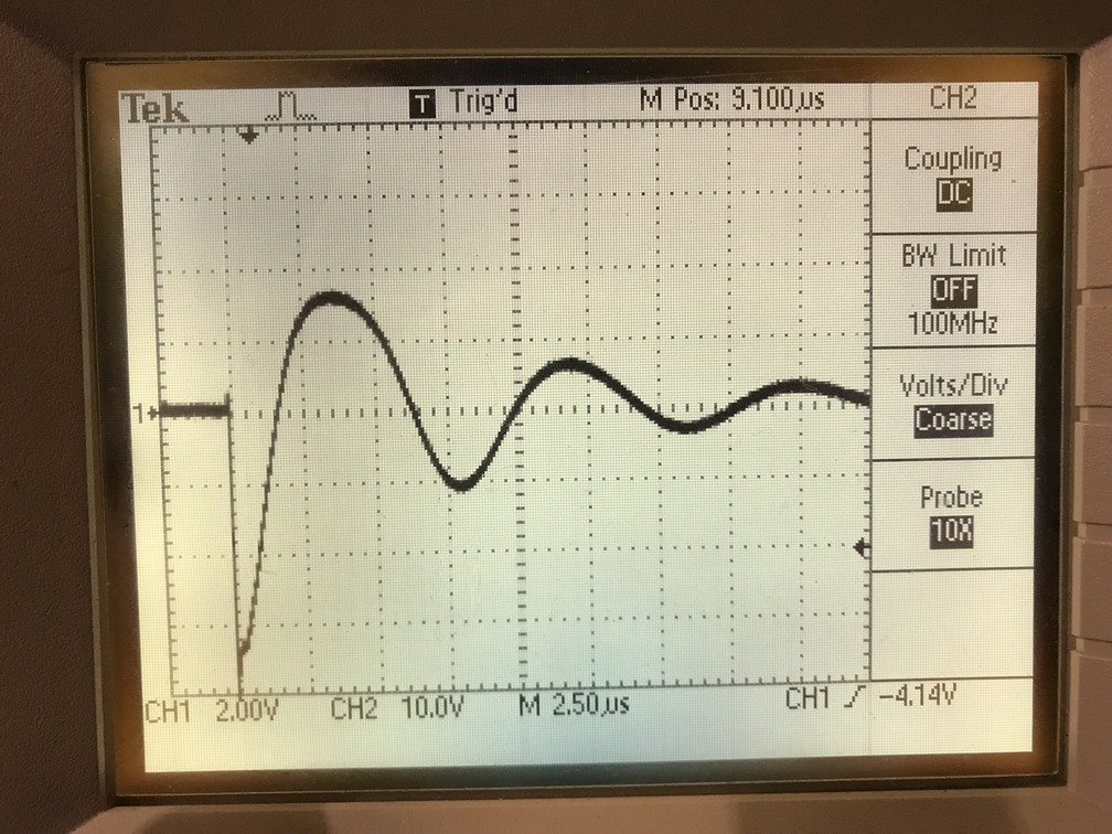

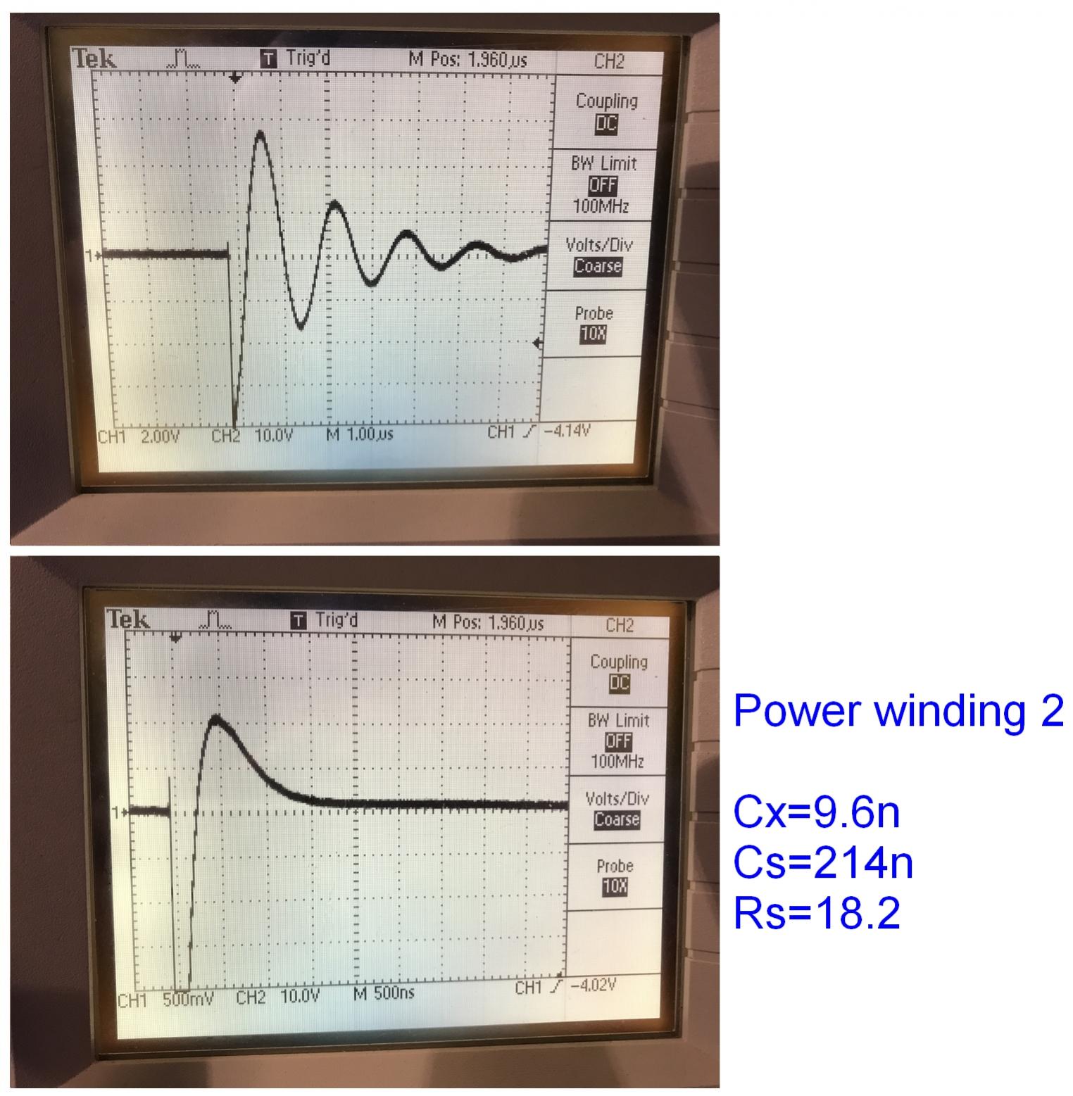

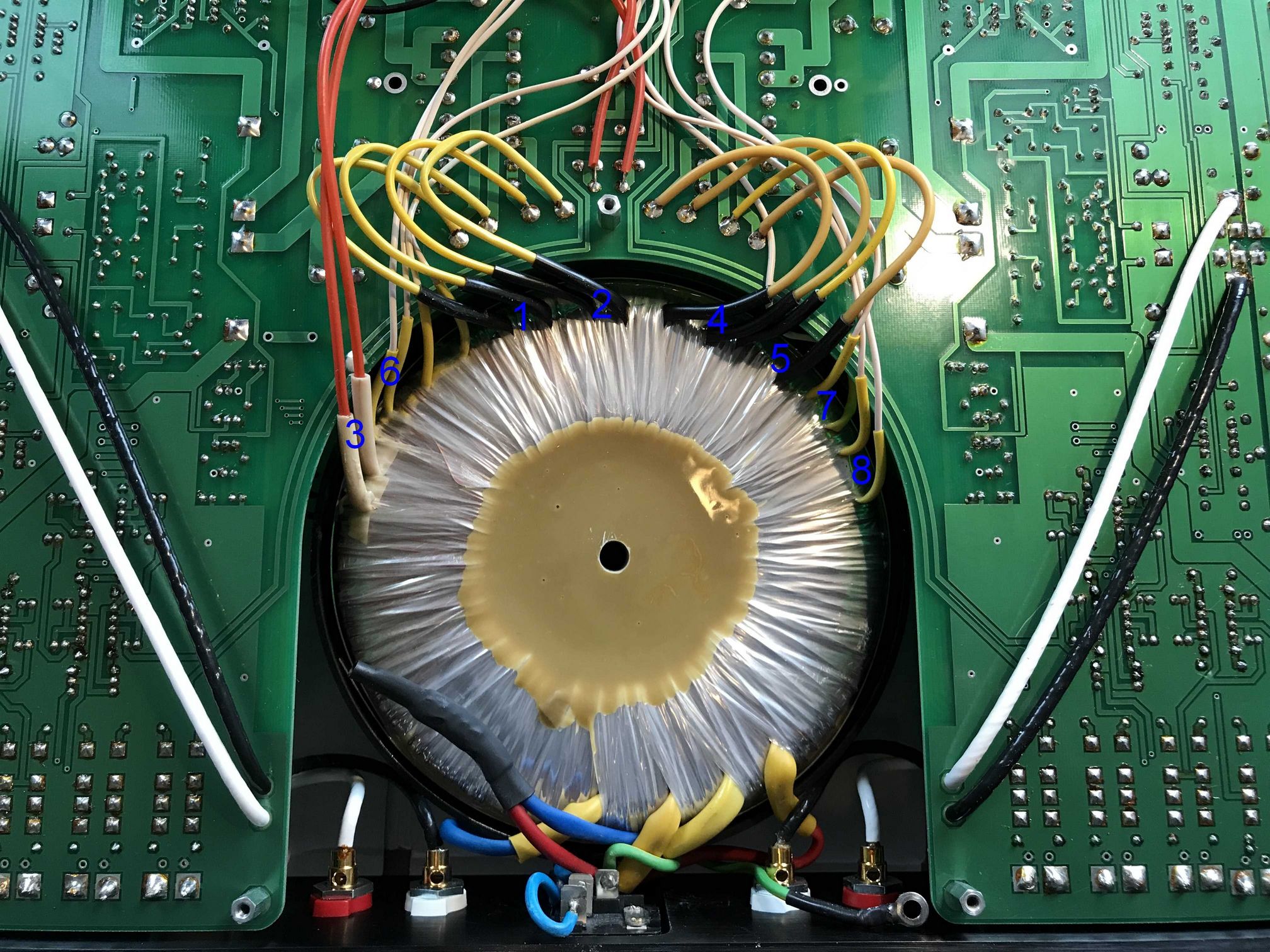

Finally got to use my Quasimodo;
First I needed to repair it, as I found out it doesn't like 20V supply voltage
Seems the gate driver went faulty, drawing lots of current all of a sudden 🙂
After replacing the gate driver, I settled on a save 10V

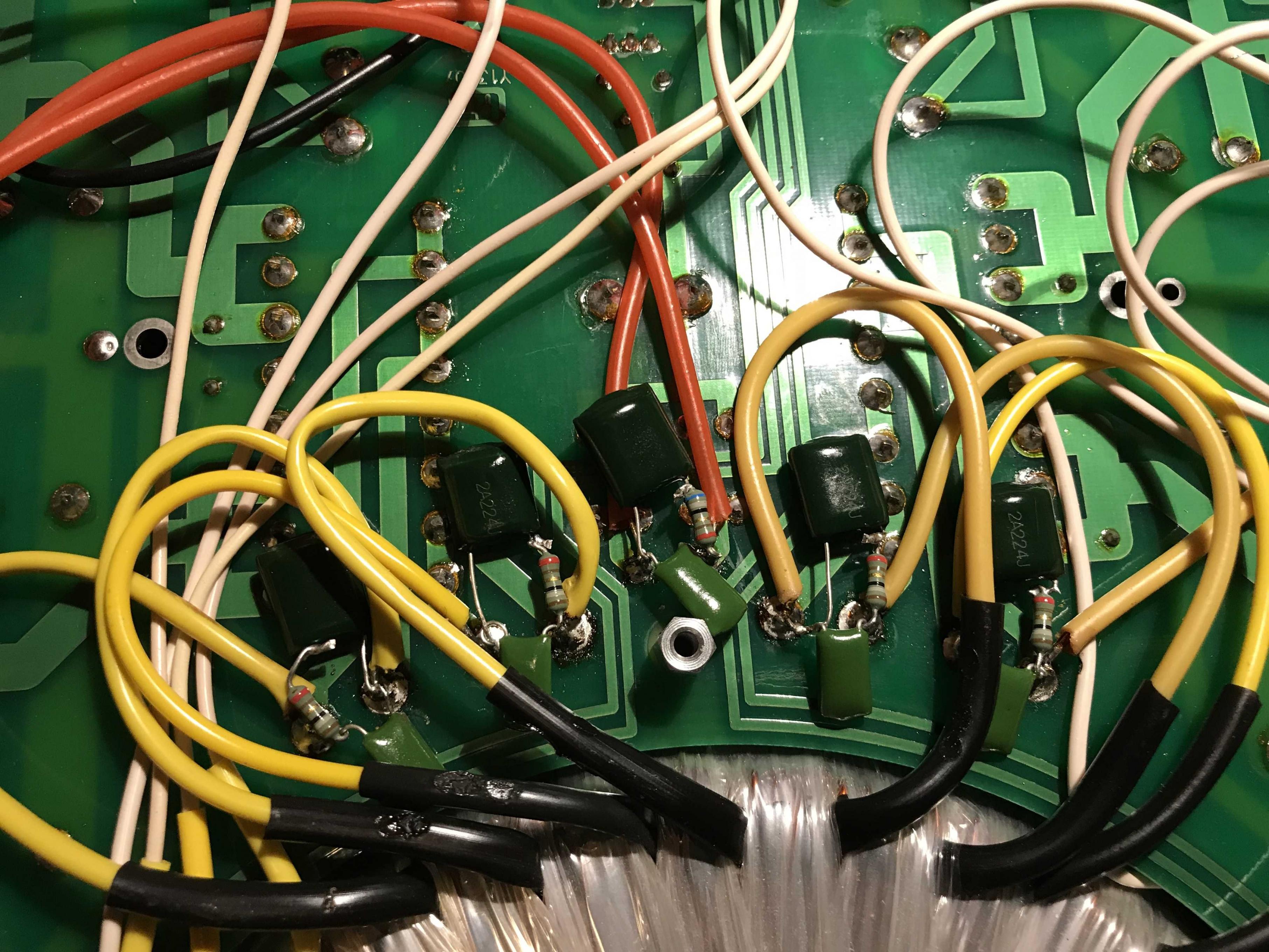

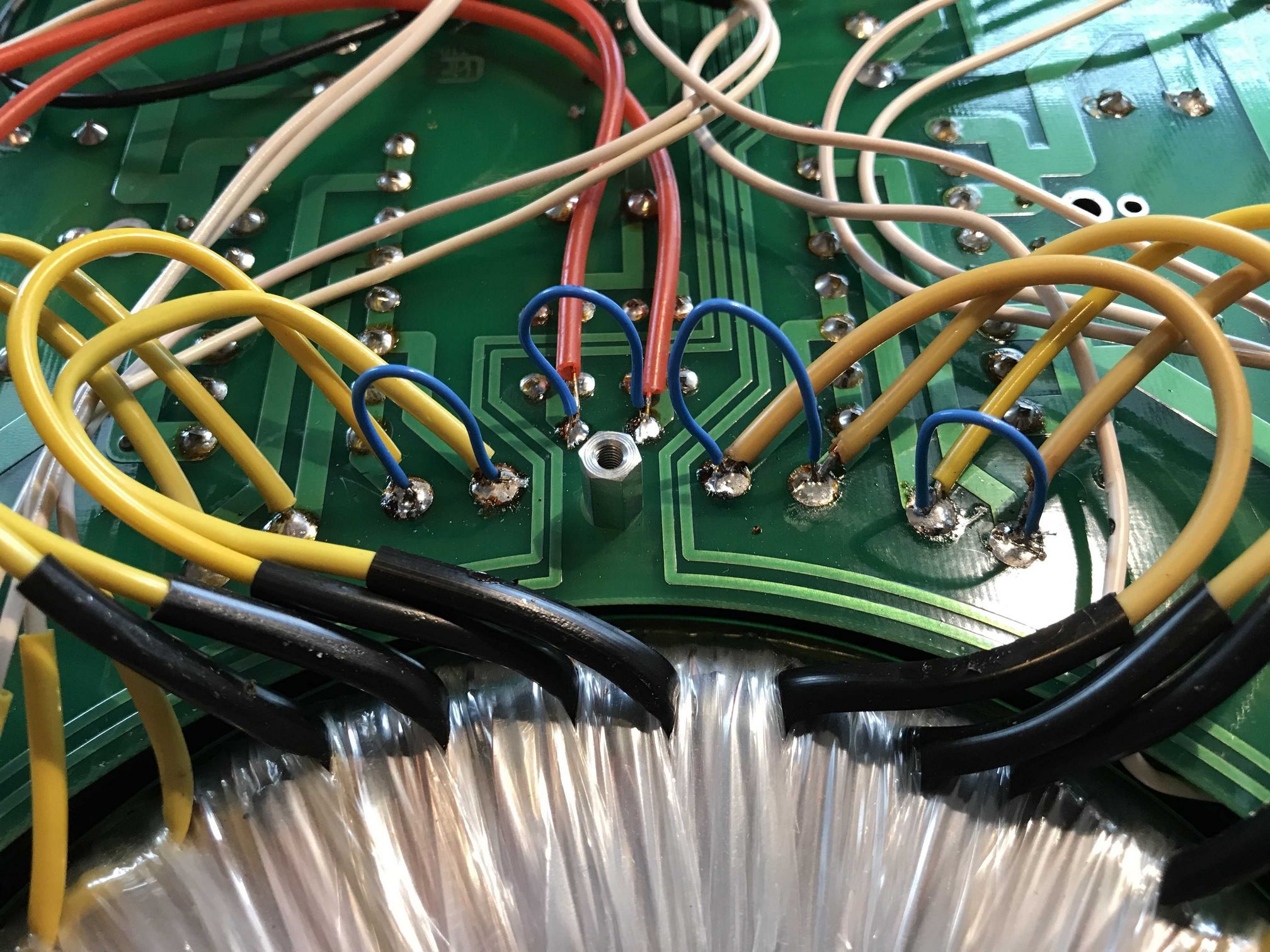

Bit hard, as the transformer is actually in an integrated amplifier, and has 8 separate windings (actually 9, more later), 4 for the power stage, and 4 others for other stuff.
Soldered shorts over all windings, except the one being tested, for which I pulled 1 transformer wire each time from the pcb so the winding is effectively isolated.

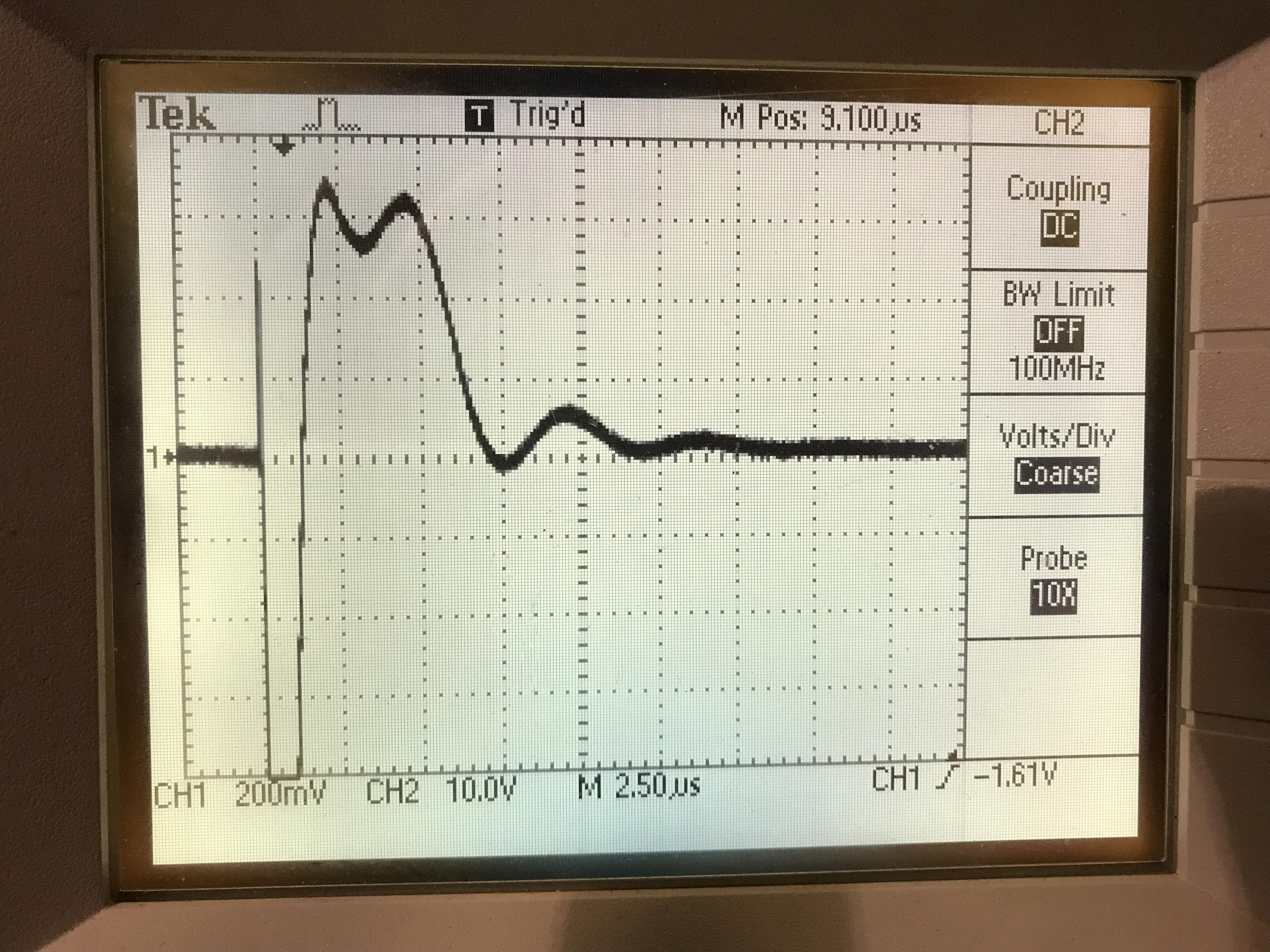

All went fine, except for 1 winding #6, which seemed distorted, but I adjusted it as good as I could.
Results:
Power Winding#1, 10.7n, 212n, 18.2
Power Winding#2, 9.6n, 214n, 18.2
Power Winding#4, 10.6n, 219n, 18.2
Power Winding#5, 10.6n, 221n, 18.2
Winding #3, 10.7n, 239nF, 68.7
Winding #6, 10.6n, 232n, 56.4 (distorted)
Winding #7, 9.6n, 234n, 20.3
Winding #8, 10.8n, 235n, 20.3
Initially I forgot to short the primary winding, but I actually didn't notice any difference with the primary winding shorted or open.
Only when I finished (and soldered in all snubbers), I noticed there was another winding, seemingly unused. Wires isolated in heatshrink, didn't check yet.
I think this may be the reason why I had distorted results on Winding #6.
But now, would I have to start all over ?
For QM testing, instead of the short on other windings, would having the snubbers in place suffice ?

Having the snubbers in place on all windings except the test winding, and shorting the primary, is imho the better test scenario, as that is what you will have in normal operation.
Obviously as a cross-check, you could also short all those windings again and see what you would have nominally come up with.
I'd anticipate the checking to show little practical change. If there was a substantial practical change then that indicates how much of an expediancy compromise is occurring with the default procedure (shorting all secondary windings other than test winding).
PS. Is that a primary winding wire nearly touching a speaker wire?

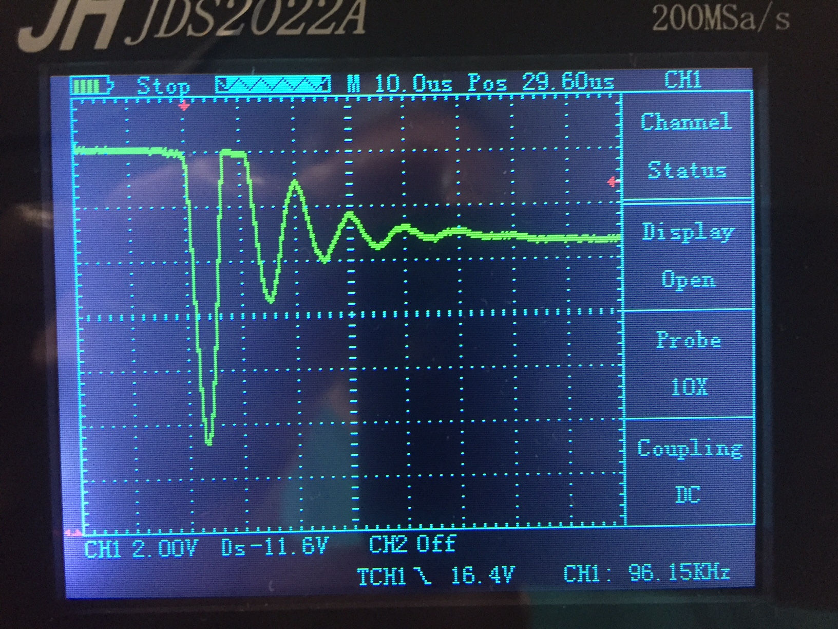

I found that the battery powered "JDS2022A" handheld oscilloscope ($144 at Banggood), gave satisfactory performance when measuring snubbers.
