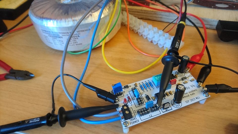

It's a new day in Q-Modo- Land, with fun and games on the ARC SP3-A1. 🙂
What you must might beable to see in post# 1439, pic#5 if you look closely at the outlet wiring between brown #2, and green #3, you will see a tacked on piece of wire that shorts the primary 120V AC line.
Now that I tried the easy way out...(and exhausted those possibilities) I'm grateful that MJ stopped by and made a few suggestions.
Aggie Sync finally got smart and removed ALL three secondaries. It didn't kill me either. I should have done it with the first post of the ARC SP3-A1.

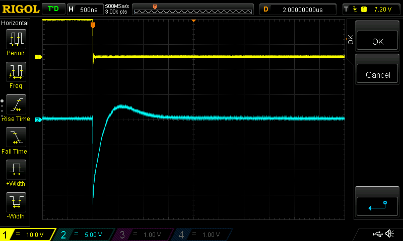

There are still questions that I have regarding the oscillations after the bell toles. The part I understand is damping the ringing. Do we go to the point of a 90 degree right angle? or to the point where the damping just flattens out.
Unlike MJs images he's shared with us in the modo guide and other threads...there is a point where 1. the damping starts 2. the ringing starts to flatten 3. the flattening continues 4. the ringing gets lumpy 5. the ringing gets more distortion-y?
6. the ringing increases again 7. until it looks like a smoother ring (only 3 to 6 minor mounds).
From what I have gleaned from doing this for too many hours
and 5 pages of lab notes, I believe the target image lies somewhere between 3. and 4. that I just listed.
Target is an almost smooth line, though it may contain small humps but if kept dialing in the Rs...the ringing or lack there of gets lumpy and the ringing starts to increase again.
I don't thing we want lumpy...I think we want nice smooth humps.
Also noted when Rs is dialed too far, it almost looks like we want to add more capacitance to the Q-Modo because it is no longer smooth. at the start of the ring curve. I've got too many pics but I'll try and post a few later that show what I'm describing.

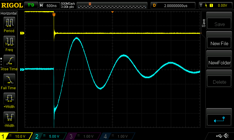

Remove the trimmer (giving Rs = Infinity) and try it on an inductor whose value is known; anything greater than 50 microhenries. You should see a waveform similar to Figure 12 in the Quasimodo design note. If you don't, apologize to your friend for destroying his Quasimodo V3.

I ordered my boards last month, I built Quasimodo 2 weeks ago, this weekend I've finally gotten around to setting up and testing the jig on one of the coils on my transformer. What a neat little project!
With Rs = infinity (i.e. no resistor), my waveform looked like the following:
I wound down the trimpot (it took ages to see any result), and eventually snubbed the ringing like so:
I measured the trimpot: 19.8 ohms! Seems a bit low to me, though the trace is hard to argue with. Should I perhaps try other values for Cs? I've yet to try it at other frequencies; my DIP switches haven't even had the plastic film pulled off. This transformer has another secondary to snub, and I have another identical transformer I'll be using in an impending amplifier build.
