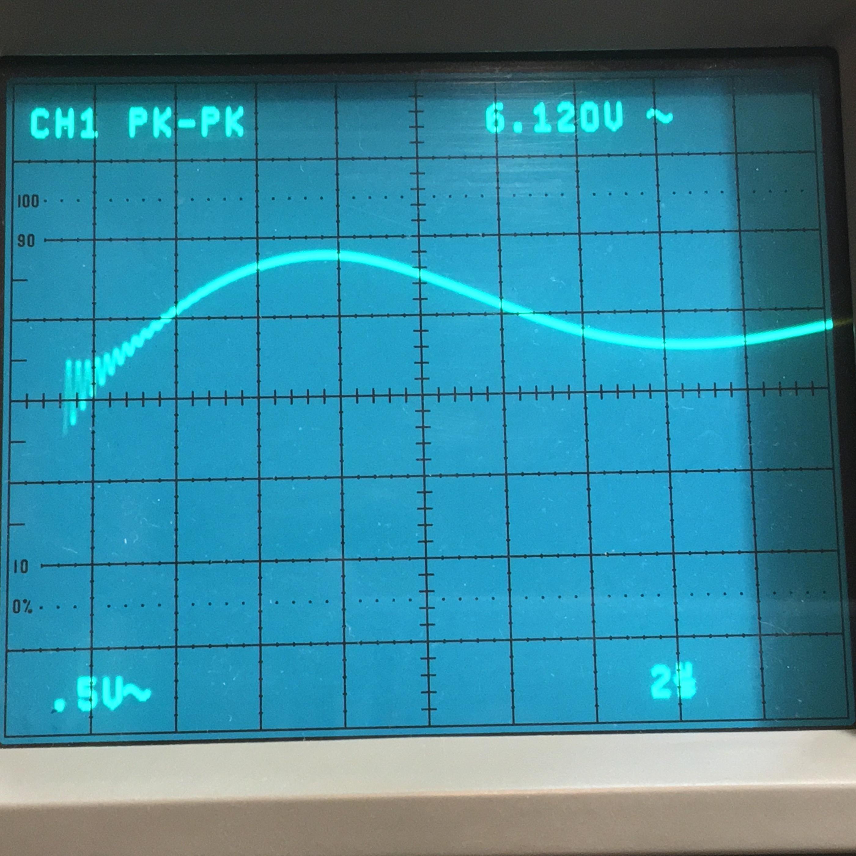

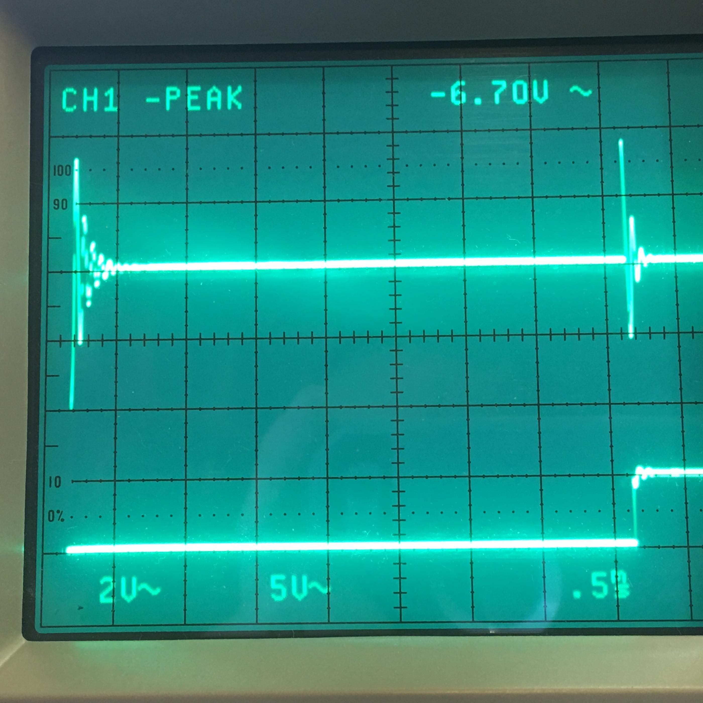

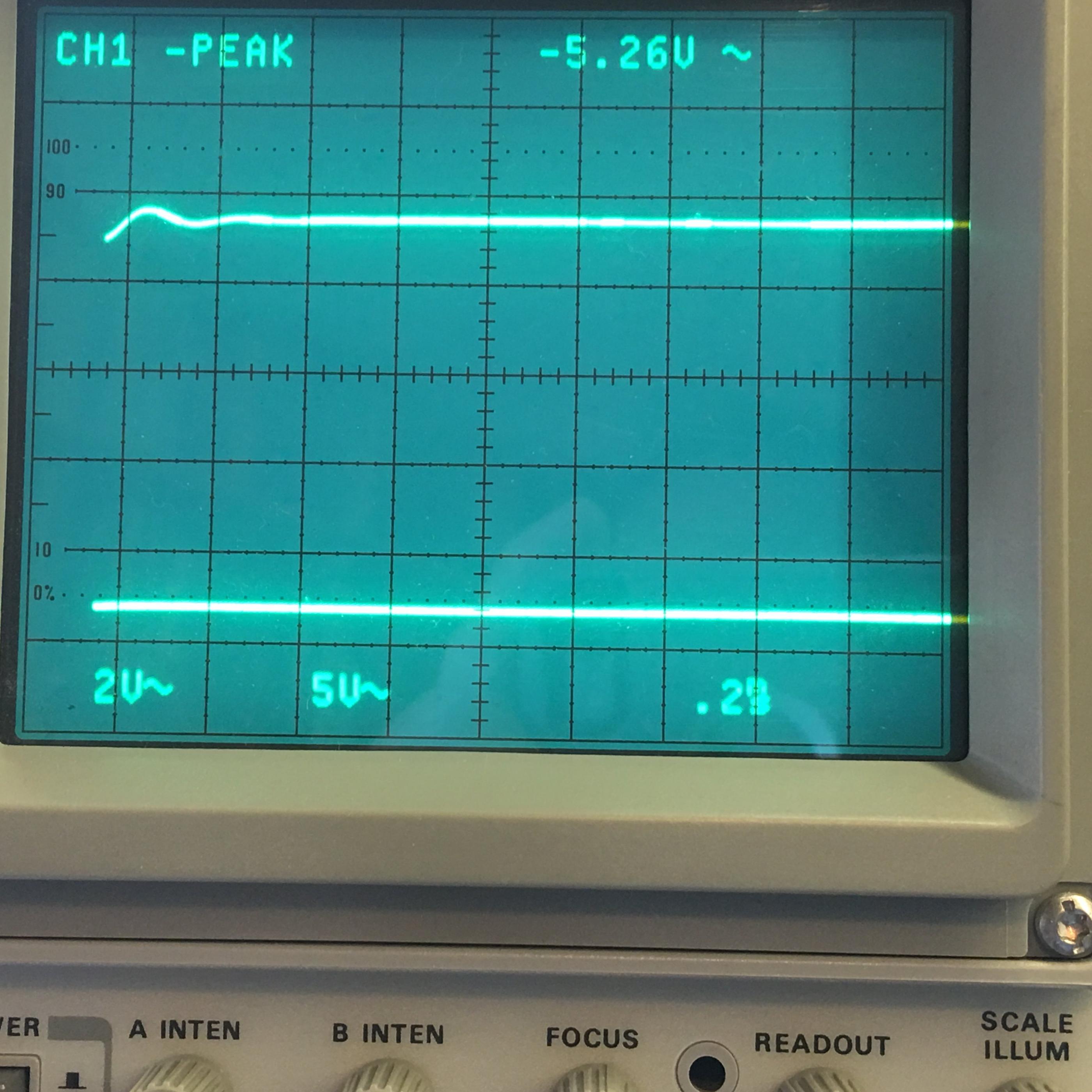

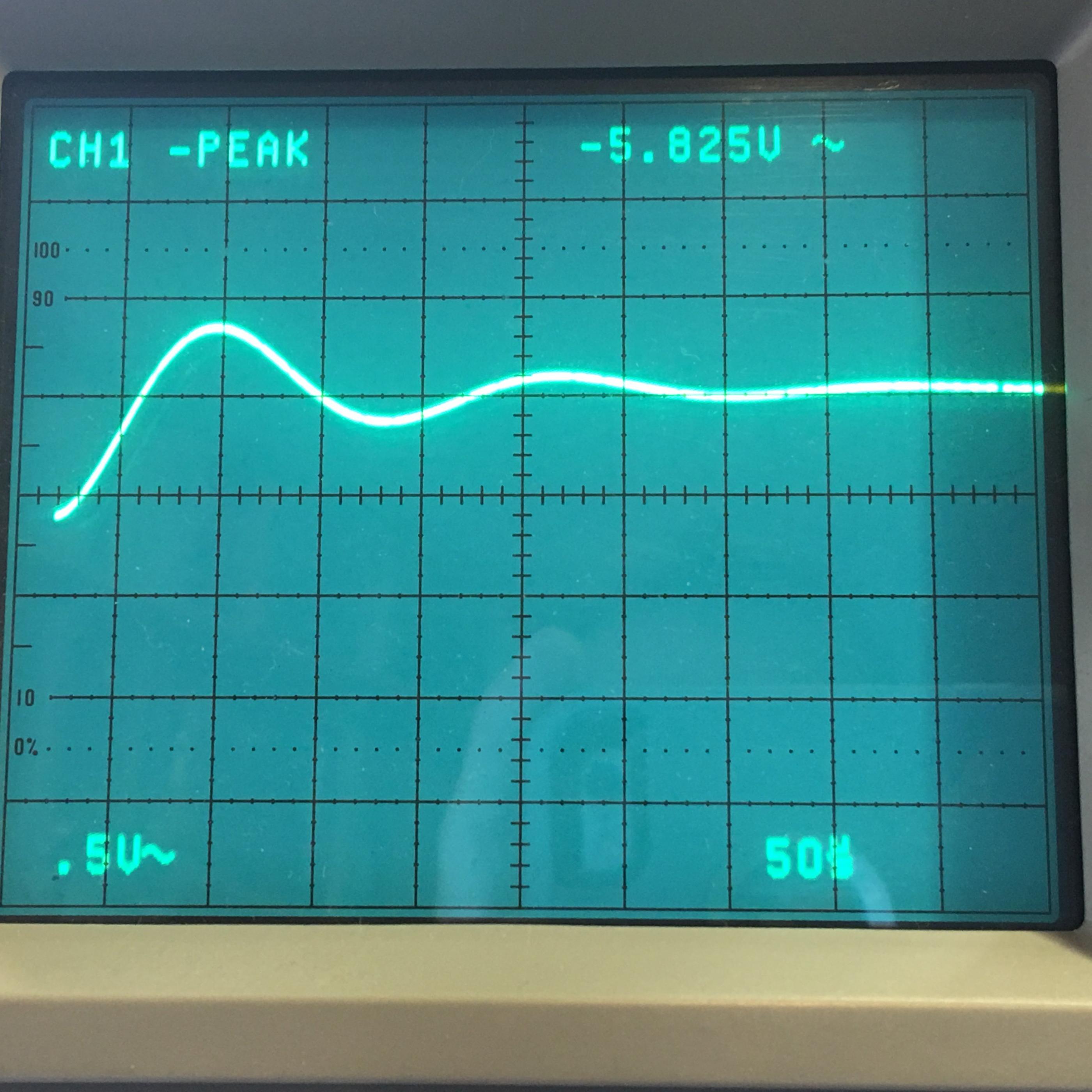

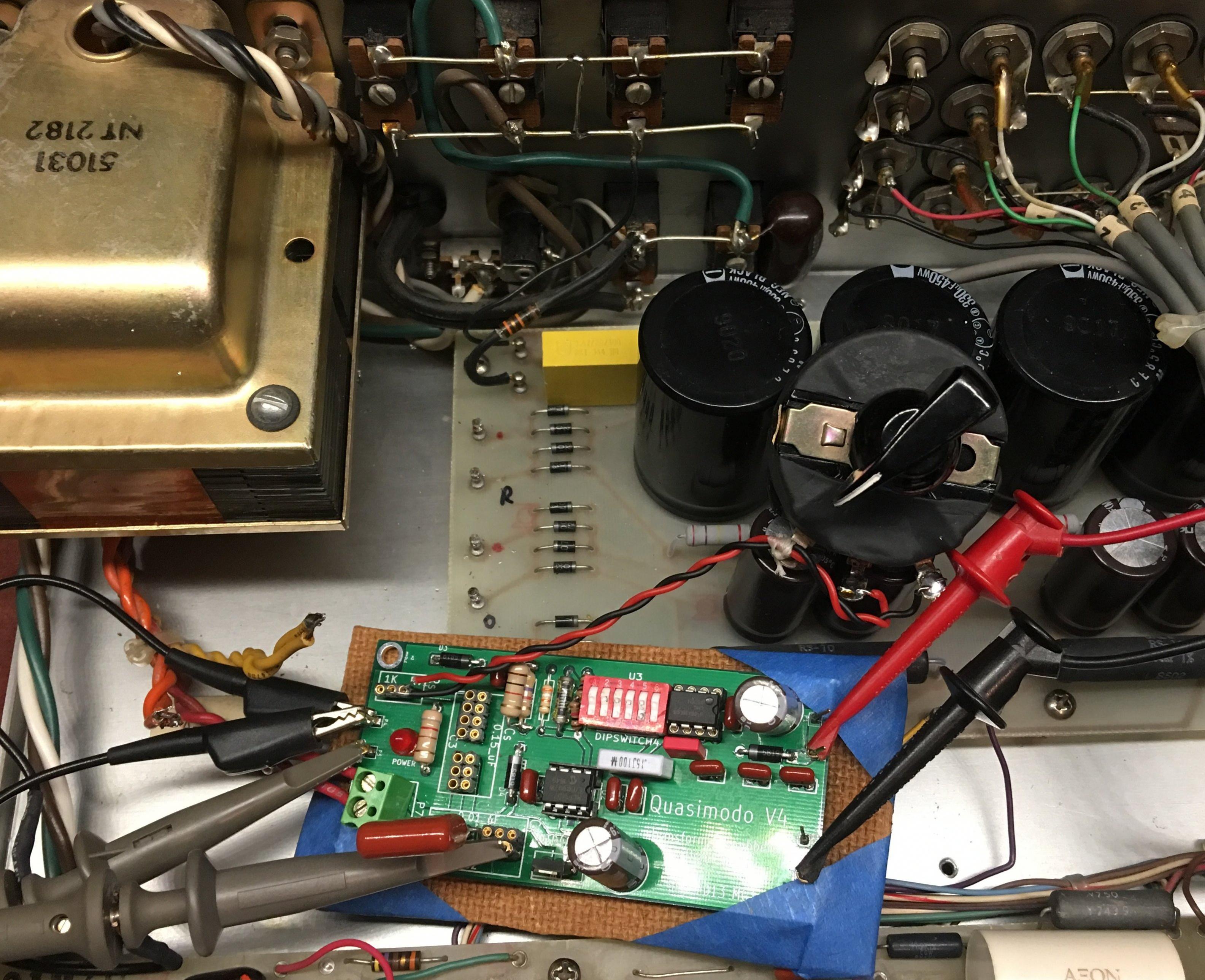

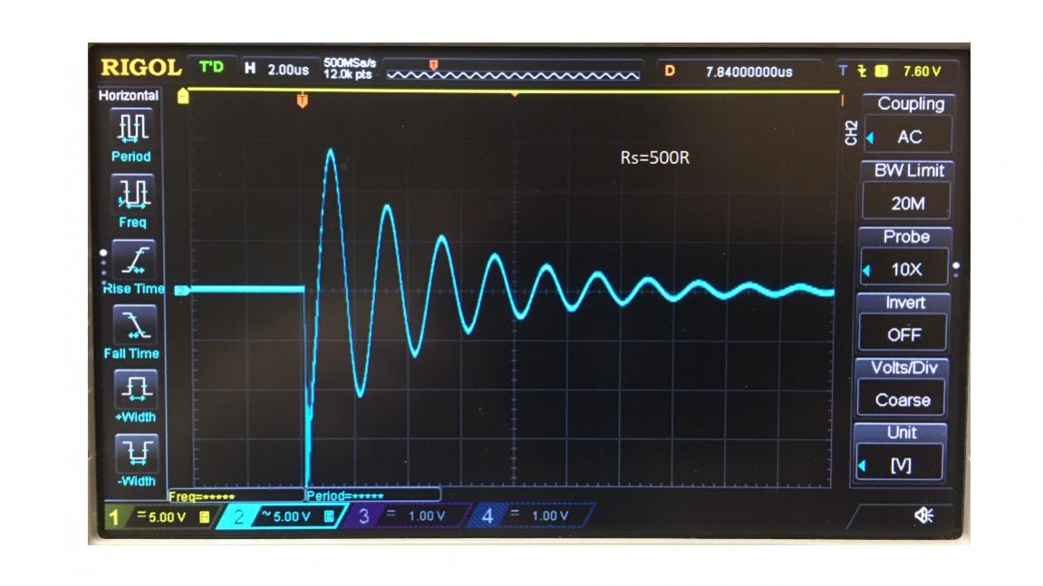

So far I have two results that I have confidence in for the Yellow and the orange pair of secondaries for the SP3-A1 power transformer.
I've reviewed the factry schematics and there is no snub/damp of the secondaries, Red, Orange, Yellow. Red is the B+ at 500V. I'm thinking the Orange and Yellow are for heaters. for the tubes. Orange goes to a few tubes and yellow goes to a few tubes. I'm not a fan of the ARCs schematic either. Pics soon.

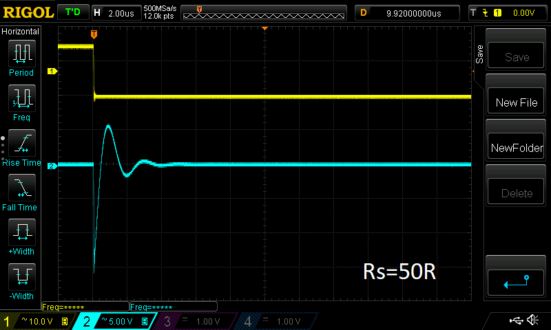

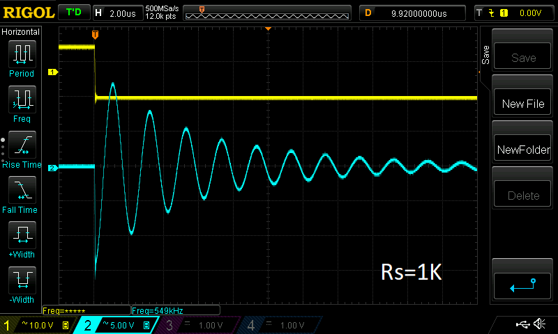

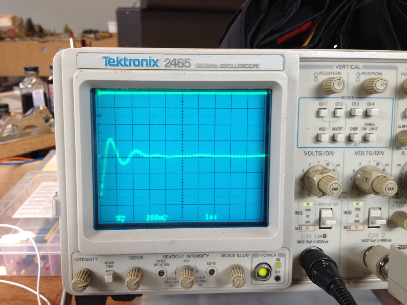

1st pic is the big 500 ohm pot. It just plane works. 2nd pic Oscillation by overdamping? just at the beginning but rather not see it. 3rd pic. Shows a damped ring. Too much or just right perhaps. 4th pic shows a reality check just to see what the sqaure wave look like and the ringing. 5th shows the amout I could damp before the wave becomes junk.
I'm no experpt at this but am learning. If anyone has comments please share.

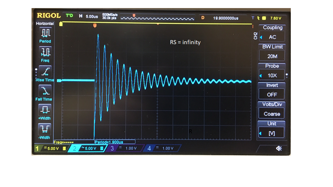

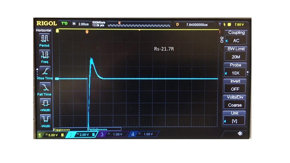

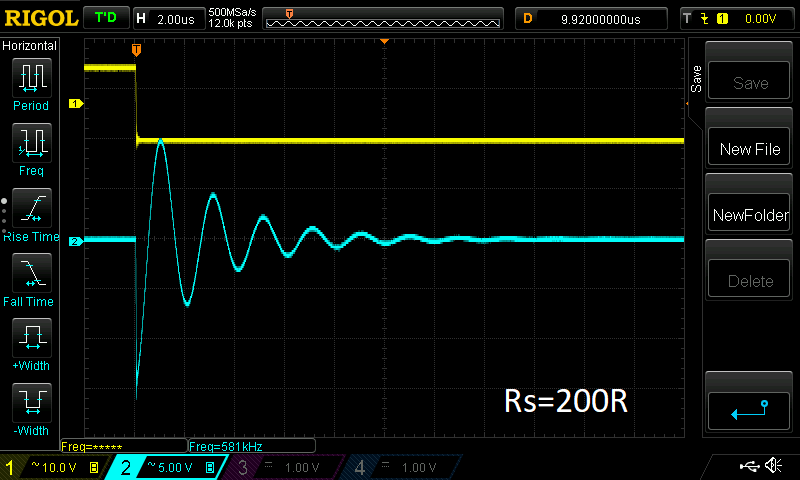

My jig sanity test

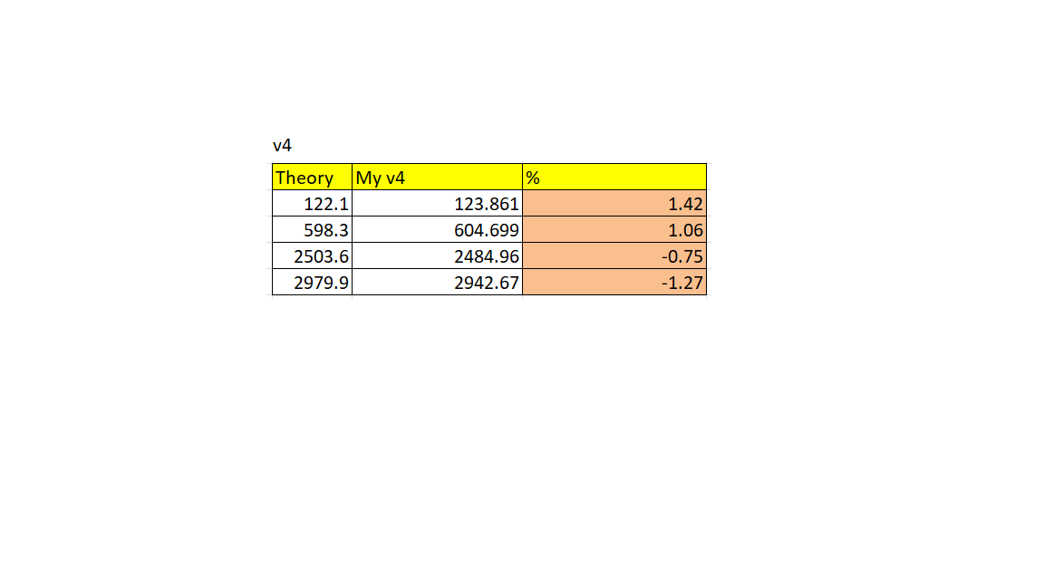

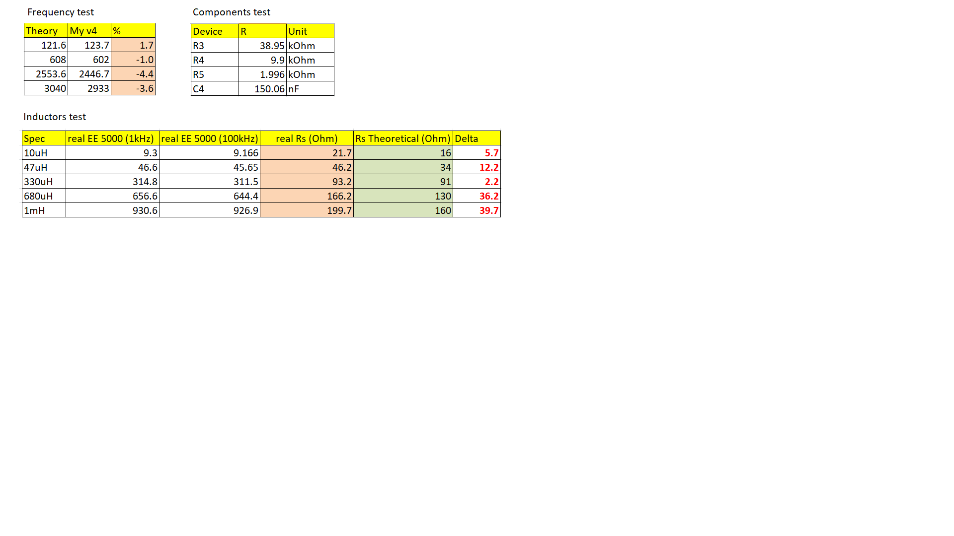

Hi Mark and all,

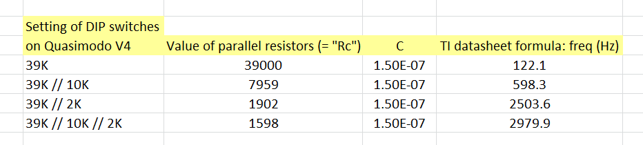

I need your help to analyse my v4 jig test results.
Please see attached table for M1 DRAIN frequency test with different switch positions and I assume that I'm in the ballpark. However, I do see some oscillations and it jumps to about 90Hz during 120Hz set (this flickering is exists in all tested frequencies): YouTube
I checked some key components (also attached results the image) and I tested advised fixed (resistors look-like) inductors. As you see, I'm quite off from your calibration table. I do not think it is related to oscillations. What that difference cause might be? I used v3 jig with no oscillation, but Rs results are very similar.

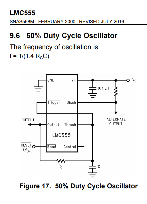

Your first error seems to be that you didn't use the proper equation from the LMC555 datasheet. Quasimodo's oscillator is the 1R, 1C, 50% duty cycle circuit which only works correctly with CMOS implementations of the 555. Fortunately the V4 Bill Of Materials calls for a CMOS 555.
The youtube video of misbehavior is horrifying. I would throw that board away and build another one.

Thank you a lot for reply. Good news that captured in video misbehavior totally stopped when PSU dropped to 17.2VCD and below. It is 17.3 and up to 18 VDC that caused such issue. So, I set PSU to 15VDC and it is very stable now.
I'll remeasure all 4 switch positions with stable behave on Rigol DG4062 counter for precision and compare results to corrected TI datasheet table. Be back tonight.
Hi Alex,
Yep, that sure is a darned interesting 'scope trace (YouTube).
Looks a lot like when a CMOS input is left floating, and being tormented by noise or a leakage path -- probably 50/60 Hz or a harmonic. Whatever the source, it pretty much has to be numerically related to the intended osc frequency to exhibit the 3 distinct periods. Might be a noisy florescent light or an incandescent on a dimmer.
I have no idea why it would behave below 17.3 Vcc, though .. Oh wait -- that would move the threshold on that (presumably floating) input.
If I understand your tables-of-values concerns, as long as they're within 1-1/2 percent or so, it's nothing to worry about. It certainly can't cause the jumpy osc periods. But there IS something to be said for OP's solution, too!

Your 500 ohm pot looks like a vintage wirewound, which might have a minimum value as high as 3 - 5 percent. The 'zeta=1' value you need may be less than 25 ohms, and as big and beautiful as that pot is, it may not go that low.
If your Tek 2246 continues to work as well as mine, it'll still find a lot of problems for you. The 1 M ohm/20 pF is just the input rating; subsequent stages can still be overloaded.

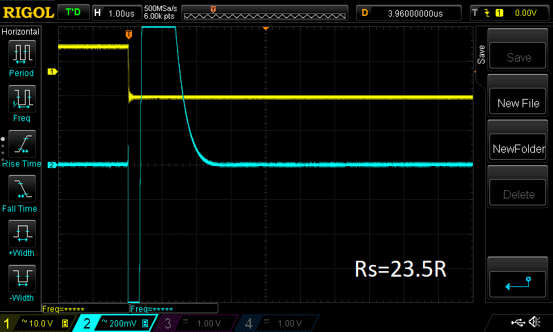

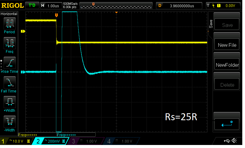

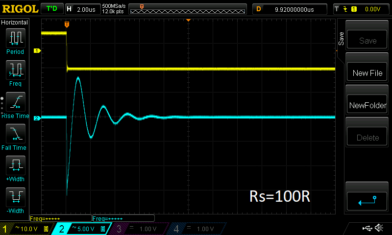

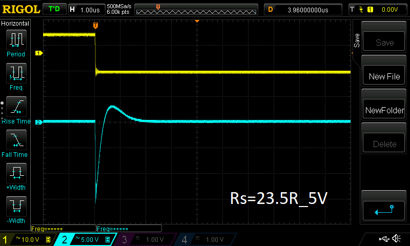

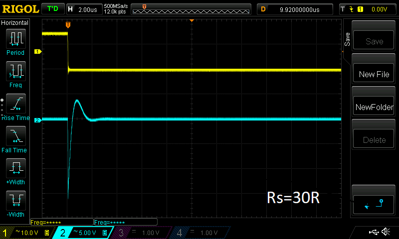

Hi Rick and all,
I feel we got kind of consensus abut my jig correct frequency respond and general functionality. Now question is why my 10uH (and the rest of my 5% conductors from DigiKey) test is so deviated from Mark's "golden test" table. Am I doing something wrong (please see attached images with R chronology (from high to low))?

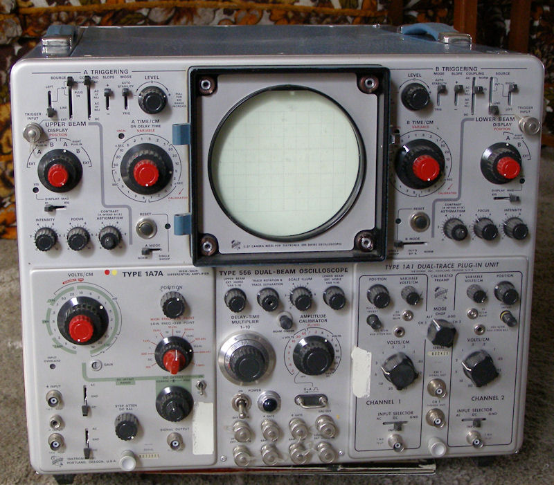

Nice Tektronix scope Jeff - I guess it’s antique but it’s just a baby compared to the 465M I have. 🙂
My large, antique Tek scope. Too lazy to drag it out to use with my Quasimodo. Actual independant dual beams, two scopes in one!

I'm a little confused, too -- your 'scope traces look letter-perfect to me, Alex.
Jeff, Bfpca, Doug -- salutations(sp?), that's some fine looking gear. And thanks for the 'confession', Jeff. Was kinda hoping we could persuade SyncTronX to not feel so bad about using a 30-year-old machine. I still use mine.
