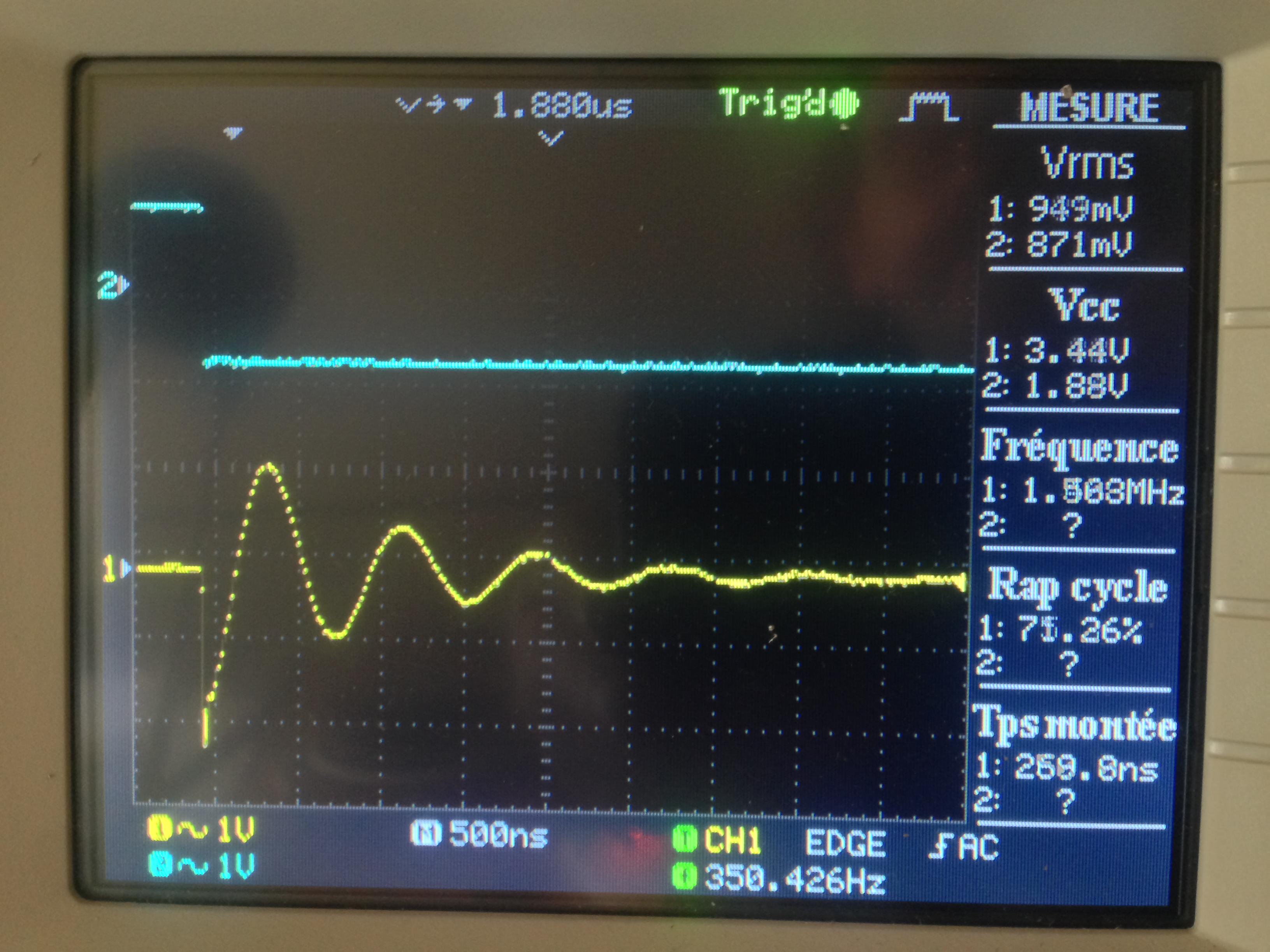

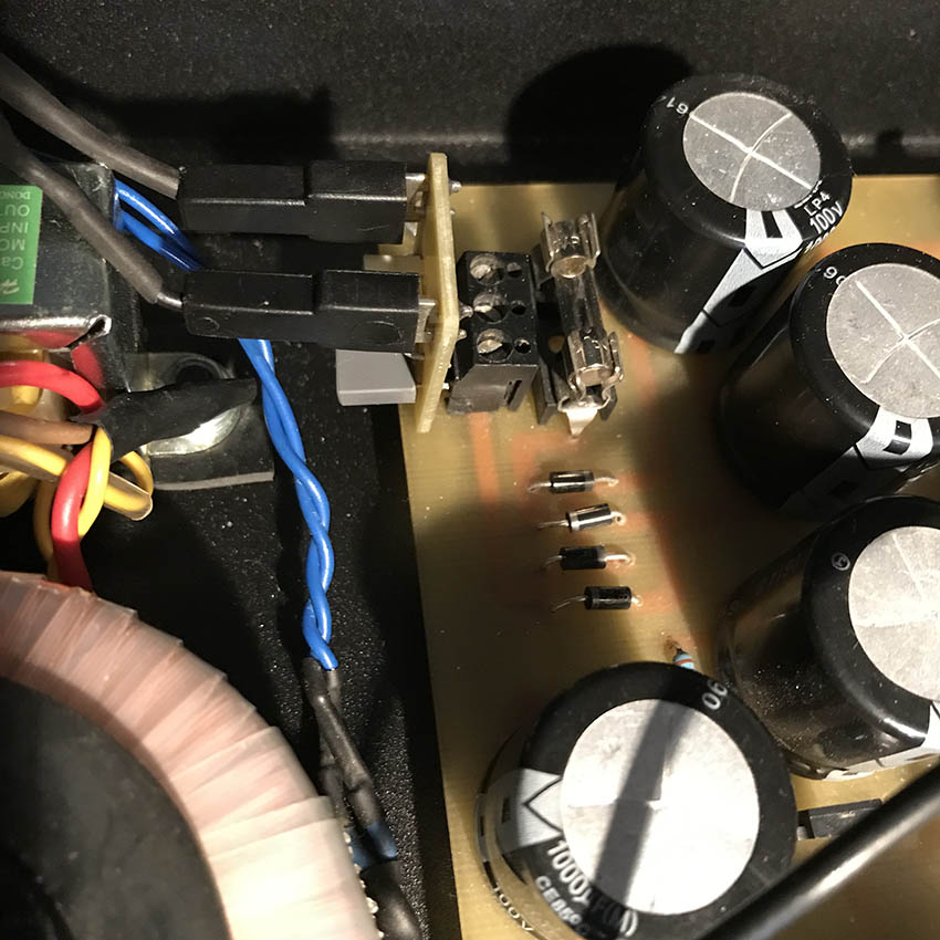

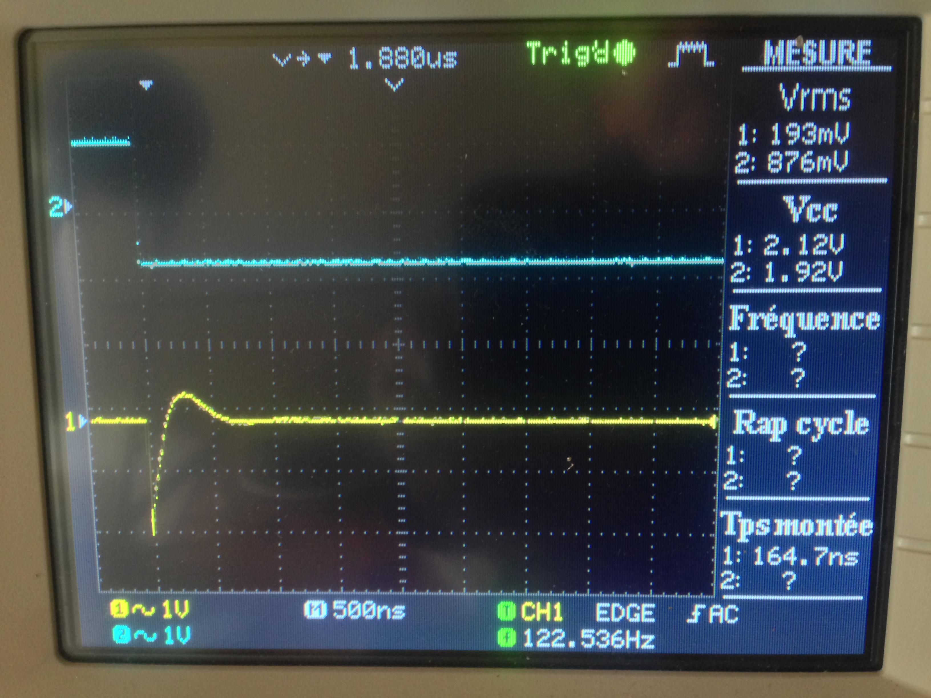

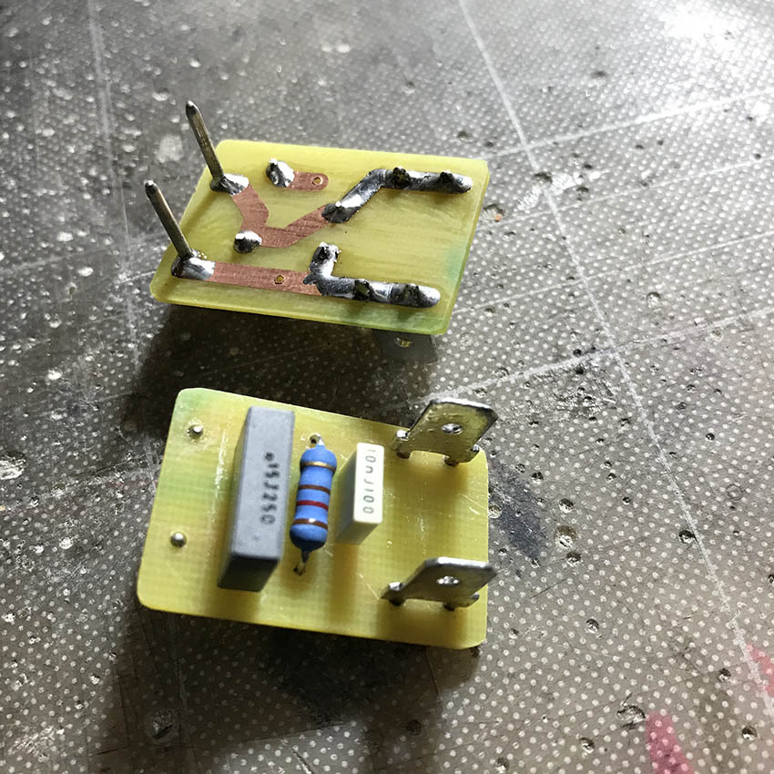

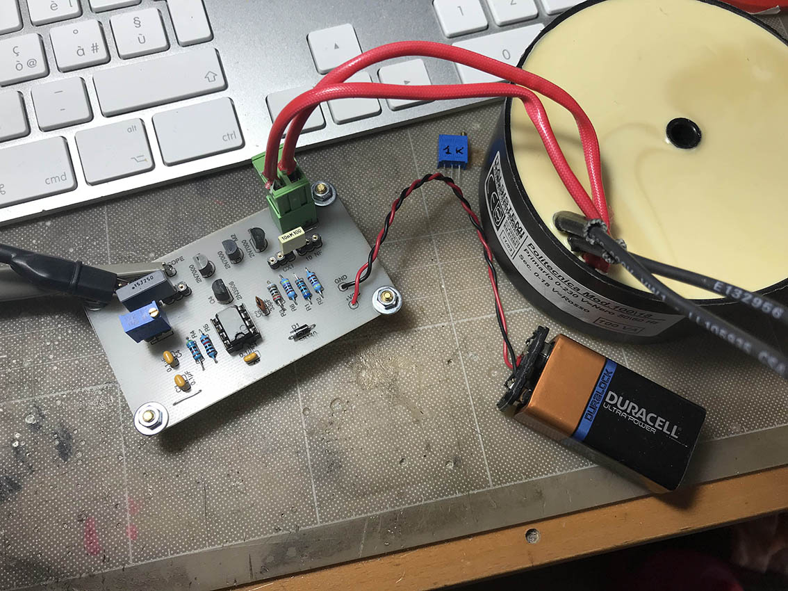

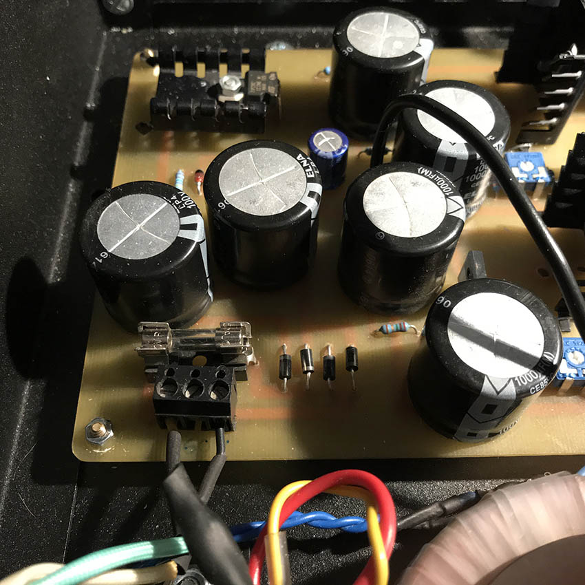

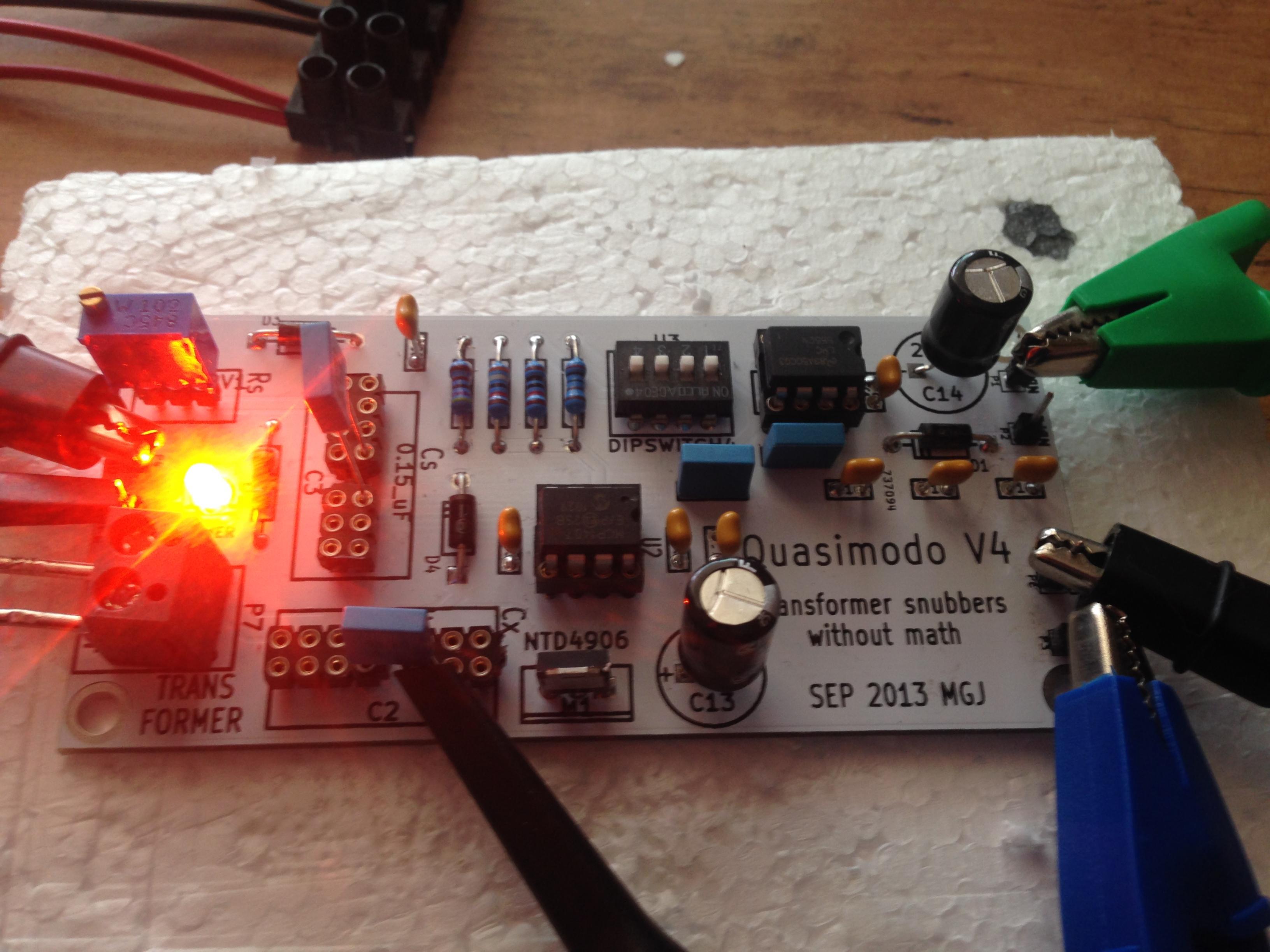

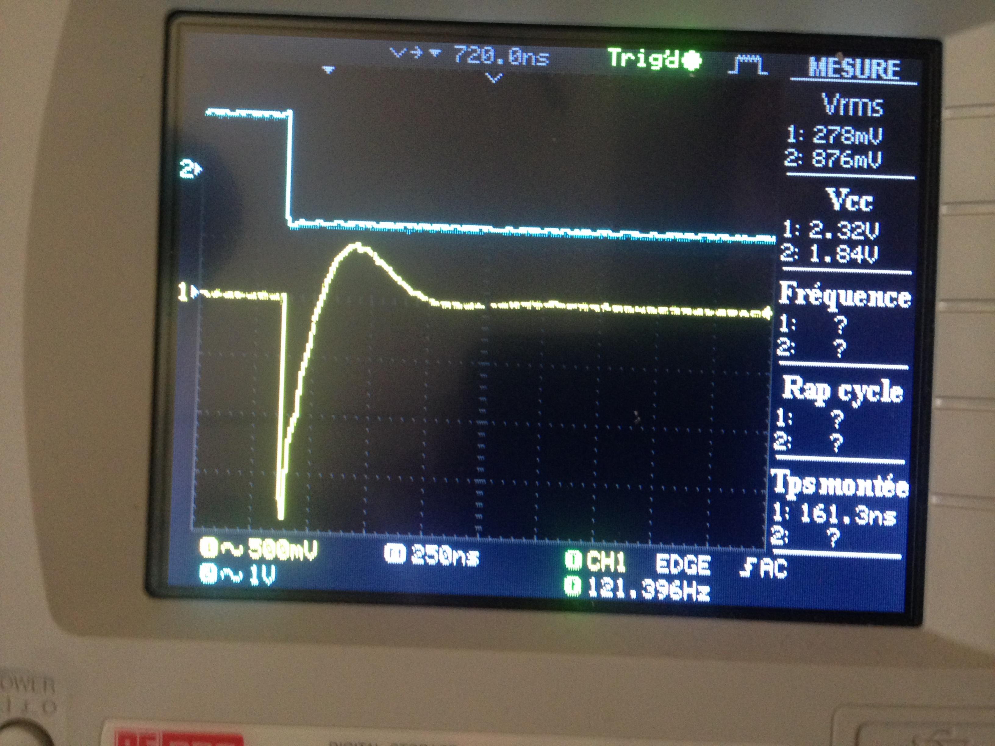

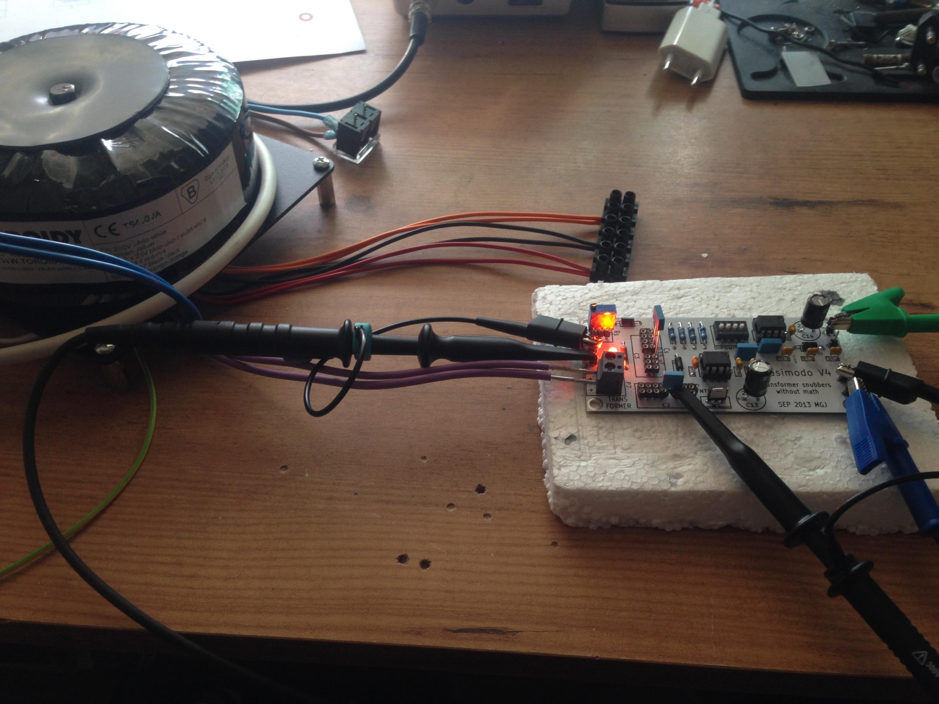

Back in France and ready to use my Quasimodo, thanks to diyAudio member "yoaudio" for the board and "SyncTronX" for the Mosfet (NTD4906). I Just try today with couple of tranfo and this is really easy to use.

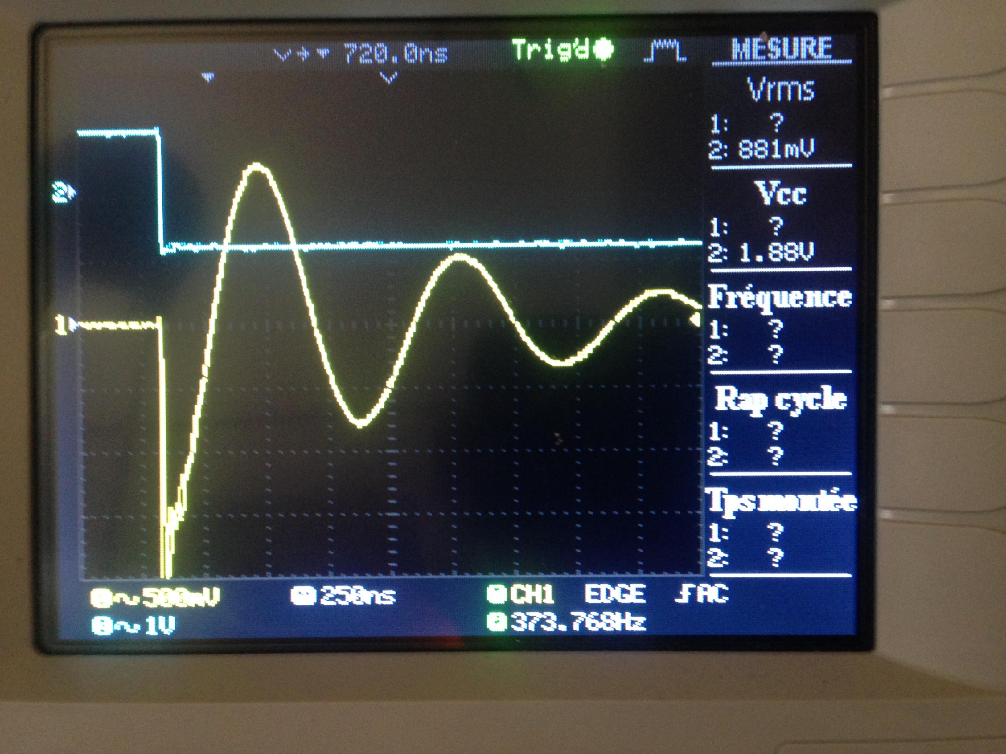

After practicing that is the result for my new Toroidy custom transformer 450va 240v with 2 X 25v (8A), 24v (1A), 12v (1A), 7v(1A)
Picture #3 - #4 same and #5 - 6 same with a different oscilloscope setting.
Cx 10nF
Cs 150nF
Rs 15Ω

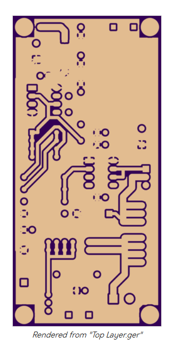

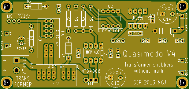

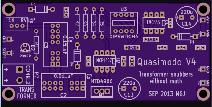

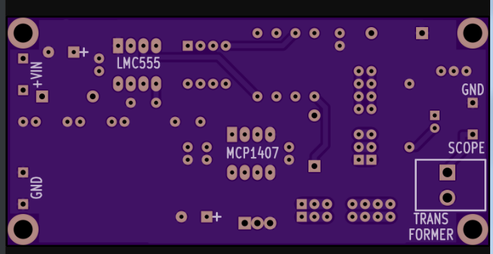

Can't see your pic.
Luckily, OSH Park kept the files on their server from when I ordered Quasimodo V4 boards back in 2013 (!). Here is what I see on OSH Park's website.
These are not photographs, they are computer generated "renderings" of what the finished PCBs will look like after fab. If all goes according to plan.

Joined 2011
Looks right.
Quasimodo V4 PCB uses a "flood / fill" to reduce the VHF impedance of its power and ground network. The top (component) side of the board is flooded to approximate a power plane, and the bottom (solder) side is a ground plane. Why? Because it's got > 100mA current pulses with 1.5 nanosecond rise time. Smells like VHF to me. (This is why I encouraged member EUVL to solder the MCP1407 directly into the PCB with no socket. But he declined.)

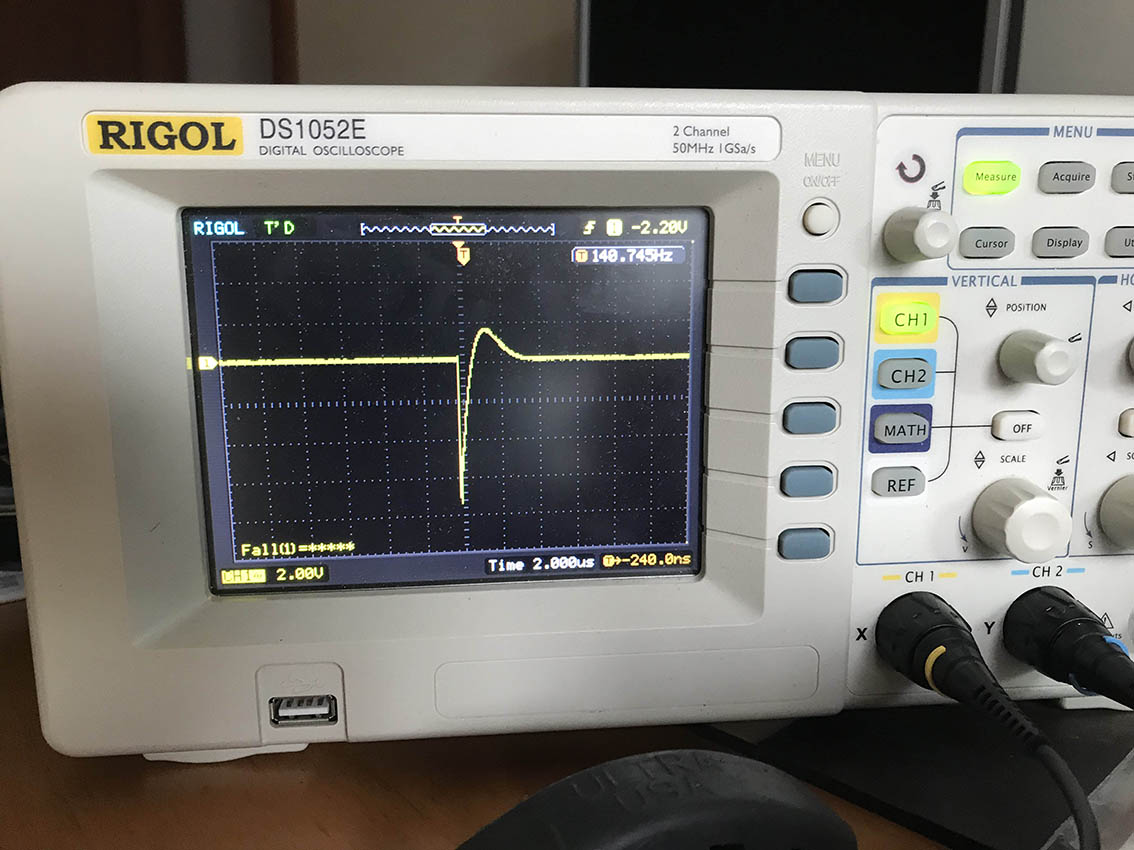

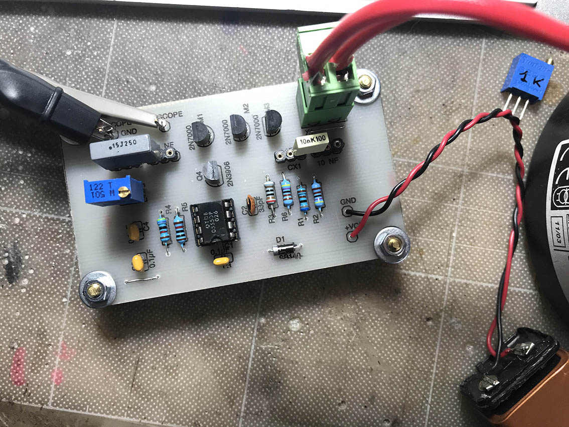

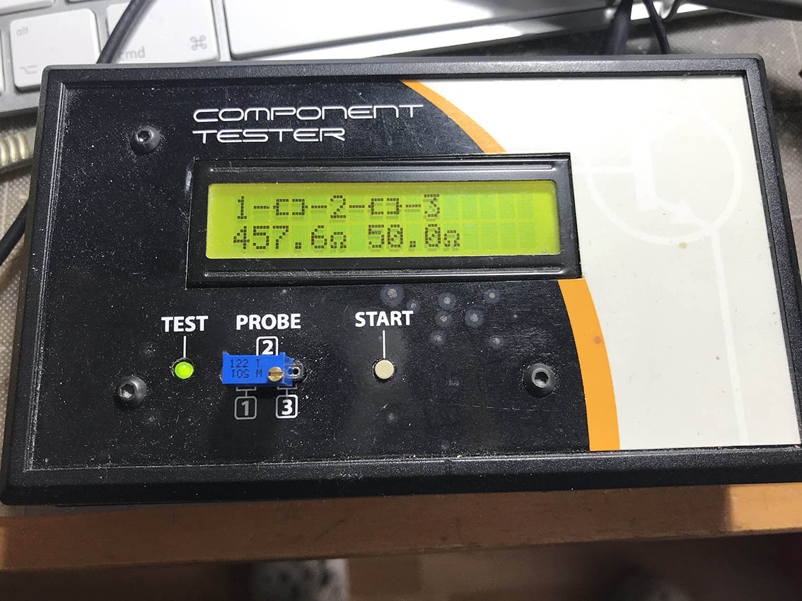

Hi, this is my first attempting with my DIY Cheapomodo PCB (1 side toner transfer…). What do you think about the result. 50 Ohm is right? I use 500 ohm trimmer for best reading.
Thanks…

Joined 2011
Scope photo (#3) looks perfect!
Also congratulations on laying out and fabricating your own PCB! Not many diyAudio members are as bold as you. The non-CMOS-555-chip oscillator used in Cheapomodo, doesn't work at super low voltage supplies (3V). But as long as you use a 9V battery, that won't make any difference at all.

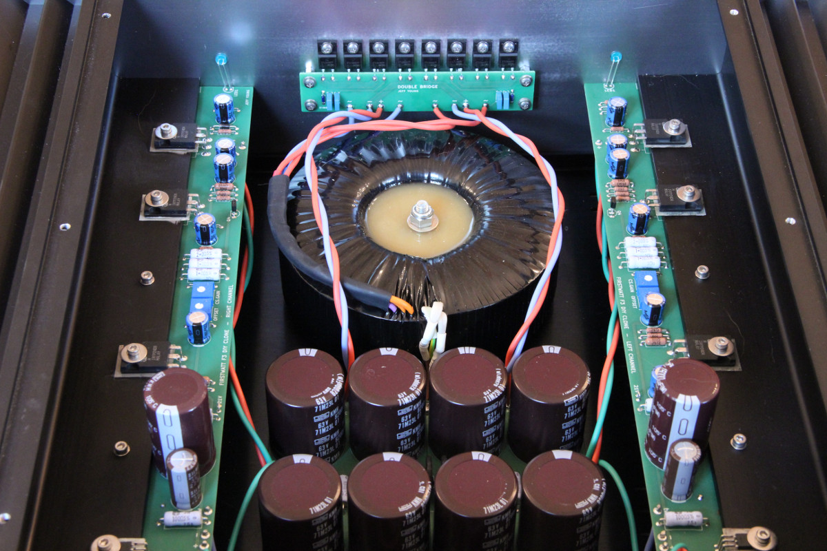

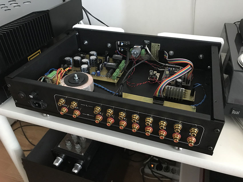

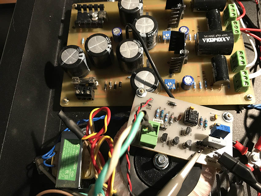

This is my little snubber module that I inserted in my BOZ Nelson Pass preamp. Can this solution work, are there any contraindications?
Bye…
