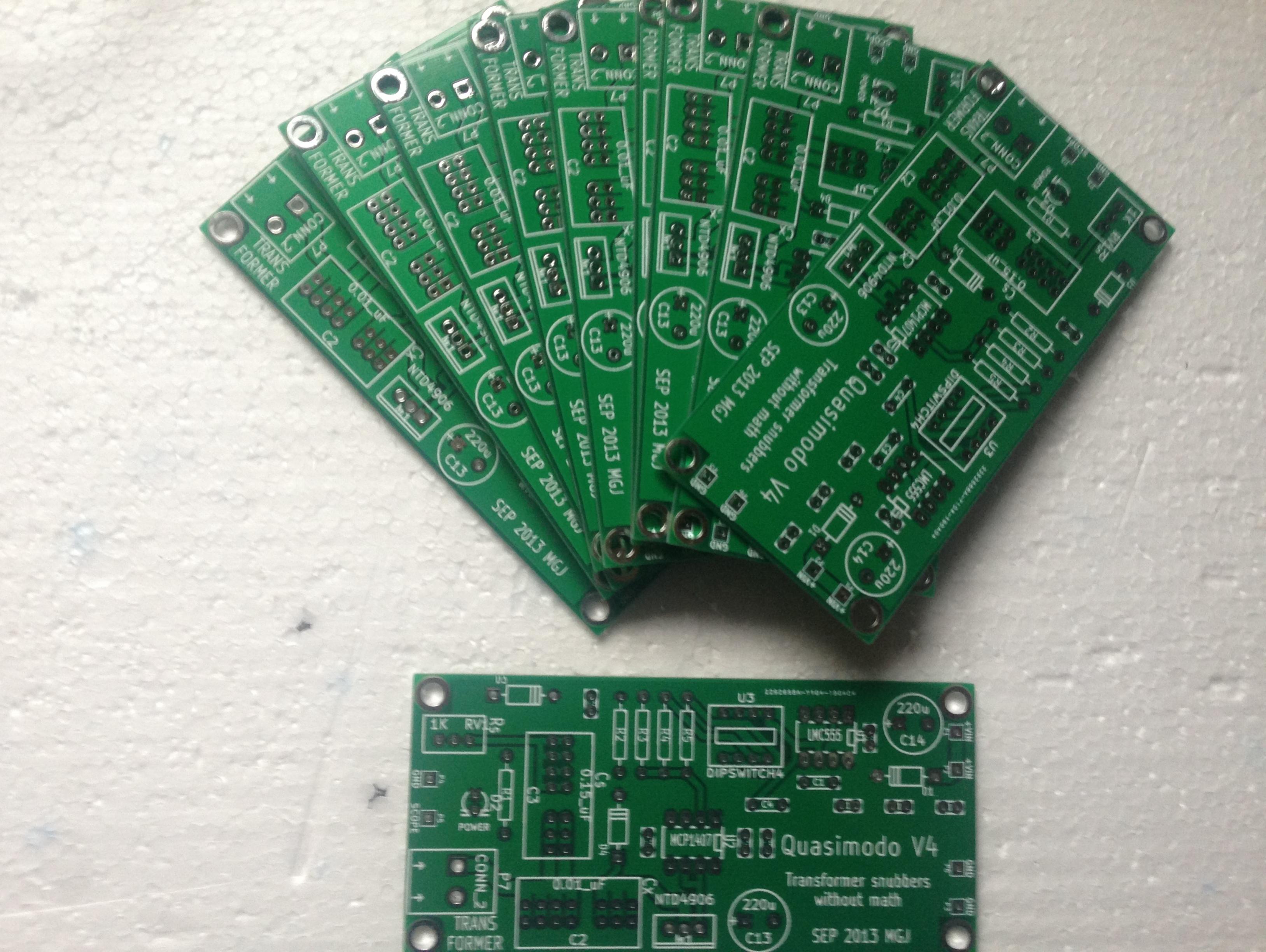

I just built up a through hole version and it worked perfectly and is so easy to use! I will be busy snubbing some diy gear in the near future. Thanks Mark!
If anybody in North America wants a V4 through hole board I have an extra one and will ship it to you no charge. First to PM me wins the prize!

Yes please PM mailing address...Hi Hicoco, I'd like to have one of your boards if there're any left. Merci.
