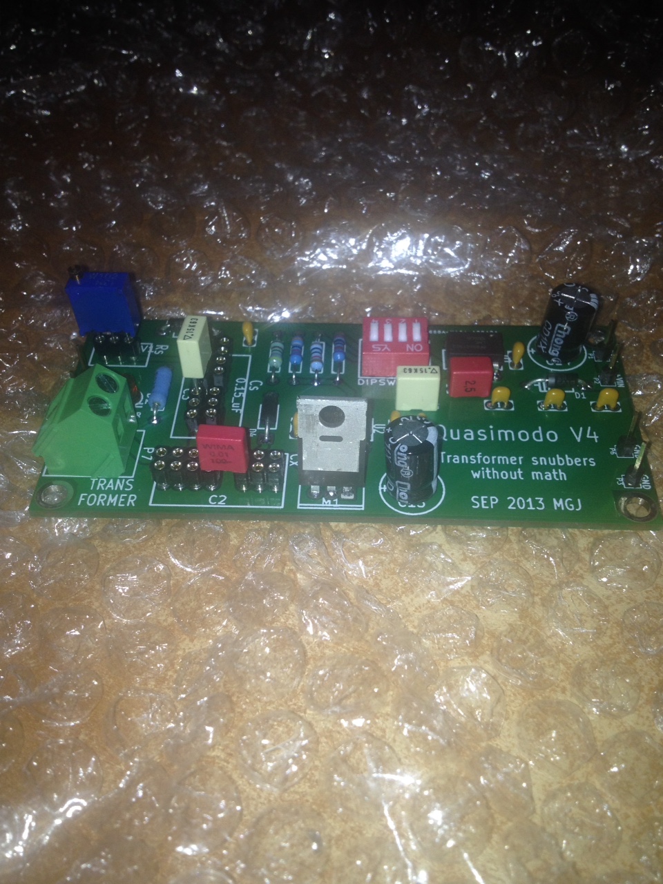

Hi orelli your PM is not working, you have to allowed PM.....in your private message setupHi Hicoco,
do you have a spare pcb for me?
Hi Hicoco,
post me at astrologo17@alice.it
Hi Hicoco,
tank you very much

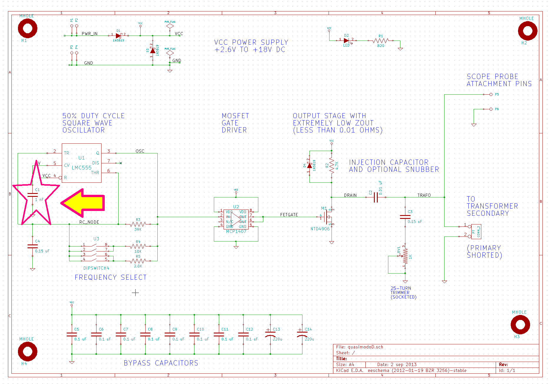

As NTD4906 or STS12N3LLH5 is hard to find or obsolete, what's the best alternative so far? BTW, I am assuming TC4427 or NCP1407 will work on every MOSFET, right? Thanks.
Poting
Poting
Hi🙂
You should read bom in the first post. There are 2 substitutes listed:
IRLB8748, IRLU8726
IRLB8748, IRLU8726
Hi🙂
IRLB8748, IRLU8726
Thanks. I found the BOM already. I thought it was on the PDF, but it was not.
Hi Mark,
in the BOM oF V4 pcb the value of C1 is 1n ie 1000p.
It's correct? I think not.
Hmm... 1nF = 1000pF
