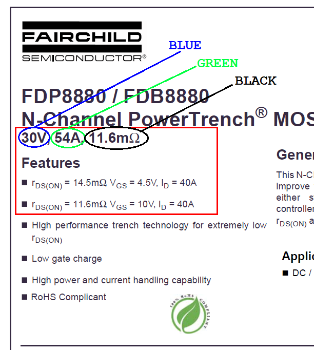

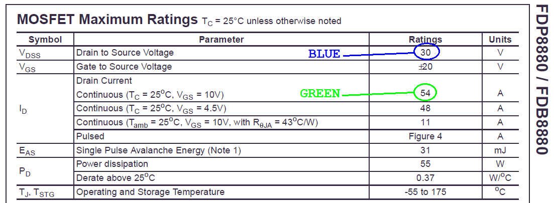

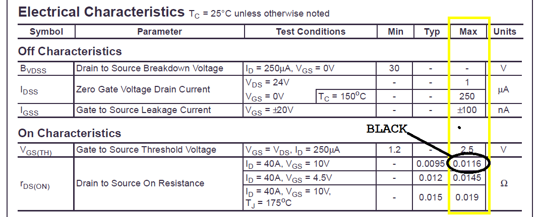

Mark,
Here you go. Please just let me know if I am right or wrong.
I appreciate the way you are not spoon feeding me information.
James
1. Yes, TO-220
2. Pinout is G D S
3. Maximum VDS is 30 volts
4. Maximum VGS is 20 volts
5. What is the maximum permitted value of IDS in amperes? 250uA
6. Does the first page of the datasheet mention the phrase "Logic Level Gate" ? preferred but not mandatory - no it does not.
7. Is RDSon less than 0.010 ohms (< 10 milliohms is preferred)? Is RDSon less than 0.10 ohms? (< 100 milliohms is mandatory) - No, it is higher being 14.5 @ 4.5V and 11.6 @ 10V
Joined 2011
Please try again after studying and reflecting upon these attachments. Note that "0.0116 ohms" equals "11.6 milliohms".

Mark,
I apologize but maybe I am not understanding this, but with the question on Rds(on) being less than .010 ohms.
The MOSFET I ordered does not meet that criteria of being less than .010 ohms, but to me it does meet >100 millohms as I am reading the information.
I researched the formula for finding Rds(on) and it seems like it is a version (different names) of R=V/I. But even with this, I am not coming up with the same values as listed in the data sheet I posted.
Sorry but I am trying my best to understand this.
James
Joined 2011
Your MOSFET will be perfectly adequate and a Quasimodo using it will work just fine.
Rds(on) is a MOSFET parameter which is measured, not calculated. It varies a little bit from one unit to the next, due to unavoidable variations in the manufacturing process. One example would be: gate oxide is slightly thicker on the left side of the semiconductor wafer than on the right. MOSFETs on the left side of the wafer will therefore have slightly higher Rds(on) than MOSFETs on the right side of the wafer. This is not desired, and the semiconductor fab engineers work their butts off to reduce its variation, but these sorts of small variations do occur.
So the manufacturer measures Rds(on) of every single MOSFET, and they throw away the ones whose measured value is higher than the datasheet spec.
Imagine how much money an unscrupulous dumpster-diver could make, by grabbing those reject units out of the garbage can and ... um ... finding a way to turn them into revenue.

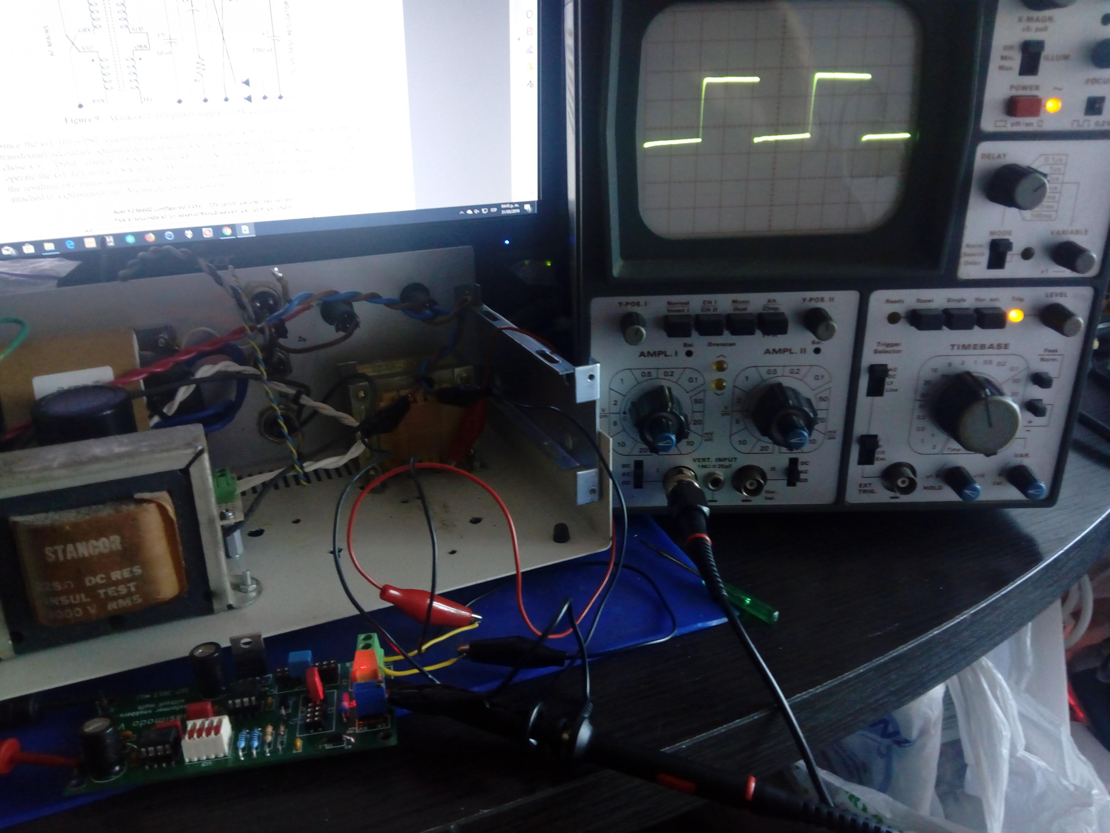

One way to get a perfect square wave display when using Quasimodo, is to disconnect the transformer secondary from the Quasimodo PCB, and replace it with a 2.2 megohm resistor connected to Quasimodo. Voila, square wave.
An even easier way to get a perfect square wave display when using Quasimodo, is to disconnect ONLY ONE of the transformer secondary wires. Remove it from the screw down terminal block on the Quasimodo PCB and make sure it touches nothing else. {Notice what you just did: you introduced an OPEN CIRCUIT somewhere in the secondary.} Now power up Quasimodo and look at the waveform between TO SCOPE and ground. Voila, square wave.

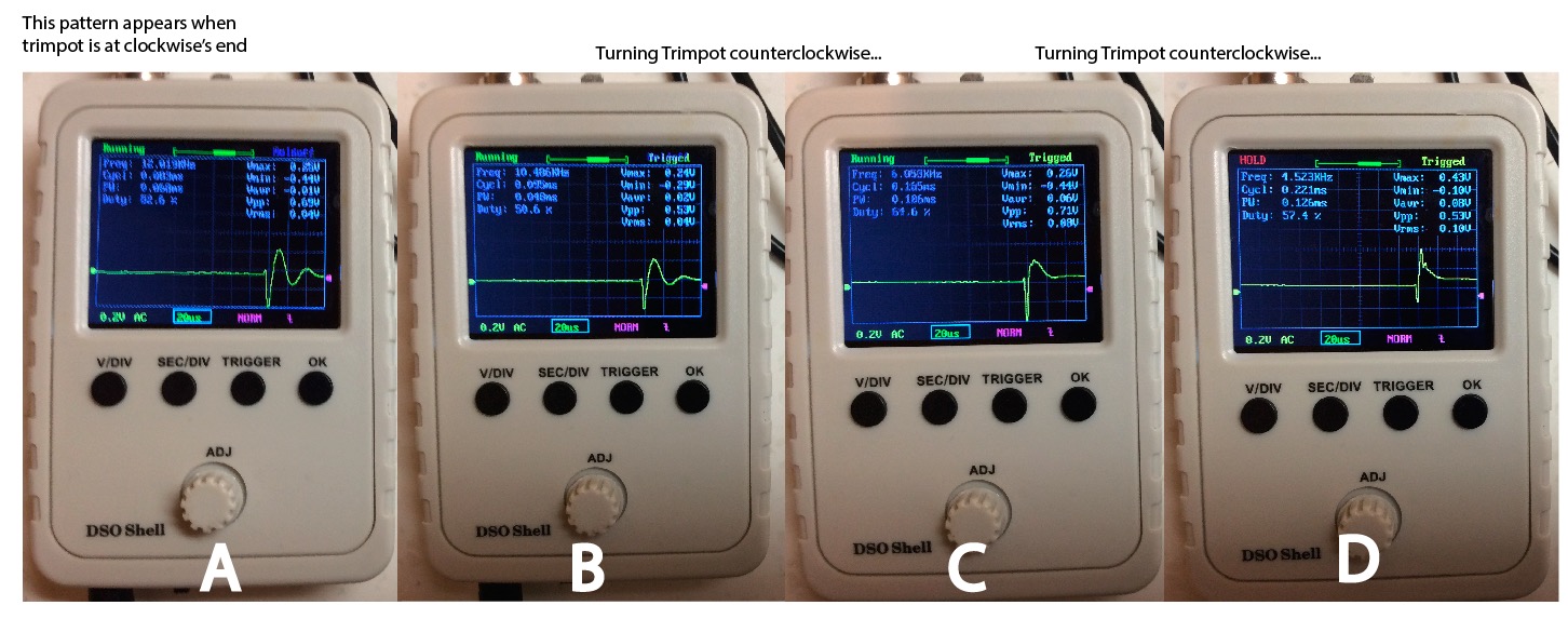

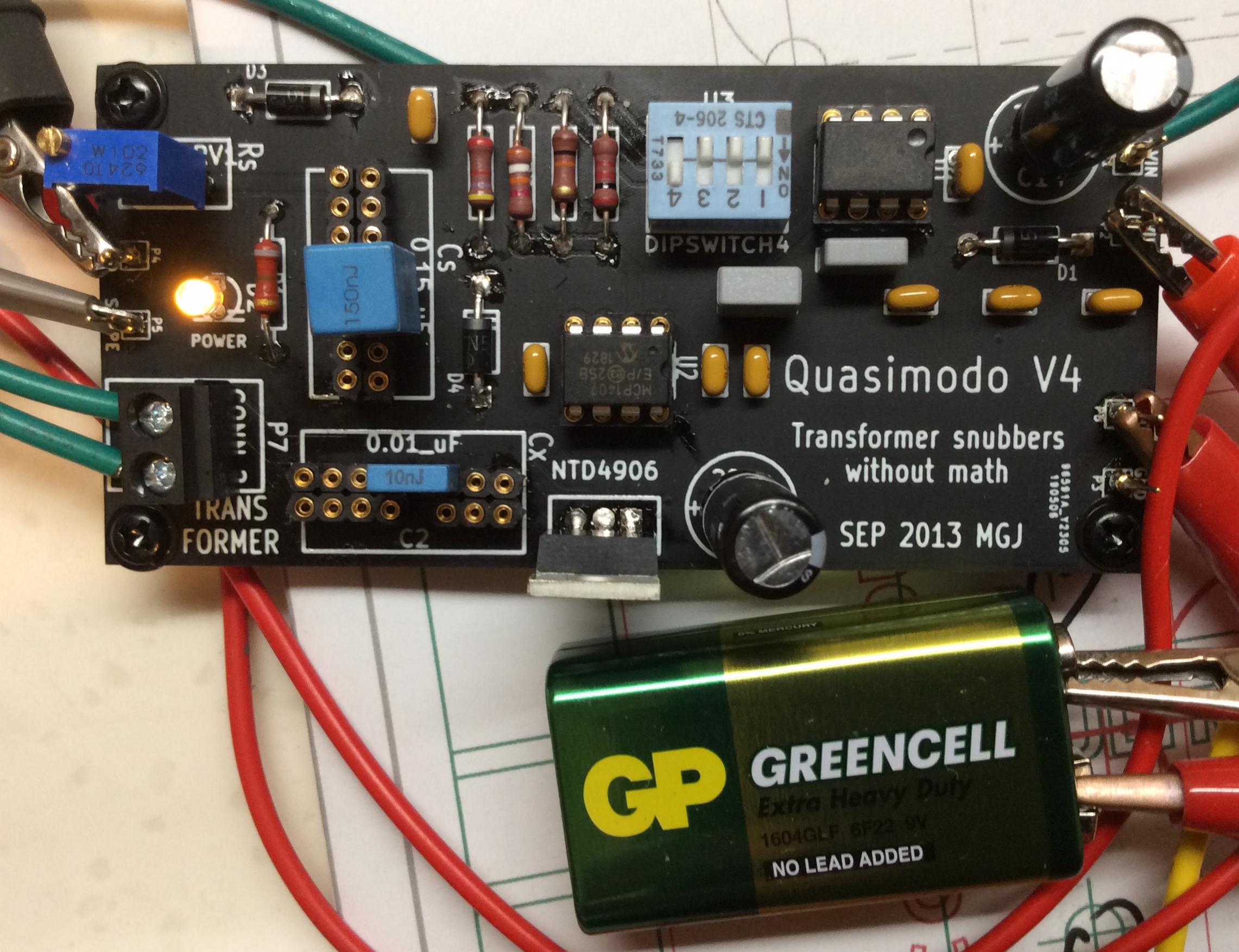

Here is my first time to test a transformer with my first ever ordered PCB-Quasimodo rig. I am excited!
I only have a very cheap Oscilloscope but it successfully displays the ringing waveform after playing with the settings.
Question:
Should I go for C or D? D seems a bit extreme and spiky.
The transformer Primary is set at 230V; secondary is 2x15Vac; 50VA.
Cs and Cx are the recommended values.
The final resistor value is about 27Ω. (for display C)
I hope I am doing everything correctly.
Thanks Mark for this wonderful tool!

Nano, congratulations on a pretty build! This is the first one I've seen on a black PCB.
Among your photos, I would select "C". The second lumpity bumpity has just barely disappeared, exactly as we wish and exactly as the yellow arrowhead points, in the first few pictures of the Quasimodo .pdf
