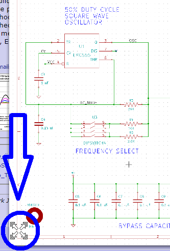

To read post #1's schematic with perfect crystal clarity:
  1. View post #1
  2. Click on the fourth attached thumbnail (the V4 schematic)
  3. Click on the white "X" icon at the bottom left of the image. This is the diyAudio website's icon which means "Increase image display size to 100% of original".
You might want to print out these instructions, and keep the paper in hand while you're attempting the maneuver
_

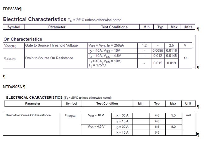

Now I was half asleep when I was ordering from the BOM but I could not find the gate driver and power mosfet so I ordered the below ones. Listed are the manufacturers PN's so I hope these will work.
I also ordered 6 of the boards from OSHpark company. So I could make a few of the these and learn how to do this for the snubber board to be used in my Pearl 2 build.
Thank you very much to Mark for all of his work on this, which I greatly appreciate. And thanks to all others who contributed to this.
Gate driver = MCP1407-E/P
Power MOSFET = FDP8880

Mark,
I went back and reviewed the datasheets for the original mosfet specified and the one that I purchased. The one question I have is concerning the Rds(on), but the way I am reading it is that the one I purchased meets the criteria specified in the post documented.
If you do not mind taking a quick lok I have attached a screenshot of both of the mosfet's Rds information and also the datasheet for the one I ordered.
If you could be kind enough to take a quick peek and let me know if I am good or need to go back and review this some more.
Thanks, James
The FAQ directs you to post #175, which says:
... here are the required properties of the MOSFET (as discussed on p.4 and p.22 of the Quasimodo design note), which you can use to help you choose a device from your favorite distributor:
  • package: TO-220 or IPAK, pinout GDS (left to right)
  • VDSmax > 20V
  • VGSmax > 17V
  • IDSmax > 2A
  • Logic Level Gate preferred but not absolutely mandatory, see p.4
  • RDS(on) as low as possible. RDS(on) < 100 milliohms mandatory, but < 10 milliohms preferred
What does that mean?
That means you write out a little questionnaire like the one below. Then you answer each question by searching for that piece of data in the datasheet.
  1. Is it in a TO-220 package? yes or no
  2. What is the pinout, left to right?
  3. What is the maximum permitted value of VDS in volts?
  4. What is the maximum permitted value of VGS in volts?
  5. What is the maximum pernitted value of IDS in amperes?
  6. Does the first page of the datasheet mention the phrase "Logic Level Gate" ? preferred but not mandatory
  7. Is RDSon less than 0.010 ohms (< 10 milliohms is preferred)? Is RDSon less than 0.10 ohms? (< 100 milliohms is mandatory)
I will answer the first few questions to get you started. According to the datasheet attached to your post:
1. Yes, TO-220
2. Pinout is G D S
3. Maximum VDS is 30 volts
4. Maximum VGS is 20 volts
Now you answer the rest. When you've finished, if every question is answered YES, then the MOSFET is acceptable. If your MOSFET lacks a "preferred" attribute, it's acceptable too, but not insanely great spectacularly awesome. Preferred is, well, preferred. But not mandatory.
