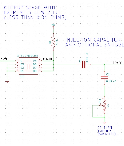

I use 0.01 for Cx and 0.15 for Cs. Two boards are tested: V3 (SMD) and V4 (through-hole). PSU is HP E3617A and it is set to 0-15VDC. I attached table which I used for reference. I found it in the post 487 when Mark described testing methode. All my instructors purchased from DigiKey.

Checking your post #1472, the first 'scope trace shows the ringing at almost exactly 500 kHz -- each cycle occupies one division of 2 microseconds. The value from the table in post #487 for 10uH with 0.01uF is also 500 kHz. For 5% and %10 parts, that seems pretty good to me.
Granted, your derived zeta=1 value for Rs is higher, 23.5 ohms rather than the table-predicted 16 ohms. This is not a surprise, though, since each part contributes its own small losses to the result.
But this is exactly what makes Quasimodo so great! All those pesky little parasitic factors that are hard to measure even with expensive equipment and setups, can be completely ignored: They're fully accounted for by the method!
In sum, I think your Quasi is working perfectly. Snub away!

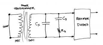

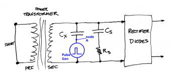

I still haven't read the entire thread yet, but did have a couple of questions:
  1. I struggle to see how the quasimodo (pic 1), with the Cx cap in series with the load, equals the actual snubber (pic 2), with Cx in parallel to the secondaries? I know the mosfet acts as a switch and is very low impedance, but it doesn't seem equivalent...
  2. From what I have seen I think this is correct, but the quasimodo jig won't function with Cx replaced by a jumper, i.e. I want to see what a simple RC snubber would look like? Or does the jig work OK that way?

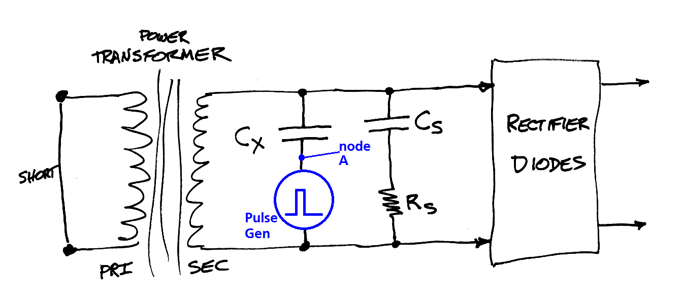

A transformer + snubber + diodes is shown in Figure 1 below. In operation, the diodes inject an (unwanted!) pulse into the circuit, every time they turn off, causing oscillatory ringing.
Figure 2 below shows the same circuit, attached to Quasimodo. Quasimodo is the blue circle on the schematic. Now Quasimodo injects a pulse into the circuit, causing oscillatory ringing.
The Quasimodo circuit works quite well, precisely because Quasimodo's output resistance ("impedance") is incredibly low: 0.006 ohms. After Quasimodo injects its single step function pulse, it becomes an almost perfect, dead short. The blue circle becomes a more or less perfect conductor of negligible resistance. Thus Figure 2 is the same as Figure 1, after the pulse is generated and while the resonant circuit is ringing.
If anyone wishes to perform a small signal analysis of figure 2, I have labeled node A for your convenience. But I think the previous paragraph explains the situation well enough, without introducing scary undergraduate EE terminology.

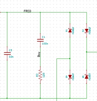

I tossed together a cheapomodo on solderless breadboard to mess around with, seemed to work alright even though it is a mess:
Built a through-hole board on the board and MOSFET supplied to me by yoaudio (thanks!).
Transformer: ILP 49783R1 - 1014, 160Va, dual secondaries
Undamped (10nf Cx)
Damped 10nf Cx, 150nf Cs, Rs ~12R
Same transformer, John Swenson RC snubber 330R/22nf
Not bad, much better than no snubber, though a bit underdamped (I think?).
