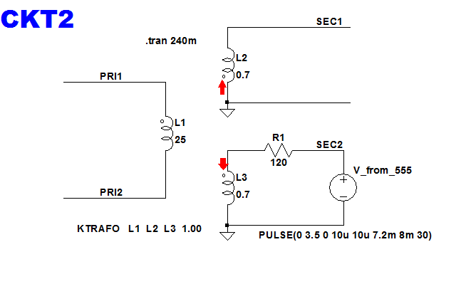

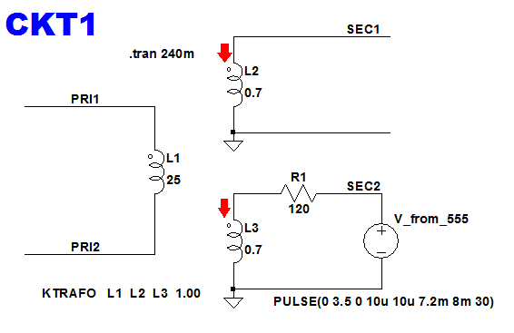

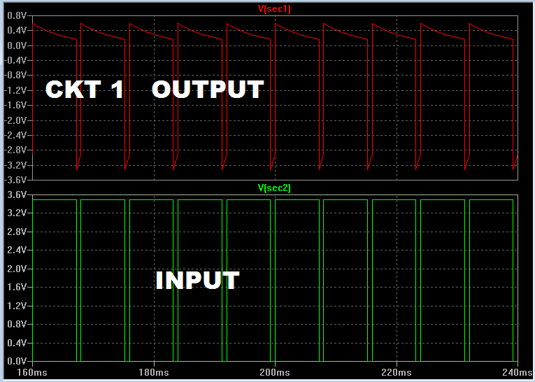

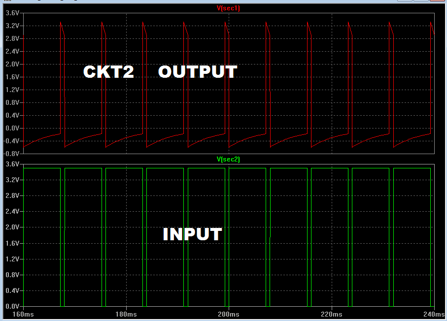

I heard from somebody who found Appendix D confusing, specifically this part:
... a square wave with 10% duty cycle would work too. What you want is a waveshape that's easy to tell right-side-up from upside-down. Apply the test signal to the dot end of winding 1, and monitor winding 2 on the scope. If it's right side up then the scope probe is on the dot end of winding 2. If upside down, the probe's on the undotted end.
Attached are schematics and waveforms for two circuits. CKT1 applies the test signal (from a little NE555 oscillator circuit on your protoboard, or from your function generator) to the dotted end of the lower winding, and attaches the scope probe to the dotted end of the upper winding. Notice how the output os NOT upside down.
CKT2 applies the test signal to the dotted end of the lower winding, and attaches the scope probe to the not-dotted end of the upper winding. Notice how the output is upside down.
