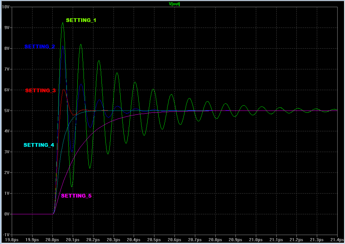

If anyone would like to prepare a set of graphs showing Quasimodo waveshapes at several different values of the damping factor Zeta, there are resources here on the diyAudio website that can help you with the job.
HERE is an LTSPICE simulation file (.asc) of a Quasimodo board in operation. It drives an inductor whose inductance value YOU choose. You can simulate exactly the Zetas you desire, simply by using the damping factor equations from the Quasimodo design note (A.10 and A.11) to select the appropriate snubber resistances which give those Zetas. Then you use LTSPICE's .STEP PARAM feature to overlay those several waveforms on the same output plot. I have attached an example below, showing five .STEPped PARAM circiuts on the same plot.

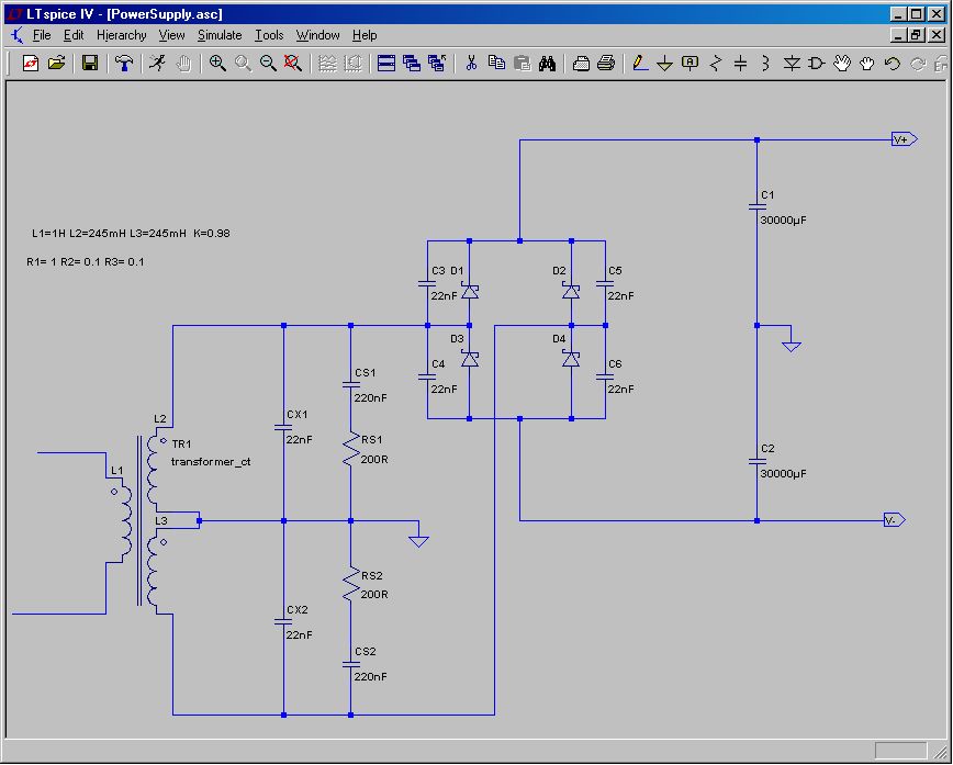

I have a question. Attached is the power supply I use. This is the same as the "Center Tapped Secondary" in Mark's note.
The difference is that I use 22nF across each of the 4 diodes C3, C4, C5 and C6. This has been implemented in my existing PCB.
So what is the value of C2 in this case? Let us assume that Ct as well as Cd can be ignored. Of course, C3, C4, C5 and C6 with value of 22nF cannot be ignored.
P.S. I am a late comer and I have not read through this long thread. If this has been asked before please execuse me. I would be glad to use 10nF for Cx and 150nF for Cs but some of my boards already use 22nF.

OK, I asked the original question. Maybe I should answer my own question.
It should be 44nF which is Cx1:22nF + C3/C4:22nF = 44nF if according to the above schematic. This is because for each secondary winding that has a separate CRC snubber, only one of the 2 connected diodes conducts at any one time, and while one is turned on the other is turned off. Snubbing takes effect when the diode suddenly turns off. When the diode turns off, its capacitance is effectively in parallel to Ct and Cx.
I asked the question because I wanted to have my understanding checked and be sure I put in the right C2 on the Quasimodo jig.
Let me know if I am wrong.

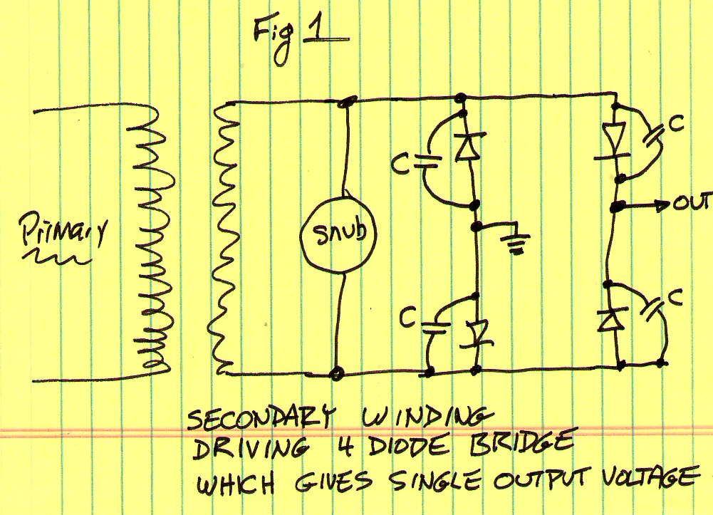

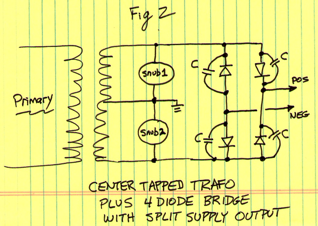

Member HiFiNutNut asks an interesting question in post #608 above.
Suppose that, for some reason, a linear power supply includes a bridge rectifier where each of the 4 diodes in the bridge, has a capacitor of value C farads connected in parallel with the diode. All four diodes are identical and all four capacitors are identical.
HiFiNutNut asks: how do these four capacitances add, subtract, multiply or divide, to give an equivalent across-the-secondary capacitor "Cx" that resonates with the secondary leakage inductance?
There are two cases to consider, shown below in Fig.1 and Fig.2. Fig.1 shows a single, 2 terminal, secondary winding driving the four diodes and four capacitors. This produces a single DC output voltage. Fig.2 shows a 3 terminal, center tapped, secondary winding driving the four diodes and four capacitors. This produces two DC output voltages, a positive output and a negative output.
And here are the answers:
If each of the capacitors is "C" farads, then Fig.1's effective across-the-secondary capacitance Cx is (1.0 x C) farads.
If each of the capacitors is "C" farads, then Fig.2's effective across-each-secondary capacitance Cx is (2.0 x C) farads.​
I imagine that one or more people may now tut "well of course the answers are 1C and 2C, that's obvious by inspection!" ... yet they didn't mention this obvious answer until just now.

I guess I could look at your circuit / drawing this way.
In your drawing, POS and NEG can be assumed to be short to ground for the resonant frequency because of the (not drawn) large reservoir caps. So the secondary wire (other than the centre tap) is effectively connecting to two capacitors (C) which are connecting to ground when the diodes are turned off.
Am I understanding it correctly?
If so, the Cx in my original schematic would be 3 x 22nF = 66nF.
The right answer for the schematic in post#608 is Cx = (2 * 22nF) = 44nF. That's what you'd use in Quasimodo testing of the transformer secondary. When you install the snubber you'd let those four capacitors work together to produce 44nF across the secondary, and you'd include an additional ZERO nanofarad Cx capacitor in your snubber.
There are three ways you can confirm or refute this answer: (i) pencil and paper analysis using Laplace Transforms; (ii) laboratory measurements of real power supplies; (iii) simulation. If you've got grave doubts about the right answer 44nF above, and if it is very important to you, then you can get busy with (i) , (ii) , or (iii) .
