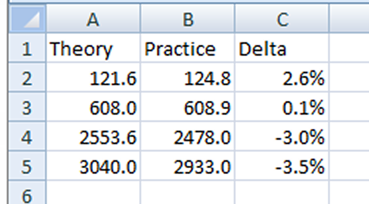

Modesty aside, I think that a possible prototype for such a table in Excel (could also be ported to OpenOffice) already exists. It evolved during my work with Quasimodo, and several evolutionary versions were presented in this thread over the last 12 months. The current version contains data for ten transformers, whereby one of them was also measured with the rectifier diodes connected.
This table provides also for automatically comparing the Rs value obtained for a particular transformer with the one obtained mathematically. All it needs is the natural (resonant) frequency entry in column E (obtained with Quasimodo) and, optionally, the secondary resistance in column D, in order to calculate the Rs value for the Zeta,opt value in column J. Of course, this is not obligatory; the table can be programmed not to do the check if the resonant frequency value in column E is absent. The check is currently there because I wanted to cross-check each experimentally obtained Rs value witrh the one coming from the formula.
So I'm putting this table as a possible prototype for consideration here.

Actually, it's much easier than you might think. You only need to enter three items in order to have the Excel sheet compute the theoretical value of Rs, these being the secondary winding resistance, the natural frequency (the oscillation you see on the scope with Rs removed from the Quasimodo ringer), and the Zeta value of your choice.

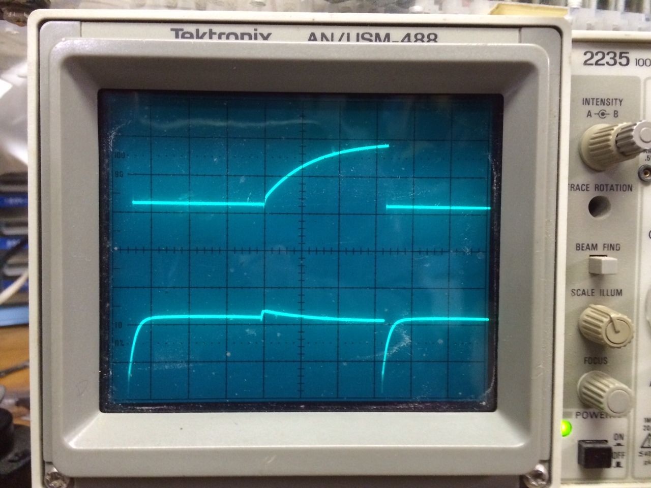

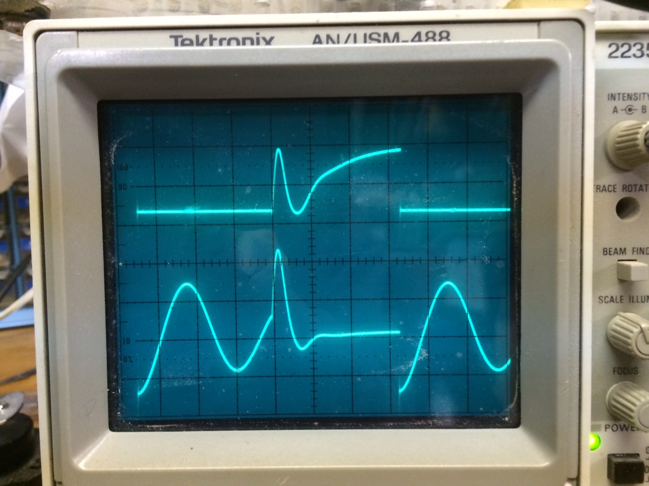

I just assembled a Quasimodo (through hole version) and seem to be having a bit of trouble. The traces I get look nothing like what the documents indicate they should look like. (These are with a random transformer I had in my junk box).
The first photo shows the traces I get with RV1 uninstalled (=infinity) (the top trace is trigger and the bottom trace the normal scope output.
The next photo shows the traces I get with a random (virtually any value within the range of the trimpot).
If I remove C2 the trigger (at the drain of the MOSFET) is basically a perfect square wave.
So, not sure what I have done wrong. Any suggestions would be much appreciated.

It appears you might be running your oscillator WAY too fast for this transformer. I suggest you fool around with different DIPswitch settings (there are only 2^4 = 16 of them) and find the setting which gives the largest period (the lowest frequency) measured at node DRAIN. It ought to be in the neighborhood of (frequency = 120Hz), (period = 8.3 milliseconds).
If yours is not ~ 120 Hz, you may have accidentally installed the wrong component values for the timing resistor R3 (39K) and/or the timing capacitor C4 (0.15uF). Or there may be a soldering error near those components.

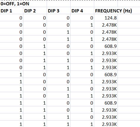

I checked last night and sure enough I had set the frequency incorrectly. I created this handy-dandy chart to remind myself not to do that again (these were actual measured, as opposed to calculated, frequencies).
Quasimodo is now working as expected.
Thanks again for your help.

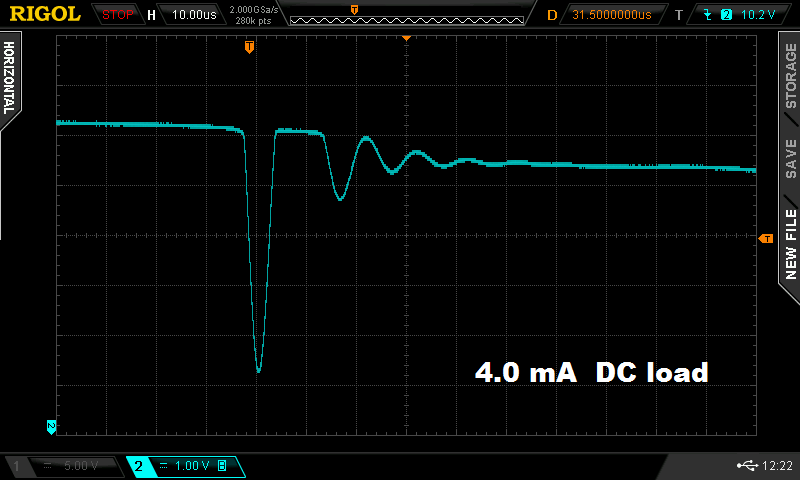

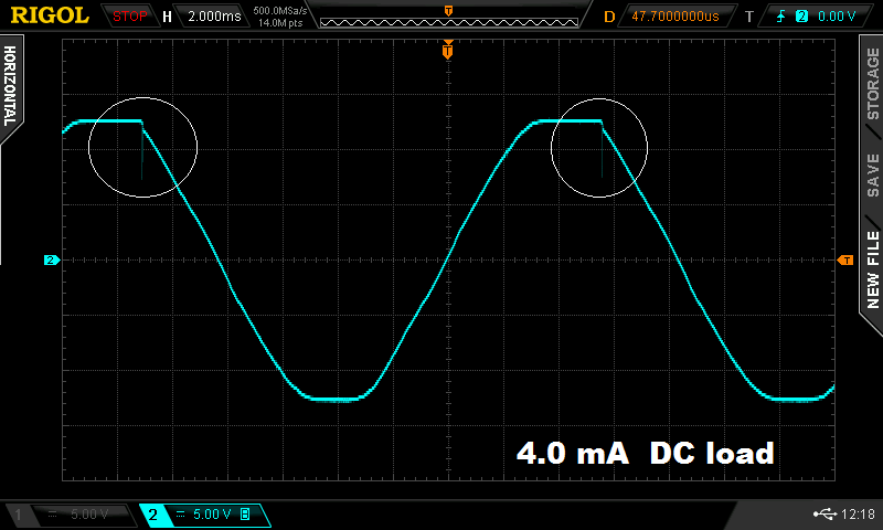

... if you have a full wave bridge supplying a DC circuit that draws 5-10mA, would a snubber be actually worth considering?
The answer depends on the details of the transformer, the details of the rectifiers, the details of the filter capacitors, and the personal taste of the circuit designer.
I have attached two oscilloscope photos that show the voltage across the transformer secondary, for one particular combination of (transformer, rectifiers, filter capacitors), with a 4.0 milliampere DC load.
Picture1 shows a full 60Hz AC cycle; the diode induced oscillatory ringing is circled in white. {Yes the power line waveform certainly does have a flat top in my neighborhood!} The transformer secondary voltage is ±12.5 volts, and the downward spike amplitude is 5 volts (!) with this tiny 4mA load.
Picture2 is a zoom-in of the ringing oscillation. The spike-down is so great that the subsequent half-cycle of oscillation rings upward high enough to actually turn on the rectifier diode again (!!), between t = 43usec and t = 53usec.
Is it "actually worth considering" a snubber for this power supply? Different designers will give different answers. My own personal answer is: yes I think it is worth considering a snubber for this power supply.

Consider it a challenge, see whether you can put together a transformer, rectifier(s), and filter capacitor(s), driving a DC load of 4mA, which produce a reverse recovery spike amplitude >40% (5 / 12.5) of the secondary voltage. Messages #44 and #45 in the Cheapomodo thread, indicate this is unlikely.
(An earlier post by user DNi) achieved a 21% spike amplitude (2.5 / 12) when his supply was delivering 50 mA DC to the load. It would have been even taller if he had used a different Cx.
