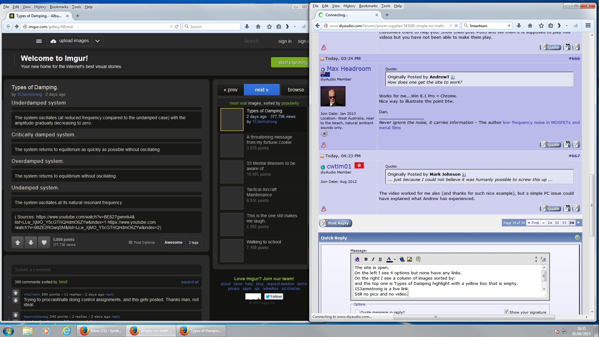

I just saw this nice demonstration of second order linear systems. The top one is Underdamped (zeta < 1.0), the middle one is Critically Damped (zeta = 1.0), and the bottom one is Overdamped (zeta > 1.0).
If you ever wanted to see the mechanical equivalent of your Quasimodo electronic output, this is it.
The .gif video is hosted on a third party image site and I don't know how long they'll keep it before scraping it off their server. View it now while you still can: (http://imgur.com/gallery/NErmd)
I'm not too sure but I think the bottom image is a fine crystal wine glass that's been tapped with a wooden spoon.

How does one get the site to work?
None of the headings nor descriptions are links.
The box on the right does nothing either.
Here's what I did:How does one get the site to work?
- Hover my mouse over the word "gallery" in blue text in post #663 of this thread
- Right-click the word "gallery" and select "Open In New Tab"
- Click on the newly created tab
- Wait 20 seconds for the videos to load
- Watch the video just below the words "Underdamped system"
- Watch the video just below the words "Critically damped system"
- Watch the video just below the words "Overdamped system"
- Watch the video just below the words "Undamped system"
- Windows 7 + Mozilla Firefox browser
- Windows 7 + Internet Explorer browser
- Windows 7 + Opera browser
- Windows 7 + Google Chrome browser
- Windows XP + Mozilla Firefox browser
- Windows XP + Internet Explorer browser
- Windows XP + Opera browser
- Windows XP + Google Chrome browser
I also tested it on a smartphone (!) using the Safari Browser. Yes that worked too and I successfully watched all four videos.
Maybe you can take your laptop or smartphone to an internet cafe and ask one of the other customers there to help you. Show them post #663 and tell them it is supposed to play four videos but you have not been able to make them play.
Works for me...Win 8.1 Pro + Chrome.How does one get the site to work?
Nice way to illustrate the point btw.
Dan.
... just because I could not believe it was humanly possible to screw this up ...
The video worked for me also (and thanks for such nice example), but a simple PC issue could have explained what Andrew has experienced.

post668 link works for me Win7+Firefox+AVG
I think it is AVG that blocks sites reputed to be bad.
This is the screen I see when I go through imgur.
