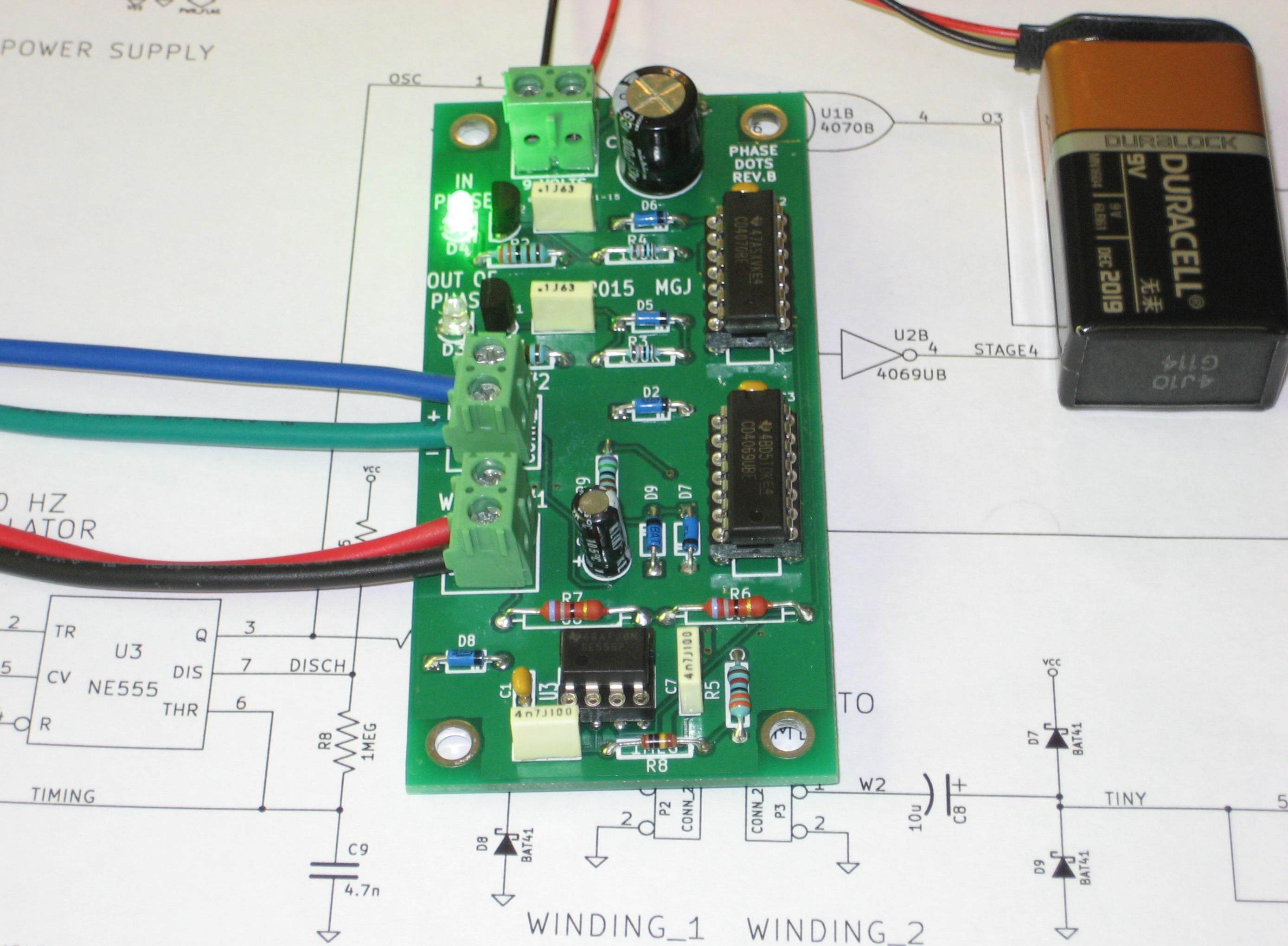

Appendix D of the Quasimodo design note shows how to find the polarity "dots" of a transformer using lab bench test equipment. However, some QM users don't like this method for various reasons.
So, in response to their requests, I've designed and built a little standalone test jig which finds transformer polarity dots using no lab equipment -- just this little test jig and a 9V battery. It's three digital logic chips (555 timer, CD4070 exclusive OR gate, CD4069 inverter gate), a few passives, and two LEDs, as you can see in the picture below. When transformer winding dots are aligned, the green "IN PHASE" LED lights up. When transformer winding dots are misaligned, the red "OUT OF PHASE" LED lights up. Simple and unambiguous.
The schematic, PCB manufacturing CAD data ("Gerber files"), and bill of materials are found in (THIS diyAudio thread). I also have a few kits of PCB + all parts, which I'm selling at my cost.

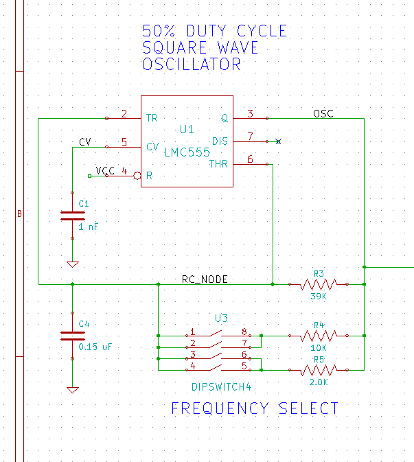

Hello guys! I have just built my Quasimodo. Ordered PCBs from Seeedstudio - perfect quality. But I have a question about film caps C1 & C4. When I was ordering all the parts using BOM from first post, C1 cap (connected to control voltage pin of LMC555) wasn't marked as film, so I bought X7R ceramic 1nF cap. Now, looking carefully at all the pictures of already built Quasimodos I see that most of you use film cap for C1. Does it make any difference if I use ceramic cap instead of film one for C1?
A film capacitor is likely yo have lower esr than the X7R.
This extra damping resistance will have a small effect on the final damping resistance that you measure and then implement.
The difference may be too small to measure and thus can be ignored.
However, if your implementation also uses an X7R, then the measured damping resistor and the esr are BOTH needed to arrive at the optimal damping arrangement.
Can you get the X7R in suitable voltage ratings to suit all your circuits?
Atnegam, the bypass capacitor from 555 pin#5 ("control voltage") to ground, is utterly non-critical. There's disagreement over whether it's truly necessary, or just common folklore / voodoo about 555s. The supposed "reason" why people install it, is to make pin#5 impervious to capacitively coupled noise injection from nearby components. The reason why I installed it, is because I didn't want to listen to whiny people complain about its absence. Any capacitor at all, made of any dielectric at all, with any temperature coefficient at all, will be just fine in that position.
However the timing capacitor from pins 2+6, to ground, is quite a bit more important. This capacitor, called "C4" in the schematic below, sets the oscillator period, along with whichever pieces of R3,R4,R5 are selected by the dip switches. I would recommend using a better-than-average capacitor type for C4. Either metallized film, film, C0G ceramic, or X7R ceramic.
C4 is not super-critical, since the way we actually use Quasimodo only looks at a single waveform edge and not a full period (or many full periods) of the square wave. Therefore, if the oscillator's frequency wanders around*, Quasimodo users don't care. (Indeed they won't even see it). So my suggestion to you is: don't worry about it. Use your Quasimodo and have some fun. Be sure to read the section "Triggering the Oscilloscope" on page 12 of the QM design note.
*perhaps due to C4 variations with temperature, or C4 variations with supply voltage, or C4's value simply drifting up and down over time
