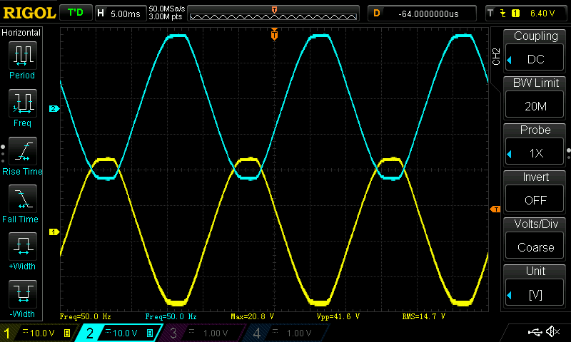

Thanks, Mark! I'll check the values with inductor. As I said, Cx is already in the amplifier - so it wasn't my choice to set Cx so high.

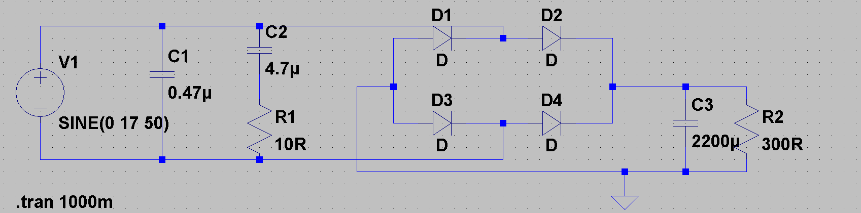

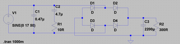

BTW, I'm estimating Rs (R1 on scheme) power dissipation using LTspice scheme attached. Am I doing it right, or should I omit snubber from the scheme completely and place Rs in series with V1 to correctly estimate dissipation?
Because currently simulation gives me values around 6mW, and if I make Rs even lower - dissipation lowers too. So if we know that ζ rises when Rs lowers, why not keeping Rs as low as possible for overdamping? What is the "stop factor"?
If I place Rs in series with V1 in simulation, it becomes current limiter for the smoothing capacitor and so it's power dissipation will be pretty high (lower resistance - higher dissipaton) until capacitor fully charges.

The two extremes for R1 are 0r0 and open circuit.
Neither of these extremes operates as a snubber.

I boldly claim (and you should verify!) that at 50 Hertz, the magnitude of the impedance of C2 is 677 ohms. This capacitor C2 is in series with R1.
You can use Ohm's Law to calculate an approximate value of the current thru these two series elements, when driven by a 17 volt, 50 Hz sinewave. Then the power dissipated in R1 is just
Iapprox * Iapprox * R1
The calculated current is only an approximation, because we ignored the phase angle of the impedance. Fortunately, in this case the error is small and the approximation is very good. The arctangent of (10/677) is a tiny: less than one degree.

Alright, I've checked the Quasimodo with 180µH inductor in place of transformer - calculated ζ=1 Rs and eye-matched Rs are almost identical. So it's working properly even with so large Cx/Cs. Actually I understand that current Cx in amplifier is an attempt of original designers to place a snubber, so if I'm doing my own snubber and calculations are ok - I have all the rights to replace Cx for the one with smaller capacity. But, is there really a good reason to keep Cx/Cs capacity small? So what are the downsides of big capacity Cx/Cs in relation to snubber performance?

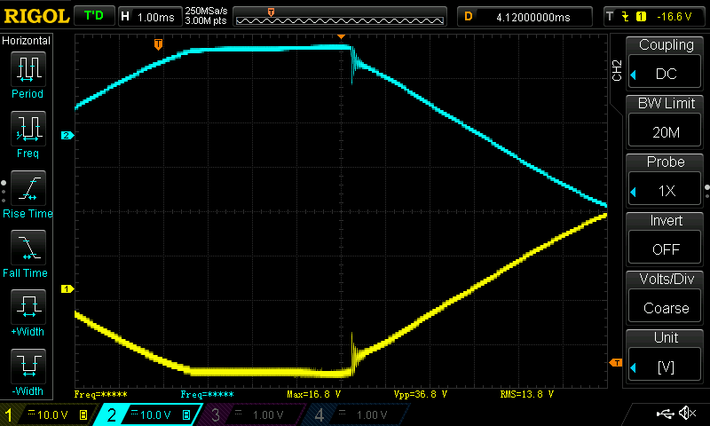

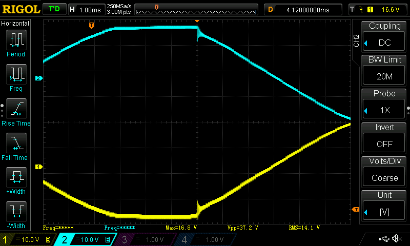

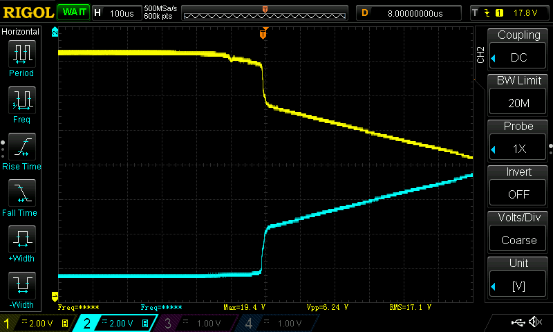

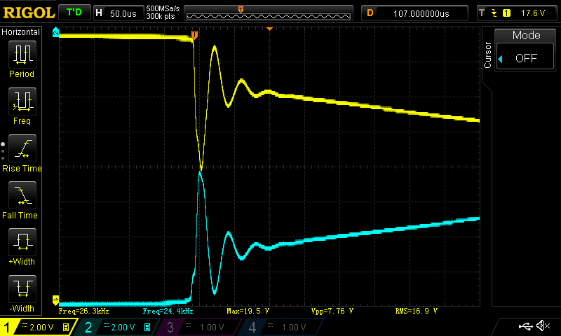

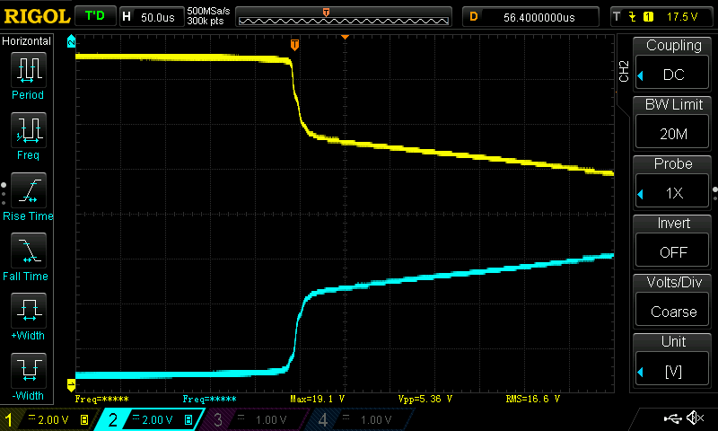

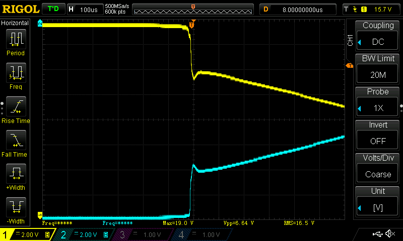

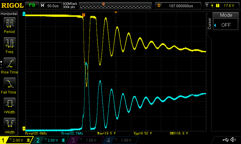

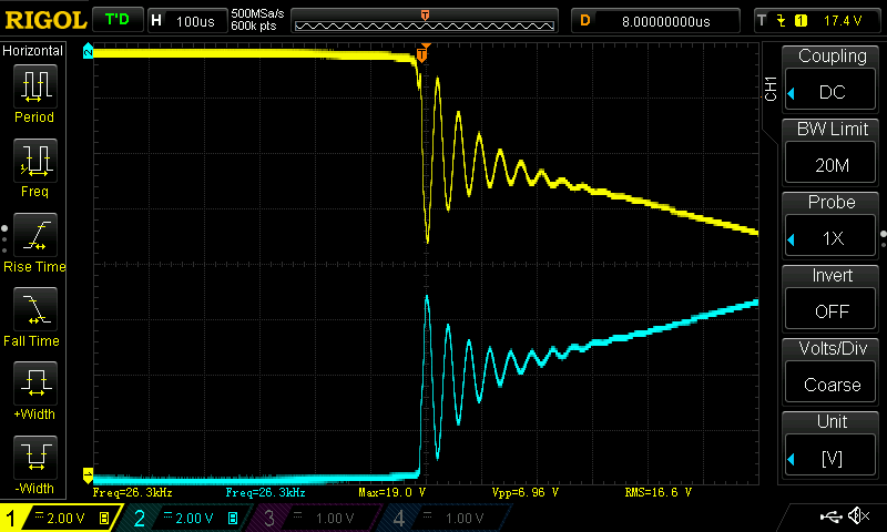

Recently, while helping a colleague from another (non-english speaking) forum determine the value of the snubber resistance for his power supply (PS) I made an interesting observation which I think is worth sharing.
The problem was that the colleague did not have any means for exciting the ringing by external means, i.e. neither Quasimodo nor a function generator, but he possesses an oscilloscope. I suggested doing it in a running power supply, and put together a step-by-step instruction by performing the procedure on an improvised PS utilizing a transformer I already measured with Quasimodo, obtaining Rs=160R for Zeta=0.707 (see my table in post #643 - it is the Triad FS24/800 with two 12V secondaries). In my makeshift PS it feeds an ordinary bridge rectifier to produce a nominal +-12V PS. The secondaries are connected in the center tap fashion, each of them having a Cx=10nF capacitor between the center tap and the respective rectifier bridge connection. The filter section consists of two 1000uF electrolytics.
The first figure shows the waveforms at the respective secondary ends with the PS unloaded. There are no parasitic ocsillations, or rather they are so weak as to be not visible with my scope's resolution. The subsequent figure shows the waveforms when one branch of the PS is loaded with 60mA; the oscillations at the diode shut-off are clearly visible on both secondaries, the spike amplitudes being some 6-7V.
Loading the other half of the PS increases the spikes to about 10V because there is now more energy available for the excitation; the subsequent plot shows the oscillations' details. The resonance takes place at about 26kHz (never mind the scope display, I measured the frequency with cursors placed four periods apart). Comparing this value with the one of 86kHz measured with Quasimodo in the standard setup (the primary and one secondary shorted) this may come as a surprise at first sight, but bear in mind that the two circuit configurations are quite different.

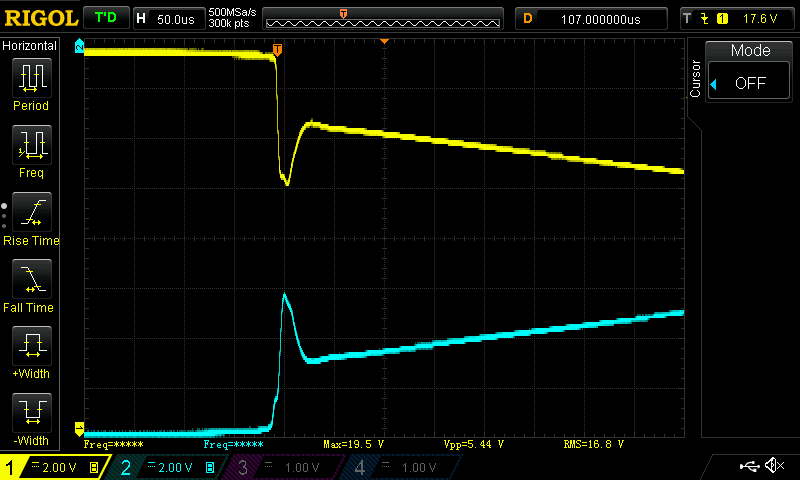

Now I connected a CR snubber (Cs=150nF, Rs=1000R - a trimmer) across one secondary only, and was struck by seeing the oscillations at both secondaries weakened by the same amount (the fifth figure). Once again, it is a snubber across one of the two secondaries attenuating the parasitic oscillation at both secondaries.
Adjusting now the trimmer resistance for the damping factor Zeta=1.0, I obtained the waveforms in the sixth figure; the trimmer resistance at this setting measured 330R, i.e. twice the value obtained with Quasimodo and the primary and one of the two secondaries shorted.
So I had two surprises in this exercise. The first is that a single snubber quenches parasitic oscillations in two connected secondaries; and the second one is that this happens with a larger resistance value Rs than in the idealized measurement, although the latter was to be expected given the lower resonance frequency in the configuration with both secondaries active.
By extension, one could now expect that a single snubber between the two outside legs of a center-tapped secondary may also do the job, and it is indeed so: with Quasimodo I measured Rs=625R for Zeta=0.707 in such a configuration, but I have to scrutinize this result yet, and will describe it in another post.
This behaviour seems to be the case with transformers having two or more secondaries. Last year I determined Rs for a single secondary transformer both with Quasimodo and in a running PS; both values were nearly the same. On the other hand, prompted by the above findings, another colleague from the same forum investigated the PS in his amplifier, consisting of 2x22V secondaries for the power stage, and 2x14V one for the small-signal section. He found that a single snubber across one of the 22V secondaries quenched the oscillations in all four secondaries. Unfortunately, he only posted figures for the 2x22V secondaries, but I might be able to persuade him to repeat the measurements and provide the figures.
What diodes are in the rectifiers?
Would you have a waveform of the original setup, but without the 10nF bypasses on each half-winding?
The rectifier I used in the above test is a Semikron B250 C1500, an ancient (ex-equipment) part that happened to be the first one I saw in the parts box.
While it might be possible to try snubbing a transformer without the 10nF capacitors across the secondaries, I prefer to work with them. The reason for this is that they bring structure into the system, i.e. they swamp out the small capacitances in the power supply, making thus the performance of the latter much more repeatable.
Braca

The extra capacitance produces an oscillating circuit with constant natural frequency; without it the parasitic oscillations' frequency varies with the rectifier capacitance and other internal capacitances, which affects fixing the correct snubber value. And in comparison with the secondary current in operation, this additional current loop is negligible.

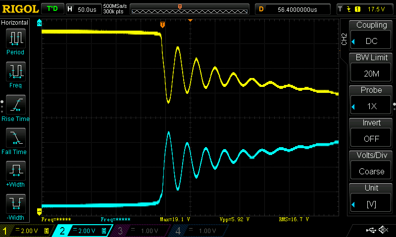

I'm now enclosing the results obtained with two more recitifiers. The first two figures below refer to the measurements made with a W01 rectifier bridge; the first one shows the oscillations with the secondary unsnubbed, and the second one with a 150nF/760R snubber across both secondaries at a load of 94mA each. Both secondaries appear to be correctly snubbed.
Since in the Mark's paper in Linear Audio Vol. 10 the 1N4005 came out as the worst of the "terrible" diodes in the 1A current group, I tested the Triad transformer with a bridge made up of four 1N4004 diodes.
The results are shown in the three figures that follow, the first one referring to the configuration without snubbers, the second one snubbed with 150nF/680R across both secondaries, and the third one snubbed with 150nF/170R across a single secondary.
Both secondaries appear to be correctly snubbed in the above two configurations. However, the Zeta value in the last plot is a little lower than in the second one (150nF/680R) because at Rs lower than 170R, the Cs capacitor starts becoming a part of the oscillator and ringing starts appearing at the frequency determined by (Lt, Cx+Cs),
The above method of snubbing appearrs to work with this transformer. I don't know whether it would work with other transformers, but I intend to look into this matter further. The next step will be to repeat the measurements with another transformer with two secondaries.
