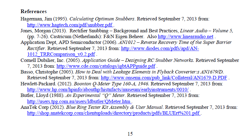

.. in the paper by Hagerman (referenced by Mark in an earlier post)
Hagerman's paper is Reference #1 in the Quasimodo design note. In the .pdf file it's a hyperlink, so when you're reading the design note you can click on reference 1 and boom! your browser opens up Hagerman's paper. This computer stuff is magical.
(It's NOT a hyperlink in the screen capture image below; this image is merely a copy of the pixels, but not the magic.)
