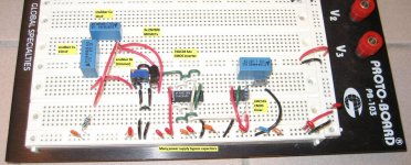

You can build a temporary "CheapoModo" (link to thread here) , even on a solderless breadboard. See image below. That's the first prototype of CheapoModo and it worked quite well. It took about 1.5 hours to assemble, including cutting and stripping all of the hook up wires.

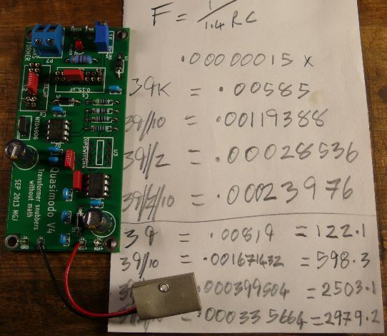

Okay, I've read through the relevant files, built it, did the math, thought about it, read over 500 posts about it (and I don't think I missed the explination), but still, I don't get it. Why a 4 switch DIP when a 2 switch would have done the same? Why have besides the all switch off 120Hz option, also the 600Hz, 2500Hz and 3000Hz options? If the 120Hz is suficient for anything I might want to do with this, then I will just leave the DIP switch out like it is now. So........... Mark, what were your original reason(s) why you included the DIP switches.
Think about it for a while. If you'd rather not think, if you just want somebody to tell you the answer, it's there among the first 49 posts in the CheapoModo discussion thread.

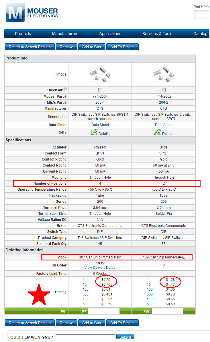

About DIP switches: I prefer the gold plated contact types. Here they are at Mouser Electronics (attached). Which of these would YOU use in a Quasimodo ThruHole board?
