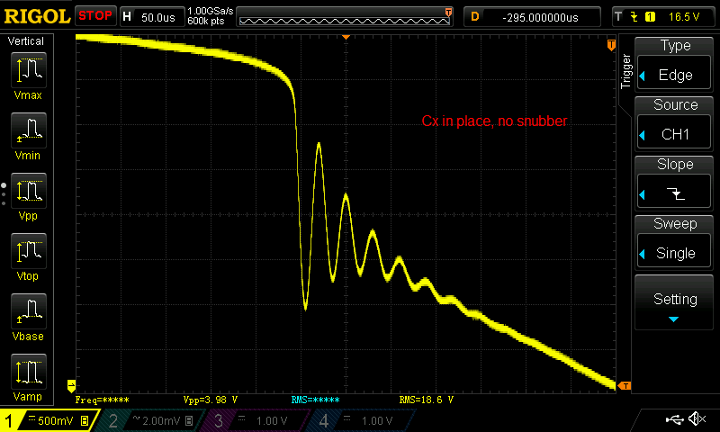

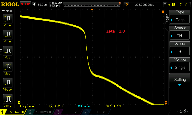

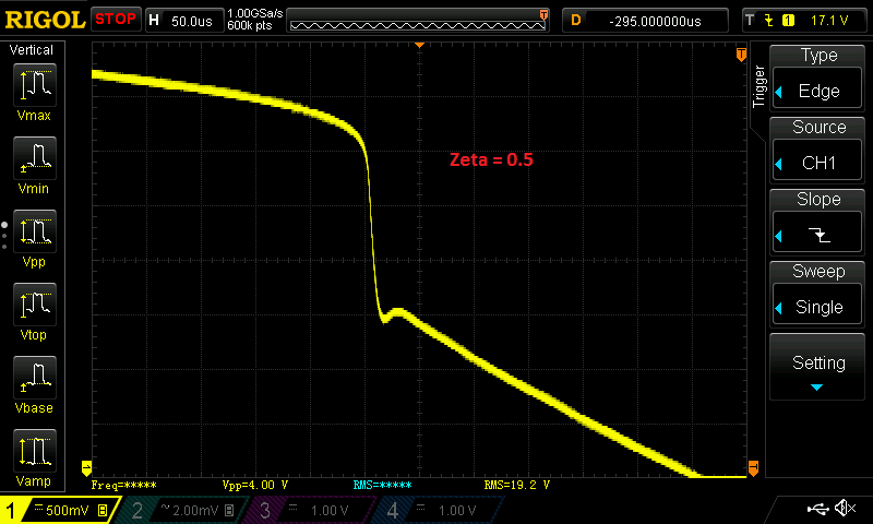

Just for illustration, I'm attaching waveforms for different values of Zeta, measured in a working power supply. Referring to the Excel table in post #486, it is the entry in row 11, i.e. a simple wall plug, 12V/500mA power supply, loaded for the measurement with a 330R resistor (approx. 50mA).
The snubber configuration used is Cx=10nF, Cs=150nF, Rs,max=1K.
The first plot shows the waveform at the transformer secondary with Cx in place, but without snubber; it rings, as expected.
The following three plots refer to the Zeta values of 0.5 (Rs=487R), 0.707 (Rs=340R), and 1 (Rs=239R), respectively. At Zeta=0.5, the secondary is not yet quite damped, whereas the waveforms at Zeta=0.707 and 1.0 indicate a properly damped behaviour, and are almost indistinguishable from each other. This speaks in favour of choosing Zeta=1 as the criterion for determining the snubber resistance, since it trades a negligibly higher loss for robustness in the snubber design.

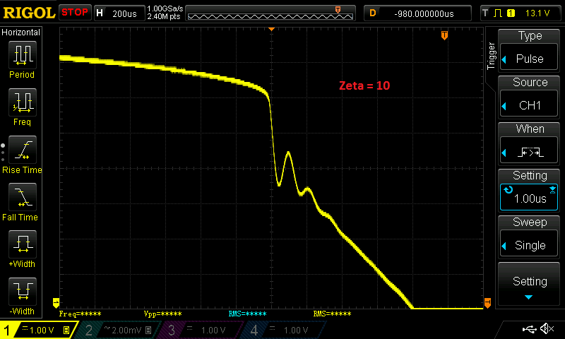

If anyone intends to fool around with CRC snubbers at zeta>1.0 (outside the recommended range of "Simple no-math transformer snubbers"), I strongly suggest you slog your way through the Laplace domain math that includes all three of Cx, Rs, Cs. Sorry, the no-math approach includes a few simplifications and one of these is that zeta is around 1.0. Hagerman's snubber paper shows one possible approach to writing out the appropriate equations.
I predict that after a few pages of algebra, you'll conclude that oscillations do not remain damped unless (Cs >= (15 * Cx * zeta)). For "no-math snubbers" having zeta=1, this simplifies to (Cs >= (15 * Cx)) and indeed the Quasimodo starting recommendation is Cs=150nF and Cx=10nF ... a factor of exactly fifteen.
However, if for some inexplicable reason you wish to explore zeta >= 10, you won't get the overdamped non-oscillations you expect unless you set (Cs >= 150 * Cx). Depending on your own personal inventory of low dissipation factor (tan δ) film capacitors in your parts box, that might be {Cx=10nF, Cs=1.5uF} or, more likely, {Cx=2.2nF, Cs=330nF}.
could you generate the Zeta = 10 plot and post?
Andrew, even without performing a measurement at Zeta = 10, the response of the circuit can easily be predicted. Since the Hagerman's theory produces Rs=23R in this case, which effectively leads to Cs being connected parallel to Cx, the system will oscillate at the natural frequency defined by (Lt, Cx+Cs). In this particular case, this frequency is approx. 8550Hz. The ringing will be damped by the sum of the secondary winding resistance and Rs, and by whatever other dissipation mechanisms that may be present.
For the fun of it, I'm enclosing an oscillogram of this configuration. The period of the single oscillation visible is roughly the half of the 200us time base interval, which comes close to the above mentioned value of 8550Hz.
So the response is not damped, as Mark rightly points out, because it is not the same system any more, i.e. the one composed of (Lt, Cx).
Braca

DnI, why not run your test with Rs=23R, Cx=10nF, Cs=1500nF? This will show what a severely overdamped (zeta=10) waveform actually looks like. {any Cs >= 1.5uF will be equally good}
The label in your post #504 photo might be a little misleading; the experiment is not really "zeta=10" , but rather "Rs=23".
Braca

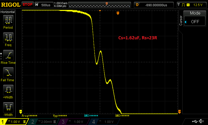

Apologies first: Due to a typo, the secondary winding resistance of the transformer used for the current discussion is 18 ohm instead of the correct value of 1.8 ohm. The error has almost no effect at low damping values, but 18 ohm is a lot of damping in the "Zeta=10" case. I'm enclosing a corrected version of my Excel spreadsheet. Please discard the previous version.
Re. the above label on my plot: There is nothing in the theory that forbids setting Zeta=10 as long as the circuit structure remains the same. Since, however, at Rs=23R the circuit structure is a tank with (Lt,Cx+Cs), i.e. not any more the one with (Lt,Cx), Rs=23R with Cs=1.62uF I used for the measurement. So my labeling the plot with Zeta=10 is misleading.
The above damping factor value, i.e. 0.375, entered temporarily into cell G3 of the spreadsheet along with Cx=1.62E-6 in cell C3 results in Rs=22.7R in cell J11. Please dont't forget to restore the original values in cells C3 and G3 after finishing this exercise!
A measurement with Rs=23R and Cs=1.62uF does indeed produce an undamped waveform that is to be expected from these values. Results similar to the measured one are also obtained from the LTspice simualtions of the Cheapomodo and the power supply I used for the measurement.
In conclusion, there is no reason to go for high Zeta values when designing the snubber. Zeta of about unity provides ample damping of the parasitic oscillations at rectifier diode's switching off without the risk of waking up the sleeping dog at (Lt,Cx+Cs).

Another apology:
The 2nd paragraph of my above post is incomplete. It should have read:
Re. the above label on my plot: There is nothing in the theory that forbids setting Zeta=10 as long as the circuit structure remains the same. Since, however, at Rs=23R the circuit structure is a tank with (Lt,Cx+Cs), i.e. not any more the one with (Lt,Cx), Rs=23R with Cs=1.62uF I used for the measurement result in a damping factor of 0.375 at the new natural frequency of 2663Hz. So my labeling the plot with Zeta=10 is misleading.
