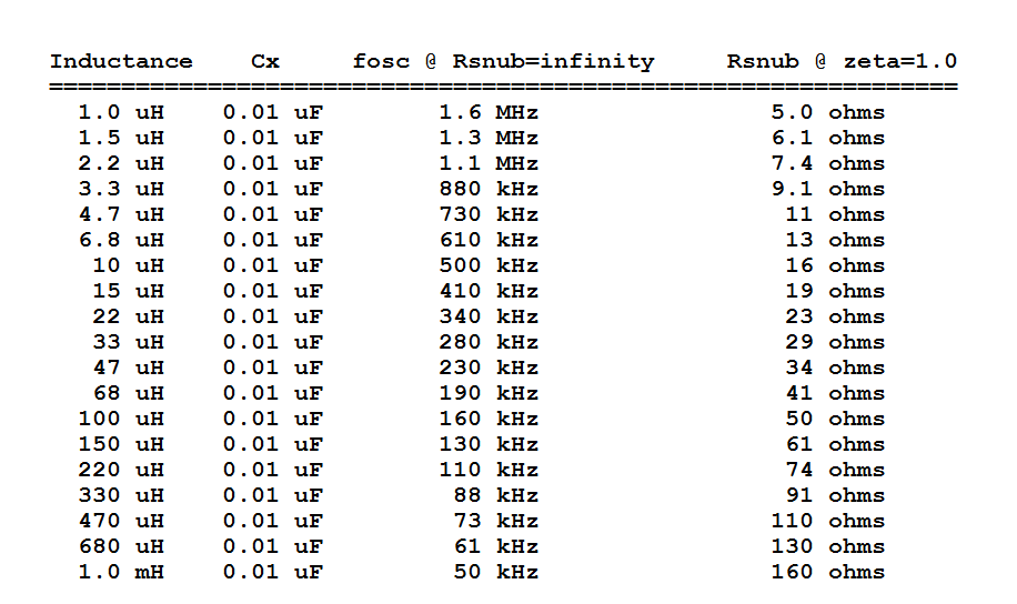

To assist readers who find equations and Greek letters a little daunting, I've made a table of worked examples including the correct answers, below. Try two or three of these yourself, to make sure you're punching the buttons on your calculator correctly. Be sure that when you plug these values into equations (A.10) and (A.11), the answer that pops out of your calculator agrees with the answer in the table. Then you're good to go: plug in YOUR values from YOUR inductor experiment and punch the calculator keys the same way.
(You could also use it as a lookup table, which avoids equations and calculators entirely. But that would be lazy and nobody who builds a Quasimodo is lazy!)
You may notice a couple of repeating patterns in the table of numbers below. That's not a surprise or a coincidence, that's just plain old math.

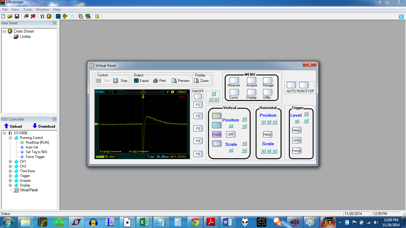

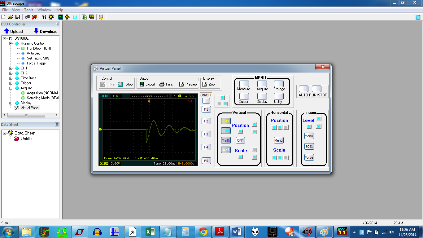

Thanks Mark!
I have a question though, about #3. I don't know what to look for to see zeta=1 when viewing the chart.

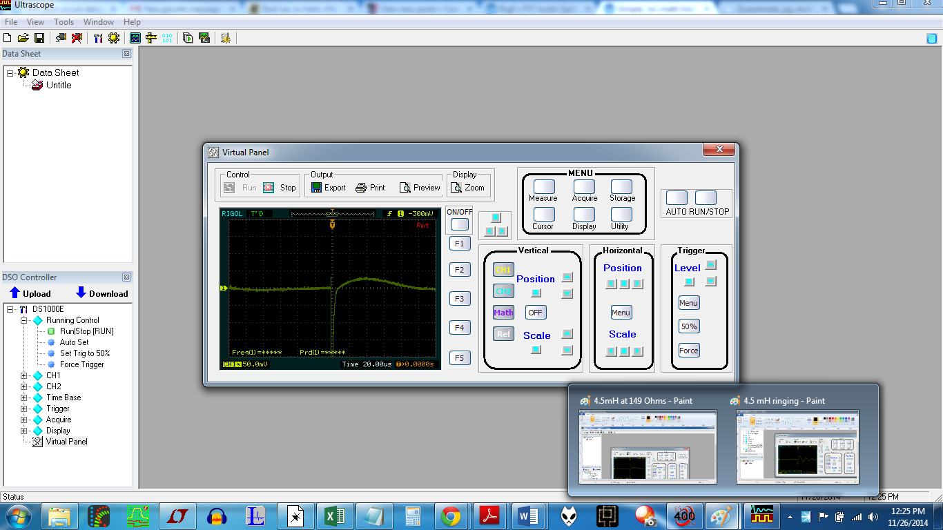

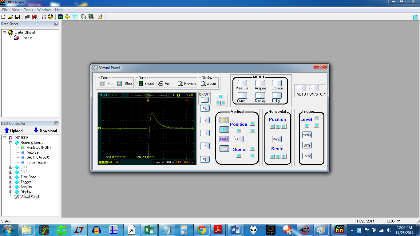

I used a 4.5mH inductor (Erse super-Q) for this test. And I was able to reproduce your numbers in a spreadsheet, so I calculated the value for the 4.5mH inductor. The scope gave me the ringing frequency ( fosc ) = 25KHz.
I took four snapshots. The first is the ringing. Note the scale and the frequency. Note also that the scale is 50mv for shots 2,3 and 4.
The second is at the calculated Rsnub for zeta = 1, being Rs=353.43 ohms
The third shows Rs= 246 ohms
The fourth shows Rs =149 ohms
Why would we not choose one of these lower values?

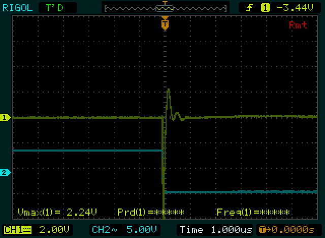

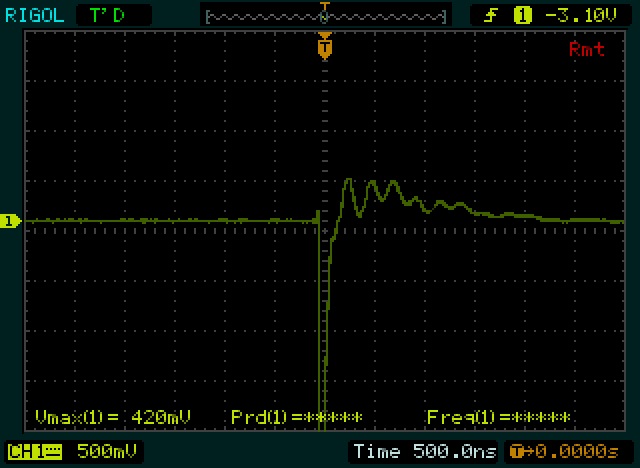

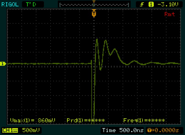

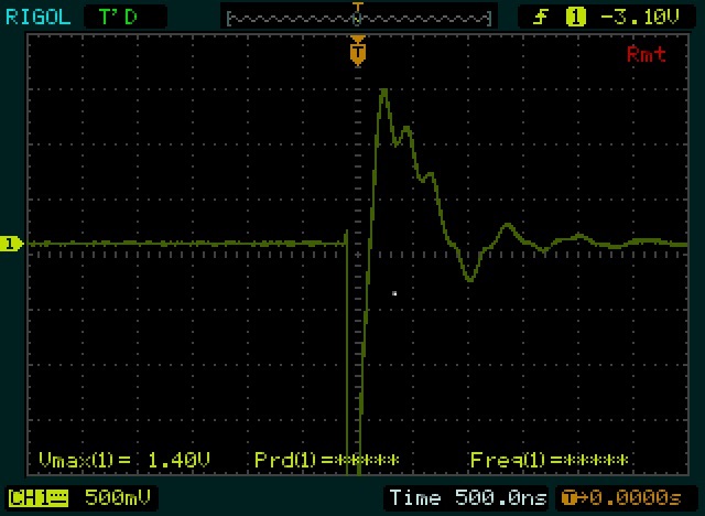

Hmmm seems to be less than perfect.
The shots are of three implementation of snubbing. The second shot is quasimodo dealing with the parallel secondaries with the snubber designed for a single secondary.
The third shot was taken after a second snubber was added. Rs=15, Cs=150nf, Cx=10
The first is using Quasimodo on the paraellel secondaries.
Here, quasimodo says go with 1/2 of the Rs value for a single CT/secondary winding. So, that is what I shall do... This is being treated like the parallel secondary case, and quasimodo is ringing out both.
