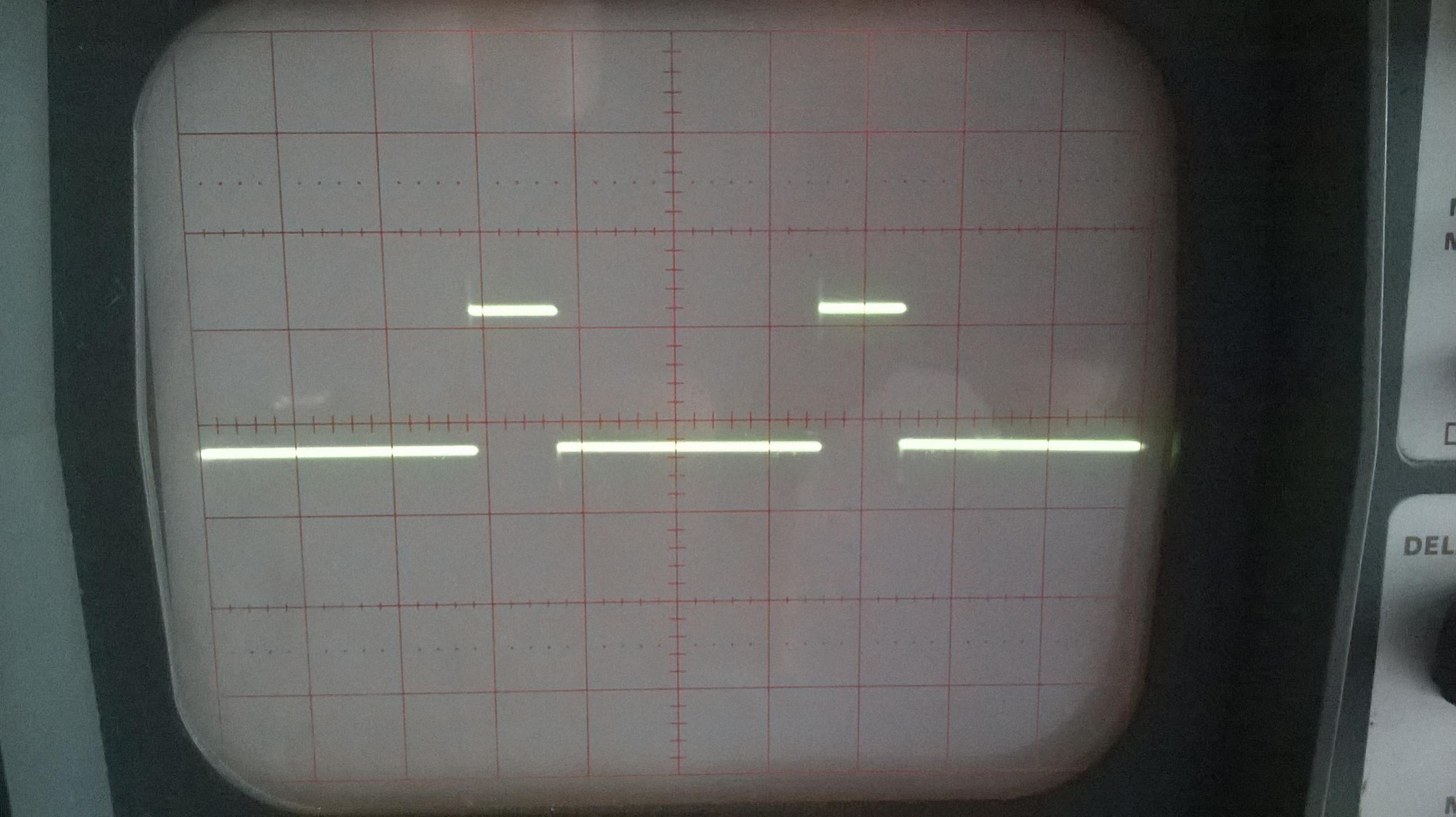

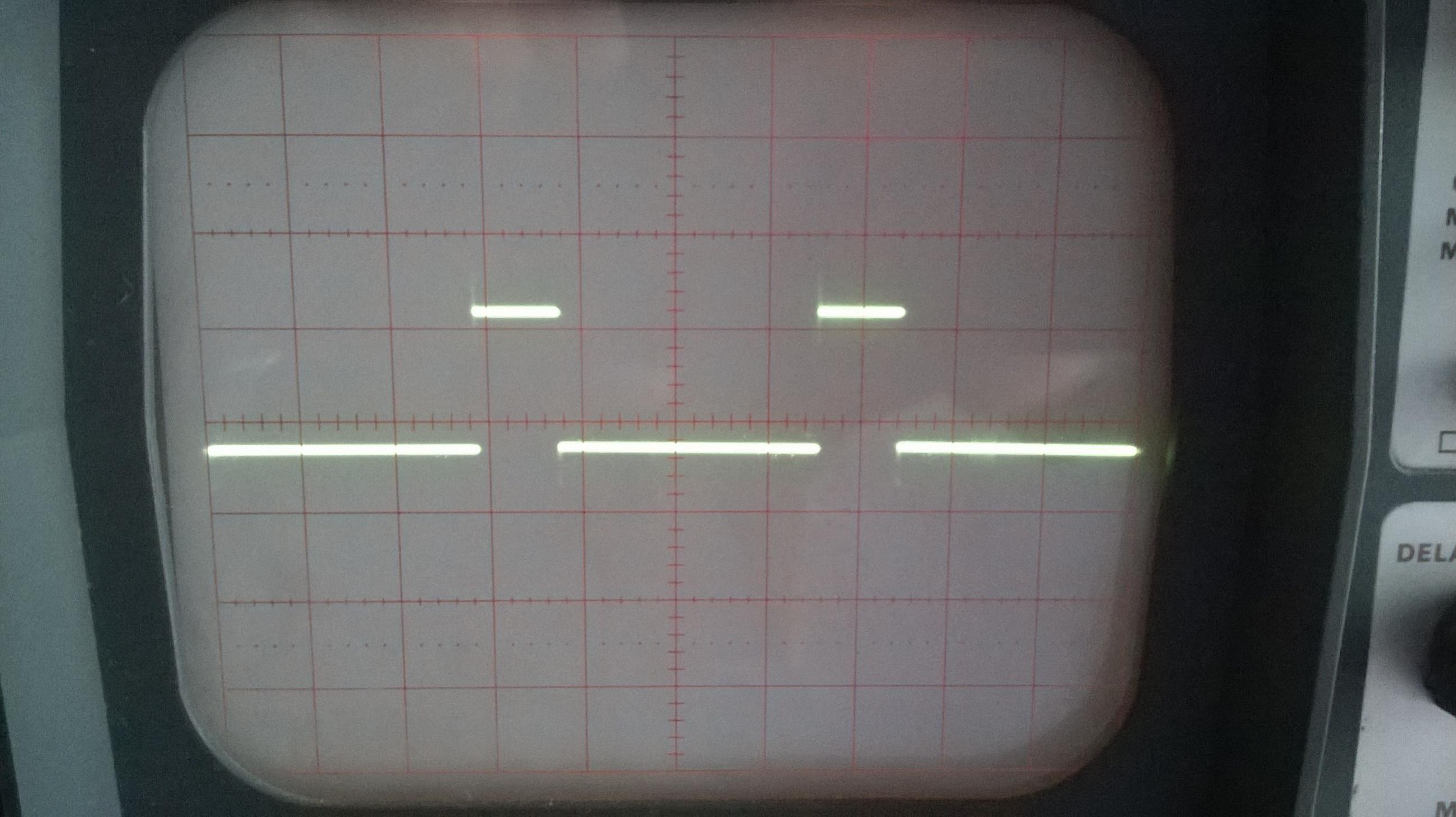

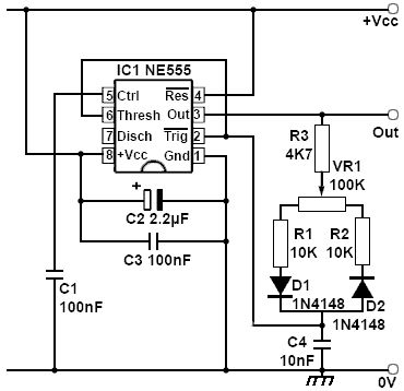

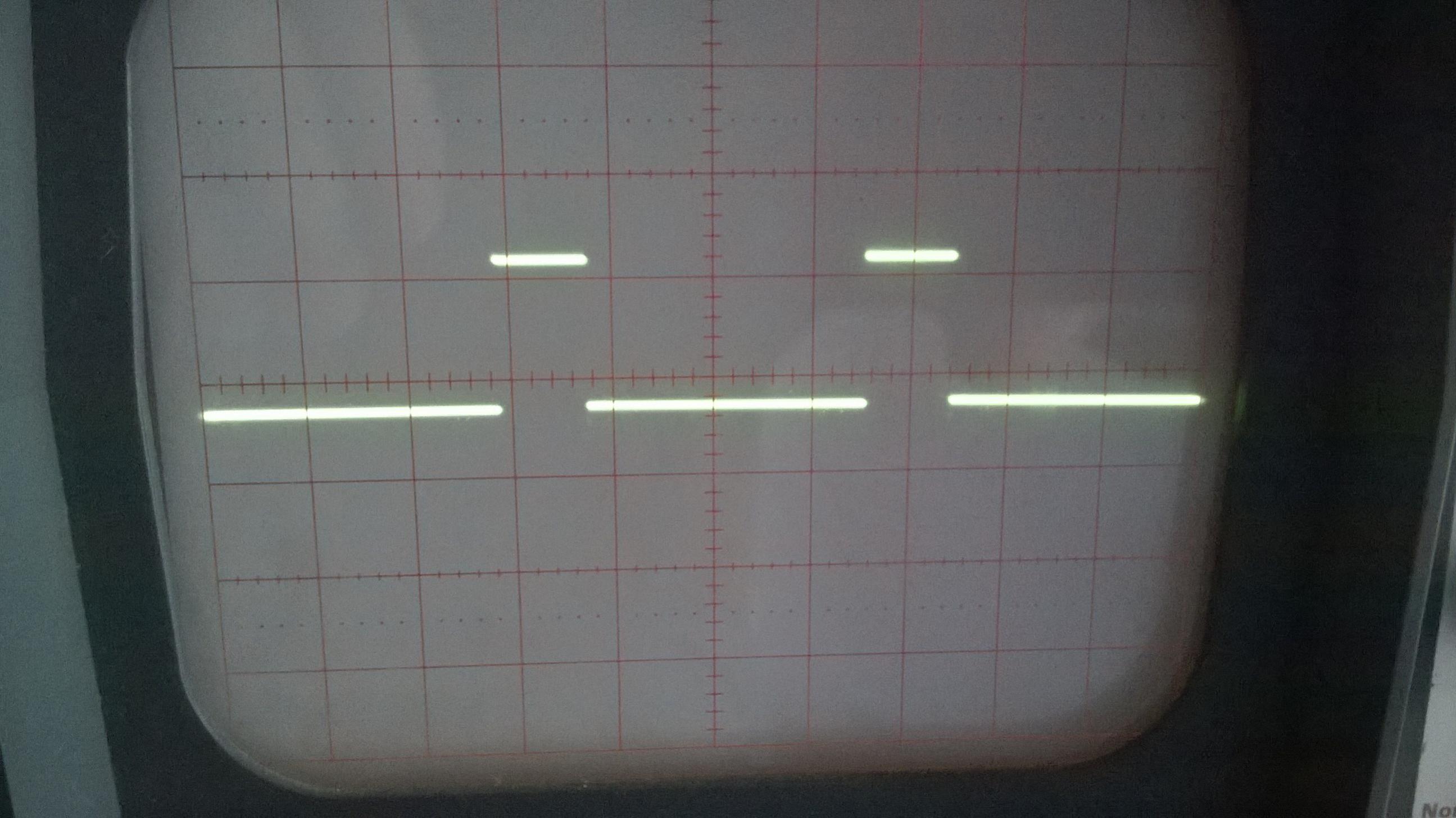

Looking for the right transformer polarity, attached pics left to right:
1st pic schematic used
2nd pic scope probe direct to NE555 astable output (not connected to transformer).
3rd pic scope probe to undotted secondary transformer, signal connected to
dotted secondary.
4th pic scope probe to dotted secondary transformer, signal connected to undotted secondary.
What I'm missing or I'm doing something wrong (primary transformer is shorted also the 2nd secondary is also shorted.
TIA
Felipe

You need to learn about transformer polarity "dots". Among the many search hits that Google provides, you definitely need to study
