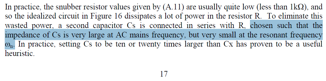

The Quasimodo design note briefly mentions the Cs requirement (@ zeta=1), in appendix A:

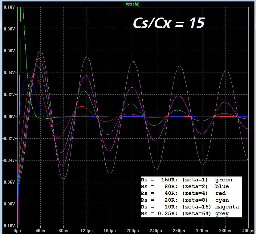

Anyone can demonstrate to themselves quite readily: it's possible to overdamp the transformer as much as you wish. All you need to do is put together a small simulation and varying the damping factor zeta (by varying the damping resistor Rs). A particularly handy set of parameters, which gives integer resistor values and integer damping factors, is (Cx=10nF, Cs=150nF, Ltrafo=1024uH).
Vary Rs while keeping Cs constant (@ 150nF); you'll get a plot that looks like this:
438277d1410627320-simple-no-math-transformer-snubber-using-quasimodo-test-jig-badly_chosen_cs.png

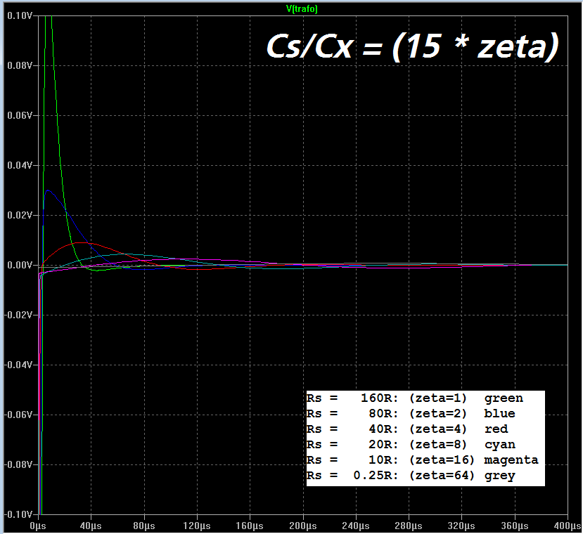

Then vary Rs while also varying Cs; you'll get a very different plot, similar to:
438278d1410627320-simple-no-math-transformer-snubber-using-quasimodo-test-jig-well_chosen_cs.png
Notice that the second plot overdamps the transformer secondary tremendously (zeta = 64!!), yet the transformer secondary does not ring. It's possible to overdamp the transformer as much as you wish.
Mathematically inclined readers will, at this point, be screaming at their computer screens: OF COURSE!! The second order differential equation does not lie: wildly overdamped (zeta>60) solutions do exist, just as DiffEq textbooks have said for the past 100 years. To see this with greatest clarity, remove the stupid power-saving kludge (Cs); replace it by a short circuit. Voila, any damping factor zeta>>1 you wish, with no ringing whatsoever. Now reinsert Cs but do not forget that its job is to approximate a short circuit, and don't be a blockhead.

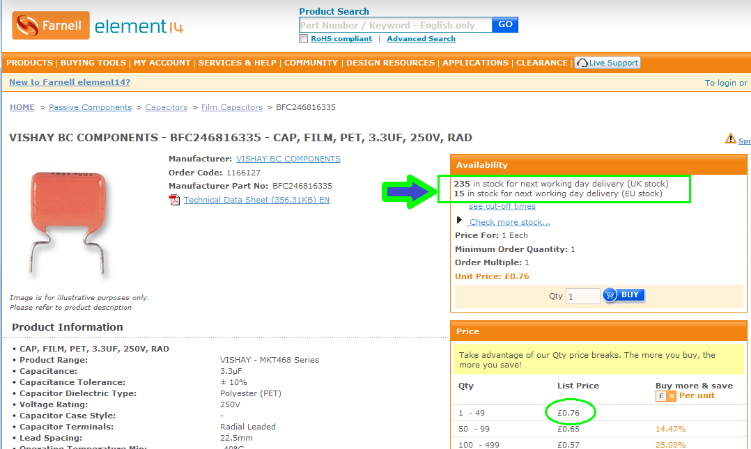

  • Using Cx = 0.01uF, Cs = 0.15uF, find the value of Rsnub which gives the zeta=1.00 snubbed waveshape shown in post #143 (Dec 2013). Write down (Zeta = 1 at Rsnub = _your_resistor_value_)
  • Remove Cs and replace it with a 3.3uF film capacitor such as the one shown in the attachment below. Using Cx = 0.01uF, and Rsnub = (the resistor value in step 1), verify that you get the same zeta=1.00 waveshape as in step 1. Now remove the Rsnub trimmer from its socket, connect it to your ohmmeter, and dial the trimmer to get (0.2 x the resistor value in step 1). You are reducing the value of Rsnub by a factor of 5. Put the trimmer back in the CheapoModo socket and look at the waveform with this new Rsnub. Cowabunga! No ringing. Your CheapoModo is running at zeta=5 and there is no ringing. {You are operating at Cs/Cx = 3.3/0.01 = 330}
