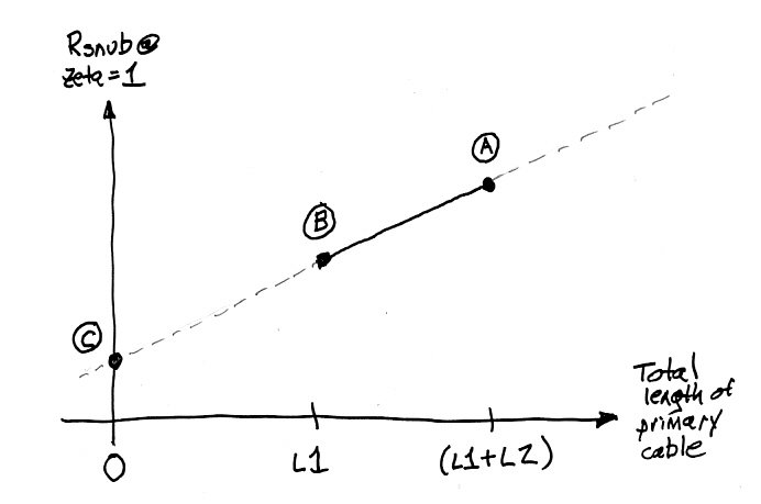

After considering the Barometer Problem for a while, the verb "extrapolate" might pop into your head, suggesting the following plan:
1. Short the plug, connect to Quasimodo, adjust for Zeta=1 damping. Measure Rsnub. This is measurement "B".
2. Connect an "extension lead" (extension cord?) to the power cord. Now the cord is longer. Short the plug, connect to Quasimodo, adjust for Zeta=1 damping. Measure Rsnub. This is measurement "A".
3. Plot Rsnub versus total lead length. Extrapolate on the plot to Length=0. This is point "C".
4. Ask and answer the question, "Just how confident am I, in this result?"

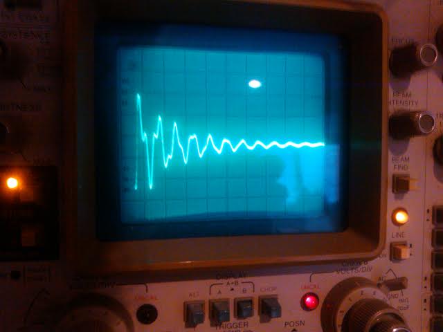

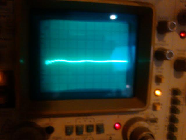

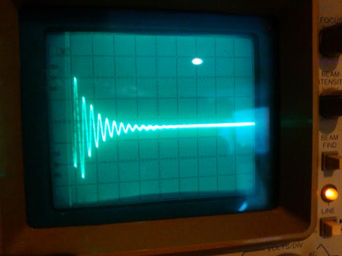

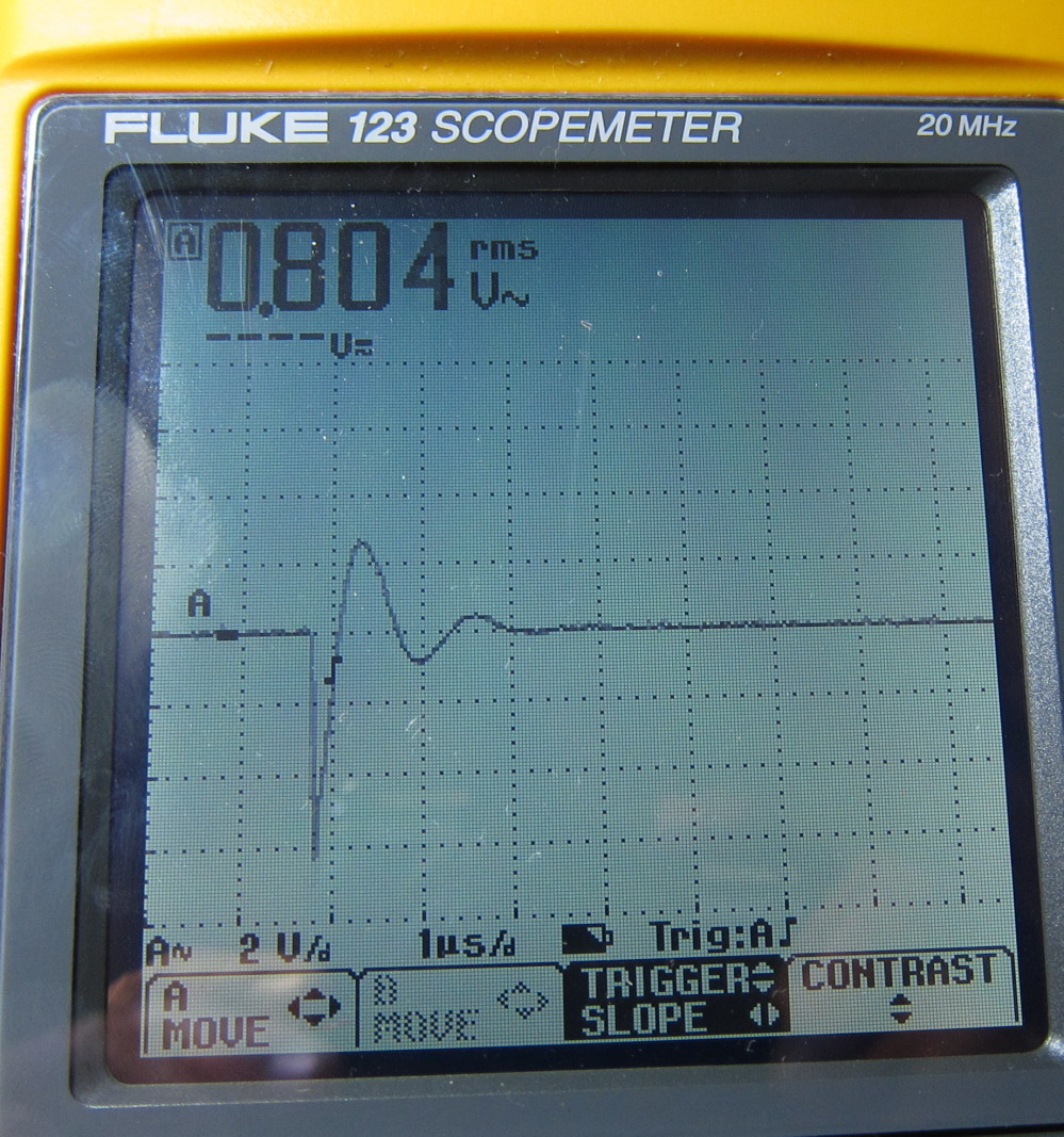

Three shots. The first is 18.5 ohms. It's 0.2 V/Div. The second is 0 ohms at 5 V/div, the final is infinite ( no trimmer ) at 5 V/div.
These are all B channel, having triggered on A channel.
What confuses me is the dead short. Unfortunately, I did not photograph it at 0.2 V/div, and my daughter just left with her cell phone....
This toroid has five CT secondaries in parallel. For this test, they were wired with the one secondary connected to the CT. They all seems to ring together.
It's kind of a shame that your first experiment with Quasimodo didn't give a clear and unambiguous answer to the question "Does my Quasimodo board work correctly? Is mine stuffed and soldered erroneously?"
Maybe you can dream up a test protocol that would validate or invalidate your QM board, without the confounding presence of five parallel center-tapped secondaries.
I've ordered a new scope, as this one is a POS. It took HOURS to get those pics.
I suppose, the best way to test is one secondary at a time, but I'm not going to use it that way.
The A channel shows a nice impulse, and the CT is shorted to the unused secondary. Let's wait until the new scope arrives. This one is a pain.

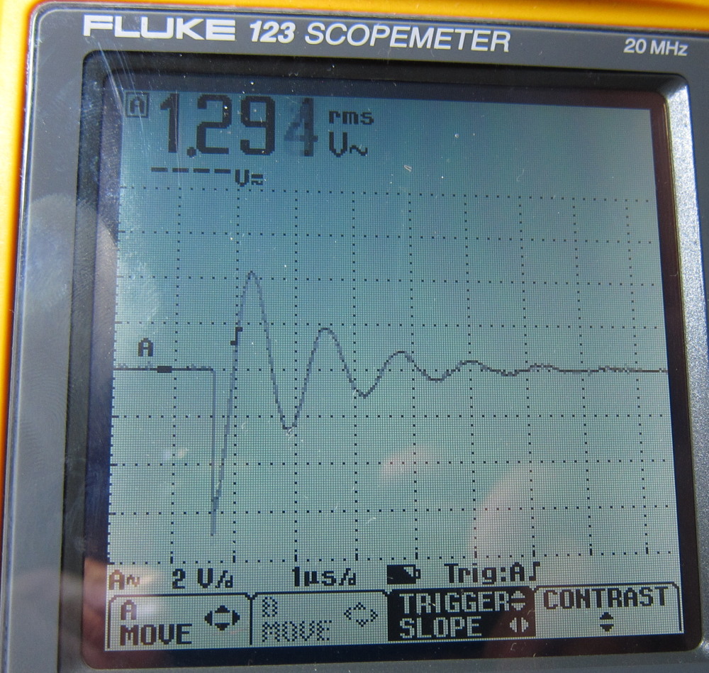

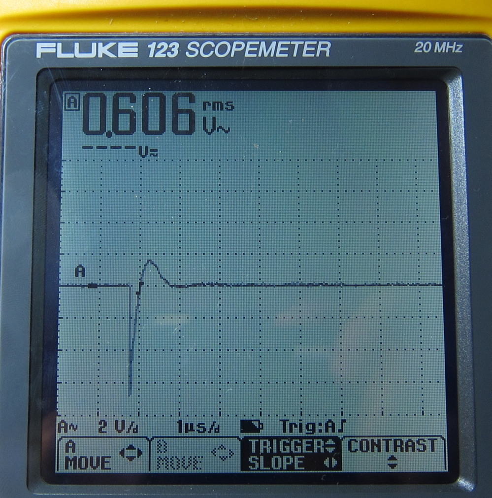

I recently bought a v4 board and kit of parts from dsolodov and threw together a kit. It works great. Thanks to Mark for the clever design and for sharing it with all of us.
To test it out, I grabbed an Antek AS-0512 toroid that I recently bought. It's a 50VA transformer with dual 120v primaries and dual 12v secondaries. I shorted out the two primaries and one of the 12v secondaries and then tested things with the ringer. I used 10nf for C2/Cx and 150nf for C3/Cs. The pictures below show with the damping resistance open, 56ohms, and 22ohms. The optimal Rs seems to be 22ohms. I was also interested in what happens without Cx. So I used a 330pf cap for C2 and also changed C3 to 22nf, which is a value I've often used in the past. Optimal Rs for this case was ~88ohms, but it wasn't as clean as when using the larger Cx.
---Gary
