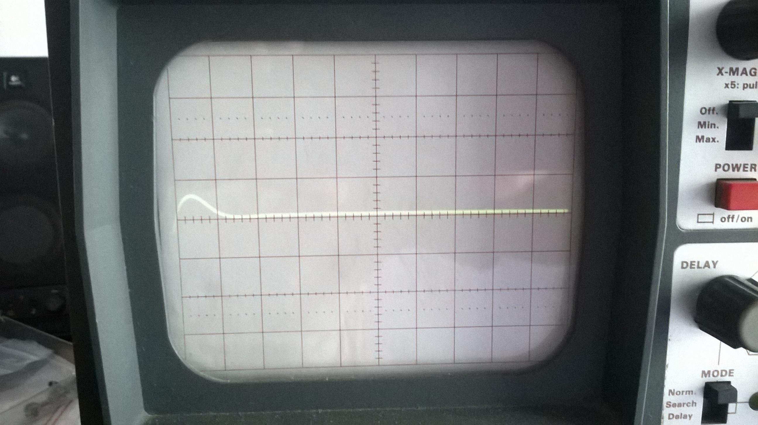

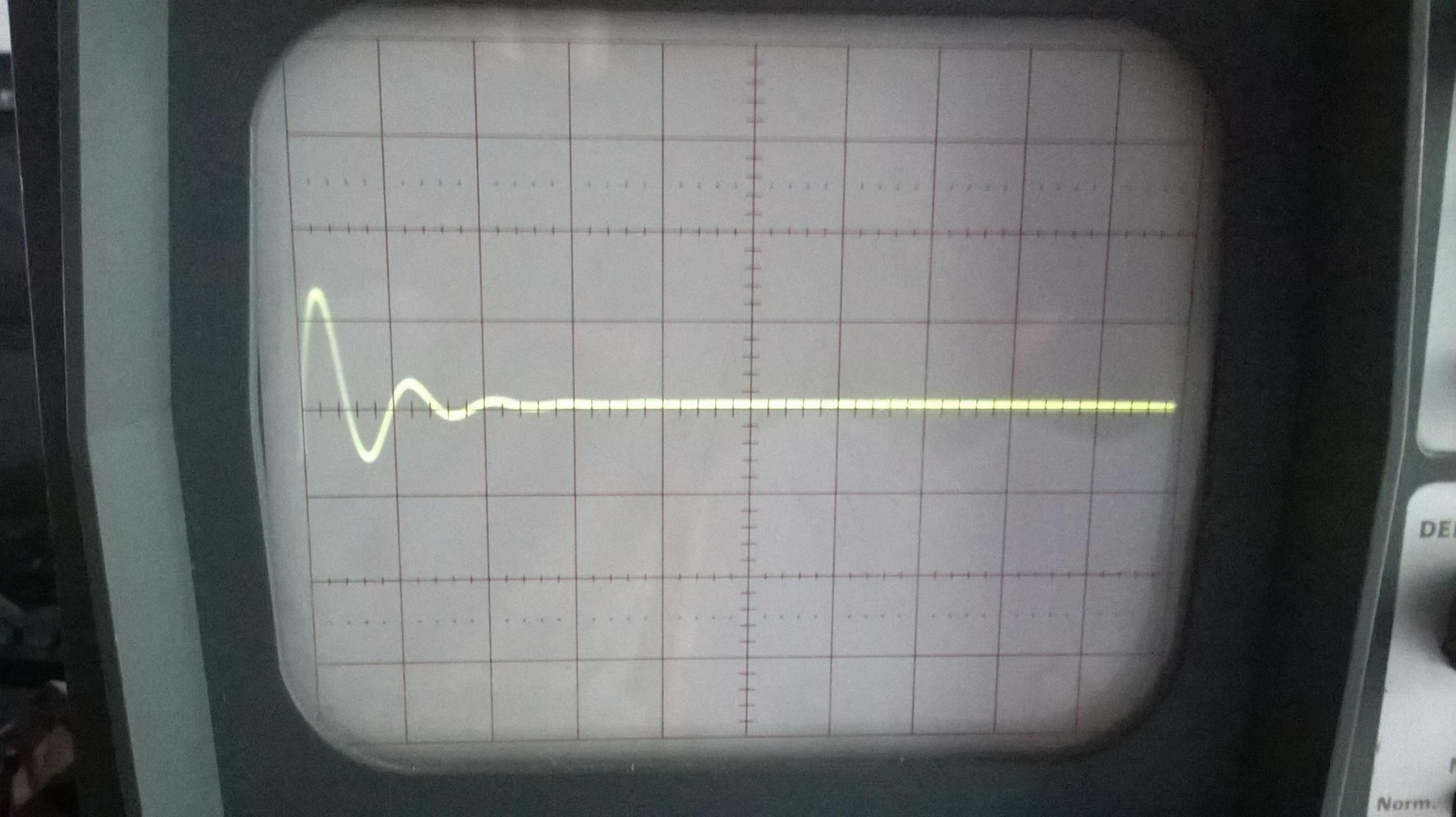

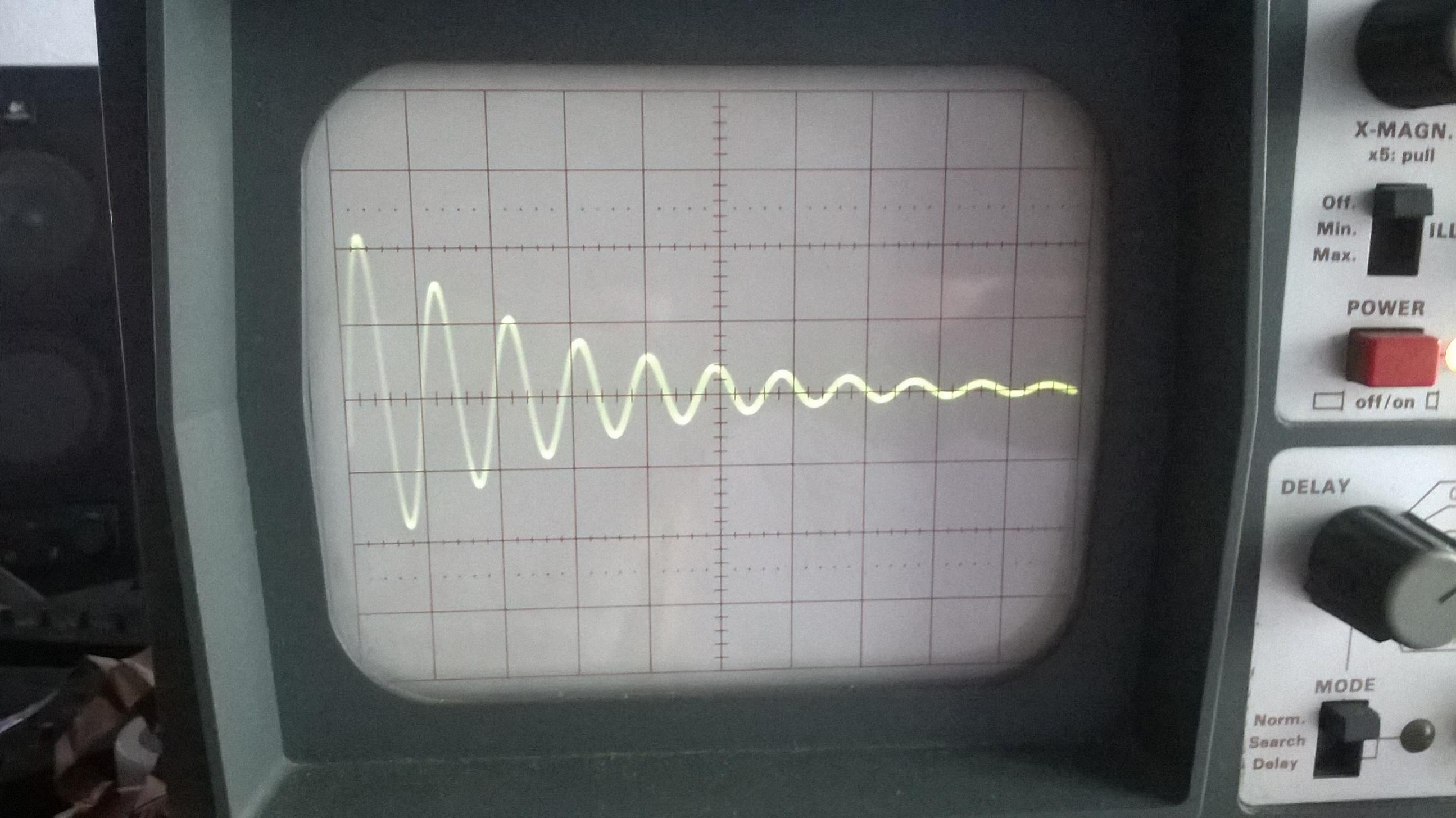

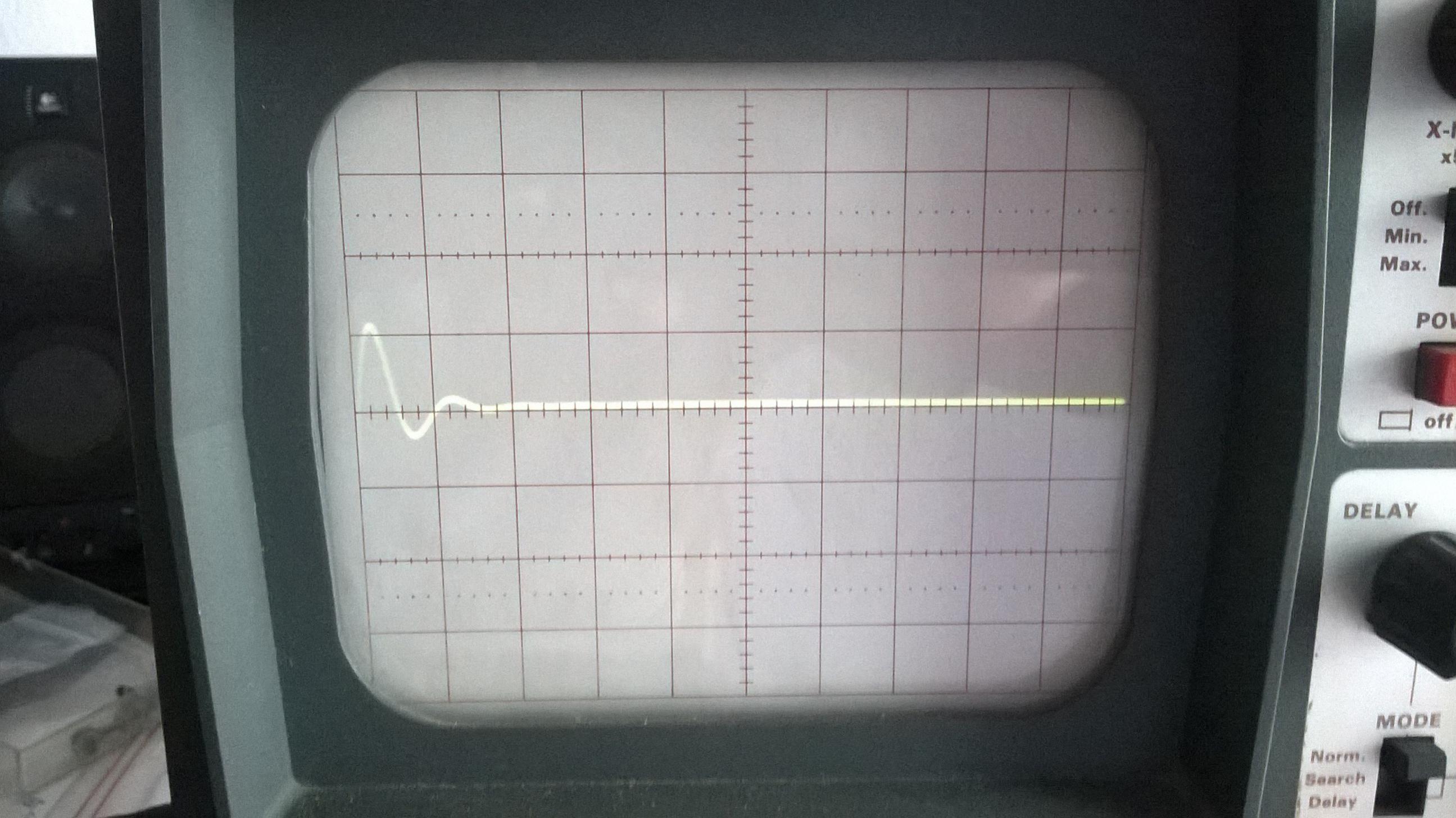

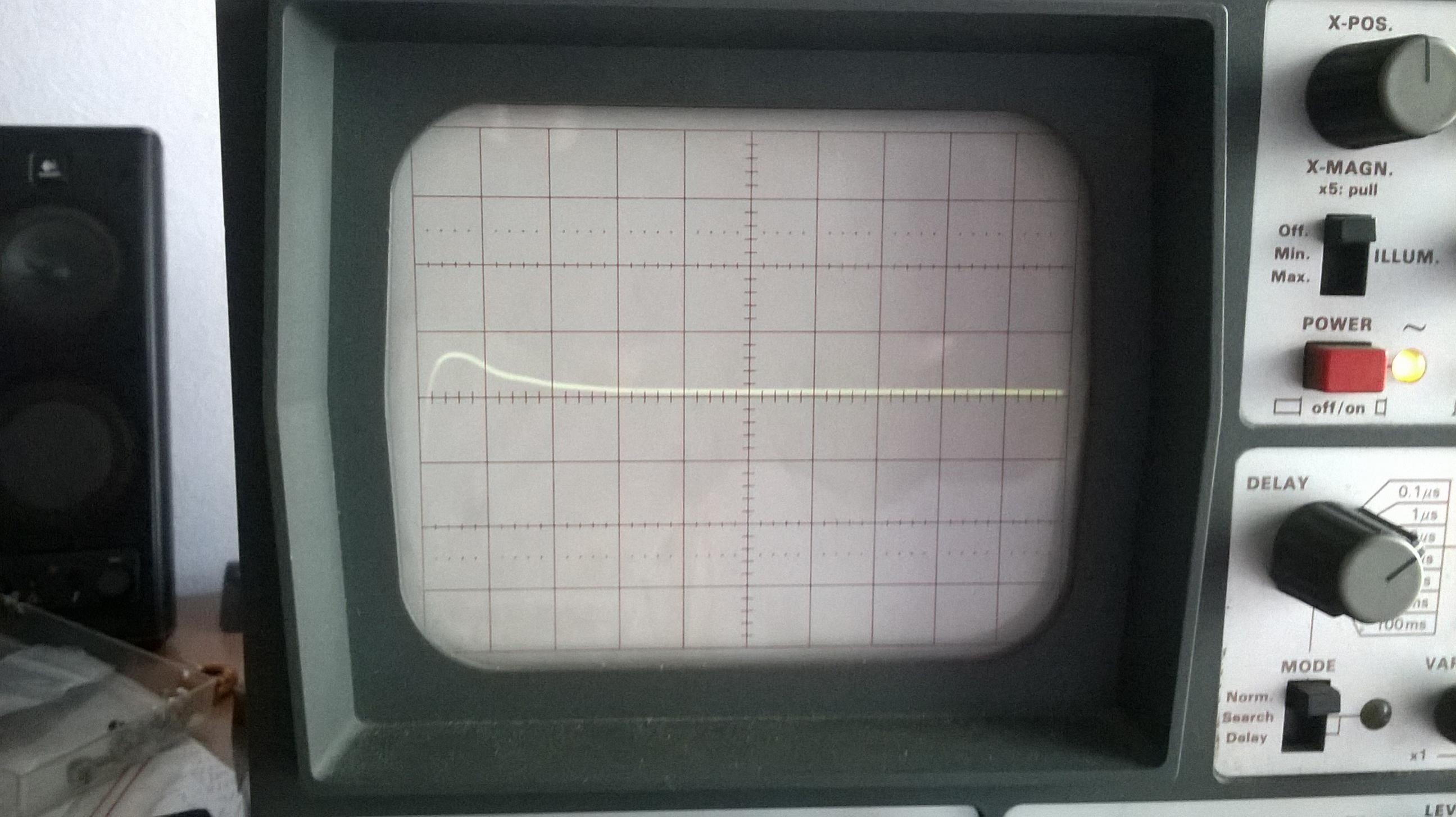

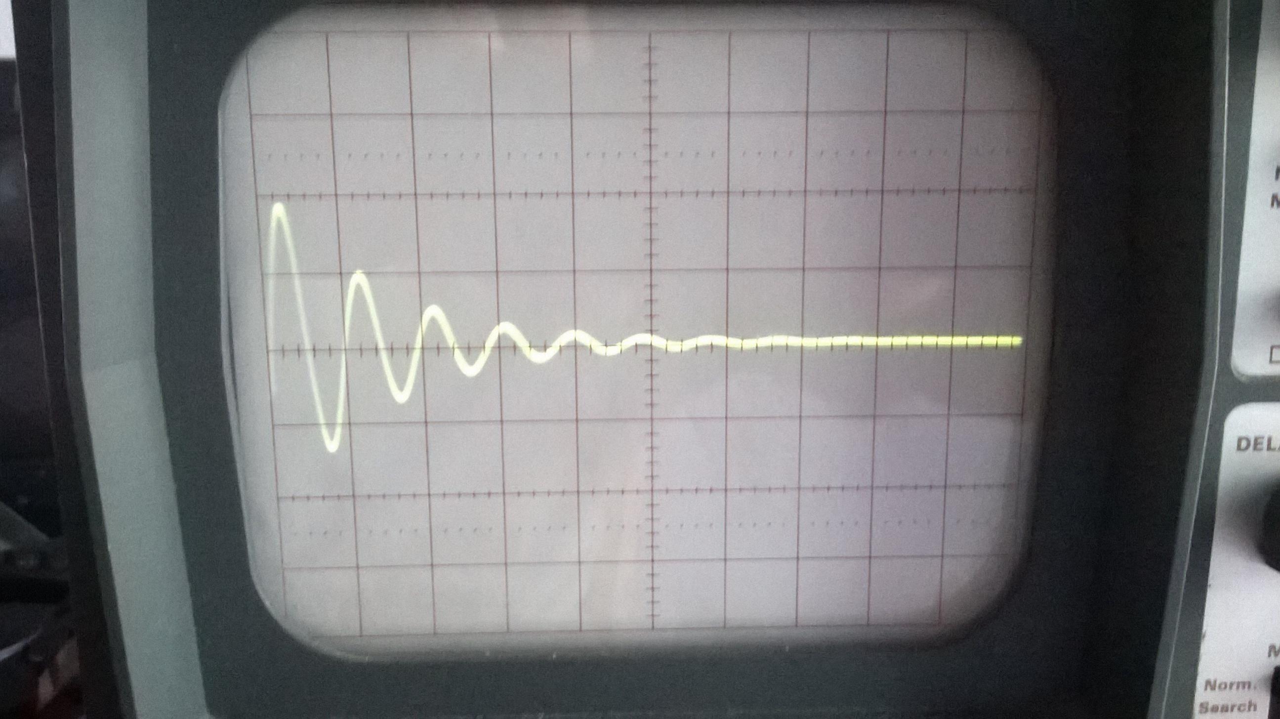

Simple, no-math transformer snubber using Quasimodo test-jig
Left to right side: InfinityRs, 100Rs, 500Rs, 250Rs & 100Rs

Primary 50R + 250R
Thanks Merlin. It was worth checking the influence of the nominal impedance of the mains connection that would normally be loading the primary winding in an actual application.
Would you be able to measure the primary winding DC resistance, so as to 'round out' the comparison between shorted versus nominal primary impedance.
Ta, Tim
I suggest you snap a series of scope photos at different measured values of Rs, just like the color overlay plots in post #1 of this thread. This will help you find the Rs which just barely flattens out the first waveform "trough" like the red trace (see yellow arrow).
From your first photo, it seems that Lsec might be in the neighborhood of 1200 uH, so zeta=1 critical damping would be expected to occur somewhere in the vicinity Rs = 170 ohms or thereabouts. Assuming your Cx really was 10nF, and so forth.

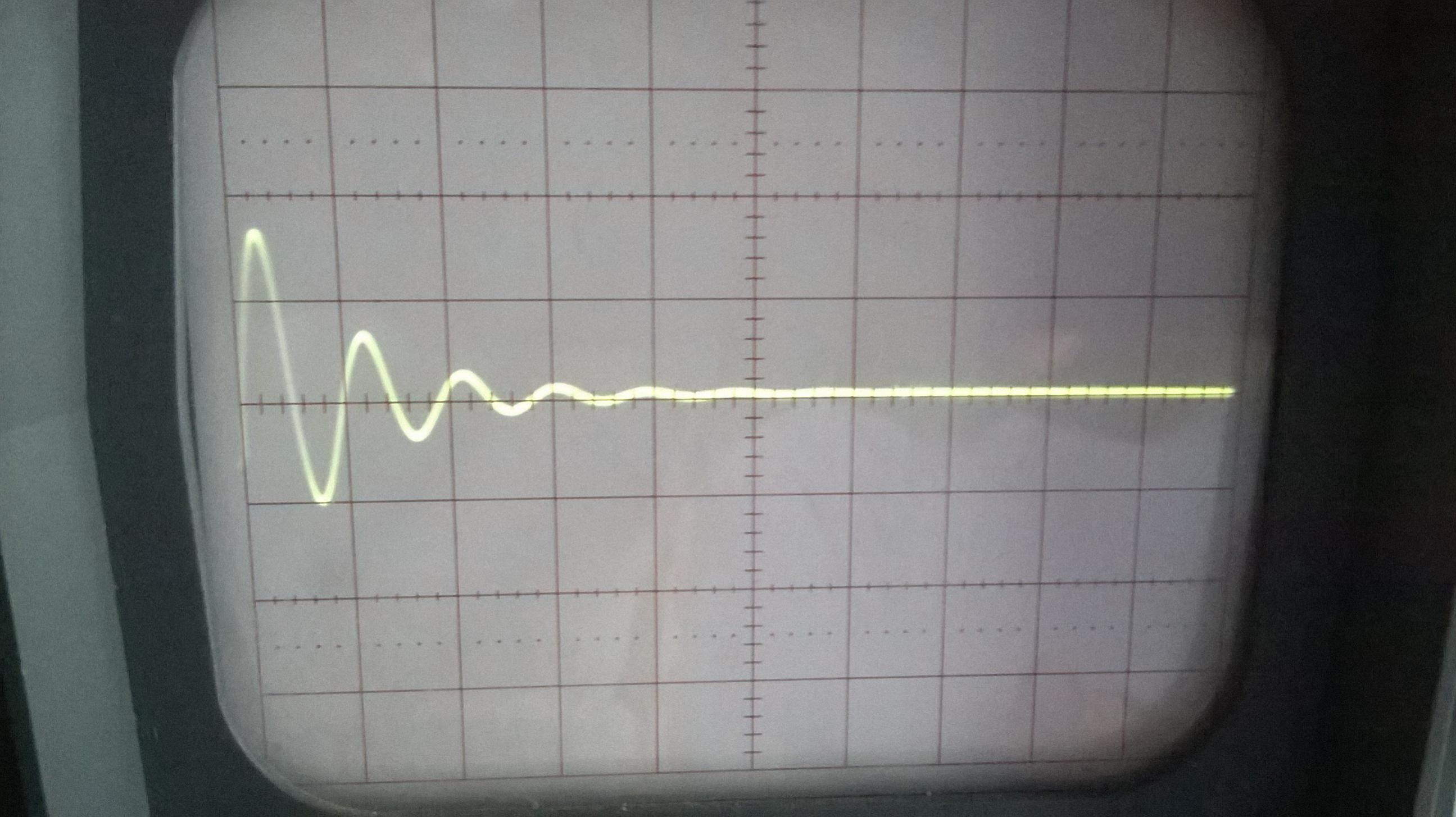

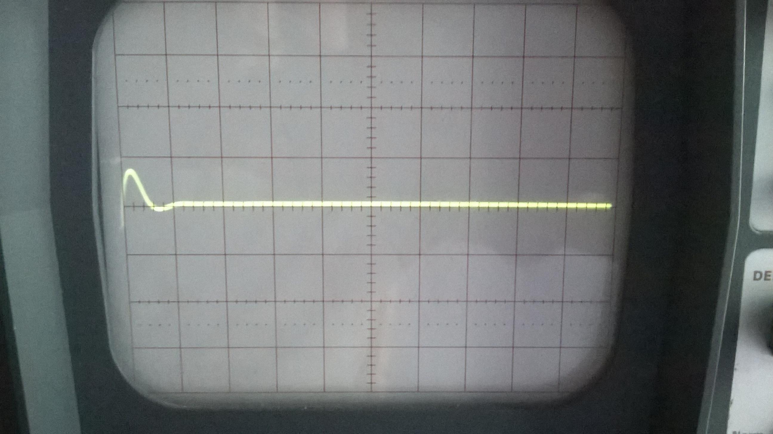

Cx is really 10nF, I measured with two different LCR meters, after the last photos still you consider the Rs value in the vicinity of 170 ohms? attached pic scope set 5V/cm 10uS with Rs 170 ohms
pic5 of post405 shows one cycle after the return to zero.
pic4 of post405 shows three cycles after the return to zero.
post 410 shows two cycles after the return to zero.
The damping in these three are different.
Which is the best for least effect downstream?
