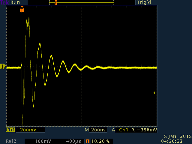

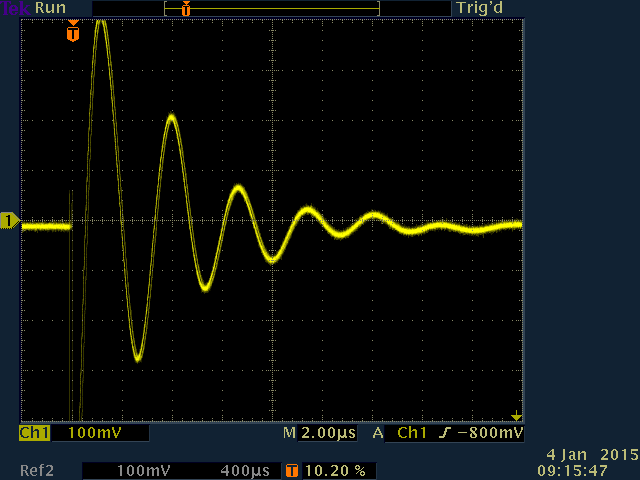

I've validated my QM works using the Inductor method and it was spot on.
Here's my first result.
The first attachment is Cs = 150nF, Cx = 10nF, Rs = infinity.
The second attachment is Cs = 150nF, Cx = 10nF, Rs = 577.
The third attachment is Cs = 150nF, Cx = 150nF, Rs = infinity.
The fourth attachment is Cs = 150nF, Cx = 150nF, Rs = 327. In this case, it's impossible to find a zeta = 1.
This transformer is a Hammond 229C40. Both secondaries measure nearly identical.

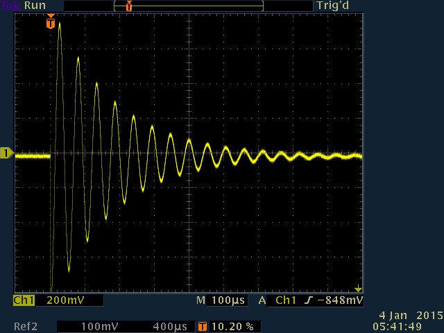

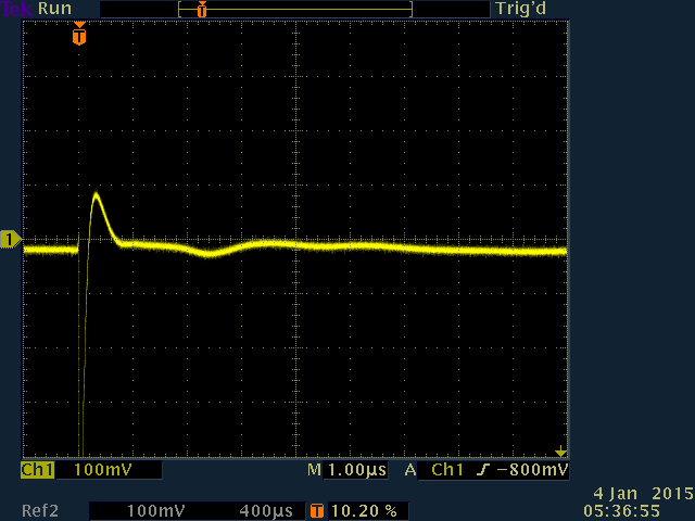

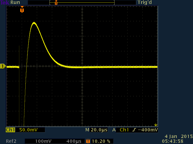

My second is a Hammond 160H12. I cannot get it to ring as nicely. I've tried both Cx = 10nF and Cx = 150nF, here's what I get:
The second attachment is Cs = 150nF, Cs = 10nF, Rs = 11.5. In this case, that's as close as I can get to zeta = 1.
The transformer is configured the same as the one above.
So, my question: why doesn't this one ring as clearly?

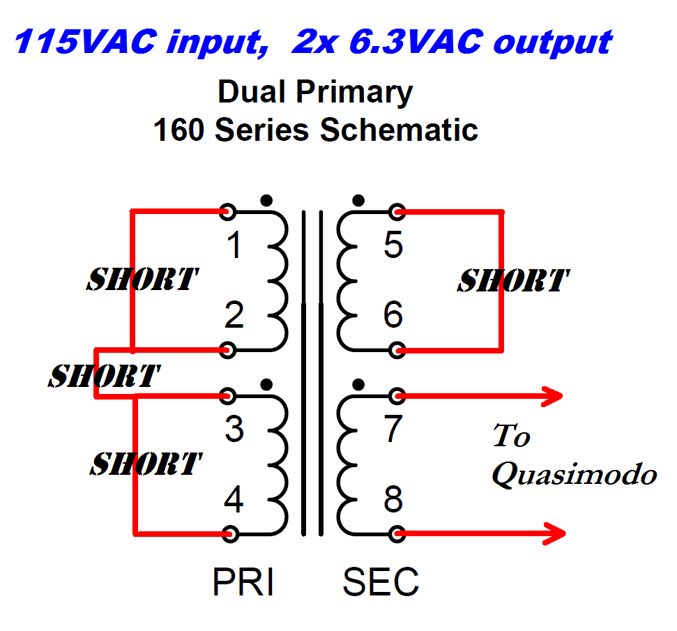

Oddly, if I remove the short on the second secondary, I get more wiggles and much more symmetric ring, see attached. It's really hard to get zeta = 1, the trim pot is nearly at the bottom of it's adjustment range and it ends up looking more like zeta = 2 or zeta = 3...

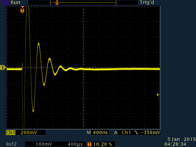

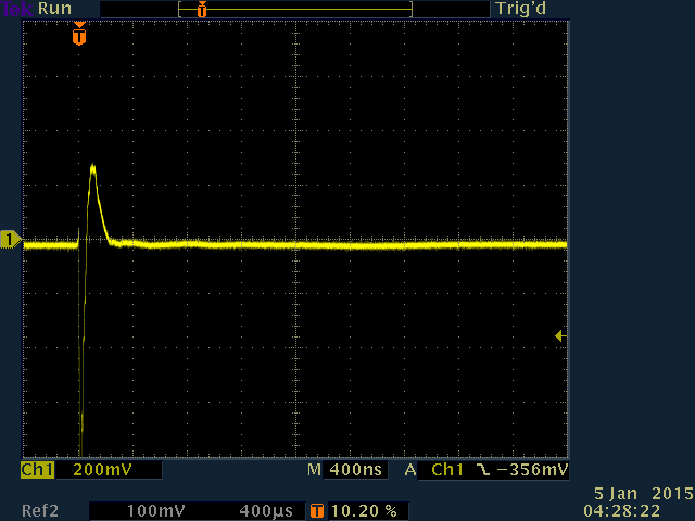

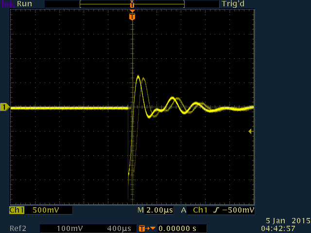

I decided to play a bit more. First I tried to vary the input voltage to the QM. Second, I decided to go lower in capacitance values. Here's what I got:
First plot is Cs = 100nF, Cx = 1nF, Rs = infinite
Second plot is Cs = 100nF, Cx = 1nF, Rs = 33.2
Third plot is Cs = 100nF, Cx = 220pF, Rs = infinite
Fourth plot is Cs = 100nF, Cx = 220pF, Rs = 25.1
Fifth is Cs = 100nF, Cx = 33nF, Rs = infinite

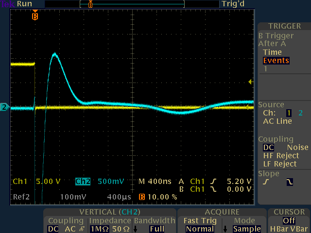

Mark: Thanks! Given the data I gave in posts #528-#530, what would you recommend as snubber configuration for this transformer?
I tried a few larger transformers after I posted the above and quickly found good values. This one seems to escape me, but wanting to learn.
Andrew: I did play a lot with trigger using a single scope channel, despite what the screen captures lead you to think. I will try with a second probe, we will see if it helps.

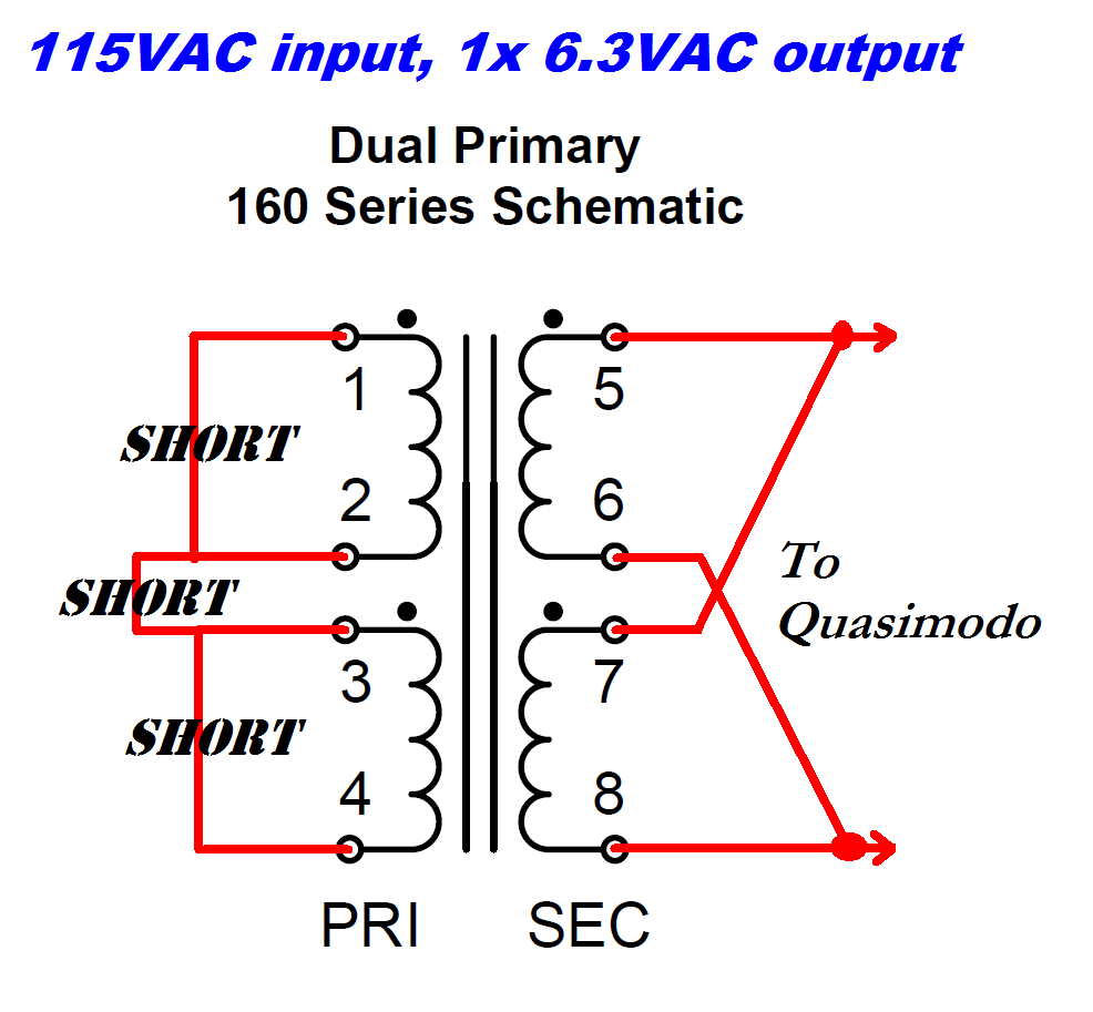

Make sure your connections are correct; avoid garbage-in, garbage-out. Diagrams below.
You may find it beneficial to use a 200 ohm trimmer (example1) or a 100 ohm trimmer (example2) in your Quasimodo test jig, instead of the stock 1Kohm trimmer. These will give you finer granularity of control, in the low-ohms region where 6.3VAC transformers often operate.
Start by choosing two or three candidate rectifier diodes. Find the capacitance of each, and let the symbol "Crectifier" represent the LARGEST capacitance among your candidates. So if your three diodes are 30pF, 250pF, and 170pF, then "Crectifier" equals 250pF.
Choose Cx to be at least 2X greater than Crectifier. (5X is safer, and 200X is even safer).
Now that Cx is known, Cs is also known. Since the (Cs / Cx) ratio is fixed and frozen.
Plug the trimmer, your Cx, and your Cs into Quasimodo. Use a two channel scope, connect channel 1 to node DRAIN and channel 2 to node SCOPE. Trigger on channel 1, falling edge. Twirl the trimpot until the oscillations just barely go flat. Voila, done!
If you are still unable to get useful readings, you could ask someone else to do the measurements for you. You could send your transformer to another DIYaudio hobbyist and ask them to measure it for you. You of course will pay the shipping both ways.

There is a reason why the figures are labeled 115VAC input.
A dual primary transformer such as the Hammond 160H12 can be configured for either 115VAC input or 230VAC input. Only one of those two configurations is shown in the figures attached to post 536. This is also the configuration shown in the Quasimodo design note, Figure 13(d) on page 11. Take a moment to count the number of shorts in the primary circuit of Fig. 13(d).
Do the two shorted primaries need to be connected together?
I find it useful to restate this question slightly:
Suppose Elmo The Experimenter connected a real Quasimodo to a real dual-primary, dual-secondary transformer. Suppose he captured the oscilloscope waveforms when (a) the primaries are shorted but not connected together; (b) the primaries are shorted AND connected together. Would the two captured oscilloscope waveforms be identical? Would they be wildly different? Would they be mostly similar but slightly different?
The restatement makes it clear that anybody who is sufficiently interested / motivated / curious, can answer the question.

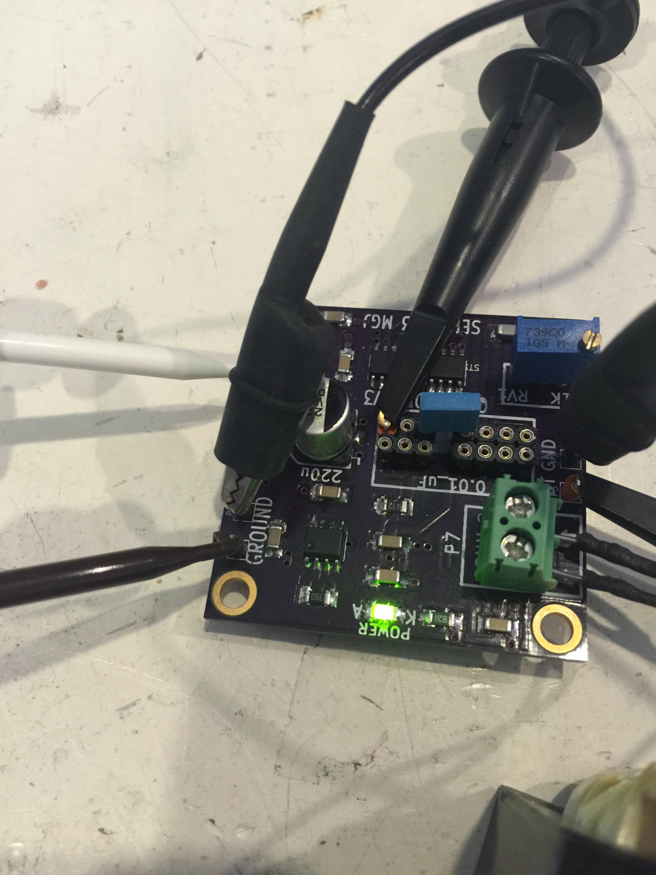

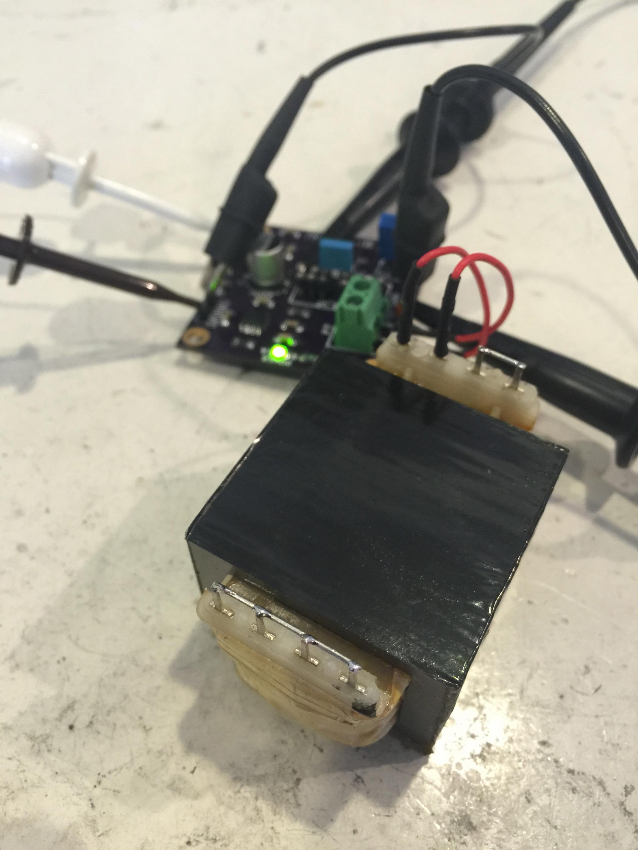

check. see first attachment.
check. see second attachment. I have replaced the stock 150nF capacitor with Rs = 100nF. The capacitor in the socket is 10nF - Cx.
I used a 500 ohm.
I chose CDBHD240-G, which has Cj = 150pF according to its datasheet.
ok, 10nF
ok, 100nF

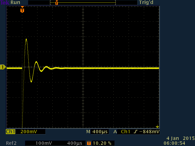

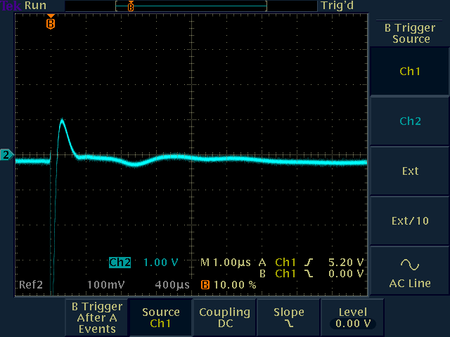

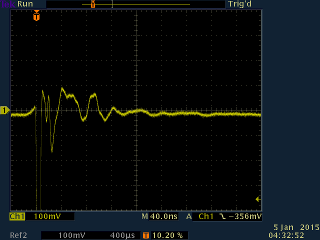

Ok, I believe I've done this. See next two attachments from the scope. I believe I have the Ch1 trigger working.
AndrewT: this didn't change the waveform at all, compared to just triggering using the same channel as the output waveform, per the docs.
This results in Rs = 12.5 ohms. I need to calculate the power through this resistor next.
