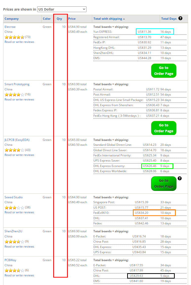

Ten minutes ago, I got price quotes from www.pcbshopper.com for a purchase of ten (10) Quaisomdo V4 thru hole boards, to be shipped to USA. Quoted prices ranged from ($11.36 , delivery in 16 days (blue rectangle)) to ($29.63 , delivery in 5 days (black rectangle)). That's a cost of $1.14 to $2.96 per board, delivered to you.
The Gerber files needed by the PCB fab, are attached to post #1 of this thread. Use the "seeed" version for all fabs in the world EXCEPT OSHpark.
