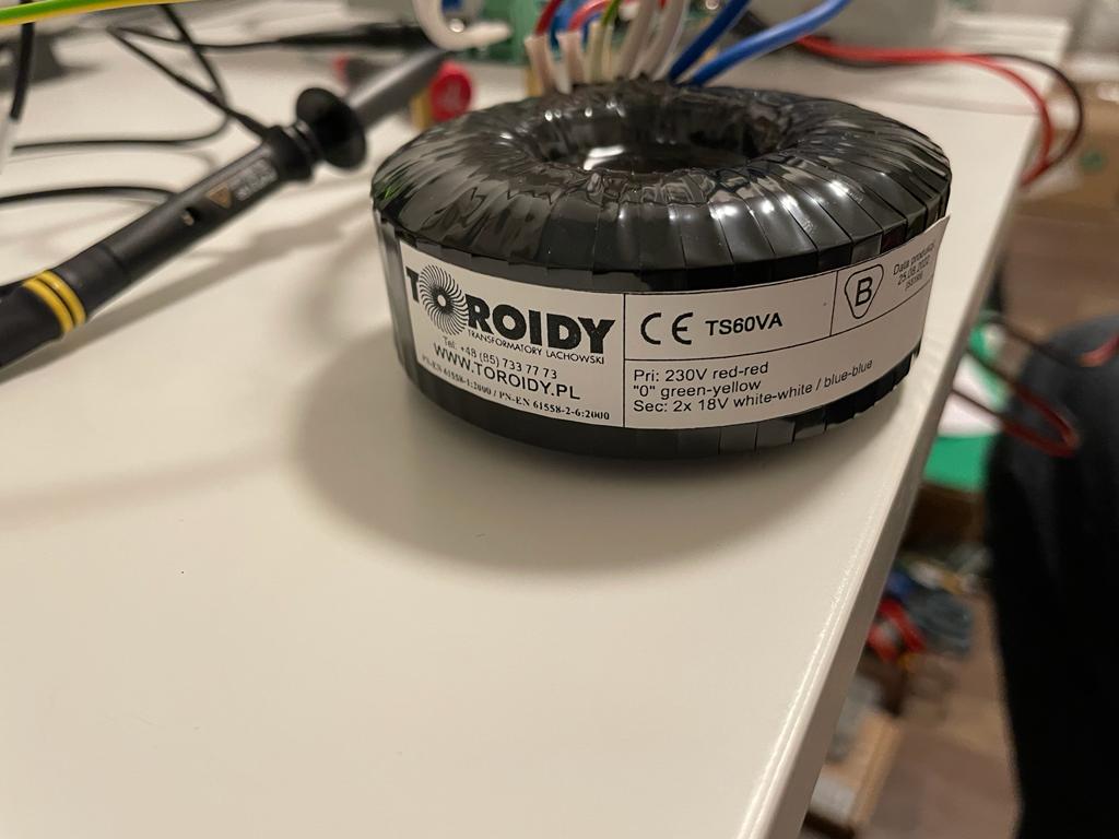

I have measured 3 Toroidy 60VA transformers.
2x - 2x18V Cx=10nF Cs=150nF Rs=920 Ohm
1x - 2x18V+1x8V Cx=10nF Cs=150nF Rs=920 Ohm
I think your concerns are well founded; 920 ohms is bigger than ANY of the optimum snubbing resistors found by diyAudio members and tabulated in the Quasimodo results (ONLY) thread. Probably there is a mistake, either in your lab procedures or in your Quasimodo fixture itself.
To find out, I recommend you use Quasimodo to find the optimum C+RC snubber for a fixed inductor whose inductance and tolerance are known and provided by the inductor manufacturer. Choose an inductor whose inductance is anywhere between approx 20 microhenries and approx 1 millihenry. Post your optimum snubber values (Cx= aaaaa , Cy= bbbbb , Rs= ccccc , Inductor= ddddd) and we'll go through the math here in the thread. This will determine whether your Quasimodo fixture is working, or broken.

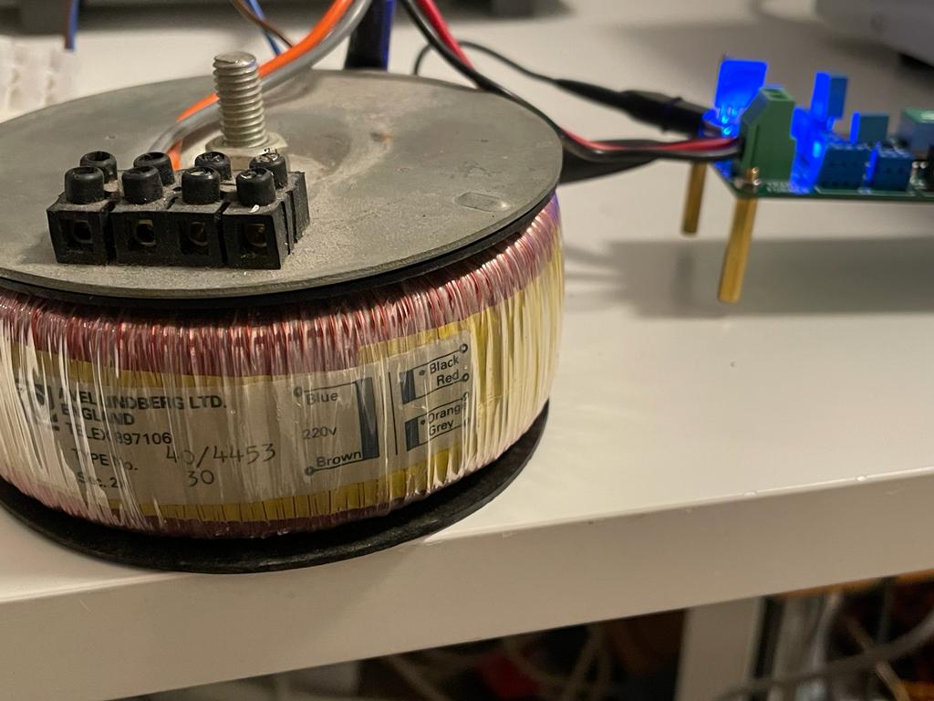

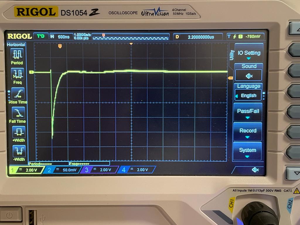

You are right. I have also measured other transformers and they al give the same Rs value. The Quasimodo has worked properly before, so I don't get it. Have attached some photos. Perhaps I am doing something wrong.

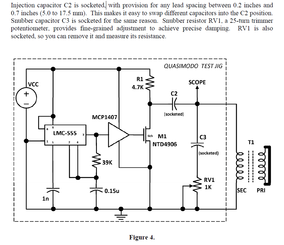

1. Buy an inductor with known inductance (between 20uH and 1000uH) and known tolerance. Use Quasimodo to optimize a C+RC snubber for this inductor and report its values.
2. Re-read the Quasimodo Design Note and study the material before and after Figure 4. Double check that you are measuring the resistance of the trimmer with the appropriate two pins shorted together (as they are on the PCB).

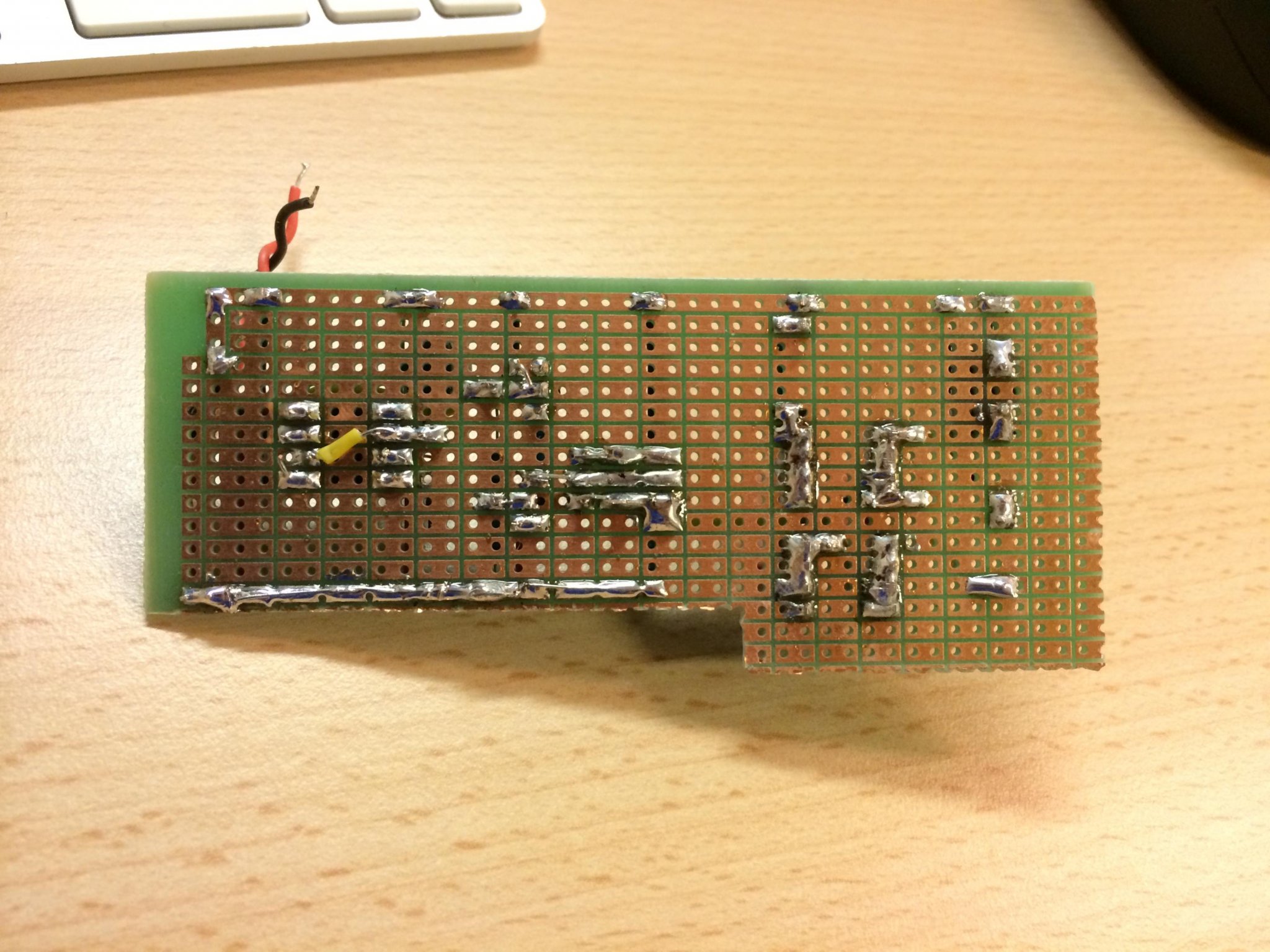

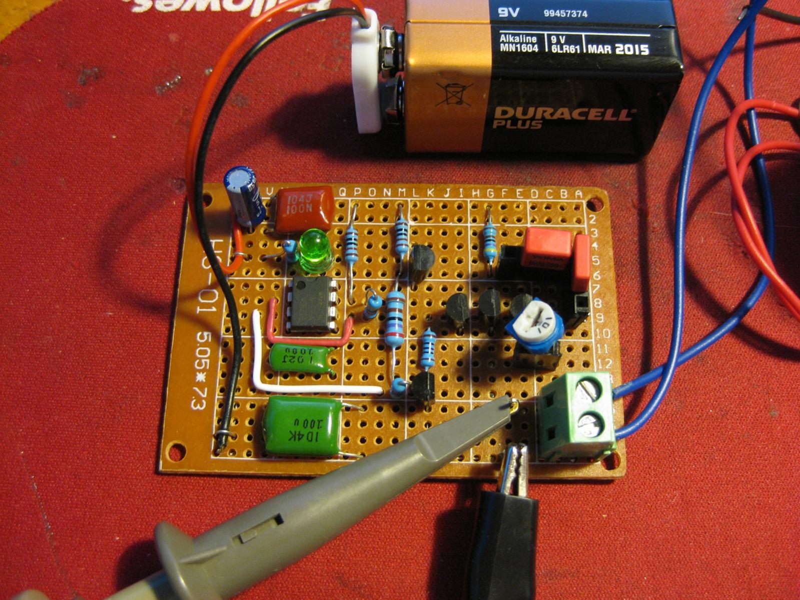

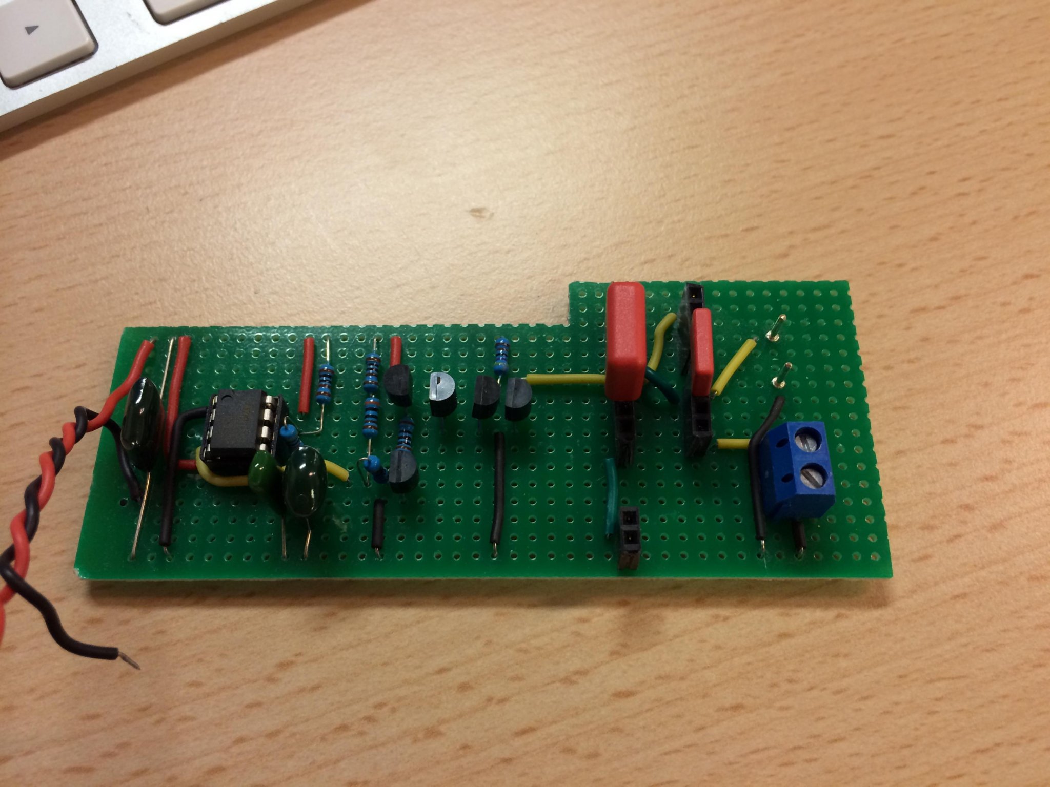

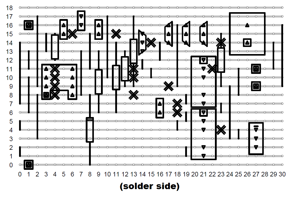

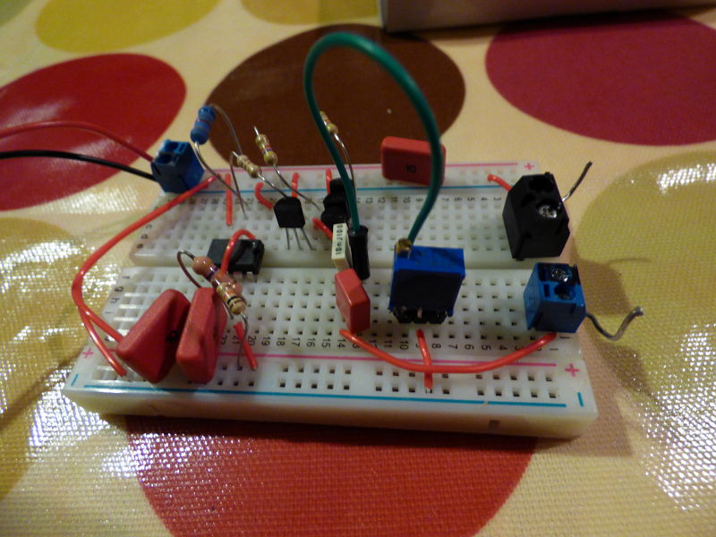

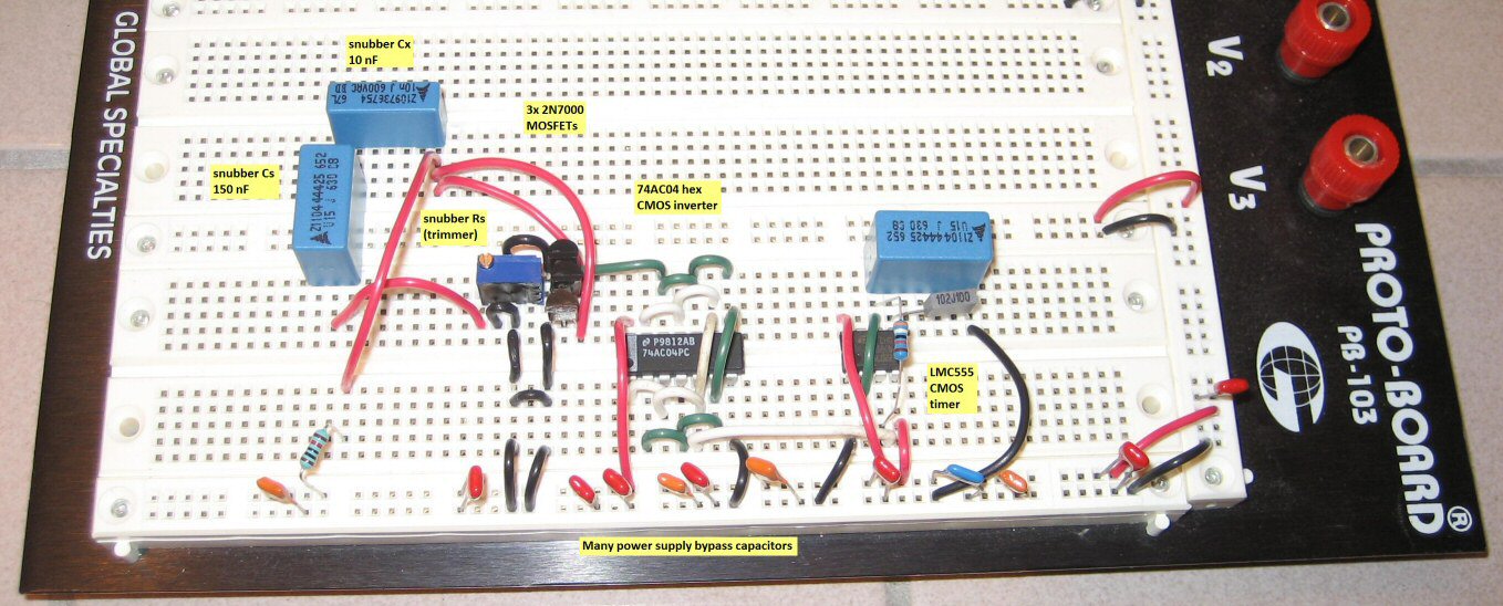

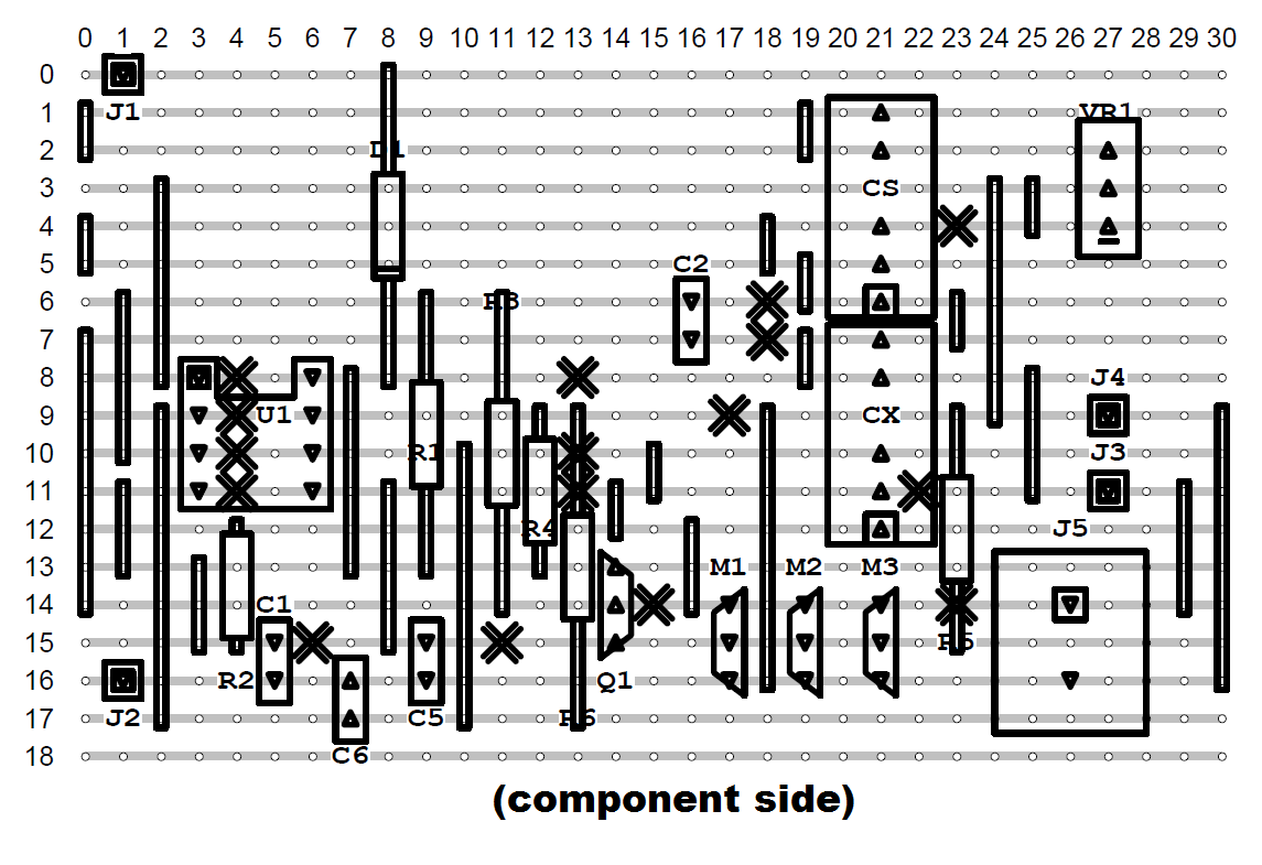

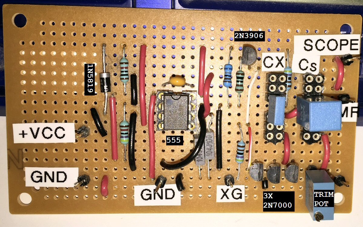

Resourceful diyAudio members have successfully assembled a Quasimodo test fixture without using anybody's PCB. Examples below, demonstrating "where there's a will, there's a way".

Very nice! I worry that the 96 kHz bandwidth might prevent it from displaying typical Quasimodo waveforms. I tried the infamous $18 oscilloscope kit called DSO138, with Quasimodo (link) and its 200 kHz bandwidth, plus very rudimentary triggering, prevented it from being a useful tool. I hope VA turns out to work much better!
