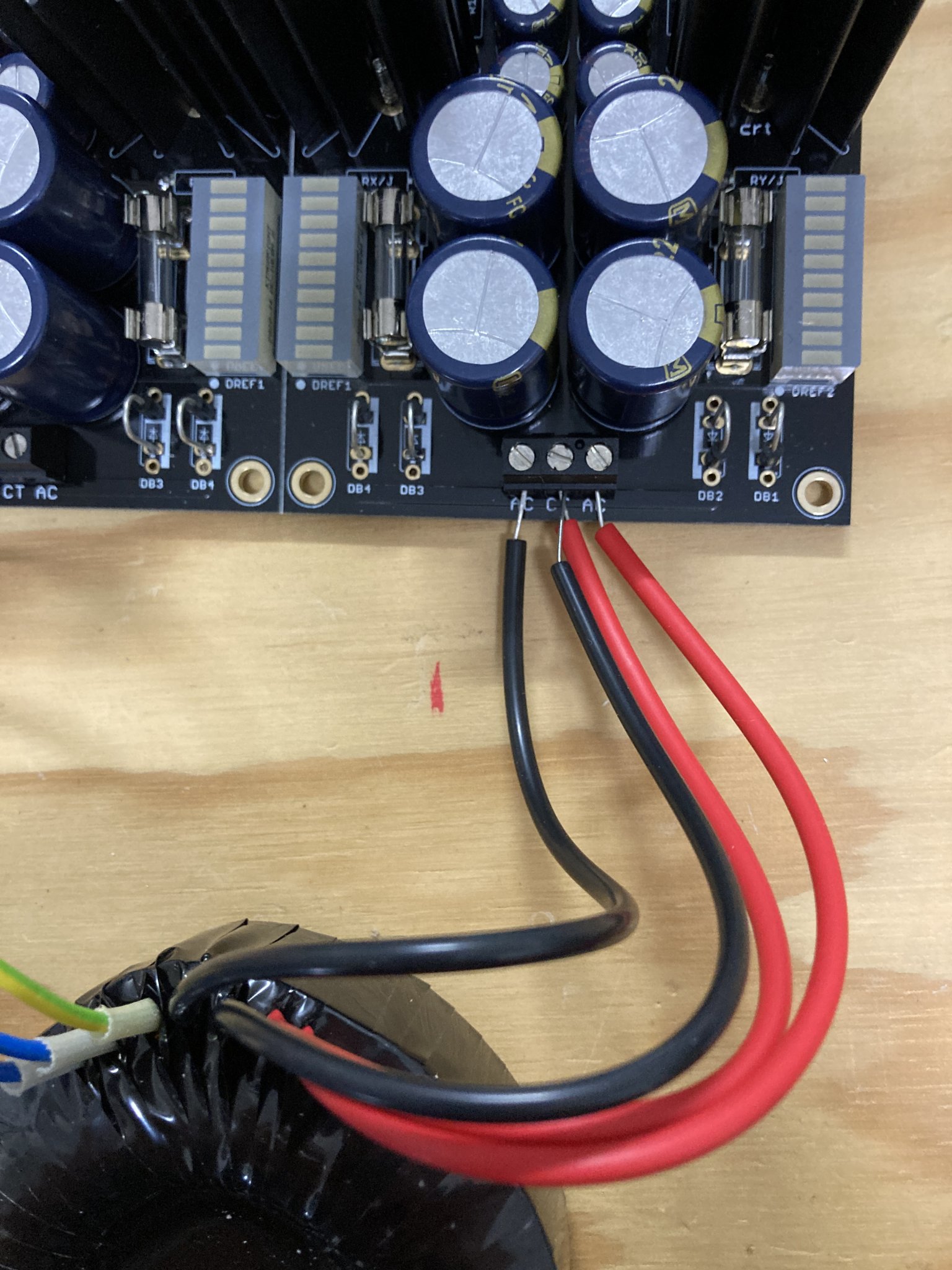

I am totally not sure whether this arrangement of secondaries would qualify as centertapped?
Or, is it rather secondaries in series?
It is somehow obvious, but (obviously) I'm a chicken.
Referring to the (excellent) Quasimodo-documentation, the third, or the last...
according to mZM : :cuss::deerman:

Without seeing the documentation for your transformer, I'd need to assume:
that the black wires are two ends of one secondary;
the red wires are two ends of another secondary;
both secondaries are the same number of turns;
both secondaries are wound in the same direction around the core; and
that you have the phases wired 'correctly'.
I may have forgotten a few things, but in general, if the above is true; you have both wired your independent secondaries in series AND the junction of the black and red wires would effectively be a 'center tap'.
I think I got that correct, but as with all my posts, what I think I know, and what I actually know can be worlds apart. I'd wait for someone else to confirm and/or say where I got this wrong.
You could also ohm out the wires. Assuming the black/red are the secondaries, one pair of black/red should ohm out with low resistance, this is one of the secondaries. The other pair should be ohm out to around the same resistance, this is the other secondary.
If they are independent, then the two blacks will not ohm out, and two reds will not ohm out.
If its really center tapped, then either two blacks or the two reds would be shorted together.
Does that make sense?

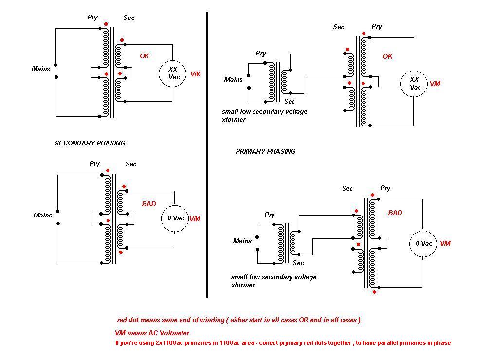

It's also critical to understand the phasing - The attached might help. Credit ZM.

The Tx is a toroidy 2 x 18V 50VA, 1 primary, red-red / black-black are the secondaries.
Toroidy, though excellent, doesn‘t document very thoroughly, they don’t even tell us the winding’s orientations (hence the wire’s colours), this I have to find out with quasimodo (I unfortunately didn‘t note it, but there is a clear difference in the results when the wire‘ orientation is swapped when they’re hooked together (parallel or series)…
Aha! 😀
That is precisely my chicken-moment…

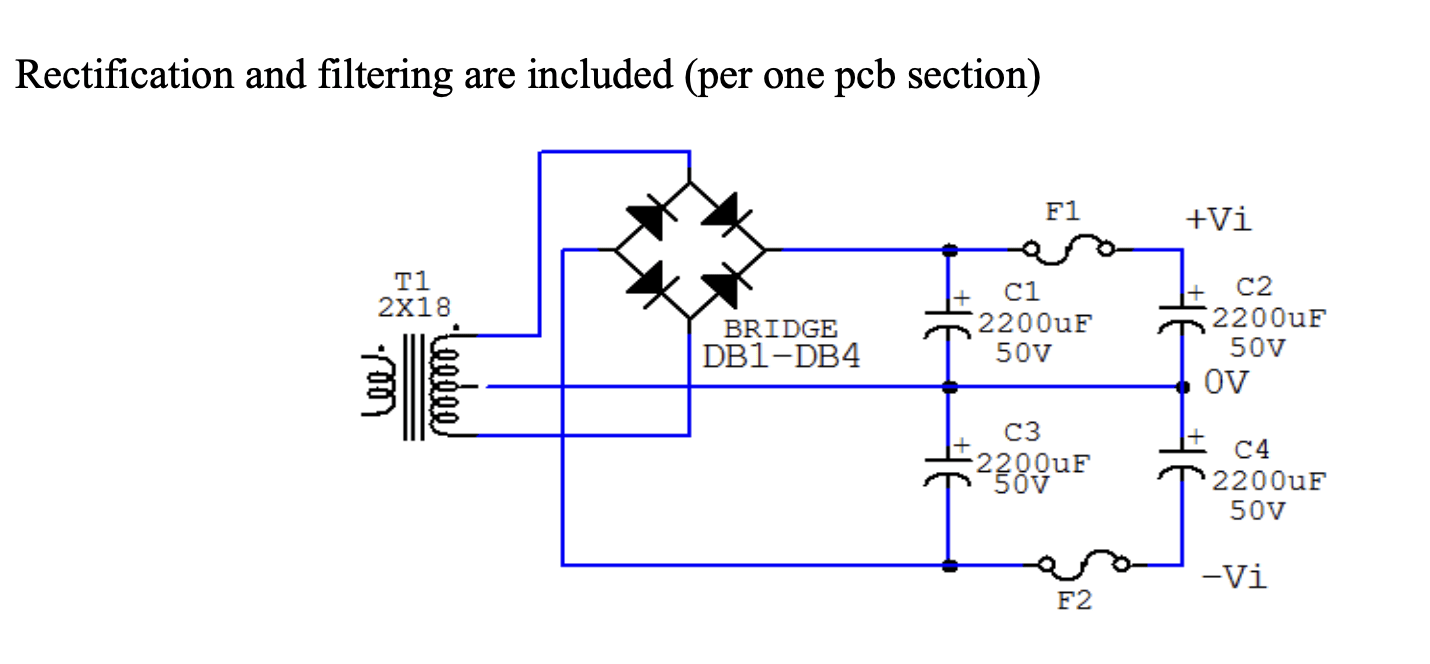

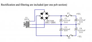

edit: here's the PSU's schematic... (which quite clearly indicate what configuration to use, ahem)
Reactions: ItsAllInMyHead
Note - I have never built one of those PSUs, but it looks to be set up on 'one' board to do two dual rail PSUs => Dual mono, dual rail. So, it looks like your dual secondary transformer set up as a CT would be the AC supply for one dual rail supply (one half of the board). If you want dual mono, then you'll need one more transformer. Someone more familiar with that supply may be a bigger help on this.

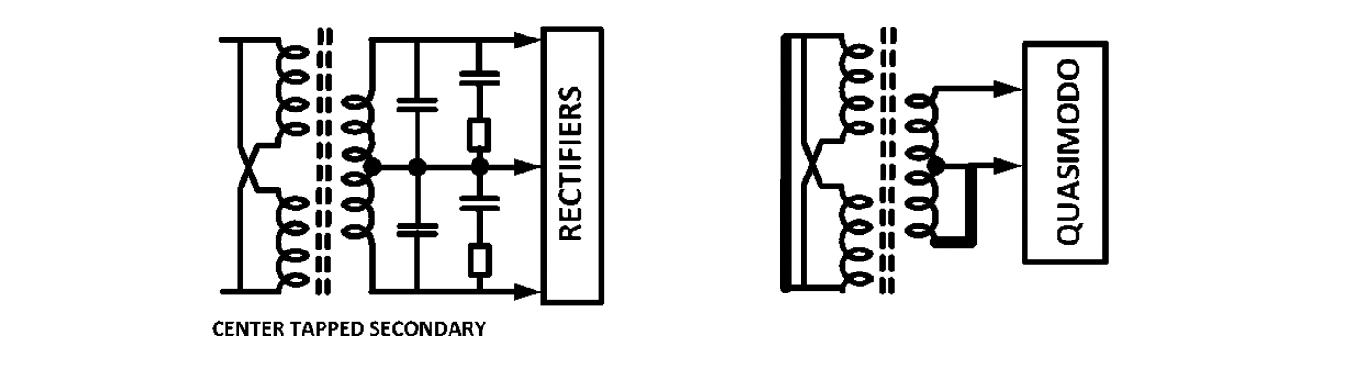

A chunk of the schematic for your PSU is very helpful re: how you'd use it with your Quasimodo to check for the snubber values. However, where on the PCB / within the circuit do you plan to implement the snubber? Do you know if it's useful for this type of PSU? I don't have a point of reference.
So, this would be the implementation for using it with the Quasimodo per the instructions. You measure it not only for how the transformer is configured, but for how you will utilize the transformer in the circuit. In this case, CT.
Once again, I don't know where you'd include the snubber within or in addition to the DCG3 circuit and/or if it's necessary / worthwhile, but that's how I'd measure it were I in your shoes.
Don't forget to look for phase dots and/or be sure to check your phasing manually (ACVM) before hooking it to the Quasimodo. Yes, you should certainly seen your measurements behave differently based on how you wired your secondaries (orientation and overall in series or parallel). Be sure to review the ZM attachment and measure. 🙂

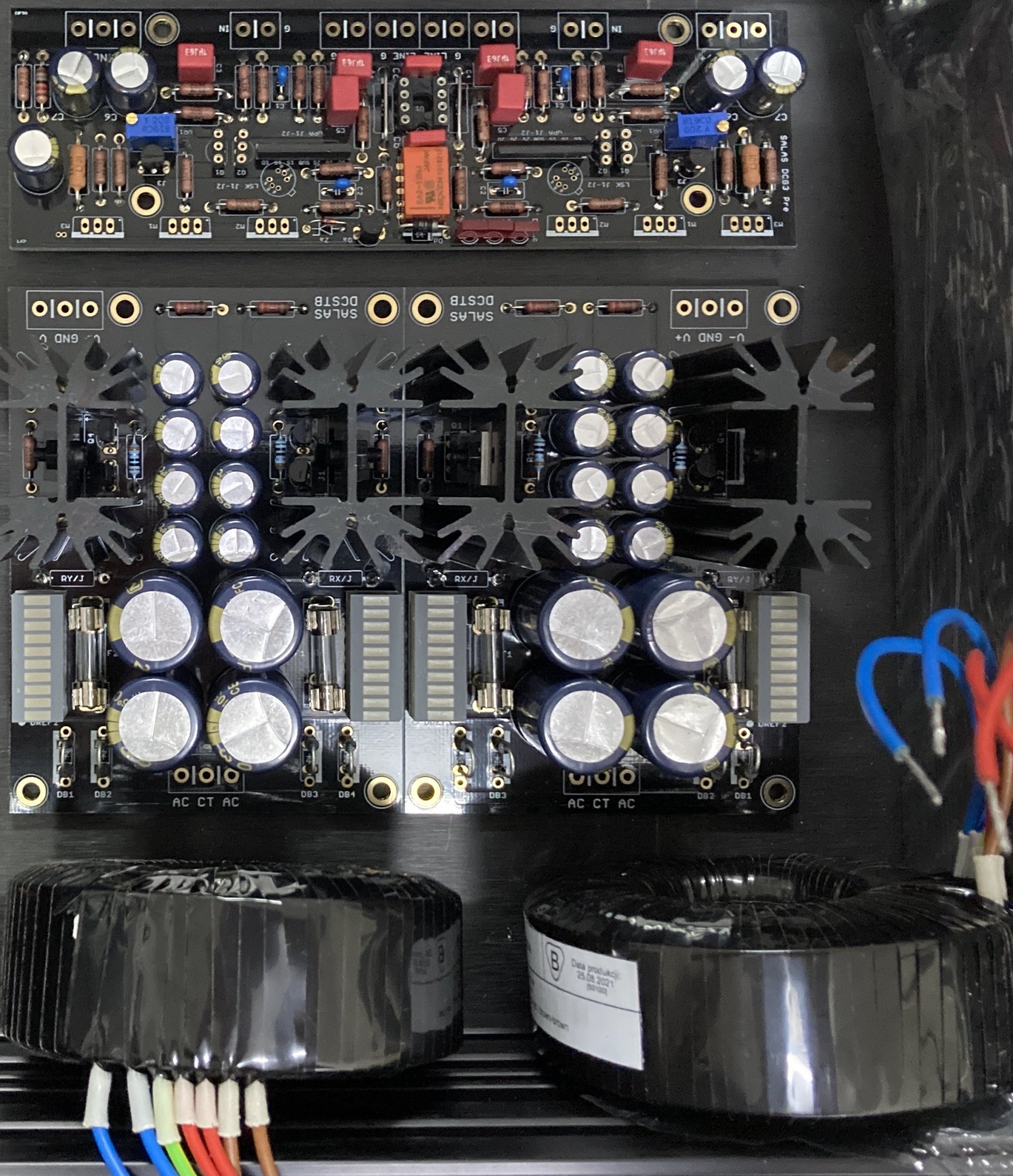

Thanks again for assisting me. Here's what will be in the box—as you concluded, two dual rails aka a dual mono beast.
The placement of the anti-ring-network would obviously be at the PSU's entry. Will ask Salas before, just to be sure it makes sense at all (AFAIK, tea-bag/Salas did recommend the use of Quasimodo)

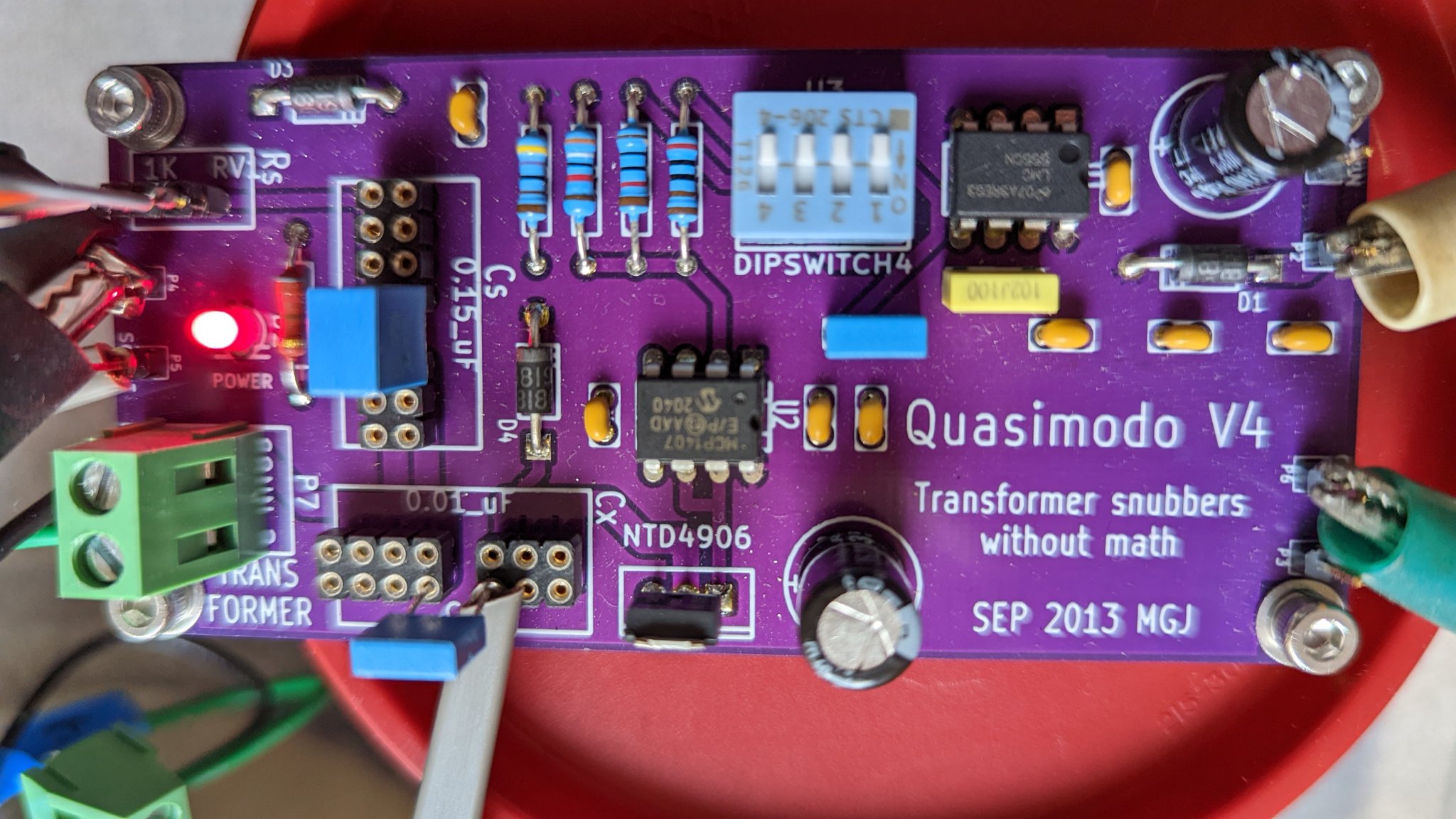

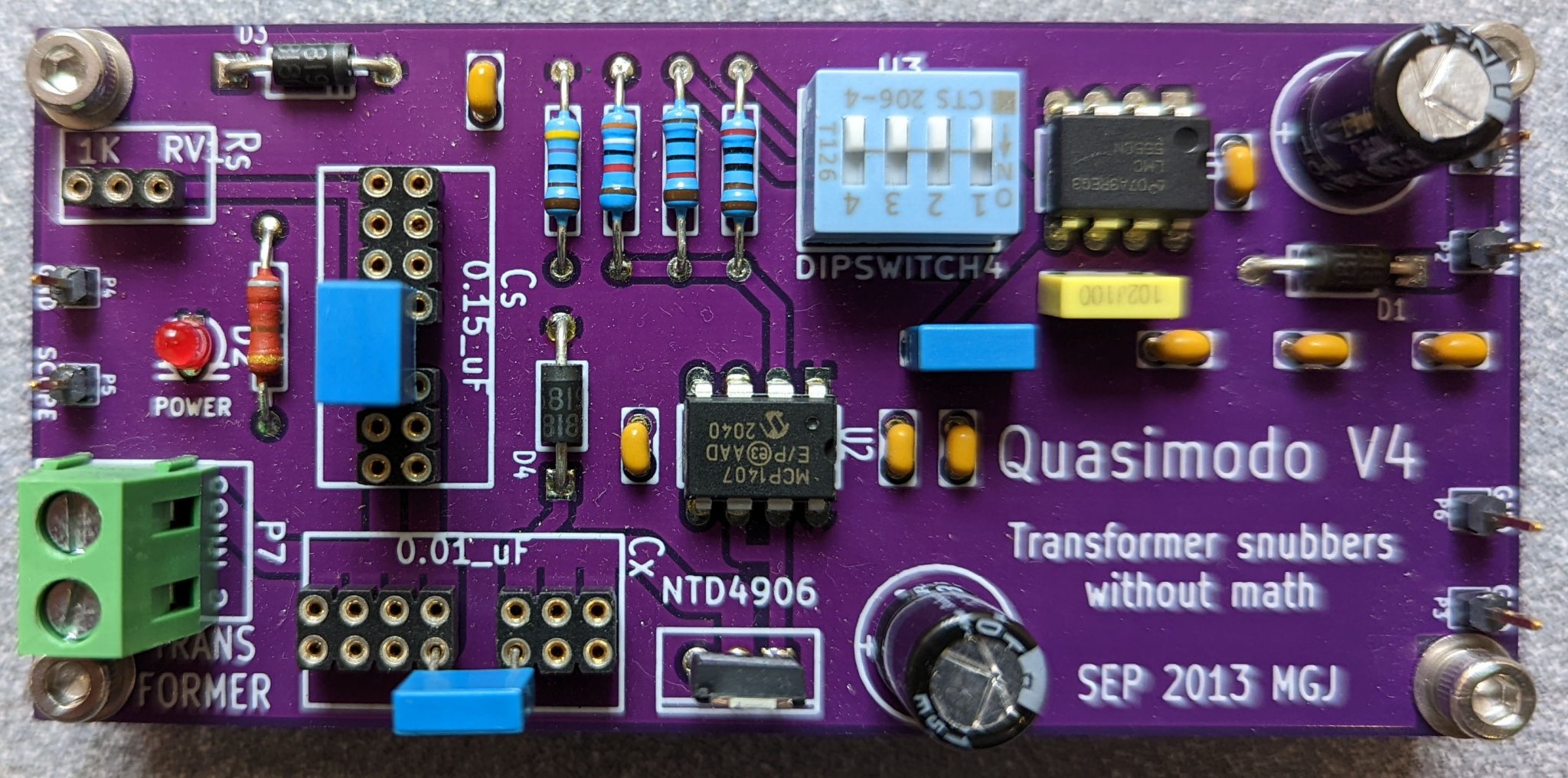

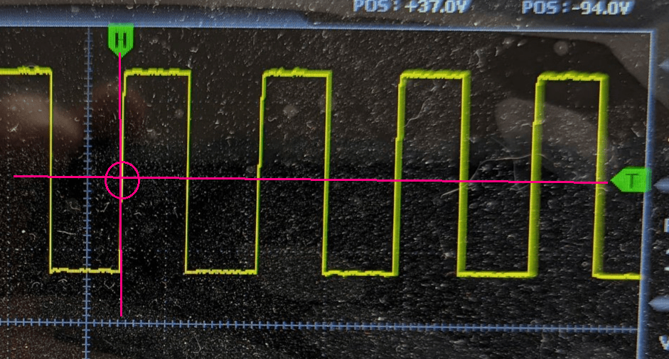

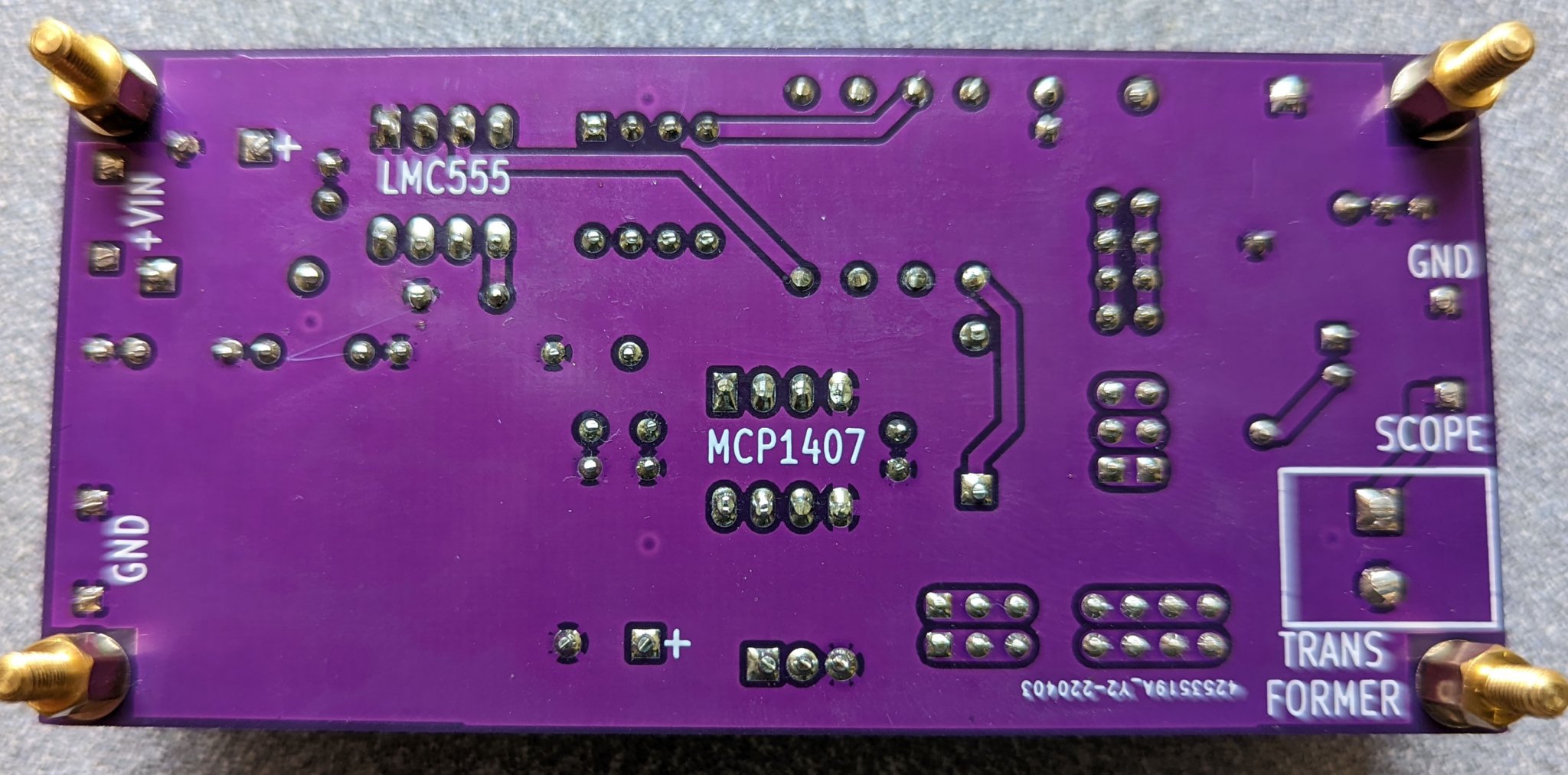

Hi All,

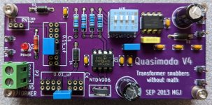

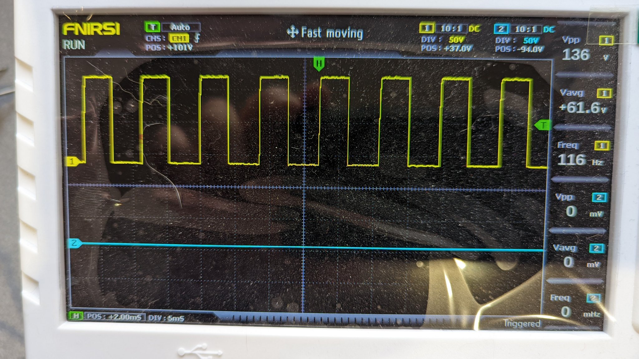

I have a problem with my Quasimodo.
Shortly, All my transformer winding are shorted except the one I want to mesure,
on channel 1 I have the square wave but on channel 2 nothing at all, no oscillation (he's dead Jim).
I figure I have made something wrong when I soldered the parts, so I constructed another one, same result.
Tested with an other transformer, same result.
Tried an other scope, again same result
I send pictures of the beast, sometime you could see something that I am not able to see myself.

Hello Mr. Johnson,
Thanks for your help, it is working well now. 👍 It is a wonderful tool. 🙂 I will take the opportunity to ask you, what is the minimum power the resistor need to be for the snubber.
It is for a 1kva transformer, if it is important.
