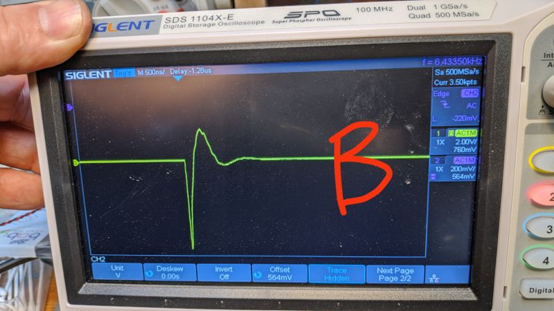

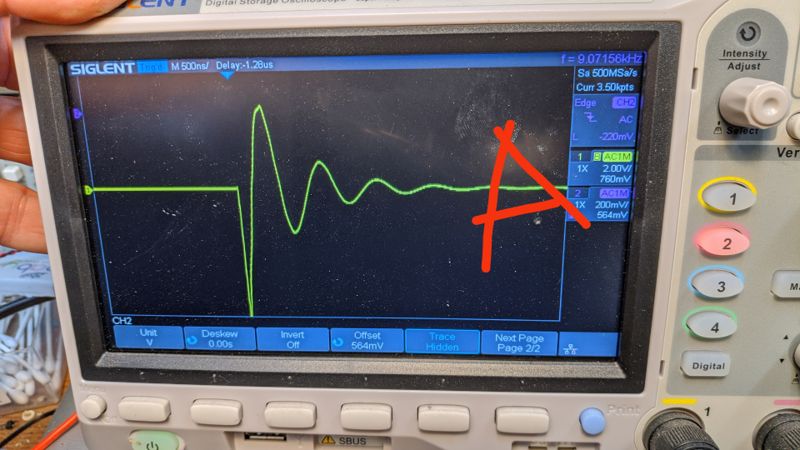

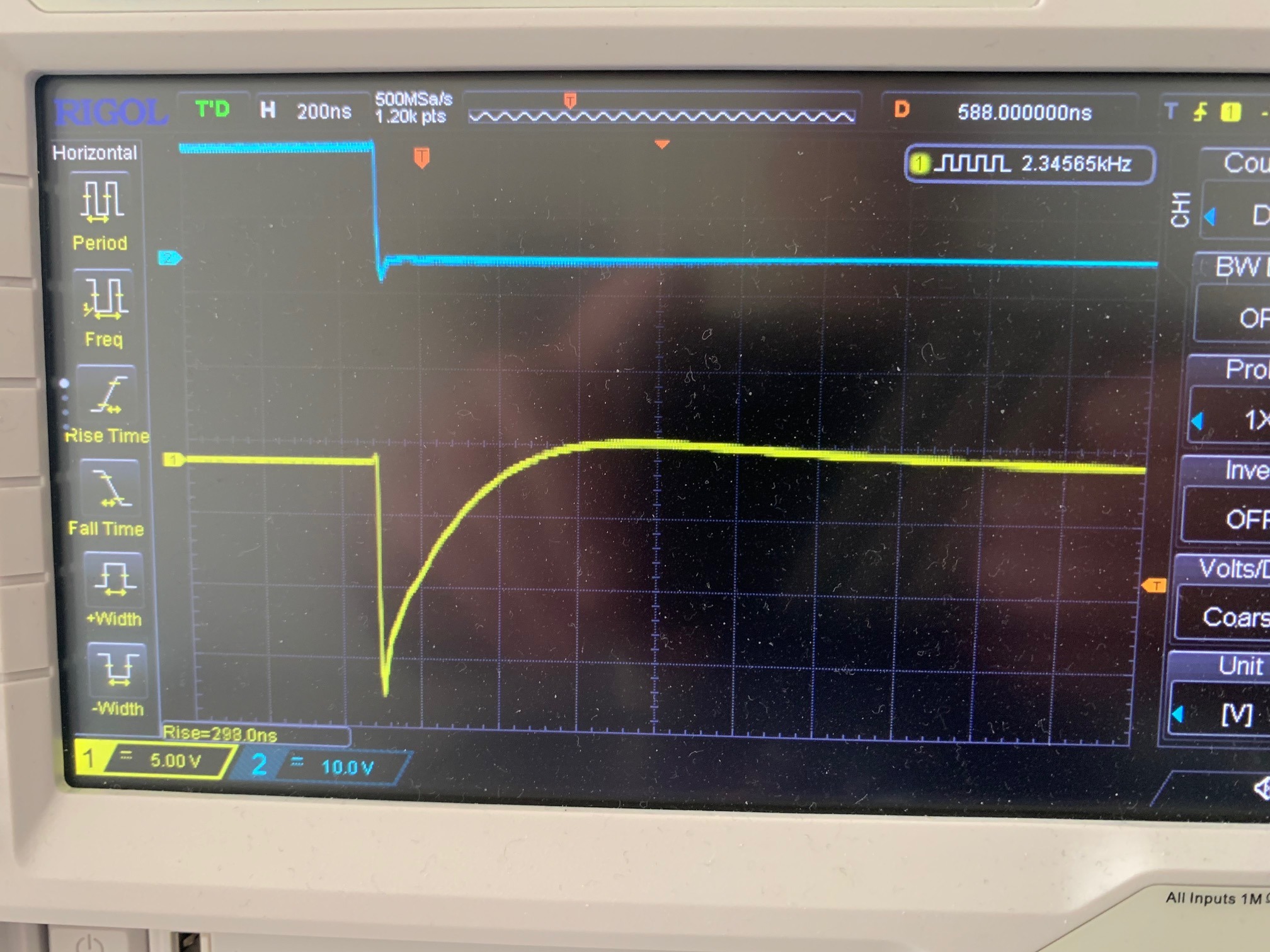

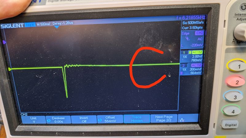

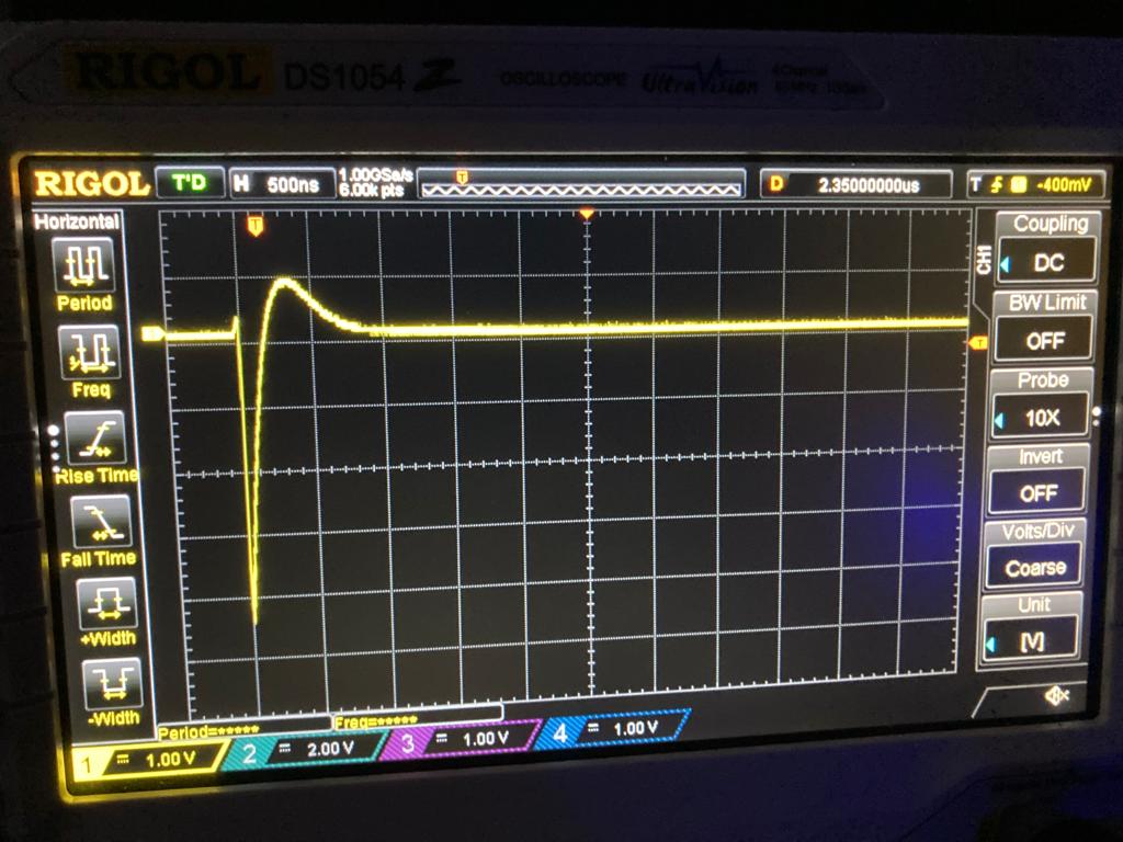

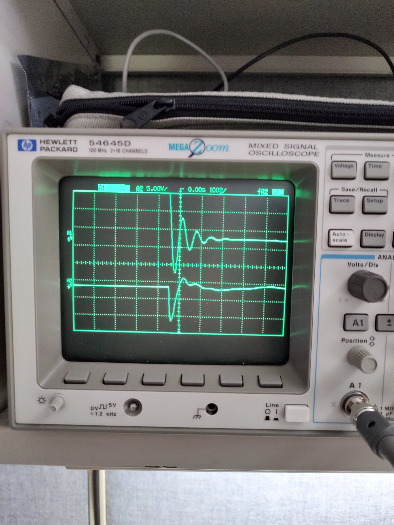

I built it up last night, but only getting to use it tonight. After figuring out how t trigger the scope properly etc, I think I have stable waveforms. I connected up a random 12v transformer and was able to adjust the pot to get pretty close to the pictures in the manual that @Mark Johnson kindly provided - not quite as clean, but not bad. I also tried a much heftier 40V transformer and that was cleaner looking. Finally I pulled out my Aleph J, big 20V transformer and hooked it up. The results are below.
A: This first one is essentially undamped - I think the pot was up around 500R or so.

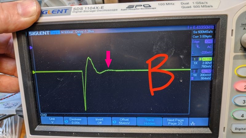

B: If I'm right, this one is I think the goldilocks spot - just damped, maybe a tad underdamped:
C: And this one I think is over damped.
I hope I have that right - If I do then I'm well on my way.
On all 3 of the transformers I measured with standard capacitors as per the manual, the resistor reading is quite low - from 15R to 30R. Is this normal? Should I change the capacitor values to achieve a higher resistance?

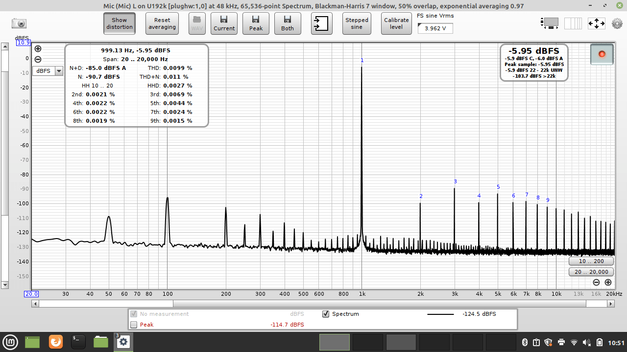

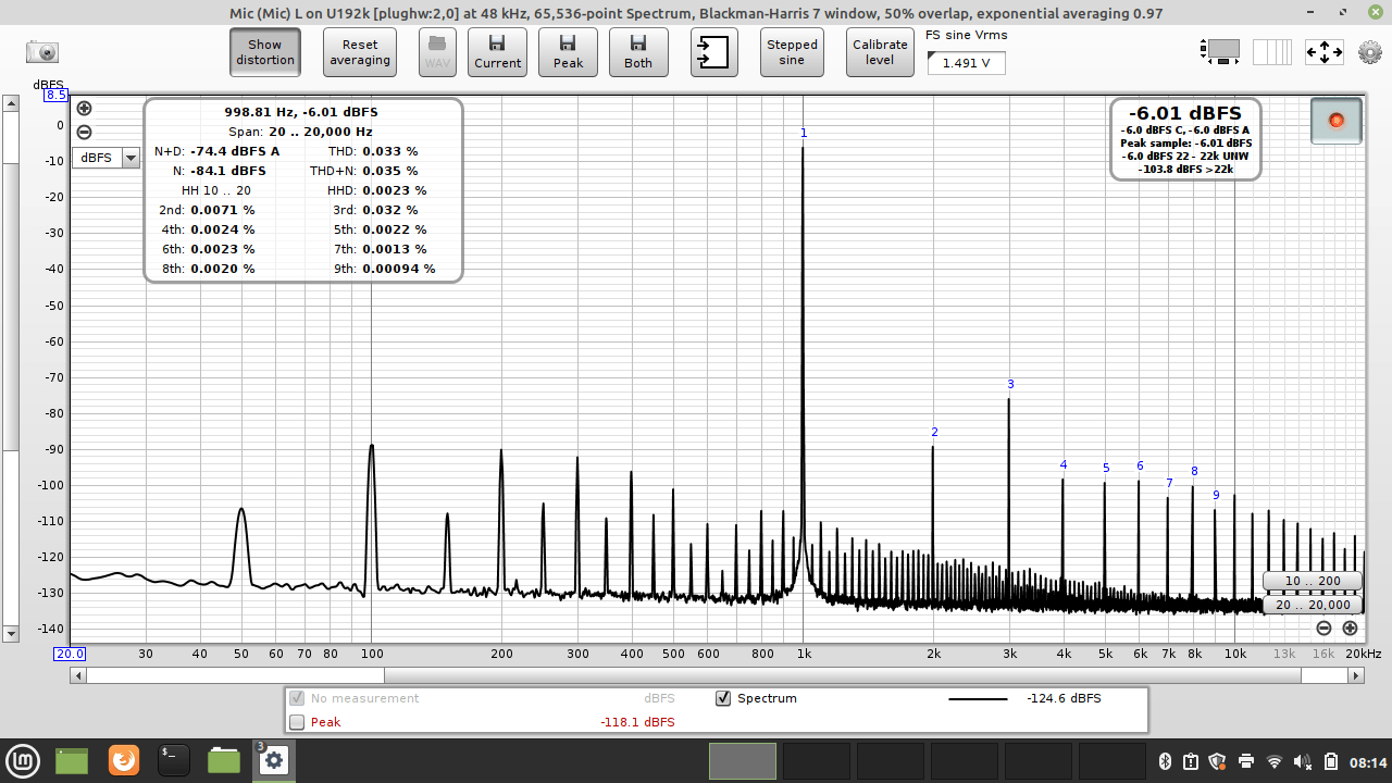

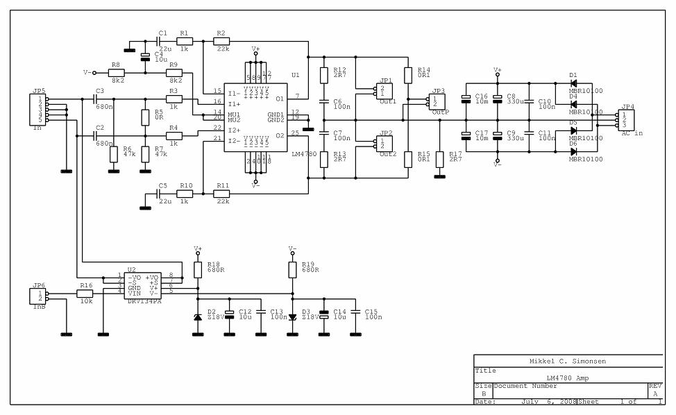

Lately i build a FFT measurement setup for testing my amplifier's. Link!
But this lead me to some issue's i see in some of my amps.
Attached picture here is a somewhat cheap LM4780 Cloneamp. (Schematic + FFT shoot)
(Feed with Victors 1KHz osc. at 1.055v ---> CloneAmp. ---> 8ohm-load ---> Soundcard)
I belive it's mostly 100Hz rectifier "noise" bleeding through the PSU (50Hz mains here in Denmark)
I'am in doubt if the Quasimodo snubber will help curing this? Or if the ringing it would cure are somewhat another issue

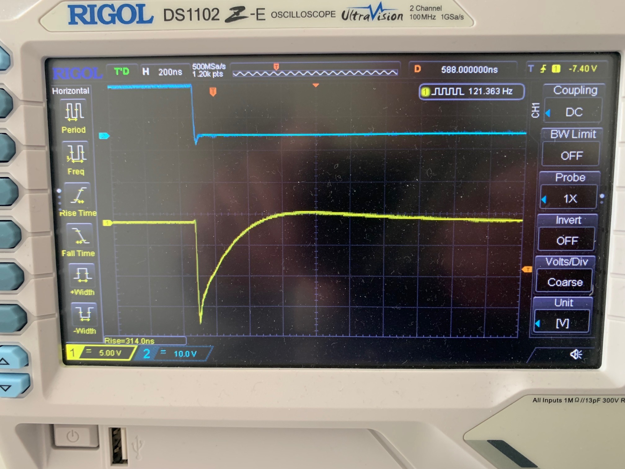

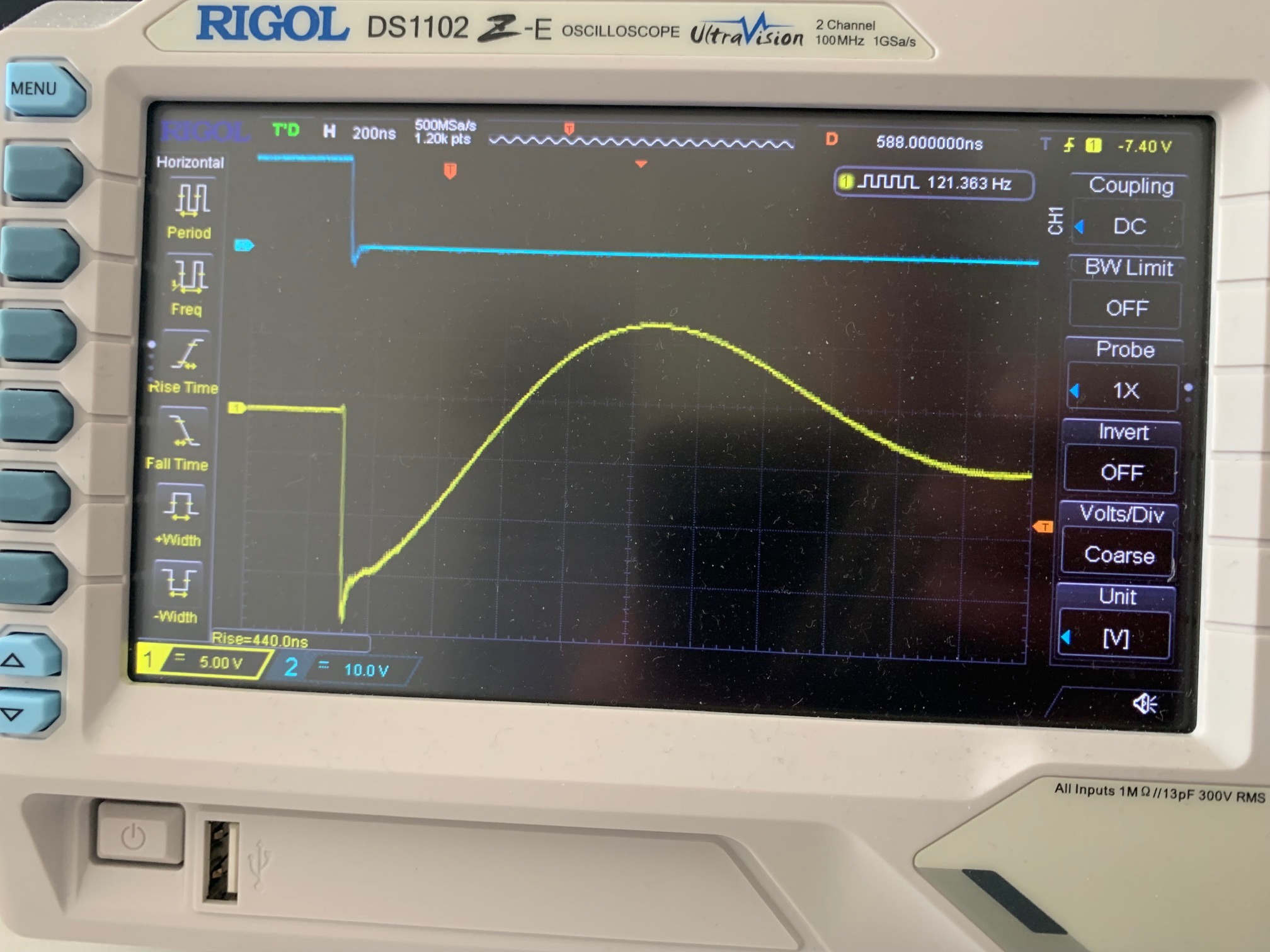

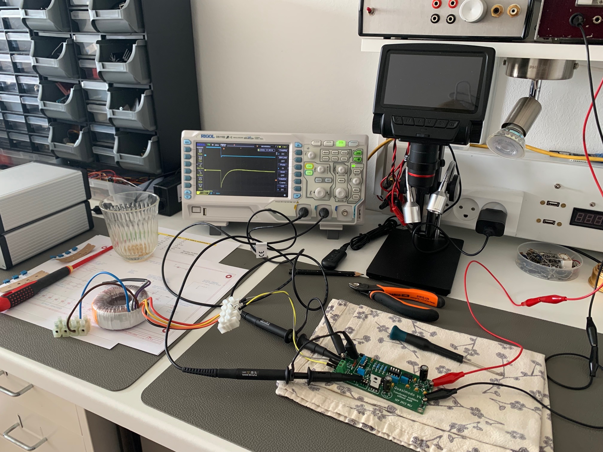

Hi all.

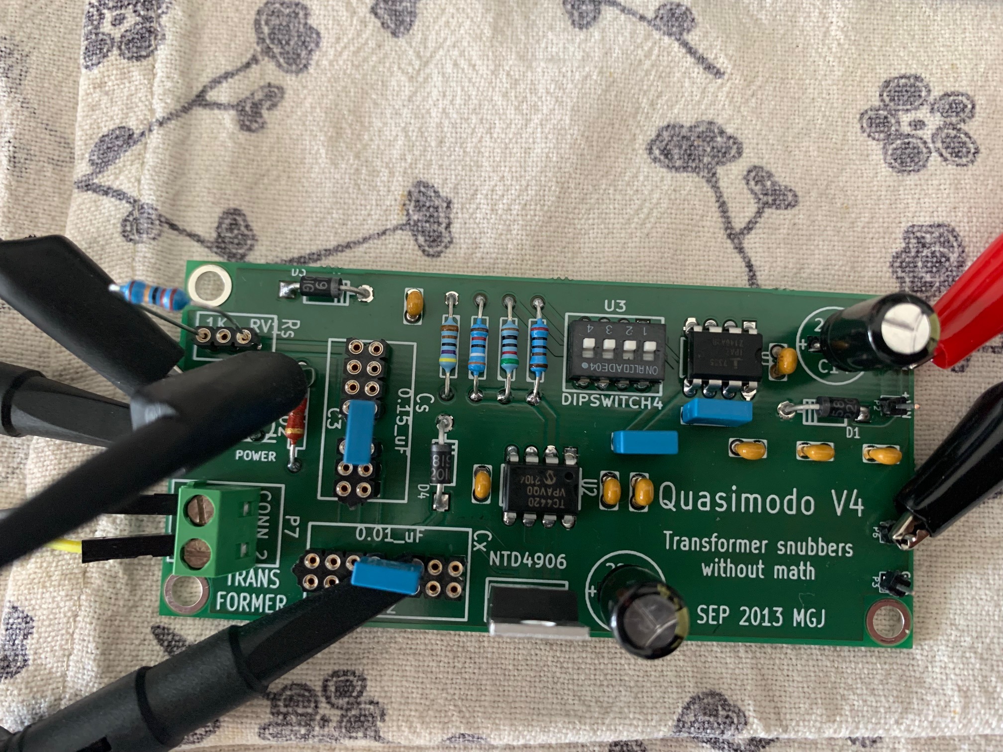

So i had my board's produced, and today i assembled one of them.
First test is an Talema 2x6v (parallel) with primary tied together as pr. the Quasimodo .pdf (Talema 91227-P2S2)
(The trace are flat when potmeter is at ~26ohm, so i tried an 22ohm resistor, and look's like its good)
I have attached shoots here, with text to see what i did.
But eventhrough i see that the scopetraces don't care when switching frequenzy, i fell that it was better to start with 100Hz here in EU? - Can somone explain why it obviously don't matter.
I have read a lot, especially around this post here Link! - Ahh... just need some little explanation 🙂
Jesper.

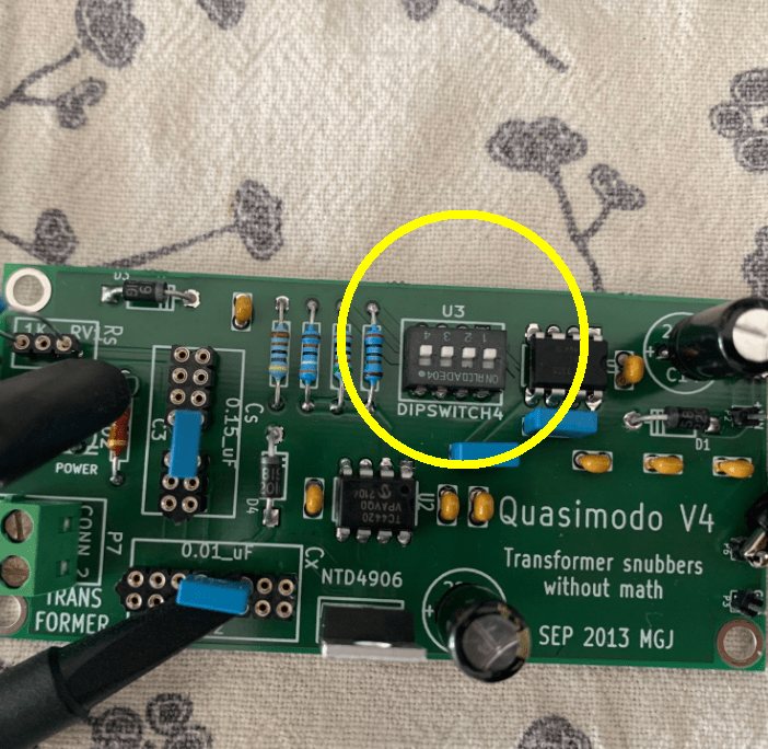

Take a look at the V.4 Quasimodo schematic -- you'll see that its DIP Switch lets you select four different stimulus frequencies. First, measure these four frequencies. (Measure the period of the waveform in oscilloscope grids, then frequency = (1/period)).
Then, using the same transformer in each experiment, operate Quasimodo four times: once with each of the four different stimulus frequencies. Find the optimum four values of Rsnub, at these four frequency settings.
Do the answers make you say "Eureka!" ??

Hi Mark... Thank's for the reply 🙂
I allready did change the dipswitch (see picture names & on the scope pictures)
I also see, that the trace do not change, when changing freq. that is!
But i need some explanation why it is not better to start out with 100Hz here in EU, instead of 120Hz, when we know, that the diodes are triggered at that freq. here?
Maybe i need a kick to understand this?
Jesper.
Jasper,
The frequency of the square wave is irrelevant for the ringing itself and Chosen to support scope triggering for a stable picture. The ringing itself is started solely by the square waves‘ EDGE!
When you see the dampened oscillation starting at the negative going edge, you just do the Pot tuning to achieve the minimal ringing as described.
Hope this helps!
Winfried

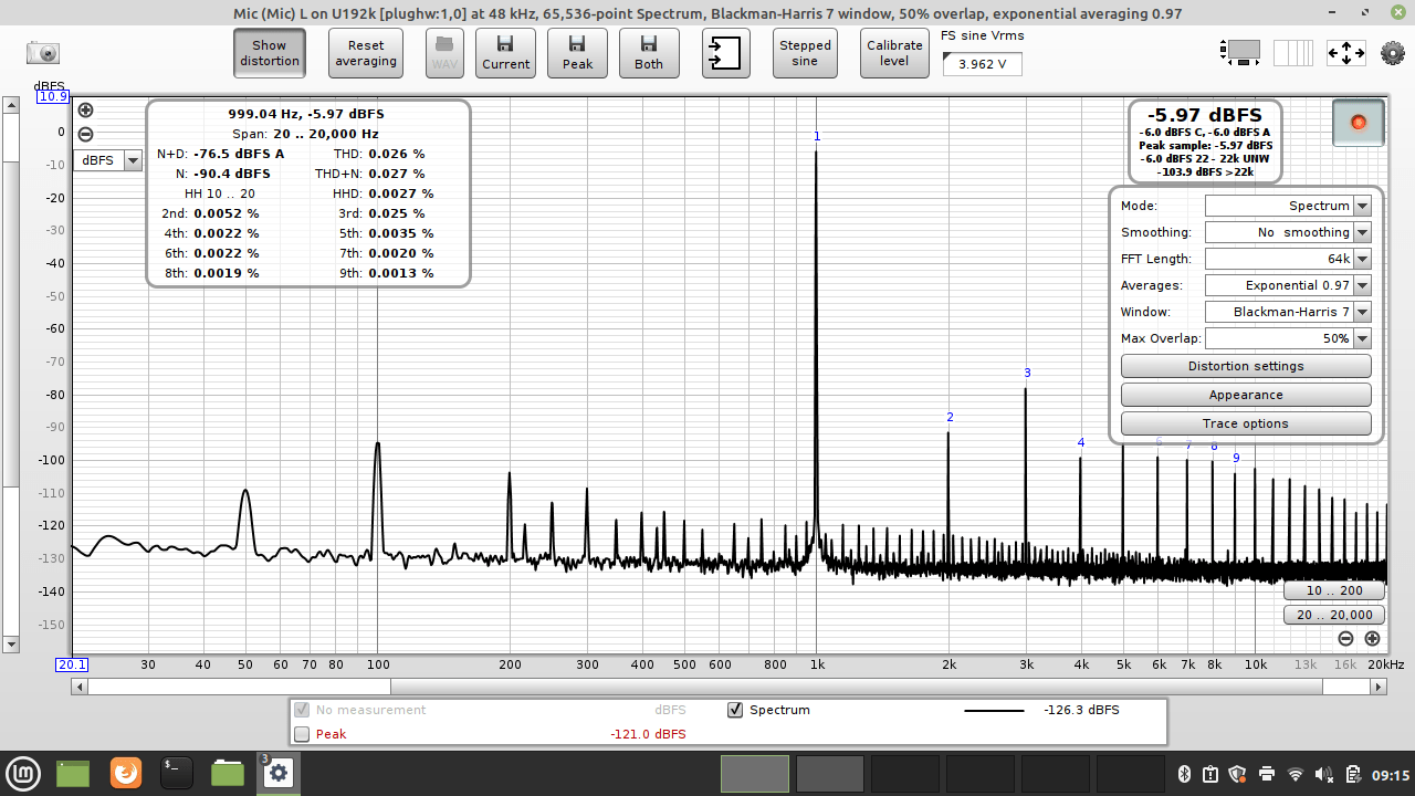

I allready posted this in another thread, but for the sake of it i will post it here to. Link!
I have this CloneAmp. which i do a lot of experiementation on 🙂 and adding snubber's are doing a great job cleaning up some of the noise from this little amp.
Pictures speak for themself.
Jesper.

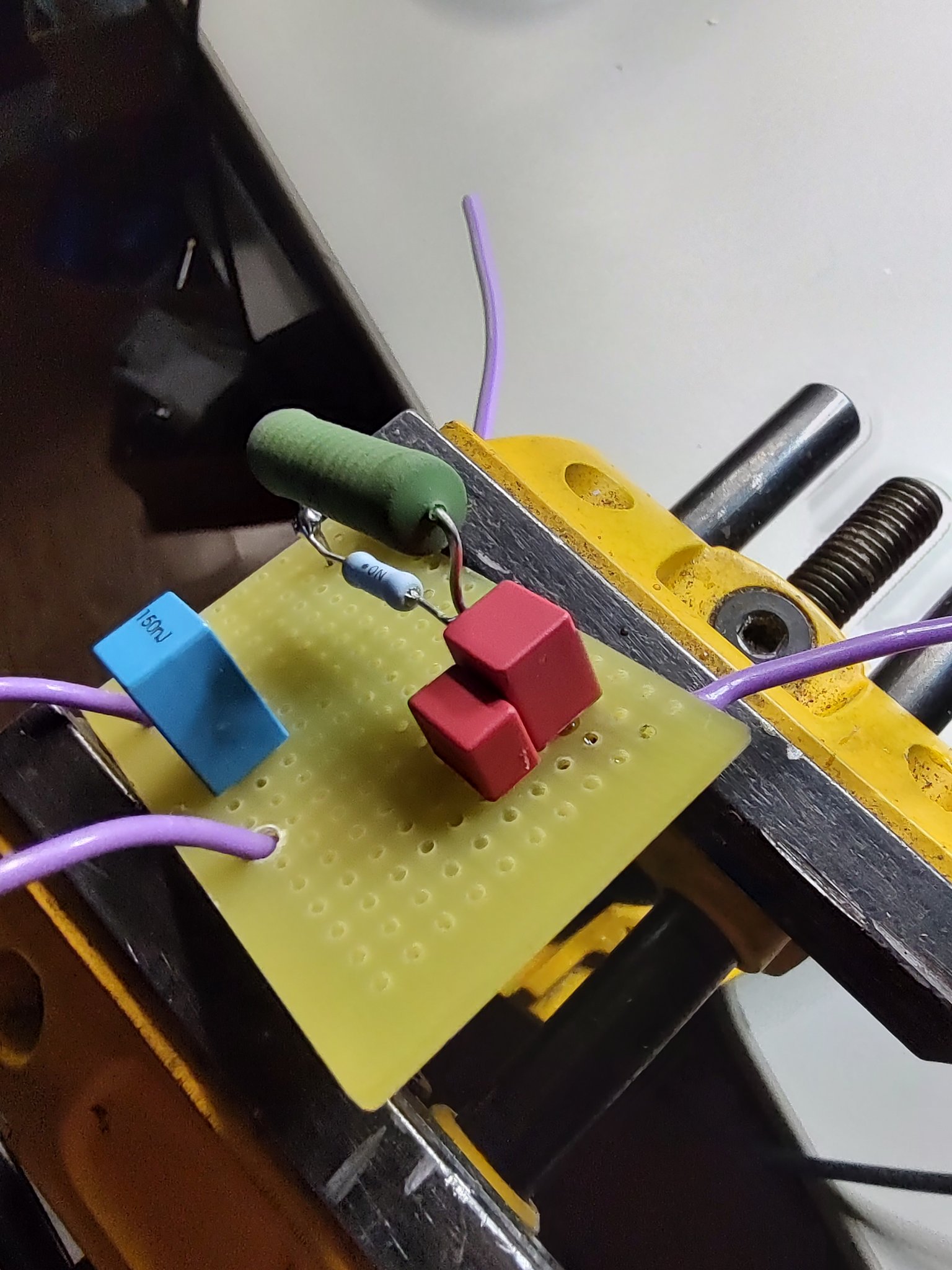

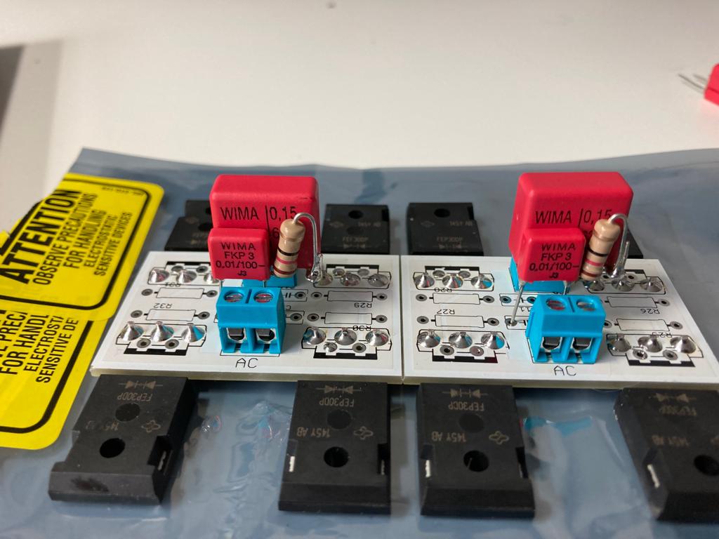

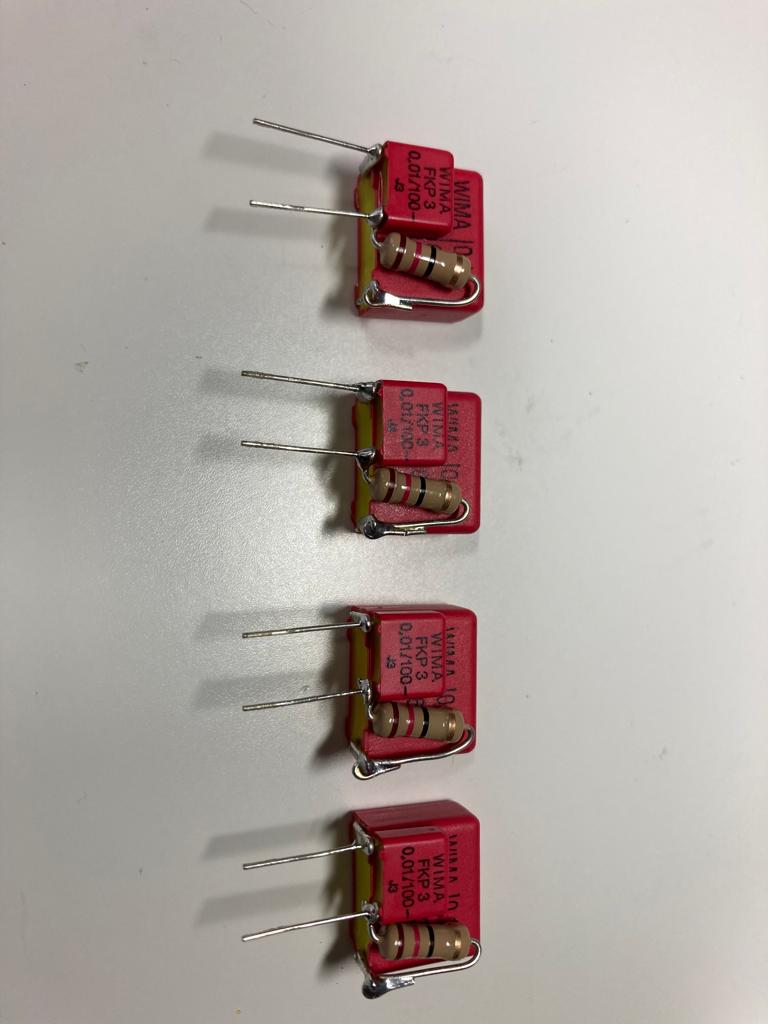

I just built some snubbers for my Toroidy 300VA (dual mono F6). The Quasimodo gave the same measurement on my scope (12R resistor) as mentioned in the results thread.
Now I need to figure out if I can stick them in Tea-bag's boards ...
