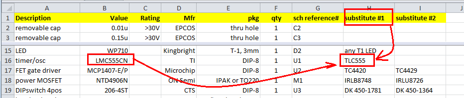

I think it should be a 555 in CMOS technology to make use of the feature "output capable of swinging rail to rail".
from the Quasimodo docs:
The 120Hz oscillator uses a CMOS 555 with rail-to-rail output swing, for
the same reason: a non-CMOS 555 chip’s output only swings to VCC – 2VBE, which spoils low
voltage operation.
(and the NE555P is IMHO not in CMOS technology...)
I was in the same problem not to find a CMOS version as a THT part at the moment,
therefore I ordered a SMD [SOIC-8] part (https://eu.mouser.com/ProductDetail/595-LMC555IM/NOPB)
and an additional breakout board "Adafruit 1212" (https://eu.mouser.com/ProductDetail/485-1212) [https://www.adafruit.com/product/1212]
Reactions: starcat
Think of it as a teachable moment: different companies sometimes use slightly different part numbers for the same basic chip. So it's worth looking in DigiKey's Parametric Search for other chips with the same features (here are more than forty) , and now that you know the part numbers, check octopart.com for availability. You'll want to avoid the non-CMOS chips, of course.
And oh by the way, the thru hole BOM attached to post #1 in this thread, does suggest a substitute part number for CMOS 555. It's been attached there for more than eight years, anyone interested can read it whenever they wish. Fortunately, Newark has (610 of them on the shelf) . Now there are than one possibility: ICM7555, TLC555, et al.
