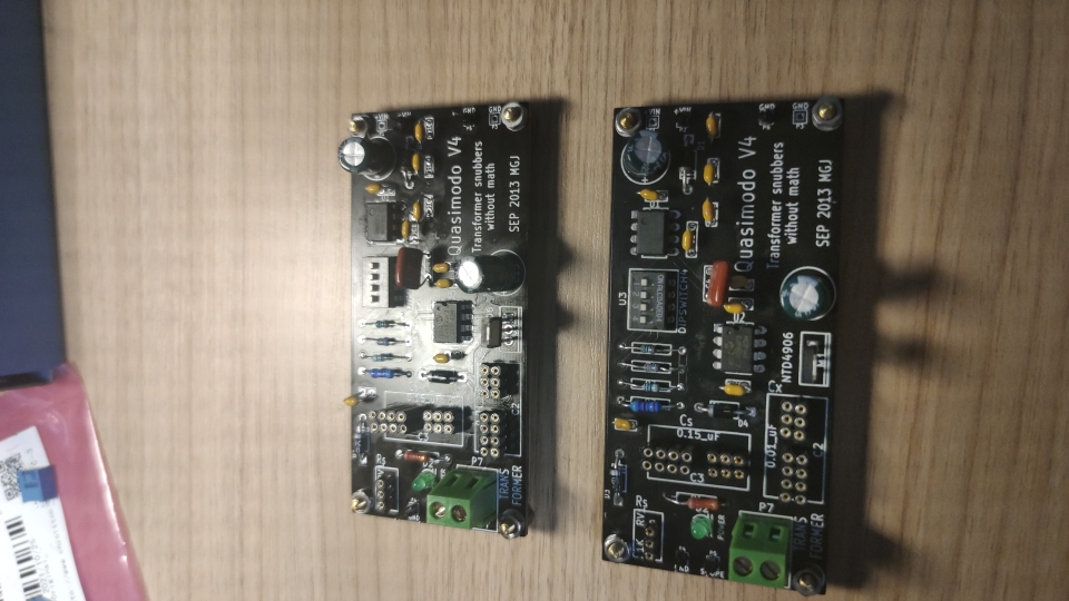

I made my own board and it's working as expected, I believe, as I've confirmed a measurement on a specific model and configuration done by merlin el mago in the results thread. I wished more of the measurements would mention configuration, ie. series/parallel/center tapped, but that may be because I'm new to this snubbing.
There's a few things I'd like to clear up, which I may figure out on my own while playing around with it a little more. Otherwise I'll ask here. Answers may be in the thread but it's a lot of pages to go through.
Thanks for your excellent work, Mark!

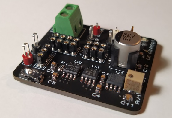

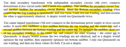

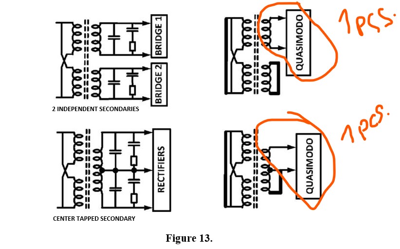

Hello everyone, finally I also put together a wonderful device Quasiomodo, Mark thank you for your work. Everything is super and it works, but in my main transformers with two secondary windings, independent and with a common central wire.
I read the documentation and do not understand, it is stated that for such transformers, 2 pieces of Quasiomdo are needed, but the pictures indicate that the secondary windings that are not measured are short-circuited, either to each other or to the center wire.
Although the text indicates that you need to connect 2 pcs. quasimodo, but at the same time short-circuiting, I do not quite understand. I ask you to prompt and excuse the curve of the test. I am writing through a translator.
Hi traktoris
Welcome in the club of us happy campers pampered with marks genius little jigs!
Text says that you need two snubbers, not two quasimodos 😉
You don’t need two quasimodos, you have to short all secondaries not being measured.
So, you connect the first sec and short the second, then you swap, short the first and connect the second. Etc.
(Not sure if connecting the second secondary even would alter the result?)

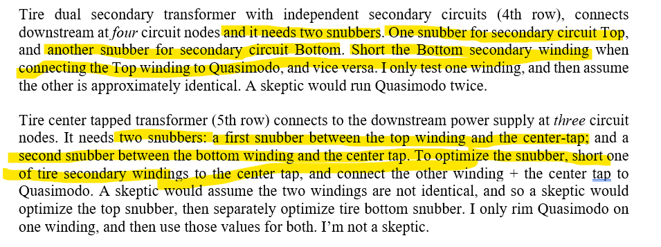

One (C + RC) snubber circuit for secondary wire-pair A, and one (C + RC) snubber circuit for secondary wire-pair B.
A total of two (C + RC) snubber circuits.
Only one Quasimodo tester PCB is required. First connect it to secondary wire-pair A, and short together ALL OTHER TRANSFORMER WIRES (including all primary wires and all secondary wires). Perform Quasimodo testing and find the optimum R value for secondary wire-pair A.
Now disconnect Quasimodo from secondary wire-pair A.
Connect Quasimodo to secondary wire-pair B, and short together ALL OTHER TRANSFORMER WIRES (including all primary wires and all secondary wires). Perform Quasimodo testing and find the optimum R value for secondary wire-pair B.
Success! Two snubber circuits, one Quasimodo tester PCB. Exactly as member @myleftear has explained.

Ninjaed by myleftear while typing but..

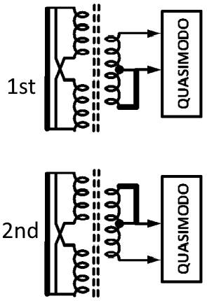

You measure the first secondary, while the other secondary is shorted. Then you move the Quasimodo to the other secondary, while the first is shorted.
The documentation shows how to measure the different configurations of a transformer. How you measure it depends on how you intend to use it, ie. if you intend to parallel two secondary's in your product, then do your measurement with the secondary's in parrallel.
Or if you intend to use two secondary's in a center tap configuration, then you first measure between the top winding and center tap, while the bottom winding is shorted to the center tap, then you measure between the bottom winding and center tap, while the top winding is shorted to the center tap. (see image)
And so on for the other configs.
Remember to short the primary, and keep leads short. Long leads or not shorting a secondary or primary does affect the result somewhat.

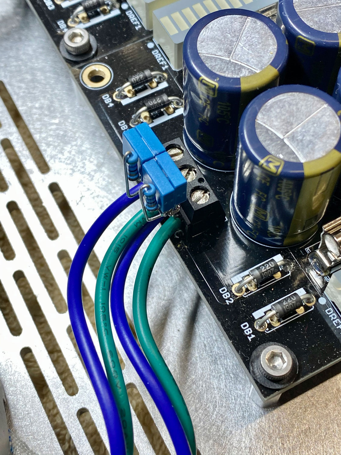

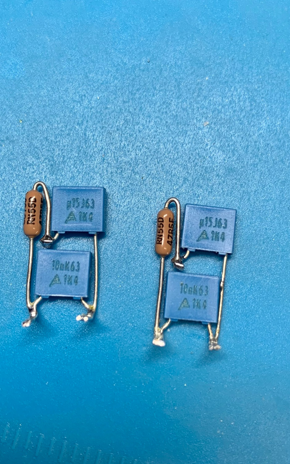

Besides the perfect how-to measure instructions above... here's an actual application of part of fig.13. in situ.
What is the stabilizer in the photo, if not a secret?
Not sure what you mean by stabilizer? I just worked with the legs of the caps and leads from the resistor etc. making the connections. Little bit of glue between the caps. No secret. I looked for a more clear image... I didn't take on at the time. Just followed MJ's drawing in fig.13. Bent the leads at the bottom after everything was soldered up to slot into the connectors....
darn that's beautiful, farrell!
(as always actually 😀)
My phonyphone and my inadvertedness bungled your screenname, apologies!
