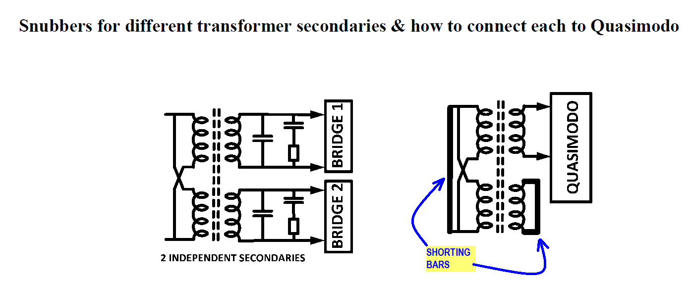

Simple, no-math transformer snubber using Quasimodo test-jig
Figure 13 on page 11 of the Quasimodo design note will help. Thick black lines indicate "shorting bars", i.e., transformer terminals that need to be shorted together during Quasimodo testing.

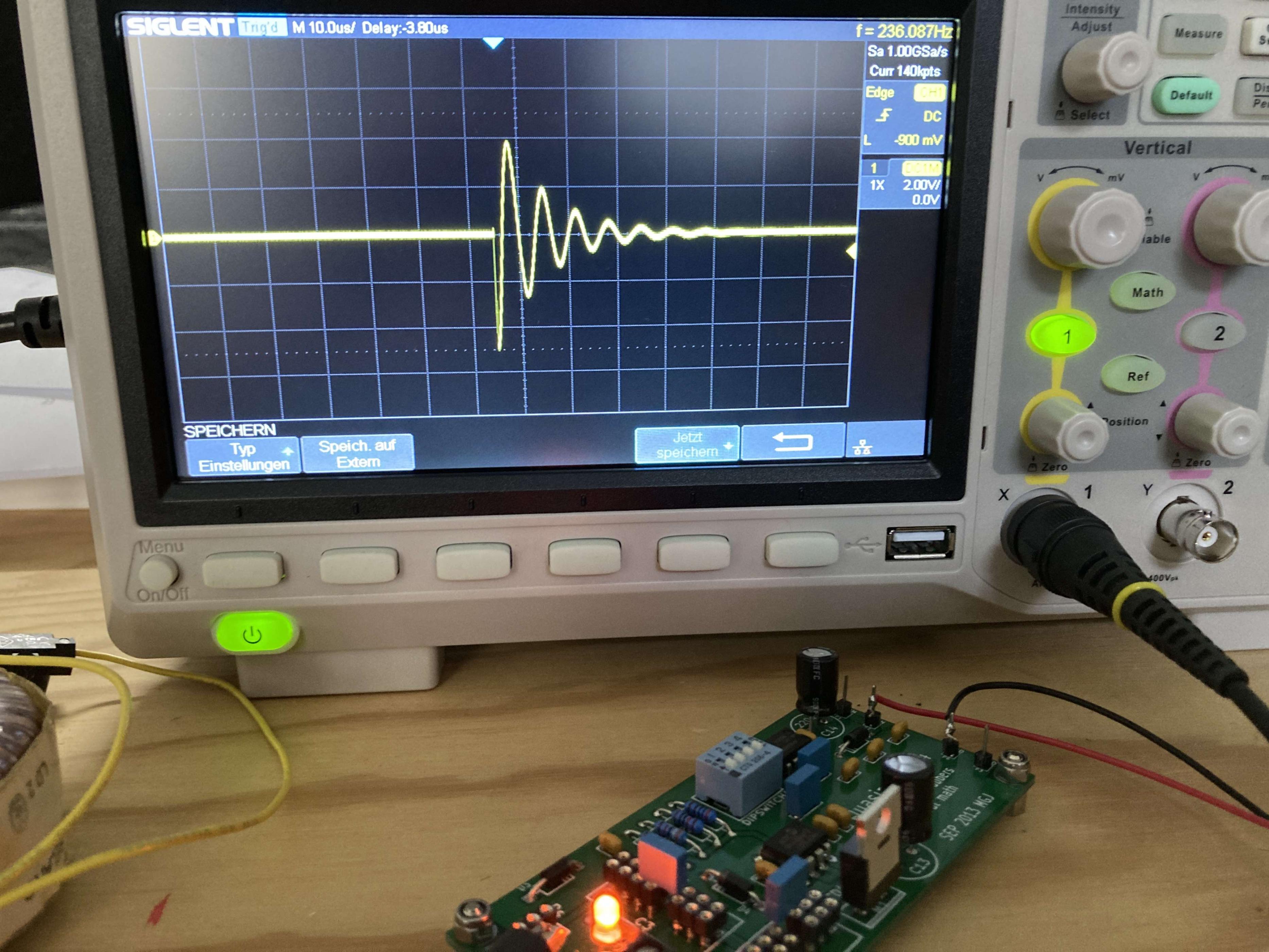

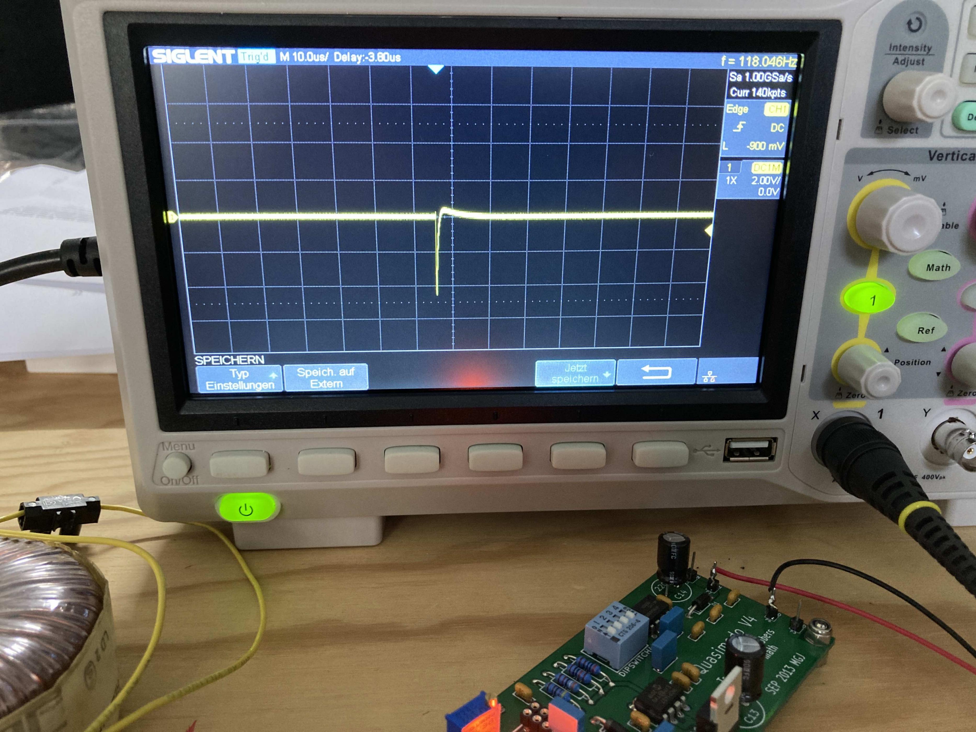

I think I am quite close to a valid result on a toroid.
I have
Cx 10nF
Cs 150nf
Rs 46R
A variation with Rs = 36R seems to be good too. Not sure where the sweet spot is? Practice!
The curves are below.
(Screenshot-export not yet figured out, but I'm closing in)
@myleftear - neither of those are correct. Be sure you look at page 1 and download the notes from Mark and read them. The top picture is underdamped, the bottom picture is overdamped from what I am seeing.

.. but your second 'scope pic is pretty close. 😀
I'd say you're doing pretty good for just 'getting the hang of' an excellent new 'scope!
Was the 2nd trace the 36 or the 46 ohm resistance? If it was the 36, then 46 ohms is probably just about right.
Are you using a potentiometer to find the sweet spot?
Thanks to everyone helping me!
Rick, the underdamped one is actually undamped (trimmer removed).
With the overdamped one I wasn‘t sure about where to stop. I of course read the manual (omitting the „f“ in the acronym)
I use a Quasimodo V4 with everything on it, thus it is a 1K trimpot.
But I obviously didn’t catch the sweet spot‘s signs. Is it more like „make the curve look like this“ or rather „make the curve not go into a „flat-but-still-present-negative-curve“?
Cheers
Thanks Rick 😀
It was 46 R.
I had a 36 R result too, and although it was very close to the 46 R variant, it seemed better to me. but didn’t pictured it. And it wasn’t the shape Jim advised me…
