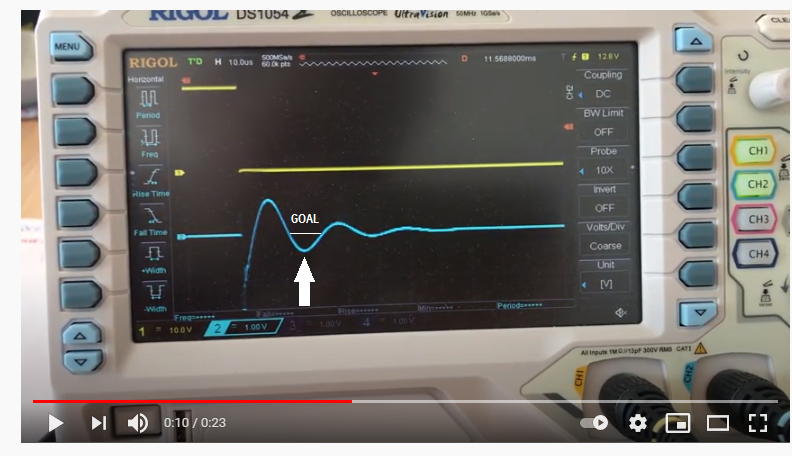

Wave interpretation - video - RIGOL DS1054Z
I‘ve recorded a video
Quasimodo V4 Snubber - YouTube
of the measure of an AUDIOPHONICS transformer with 2 x 115 V primary and 2 x 9 V secondary, 30 VA. The video starts with RS = 2.5 ohms and ends with 33.8 ohms. First half of the sine wave increases at the end of the video. Please give me an advice if I do everything right and what’s the optimum point I should use for taking resistors measurement.

Good idea to take a video, Ronny. Unfortunately the potentiometer made a "hiccup" right at the crucial moment, namely the video timestamp 0:10.
What you want to do is smoooooothly and sloooooowly turn the pot while watching the bump-down on the oscilloscope. See arrow on attached image. You want to slooooowly reduce that bump-down until it juuuuuuust goes flatline. Until it hits the goal I've marked in the photo.
Ten-turn and twenty-turn trimmer potentiometers don't usually hiccup that way; maybe you can unplug your trimpot from the board and slap it down on the tabletop to jostle it back into alignment. Or even try a different trimmer. If your optimum reading is something like 60 ohms, you can use a 100 ohm trimmer (for example) and get super fine granularity.
MJ

Hi Mark,
thank You so much for answering me. I want to tell You that unfortunately I‘ve soldered the MCP1407 the first time in wrong direction (marking!), but I don’t have driven the unit that way. I think it’s important to tell You the complete story 😉 Hope this has no impact 😱 Currently my properly filled electronics part box
doesn’t contain low value potentiometers. I’ll order some of them or try to connect some resistors parallel or in series to get the flatten curve. Kind regards from Grafenau (Wurttemberg) Ronny

Ronny, a 1K trimmer will work fine, you don't need smaller resistances. But if you're ordering parts anyway, I recommend spending a few additional Euro and buy a 200R trimmer and a 100R trimmer in addition to your second 1K trimmer. The smaller resistance trimmers merely give you finer grained control near the optimum.
Hi Mark,
I‘ll follow Your advice. What do You thinking after watching the video. Could it be that the MCP1407 was overheated during unsoldering, new positioning and re-soldering because of my former fault? Maybe it’s difficult to answer but I‘m sure if someone knows than You 😉 There is probably a chance to test if that this part is still working properly.
