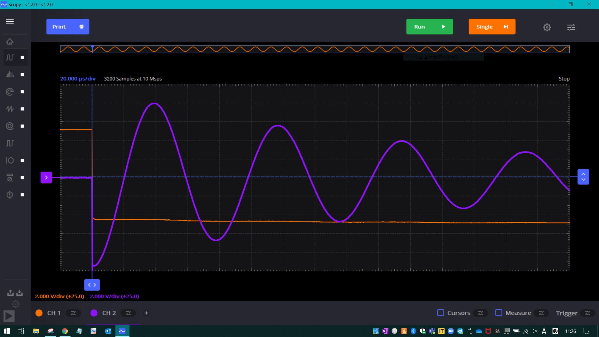

Yes. Your damping ratio Zeta will probably not be optimum (Zeta=1.0), but exactly copying other people's Quasimodo results (Cx=FirstNumber, Cs=SecondNumber, Rs=ThirdNumber) for the same transformer, will probably do more good than harm.

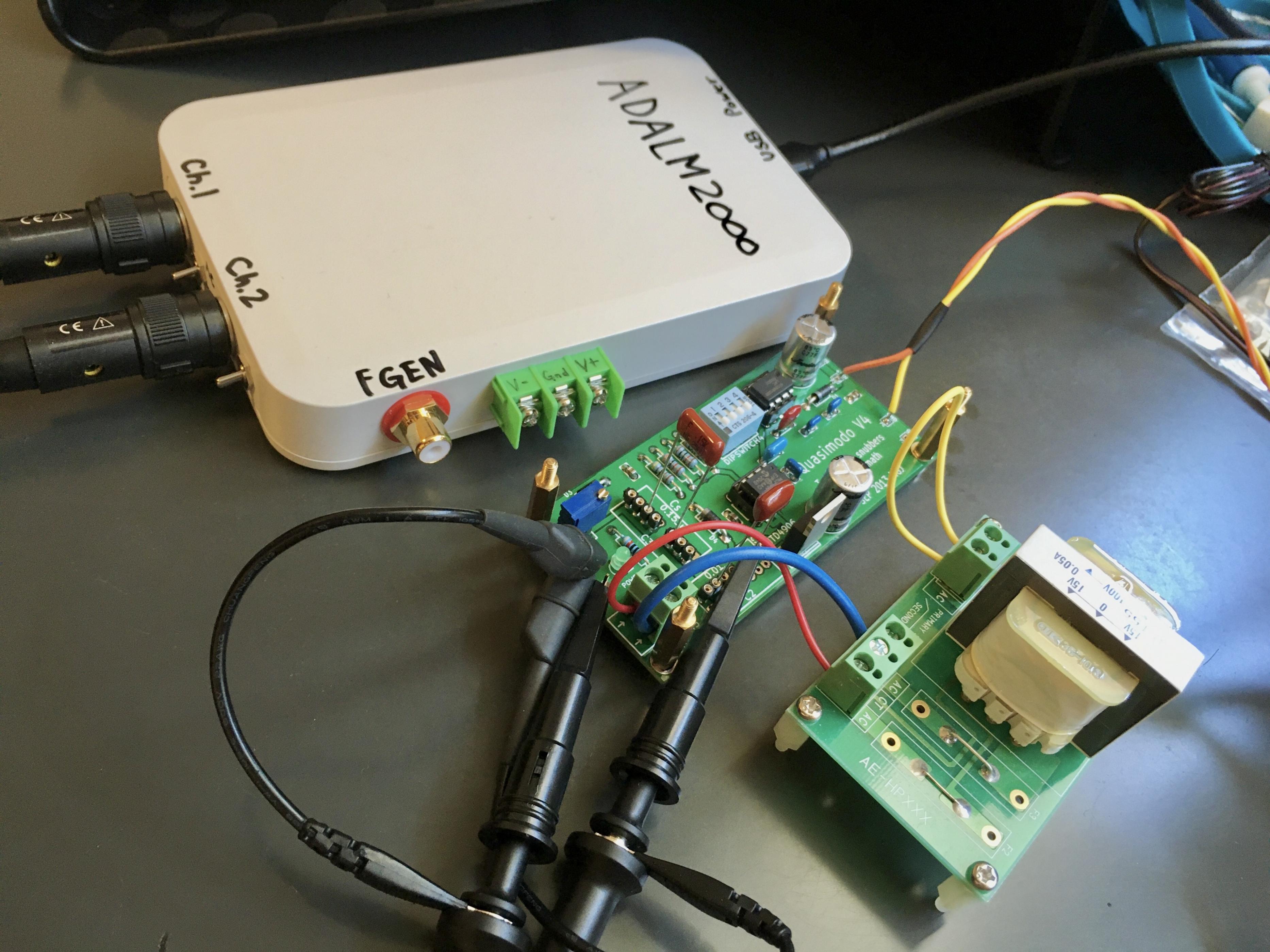

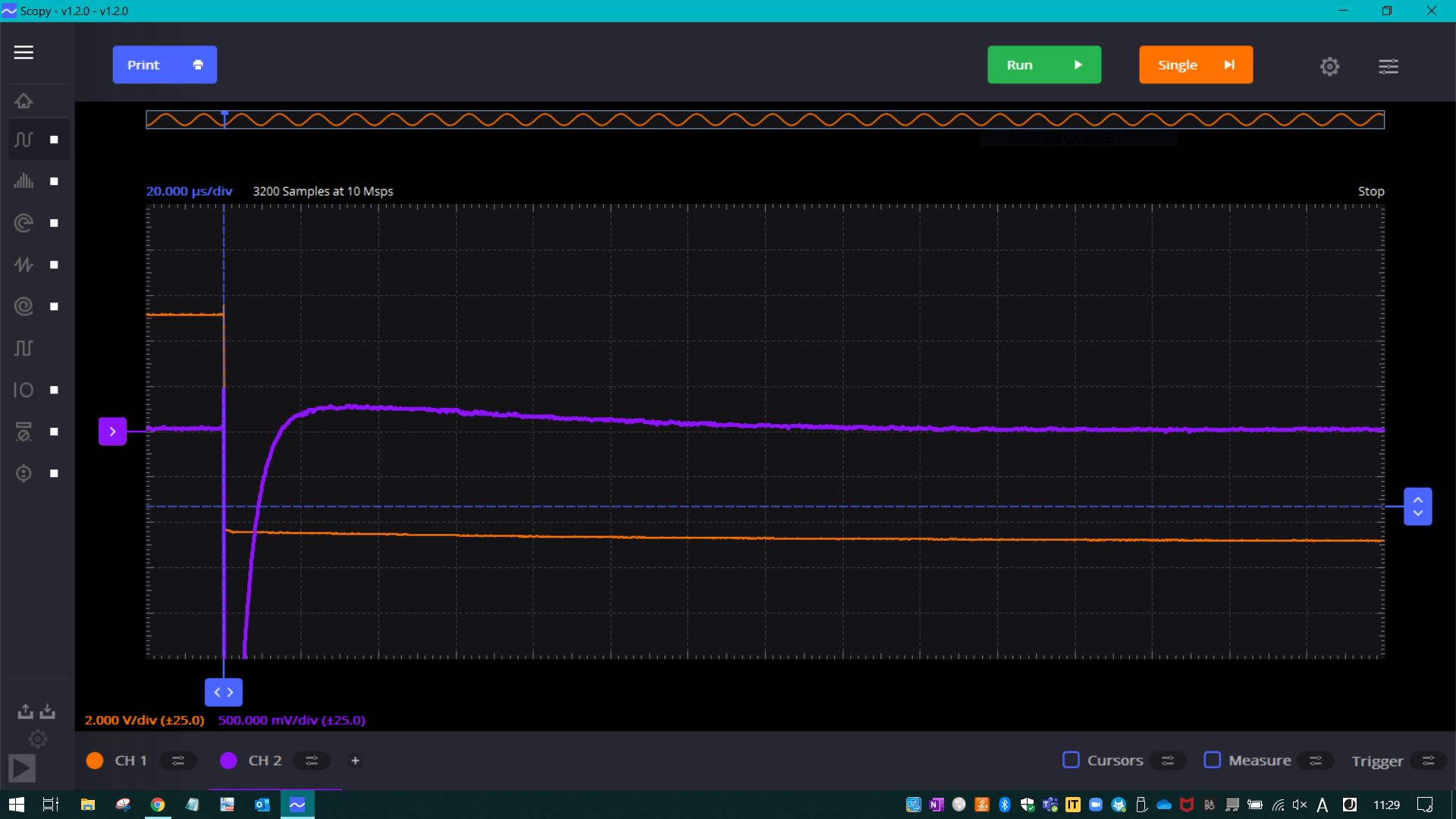

I built my Quasimodo today.
It seems work fine.
Thank you Mark.
Now I can sleep better.

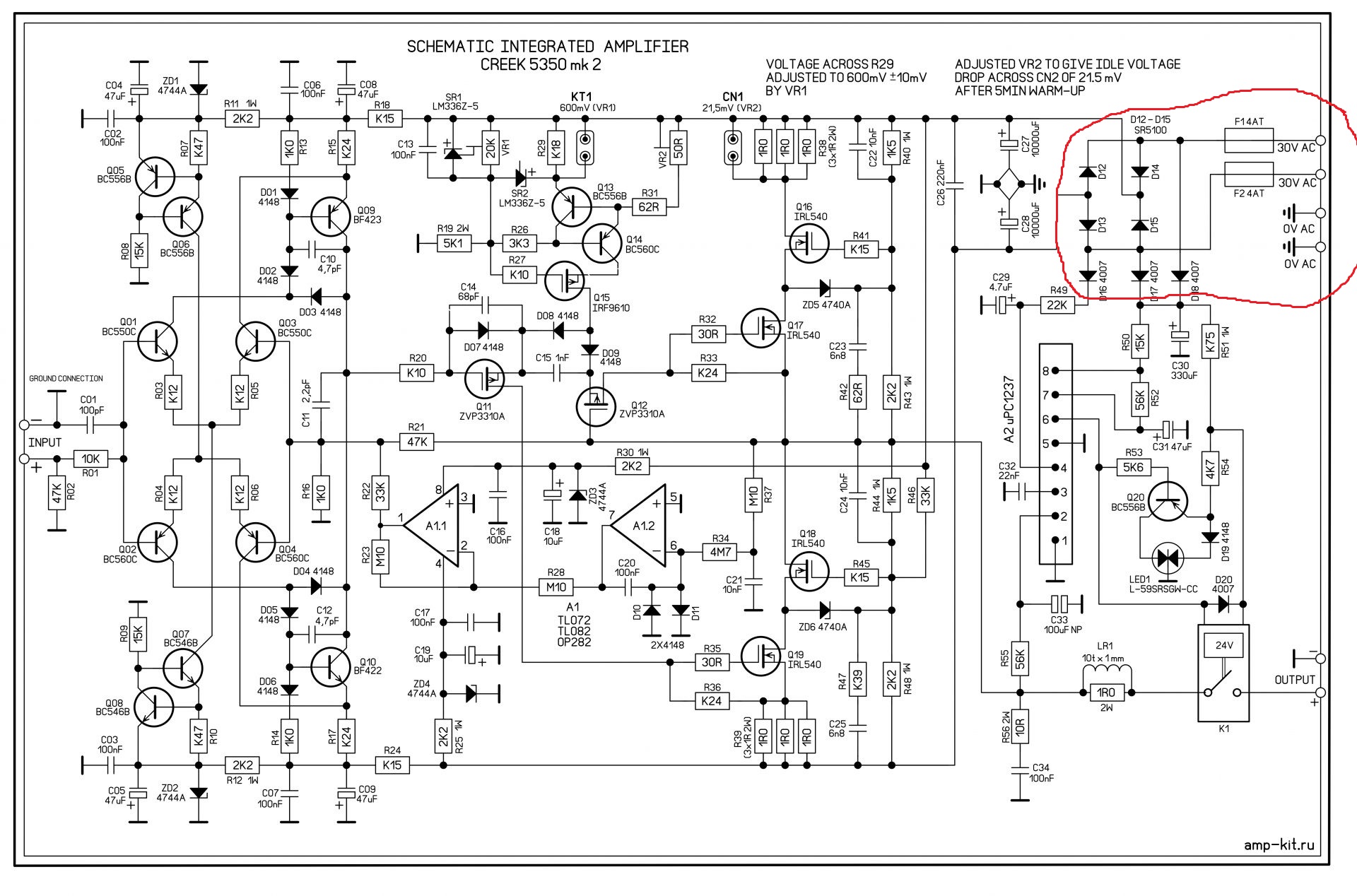

Another question:
1.Is it correct that if I have a transformer with a common zero input (figure 5), then for normal tuning it is better to assemble 2 pieces of quasimodo?
2. In the picture, the amplifier circuit that I will use, I understand correctly that there are no filters in the circuit in front of the diode bridge and it will be very useful to use a filter selected using a quasimodo CRC?
The transformer is made to order (200 watts) with outputs for 25 and 32 volts, for use with different amplifiers.

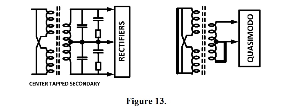

Would anyone like to offer opinions and advice about these inquiries? {I have made slight edits to the phrasing.} The collective wisdom of the diyAudio readership, vastly exceeds the wisdom of any one person.
1.Is it correct that if I have a transformer with a center tapped secondary, then for normal tuning it is better to assemble two complete C+RC snubbers? So I need a total of 4 capacitors and 2 resistors?
2. In the original amplifier circuit that I am copying (Creek 5350 mk2), there are no filters and no snubbers in the circuit, between the center tapped power transformer and the diode bridge. Do you think it will be very useful to install two complete C+RC snubbers, selected using Quasimodo tests of my transformer? The transformer is made to order (200 watts) with outputs for 25 and 32 volts, for use with different amplifiers.

Hi Traktorist3d,
While I have little collective wisdom and am not a socialist, I'll have a go:
1. Yes. Yes.
2. Yes.
And it's a fun bit of kit to build and apply, and it saves your calculator batteries. Try it, you'll like it ..😉
