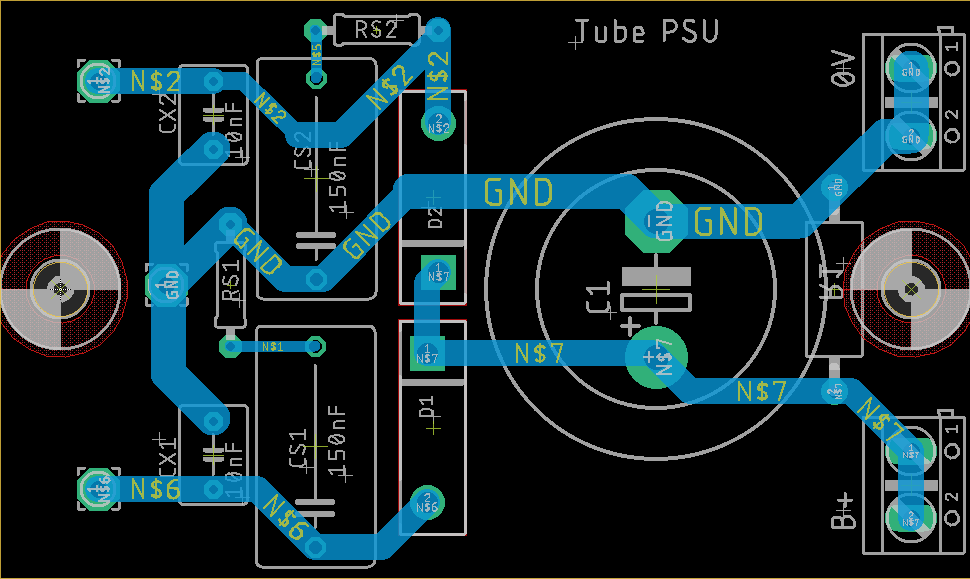

I have a draft for a PCB to hold the snubbers, rectifier diodes and 220uF main filter cap.
It would be great if someone can double-check that the layout is correct, along with any other improvements or suggestions to the layout.
The mounting holes and PCB size are intentional, to fit on top of the power transformer mounting tabs.
edit: also wanted to mention the rectifier diodes I chose are TO-247 soft-recovery ISL9R30120G2 (Mark's "belt and suspenders" approach).
I assume that at 30A rating, they won't need heatsinking for the 100mA B+.

As you two seem to be most active here lately, any glaring issues with that PCB layout?
Are the snubbers laid out correctly with regards to the Center-Tap (which ties to the capacitor neg pin). ?
Any recommendations to make that look cleaner, I'm not sure happy with it.
I think you want all three wires of the transformer secondary, to solder directly onto your snubber-and-rectifier board. You want the snubbers to be as physically close to the transformer as possible, and that includes short wires, and that includes a short center tap wire.
It certainly has a lovely symmetry.
I once got scolded for top-side foil to a flush-mounted part. Plus, since it's the ONLY top side foil, I'd look for a way to eliminate it. Either using a jumper (it's no sin -- some amazingly complex boards have come from Japan, for example, with scads of jumpers -- single sided foil), or moving the lower rectifier so that it straddles the ground trace.
By the way, where is the connection for the transformer center tap?
Otherwise, it looks correct electrically.

In the previous layout, the transformer CT was intended to connect to the 0V terminal at the output of the filter cap.
Here is a new version, it seems better to me but I can count the number of PCB's I've "designed" on one hand so would definitely appreciate another opinion.
All the transformer wires now connect to the left side and all traces are on the bottom side.
Due to room constraints, the bleeder resistor is mounted on the opposite side of the board.

The way you have it looks OK to me. Are you sure the body of the bleeder resistor has clearance on the transformer frame?
I did a little mark-up, in case you haven't already sent off the Gerbers. The performance improvement would be tiny -- likely unmeasurable. But there is a small advantage in serviceability. Yours is fine, though.

The resistor shouldn't be a problem, that PCB sits on two 19.05mm standoffs (for clearance of the wires).
I have not sent them yet, so can definitely make any improvements if needed.
Can you please explain the reasoning behind the change? My EE knowledge is very limited.
I routed it like that because I thought it was a similar case when laying a CRC PS filter. e.g, you want the trace to exit the last cap (and not through the resistor pad), to ensure that no frequencies bypass the cap and go directly from the resistor.
The charging pulses through the rectifiers are the big ones. They deserve the heaviest, most-direct traces.
The current pulses through the snubber networks, though higher frequency, have the advantage of a path already containing resistance to provide damping.
Providing little offshoots of a heavy path improves solderabilty. Plus, in a pinch, a tech can score the offshoot to disconnect that part, without impeding the rest of the circuit's function.

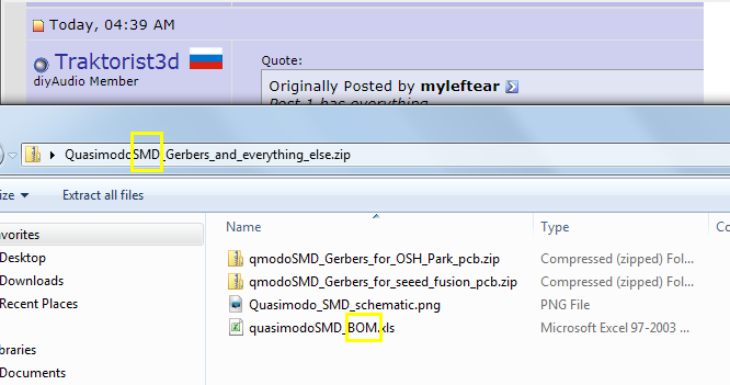

Download the "everything" .zip archive of the board you are interested in. "V3" is surface mount and "V4" is thru hole. Both are attached to post #1 of this Forum thread.
Save the .zip archive on your computer (not yet in the cloud).
Open the .zip archive. For V3 you will see the same thing as Figure 1 below.

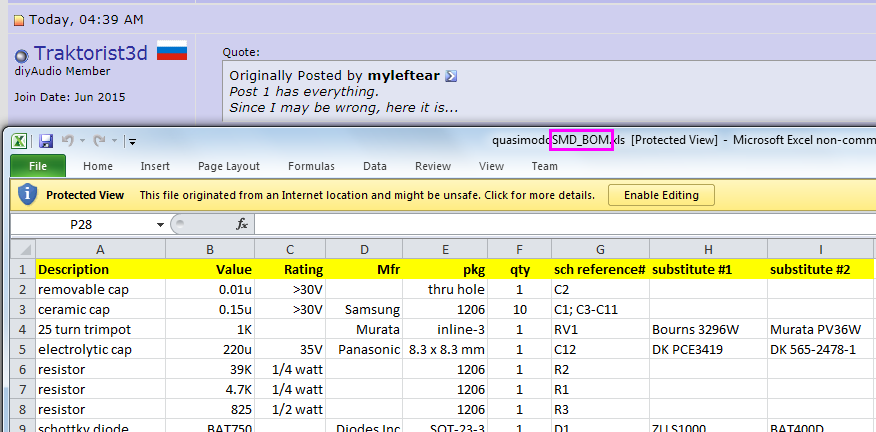

Find the Bill Of Materials (abbreviated "BOM"). It is a Microsoft Excel spreadsheet and for me, on Windows it opens just fine.
You will see the same thing as Figure 2 below.
