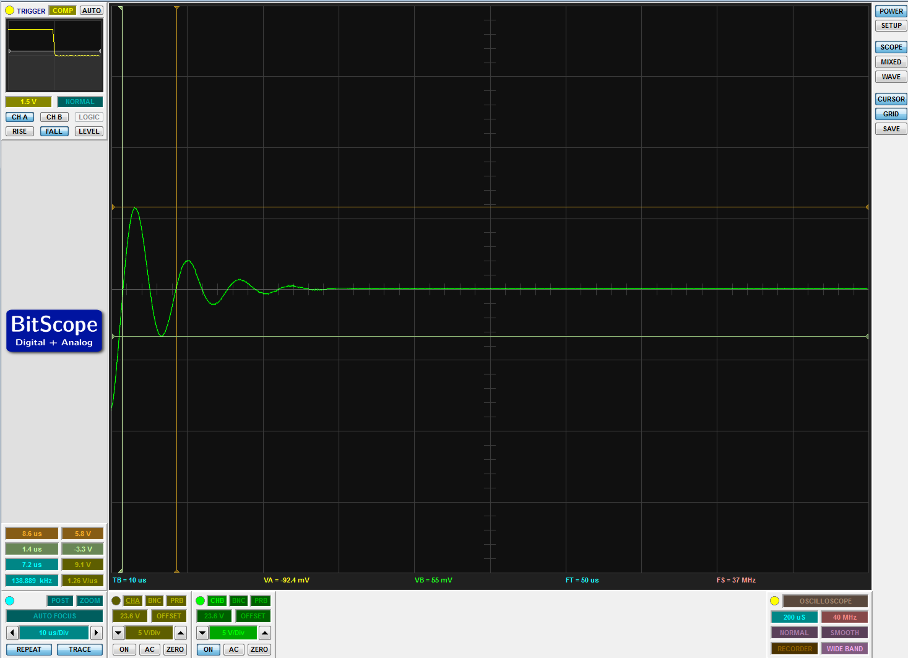

First measure with my new RIGOL 1054Z, without variable resistor Rs:
Ronny
Great job Ronny! Since you've got the two channel display, you definitely want to set the scope to trigger upon the yellow-trace channel's falling edge. Being a perfect square wave, it is completely unambiguous where the trigger event MUST be. Unlike the blue waveform, the yellow doesn't ring-a-ding-ding above and below the potential trigger level.

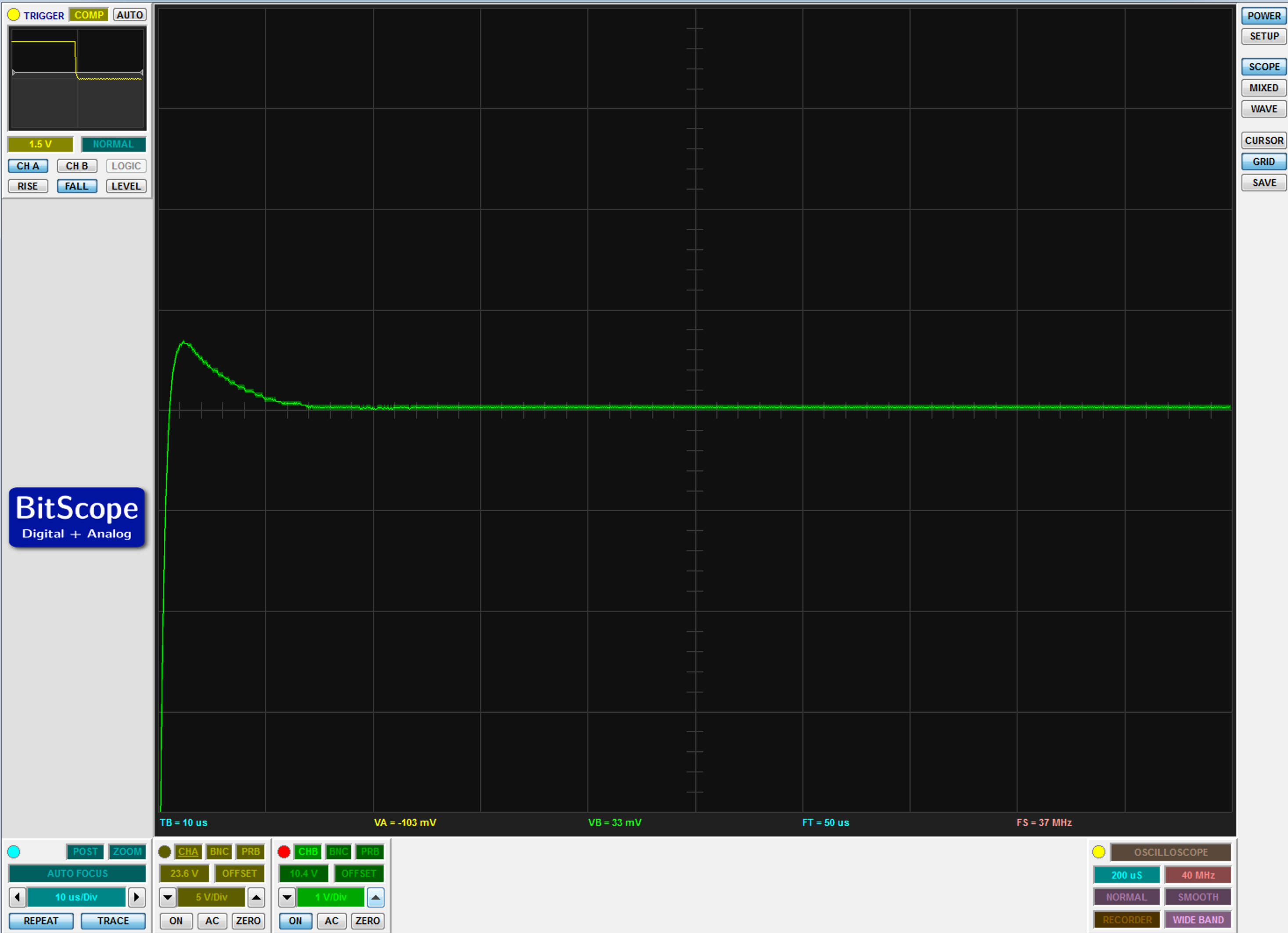

I found out that I forgot to short out the primary side of the transformer before the measurement. Once it is shorted out, the snubber resistor value is now at 47 ohms instead of 10 ohms. I also used ch 1 to trigger on the falling edge of the pulse and ch 2 to do the measurement. Here are the screen shots:
Vertical division is 5v before the adjustment. Vertical division is 1v after the adjustment.

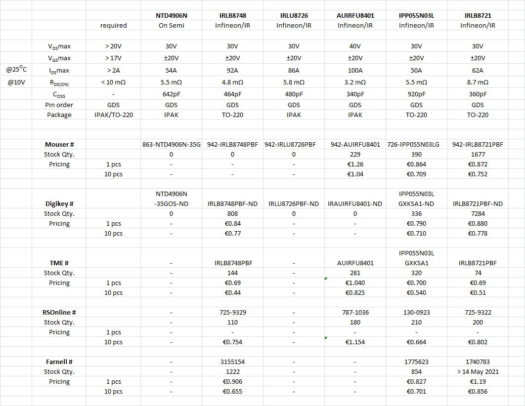

Related to that, the MOSFET in the original design (NTD4906N, IPAK package) and the listed substitutes in later BOM (IRLB8748 and IRLU8726, both TO-220 package) are no longer available at Mouser.
So I did a survey based on the required parameters provided by Mark in an early post, and found some suitable available substitutes:
Attached an overview of basic specs and an overview of availability and prices (excl. VAT) at the big 5 suppliers.

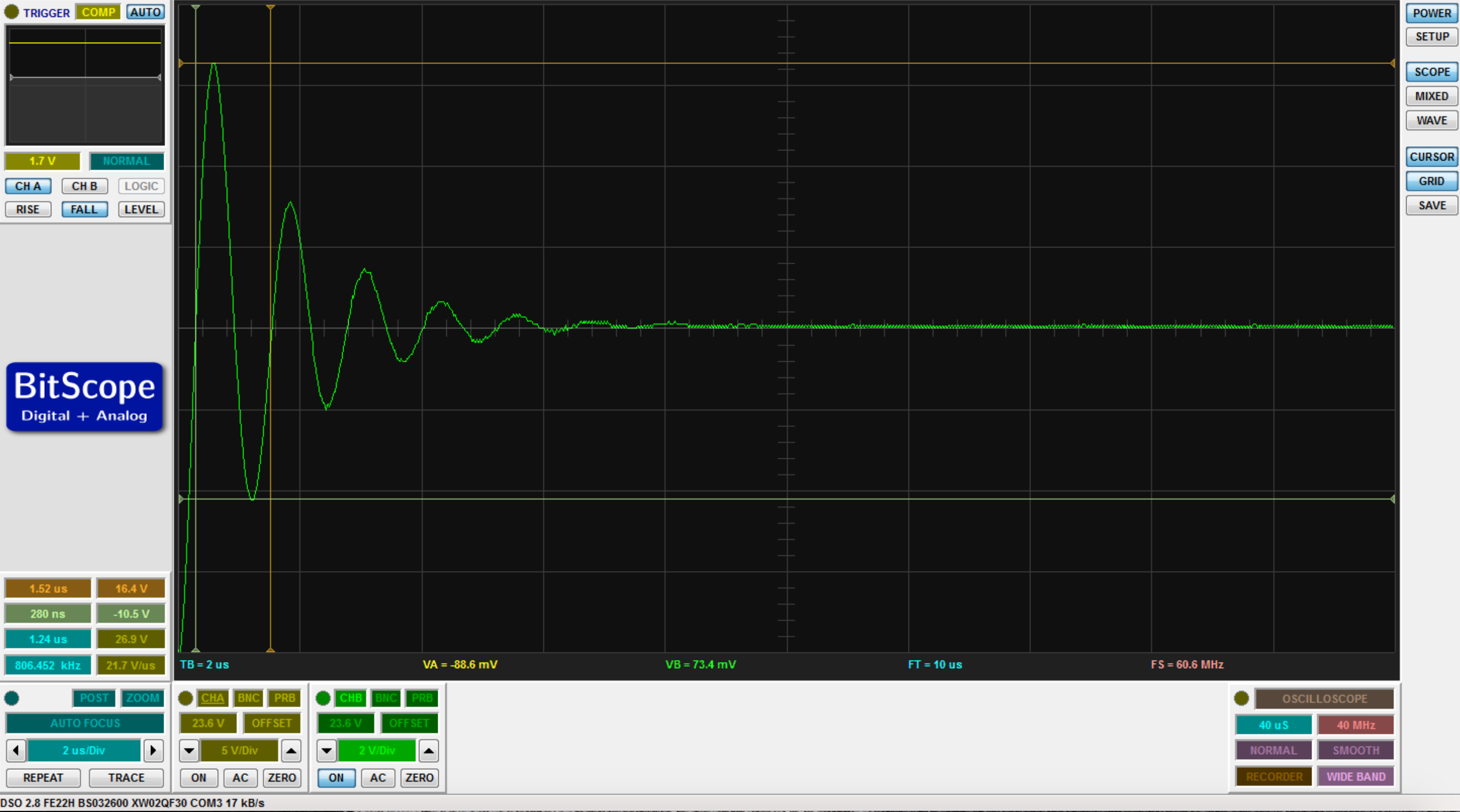

I got:
R=10 ohms
Cx=0.01uF
C2=0.15uF
The ring freq is around 806KHz when R=1K ohms.
I'm a bit leery that R is this low. Prior to this, I measured 3 transformers, and they have anything between 47 - 120 ohms.
Has anyone come across any transformer with such low R value for the snubber?

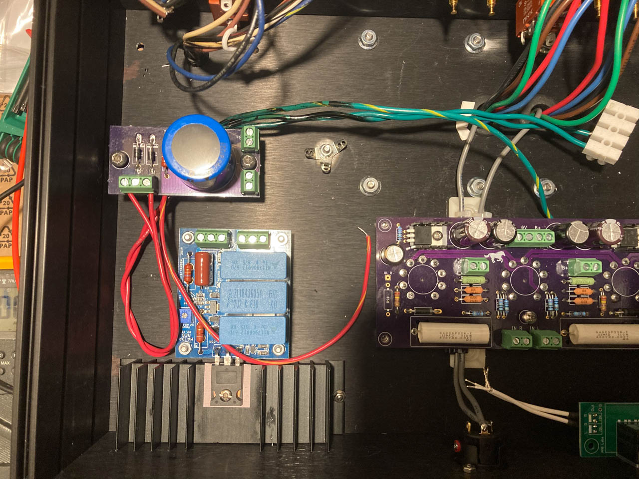

I'm building a single-ended EL84 amp based off a PCB of my own design (first attempt at a PCB), and have been chasing a high frequency ringing that is only present on one of the channels.
After trying many things, the two that have been most effective in cleaning up that ringing is either snubbing the high voltage secondary, or using regulated DC instead of AC for the heaters.
The ringing issue aside, the amp is quieter with the regulated DC heaters, than AC heaters with snubbers across the HT secondary, so that is a change that I will make permanent.
That said, I am fairly certain the transformer was making less mechanical noise with the snubber in place, so I'd like to do that as well.
For temporarily snubbing, I used a 0.1uF cap in series with a 1.2K resistor across the two secondary wires. (I measured 1.2K with Quasimodo Jig, although that was with different Cx and Cs values).
My experiment was far from optimal but still had some positive effect, both in reducing the HF ringing and mechanical transformer noise.
The improvement in ringing was observed both on an oscilloscope and PC-based spectrum analyzer.

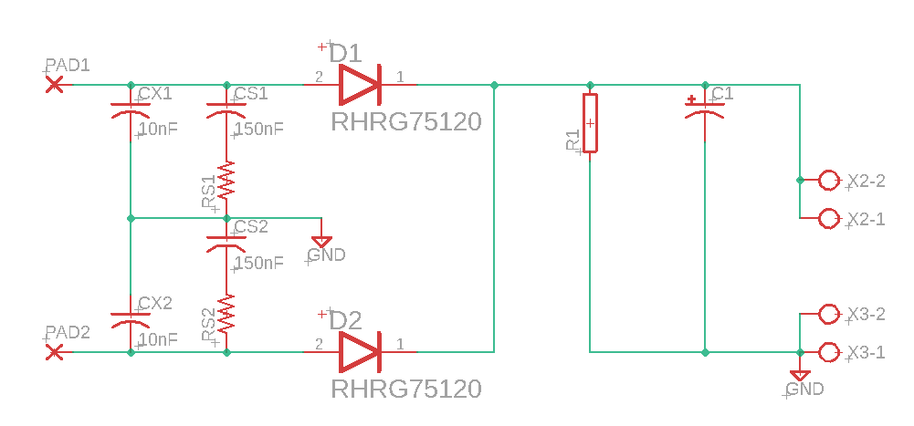

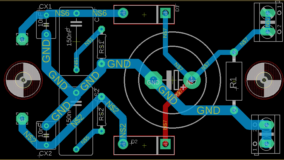

Based on figure 13 in the Quasimodo paper, for a center tapped transformer (mine is Hammond 270HX, 550 VCT), there should be dual C-RC snubbers, from each secondary to the CT.
I have a draft for a PCB to hold the snubbers, rectifier diodes and 220uF main filter cap.
It would be great if someone can double-check that the layout is correct, along with any other improvements or suggestions to the layout.
The mounting holes and PCB size are intentional, to fit on top of the power transformer mounting tabs.
edit: also wanted to mention the rectifier diodes I chose are TO-247 soft-recovery ISL9R30120G2 (Mark's "belt and suspenders" approach).
I assume that at 30A rating, they won't need heatsinking for the 100mA B+.

Umm, sadly, though, a 30A rectifier will dissipate only slightly less power than a 1 or 2A rectifier if providing the same current. The temperature rise will be slightly less due to the greater thermal mass and dissipating surface area.
100mA rectified, shouldn't be too hard to shake off the BTUs, though.
