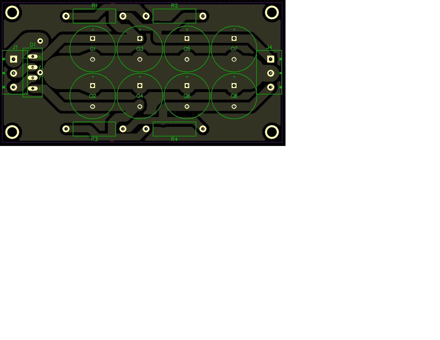

Hi Kuro
there is no kit. You have to source everything yourself... Mark kindly provided us with everything needed, like the files to be sent to the PCBs-factory, the bom and the documentations... Sometimes one of the builders ordered a dozen or so boards to get a lower price per unit, surplus is then often given away for a "good price" (sometimes even free). Ask around...

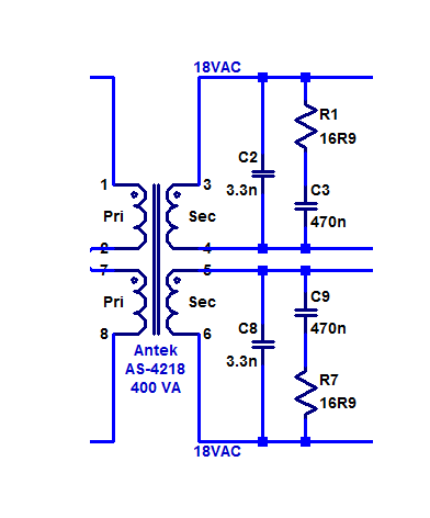

However, in pdf about Quasimodo Mark wrote: "Cs should be larger than Cx {the final paragraph of Appendix A explains why}, and in my own audio work I usually select Cs to be about 15X greater than Cx. When fitting a snubber to existing equipment that already has a Cx installed, I would of course install that same value of Cx into the Quasimodo test jig, and also install a Cs which is 10X or 20X larger.

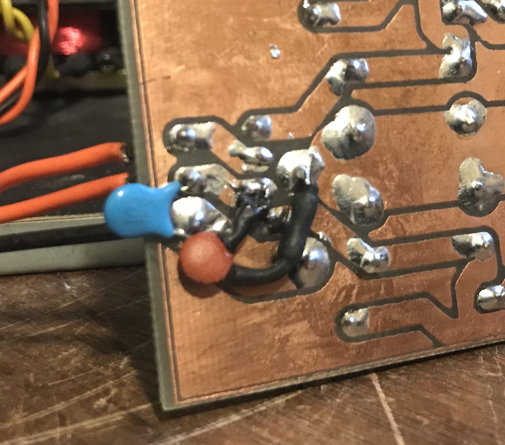

Thusly emboldened, I probed a few dual rail power supplies I have knocked together over the last year or so and found ringing on the rectifier pulses on most, but not all.
Something strange I noticed was that for a small centre tapped dual rail supply, fitting a snubber (10nf, 100nf, 470r ) on only one rail also damped out the rectifier ringing on the other rail.
Standard design with a bridge rectifier, CRC with 4400uf-5R-4400uf
Is that a quirk of centre tapped vs dual secondary?
Did you perhaps, fit a single Cx, Cs, R snubber across the entire secondary, instead of 1-each, center-tap-to-rectifier node?
If not, I think that could be due to some nominal amount of coupling between the leakage inductances of the two transformer windings. Could be quite a bit if it's bi-filar wound. Of course, that would be unusual for a power transformer.

I’m pretty sure it’s across the centre tap ( bottom of the three left hand most connections on the PCB) and a winding as per the photos.
The ringing shows up under load with none apparent at idle. I didn't build a jig as per the OP, rather soldered the caps and a small trim pot directly to the pcb and twiddled about with it until the ringing looked to be damped out on the osciliscope.
The intention was to then simply put another set of caps and the same resistor value from the centre tap to the other winding PCB connection but on probing, it didn't appear to need it?!
I took the snubber off and probed that same winding connection again and found that the ringing returned and so I'm thinking it's not my bad probing technique.
Thanks for your help.

Looks to be right, just the way you described it, Flashheart.
One thing to keep in mind about testing one side, then just duplicating that on the other winding: Depending on how the transformer is wound, the duplicated snubber may be less than optimum. It may not be off far enough for you to object, but might be worth at least checking. Remember it's the leakage inductance that we're trying to dampen.
