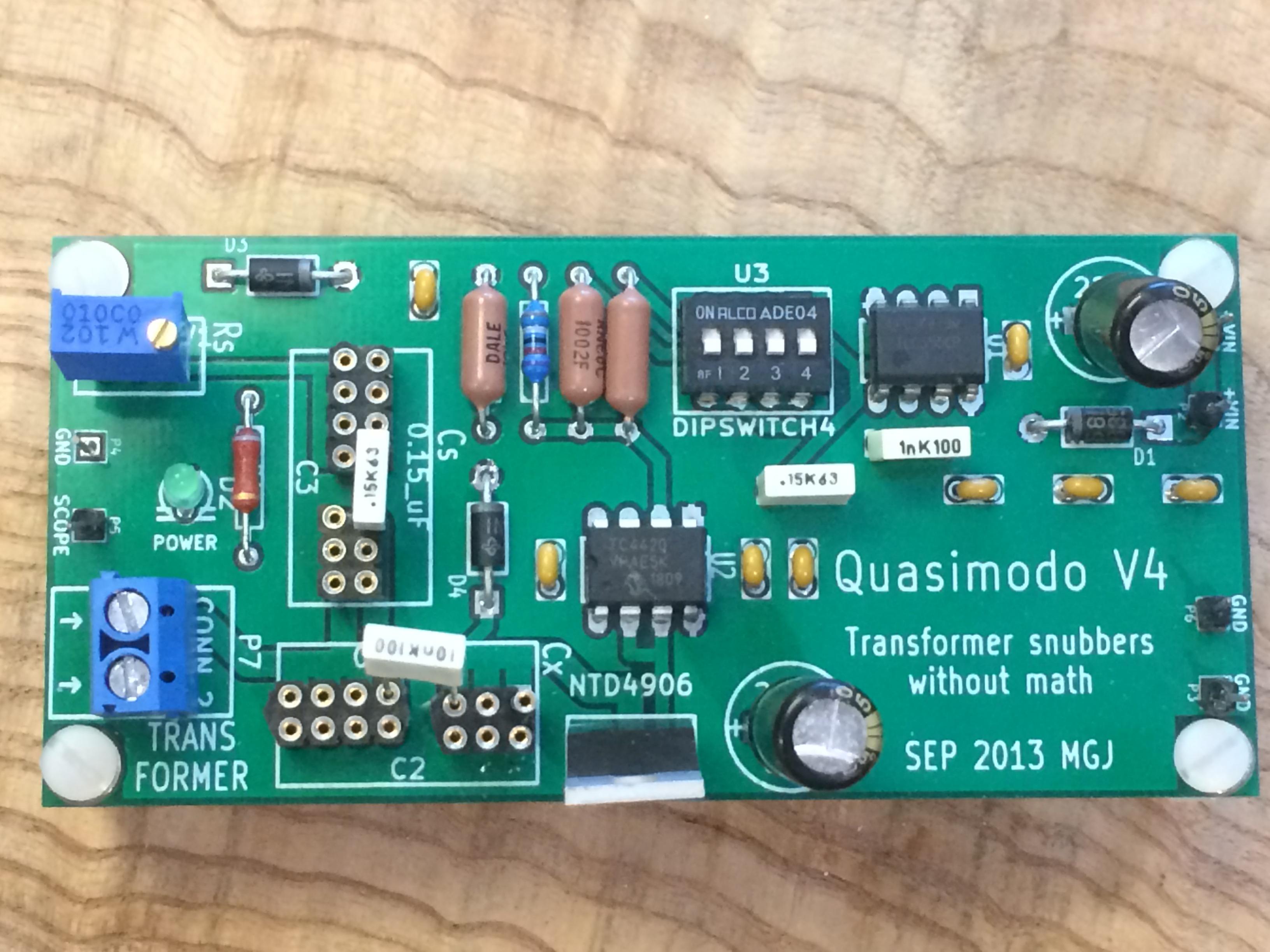

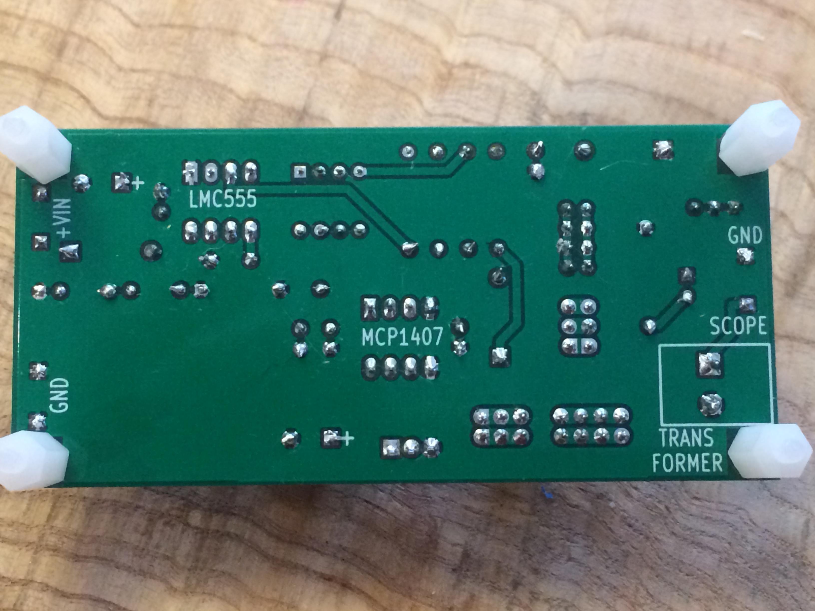

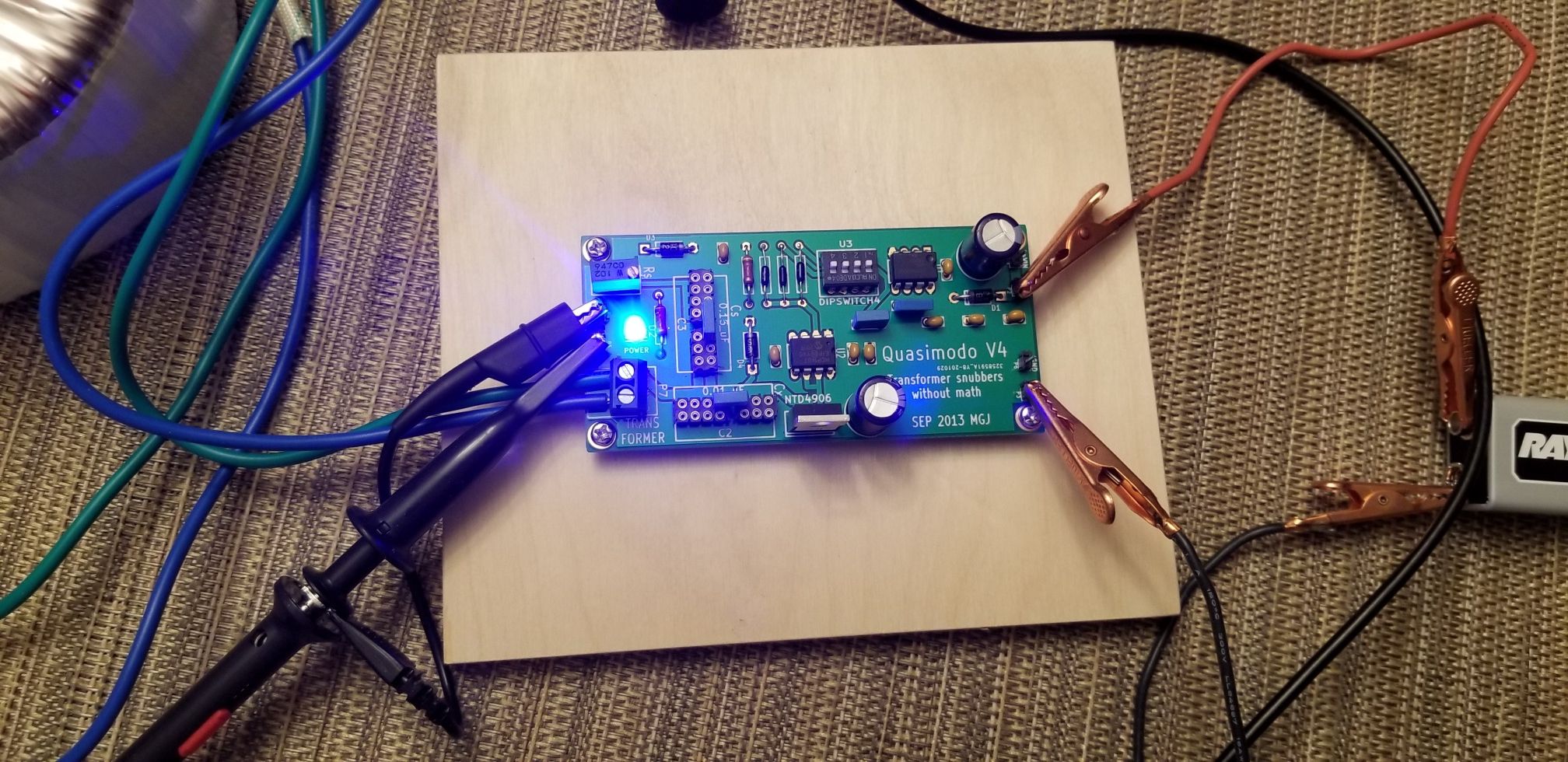

Thanks to j_thomas, i got a board and parts kit. Soldered last weekend, and just tried to power it up with a 9v battery... at first the LED was lighting up, but very dimly...barely lighting compared to photos on this thread.
So I tried some basic continuity tests and briefly touching the battery leads closer to the LED - (Pos to the square LED hole (near VR1) , and Neg to R1 (812r - actual) no dice... BUT, if i bypass R1 or connect the negative lead to the round LED hole (closer to Conn 2) then the LED lights up BRIGHTLY!!!
I also confirmed with my continuity tester that there is a path from the neg LED to Gnd, but I can't find the path from +Vin to the pos LED lead (hmmm?)
Finally - if I touch some of the legs from either transistor to with the Pos battery, and the Neg to the LED - leg, the LED lights up (various brightnesses depending on which leg).
I was careful handling the transistors and diodes (no static). The LMC555 socket is has a chip labeled TLC555cp and the MCP1407 socket has a TC4420. I did not check diode values, but I just got a diode tester, and will follow up with those values... just wanted to get the basic question out here.
Im a generally handy person, but my soldering skills and theoretical electronics knowledge are beginner level. I did clean possible flux residue trackside with alcohol and a toothbrush several times, and also used a flashlight and magnifying glass to check I had not bridged any through-holes. (at my age, bare eyes don't do the job)
Anyone willing to help me debug the board or parts I may have botched?
Thanks! - Sixto.

Hi, I find that you have placed wrong position of the U1 & U2.
The pin 1 of IC have dot mark on it and the silkscreen of pin 1 is square.
Please remove U1 & U2 and replace the new one.
Hope can help you

You are correct, I looked closer and I have them both turned 180 degrees... Silly me, I thought the text printed on the chips should align with the text on the PCB.... Rookie mistake - I won't make it again... now to wait for the Haako desoldering iron to arrive...
On closer exam... did I also install the DIP switch backwards? it looks that way according to post 106... Hmmm that's 3 strikes!
Is there a chance I may be able to salvage the chips, or should I just order replacements?... nah, I probably am nowhere good enough to remove them without damage. New chips.... ah the joys of learning the hard way.

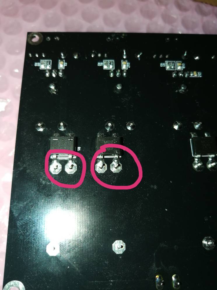

I made exactly the same mistake with a new and upgraded processor chip for my Quad FM4 tuner. Quad supplied it on a little board, because it had a different pin layout. I shoved into the socket in with the chip ident aligned in the same way as the old chip. Wrong. Looking at the instruction, it needed to be installed the other way round - so the chip ident 180 degrees out.
Fortunately the device survived the trauma.

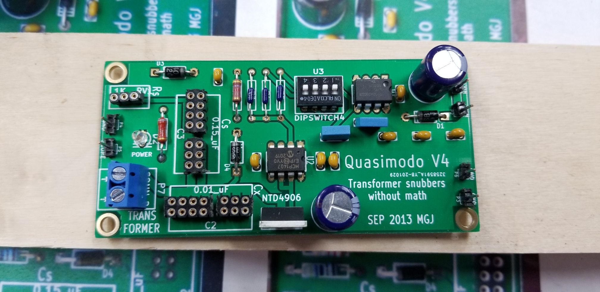

I just had some boards made from PCB Prototype & PCB Fabrication Manufacturer - JLCPCB and was very happy with the price and delivery times. Much cheaper than OSH Park if you don't need the gold plating.

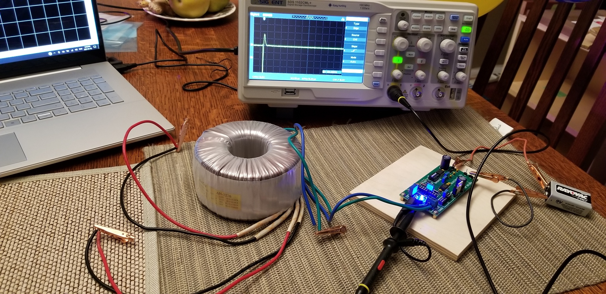

First off, Thank you Mark for the board and help in picking an oscilloscope (months ago).

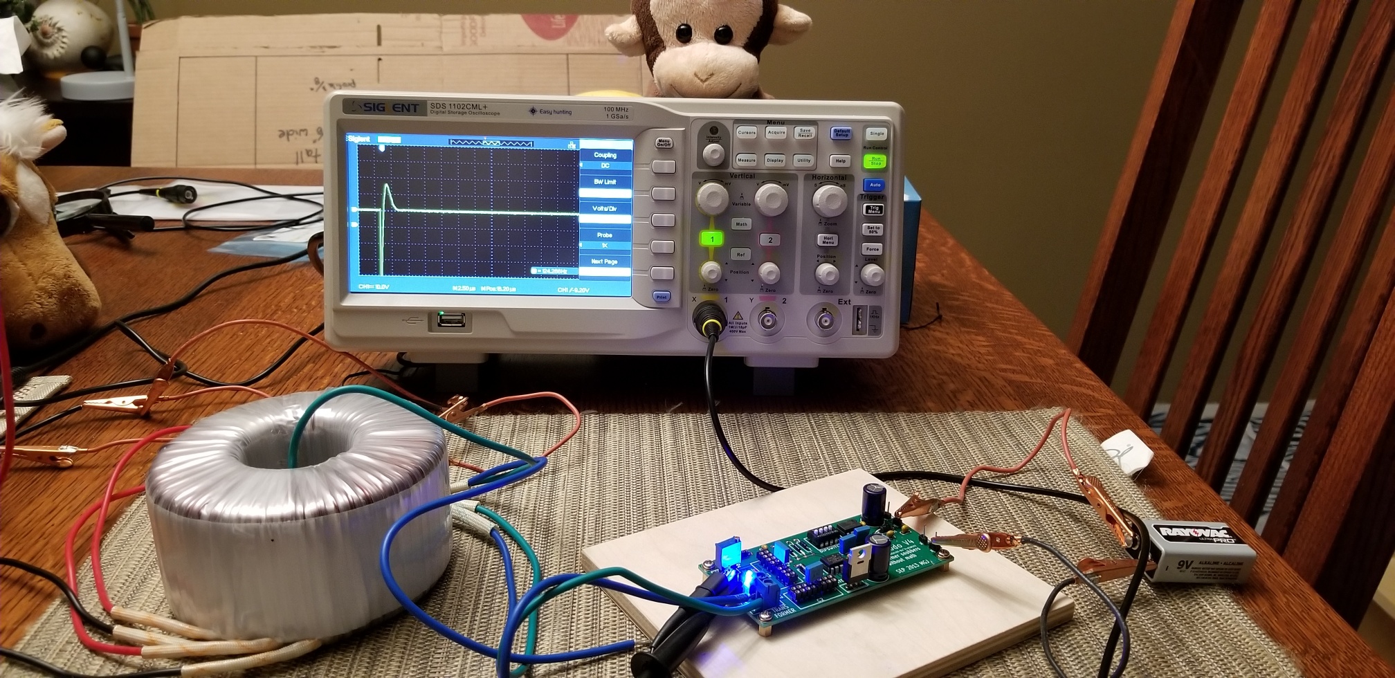

Here is a shot of my competed board,

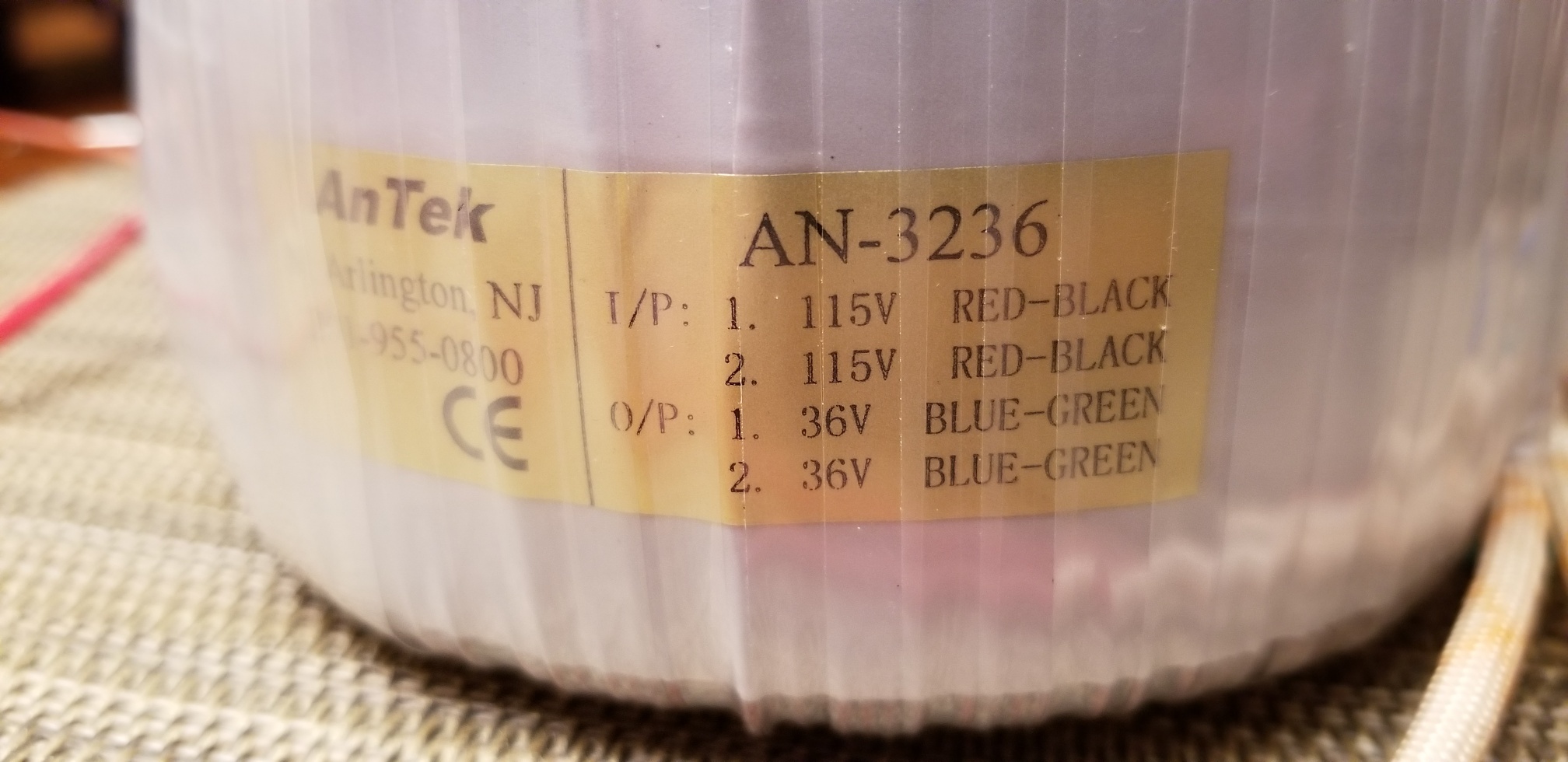

Transformer,

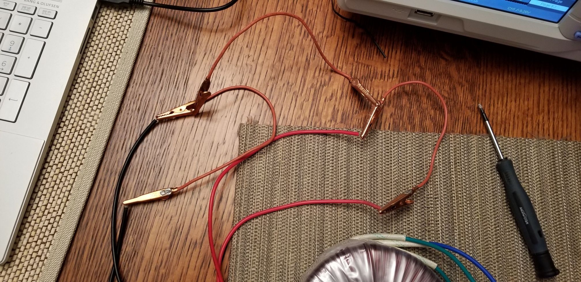

Shorted, as I understand how it should be shorted for 110v parallel primaries,
One secondary connected, I will be using two bridges on Prasi's compact PSU,

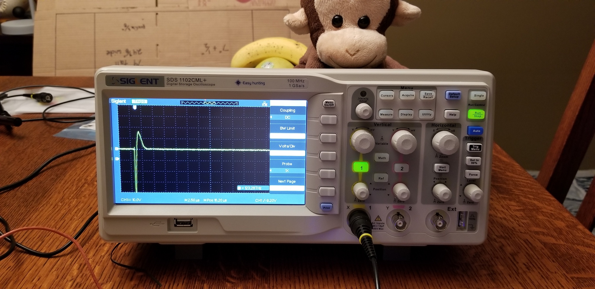

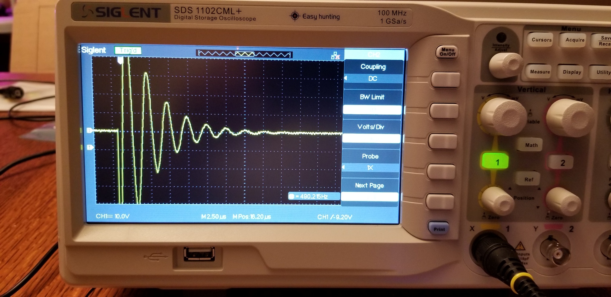

Here is the initial ring (scope was "zero'ed" as per manual)

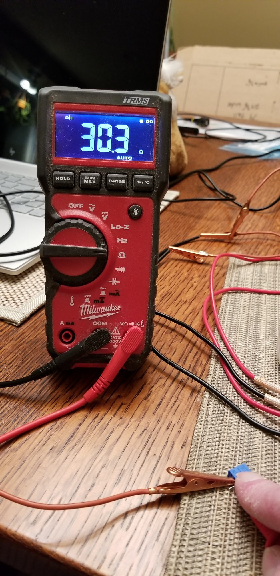

After adjusting resistor,
Removed and read resistor,
The other secondary with same resistor setting,
Does this look like I have done everything correctly?
(I am a 52 year old woodworking machinery sales professional with no foundation in electronics or math, my hobby for 35 years has been woodworking, which wandered into speaker building and now amps for those speakers, so be nice if I have this all wrong... )

Yep, I'd say you nailed it DaveFred! Fine-looking work, and great pics of it, too.
A couple little tips, though. Likely won't make more than a nibble of difference, but might on a different transformer.
Each primary winding can be shorted with its own jumper. That avoids the possibility that one winding will have a one-jumper short, while the other has three jumpers in series shorting it.
A carefully-built dual-secondary transformer MAY have similar-enough secondaries to use the same damping values on each, but there's no guarantee. Since QuasiModo only takes a few minutes (usually) to dial-in, might as well find the optimum value for each -- even though it may very well come out to about the same value.
You've now successfully damped each secondary -- congrats well done! But big transformers usually look into big rectifiers, which often have higher capacitance. Plus, not all rectifiers are created equal. I would consider reserving a little space near each bridge, and plan a final assessment for when the build is farther along. That way you'll be compensating the actual operating environment.
Still, this is great work, just as it is !
Cheers
I wasn't sure just how they were to be shorted.
Short each primary individually, or attach all the primary leads together.
Can someone clarify?

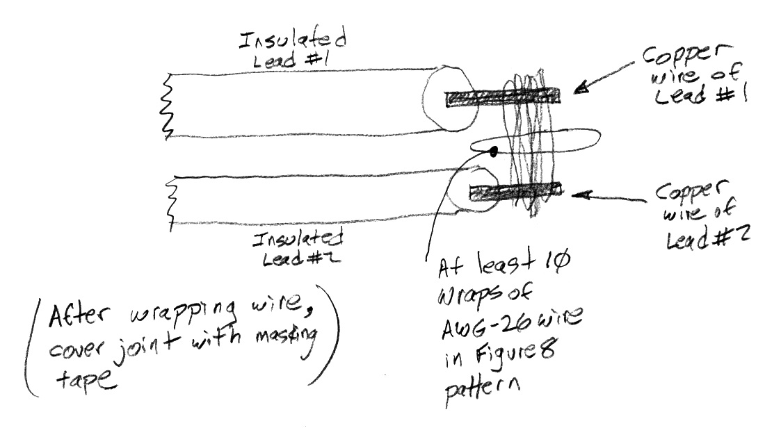

Short-circuit each of the other windings without increasing their wirelength at all. Not even 1 millimeter. I find it easy to do them one winding (one pair of wires) at a time, as diagrammed below. But any other scheme that doesn't increase wirelength at all, would be equally good.
After you do this a couple times, you'll learn to leave the final centimeter of the shortie-outie-wrappie wire, straight and not-wrapped. This will make it easy to unwrap it, later. The masking tape holds it in place, prevents it from unwrapping, and prevents it from touching other wires when it shouldn't.

When I was taking my readings, I don't think I was shorting out the windings correctly, including not shorting out the other secondary winding not under test.
The variable resistor value changed from 30 ohms to 18.5 ohms with both primary and one secondary winding shorted out (I am using two bridges).
Will using simple copper clamps to short the windings be enough, or should I really be wire wrapping them?
