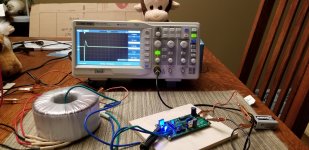

First off, Thank you Mark for the board and help in picking an oscilloscope (months ago).
Here is a shot of my competed board,

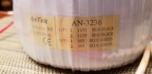

Transformer,
Shorted, as I understand how it should be shorted for 110v parallel primaries,
One secondary connected, I will be using two bridges on Prasi's compact PSU,
Here is the initial ring (scope was "zero'ed" as per manual)
After adjusting resistor,
Removed and read resistor,
The other secondary with same resistor setting,
Does this look like I have done everything correctly?
(I am a 52 year old woodworking machinery sales professional with no foundation in electronics or math, my hobby for 35 years has been woodworking, which wandered into speaker building and now amps for those speakers, so be nice if I have this all wrong... :) )
Thank you,
David.
Yep, I'd say you nailed it DaveFred! Fine-looking work, and great pics of it, too.
A couple little tips, though. Likely won't make more than a nibble of difference, but might on a different transformer.
Each primary winding can be shorted with its own jumper. That avoids the possibility that one winding will have a one-jumper short, while the other has three jumpers in series shorting it.
A carefully-built dual-secondary transformer MAY have similar-enough secondaries to use the same damping values on each, but there's no guarantee. Since QuasiModo only takes a few minutes (usually) to dial-in, might as well find the optimum value for each -- even though it may very well come out to about the same value.
You've now successfully damped each secondary -- congrats :D well done! But big transformers usually look into big rectifiers, which often have higher capacitance. Plus, not all rectifiers are created equal. I would consider reserving a little space near each bridge, and plan a final assessment for when the build is farther along. That way you'll be compensating the actual operating environment.
Still, this is great work, just as it is ! :cheers:
Cheers

Joined 2018
When I was taking my readings, I don't think I was shorting out the windings correctly, including not shorting out the other secondary winding not under test.
The variable resistor value changed from 30 ohms to 18.5 ohms with both primary and one secondary winding shorted out (I am using two bridges).
Will using simple copper clamps to short the windings be enough, or should I really be wire wrapping them?
Thank you,
David.
