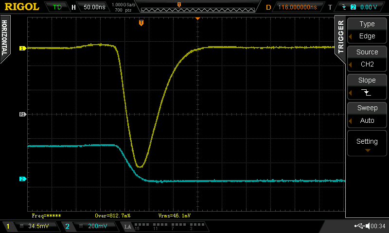

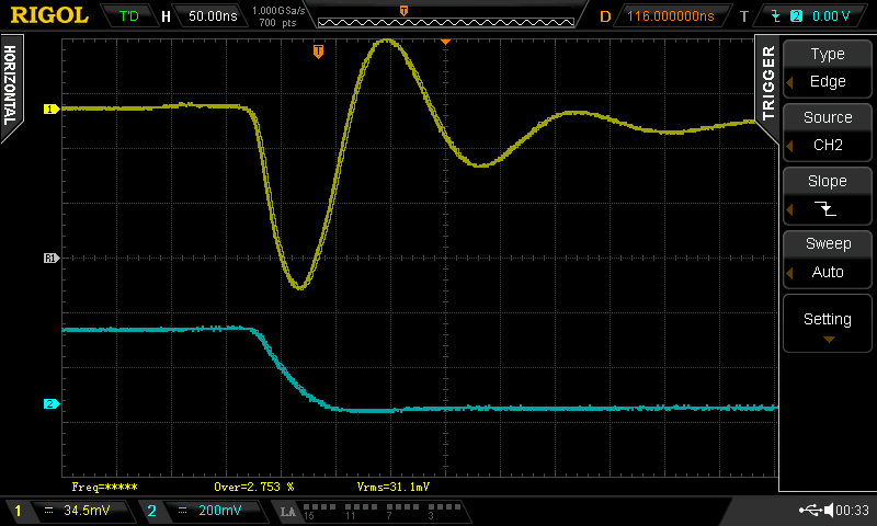

This one comes from a 5 VDC regulated wall wart. Note the time offset, -1.694z. WTH is a zsecond?
A Z second is 10 to the minus Z seconds.
I looked it up after that and it's a zeptosecond. A zeptosecond is a trillionth of a billionth of a second (10^-21 seconds). I knew the Rigol scope was a decent value, but I didn't realize how good!

This is a perfect opportunity to try the active bridge and see what the results are from snubbing - the waveform of the transistor turn-off is unquestionably going to be different from any diode, so it’s unknown territory, and any measurements you find and post will be very appreciated!
I look forward to seeing what you learn.
Congratulations, aterren! Your board seems to be working well.
Those numbers on bottom left (34.5mV ; 200mV) are a little concerning; maybe you might have set the vertical amplifier soft-knobs to expect a 1X probe when you're actually using a 10X probe, or something along those lines.
Mr. Johncons,
Thank you for the attention to detail. You are correct, the probes are 10x and the scope was set for 1x. Thankfully, in this case the absolute number was not important.

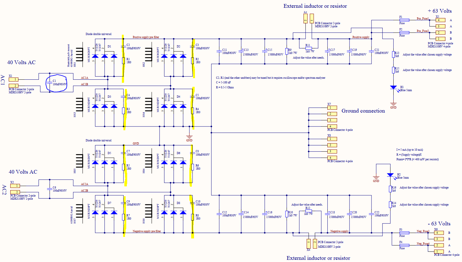

A general question if I may:
In the attached schematic (from an old DIYAudio group buy) is there any benefit to having a snubber across each diode as shown versus using a CRC snubber in place of C1?

... is there any benefit to having a snubber across each diode ... versus using a CRC snubber in place of C1?
No. That approach arises from an incorrect assumption: "if the diodes cause the transformer secondary circuit to ring, then maybe we can fix the problem by twiddling around with the diodes?" which is wrong. You fix the problem by adding a damping resistor to ruin the "Q" (increase the "zeta") of the resonant circuit.

How does the waveform look? The magic of this method is, 'If the waveform looks right, you're done!'

The waveform looks good with 9K1, if not OK usign this high value & to use lower Rs value it's possible to change the value of caps? wich values?
