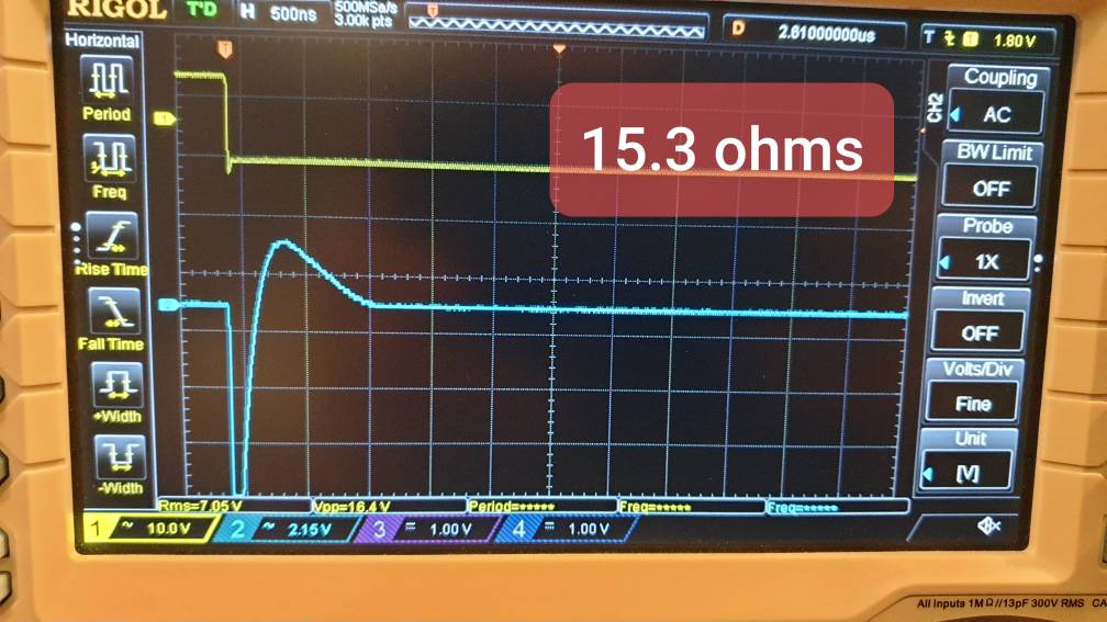

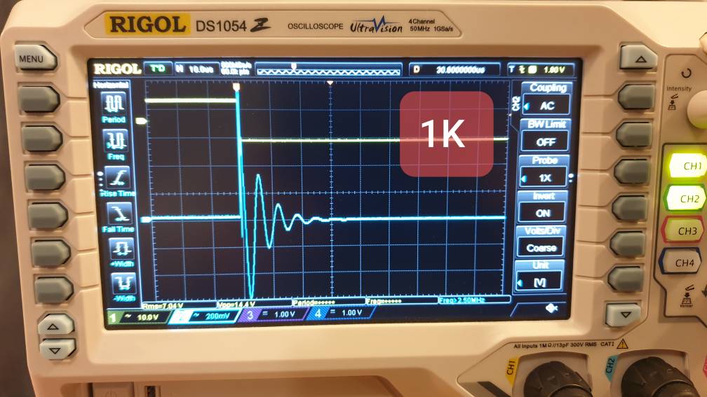

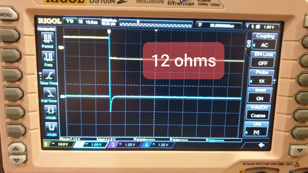

Hi Guys,
Just double checking.
I have a transformer with multiple secondary windings.
2 x 45v AC
1 x 18v AC
1 x 12v AC
I am using the 45v dual secondary windings as per the 4th row example in the Quasimodo documentation to drive my amplifier.
I have dual snubber network and dual bridge rectifier.
I am also using the 12v winding for my speaker protection.
I am not use the 18v winding and its currently open circuit.
I understand that to establish the correct value for Rs I need to short the primary winding and the other 45v secondary winding.
My question is, What do I do with the other 12v and 18v secondary windings?
I'm assuming that I need to sort them . If I could just get some confirmation that would be great.
Hi Stuart,
as far as I understand the scenario, your thinking seems correct to me: All windings except the one winding under test need to be shorted. If windings stay unused lateron is not relevant for the Rs optimising method, because you only want to determine the behavior of the winding under test without influence of other windings (therefore they are shorted).
Kind Greetings,
Winfried
Stuart,
none of your posted options is optimal. There is a really well put together PDF document in this thread describing the method and explaining the optimum. As a shortcut go to posting 001 to see a picture showing the optimisation path. Once you have reviewed that you will be absolutely clear which is the optimal decay curve and tuning Rs becomes a "no brainer"! :cheers:
Winfried
