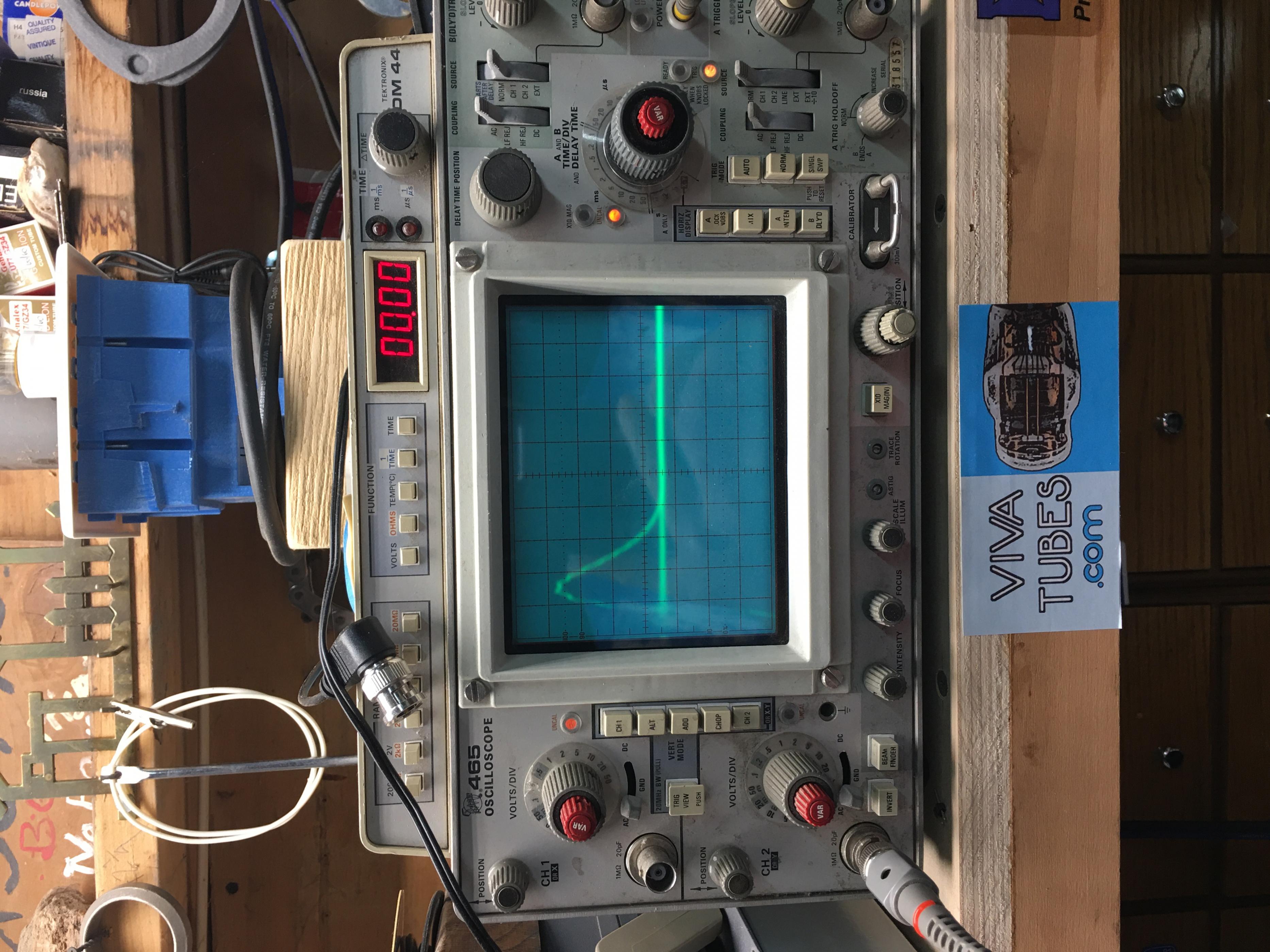

I have just tried it on an Avel Lindberg 15VA #Y236001 torroid.
With Cx=.01uF Cs=.047uF Rs=9 ohms I get the trace on my scope shown on the attached photo.
Do those values seem reasonable? If so it seems to be a good result? Would this verify the Quasimodo board?

Yes, that are good results and Quasimodo is verified to work properly.

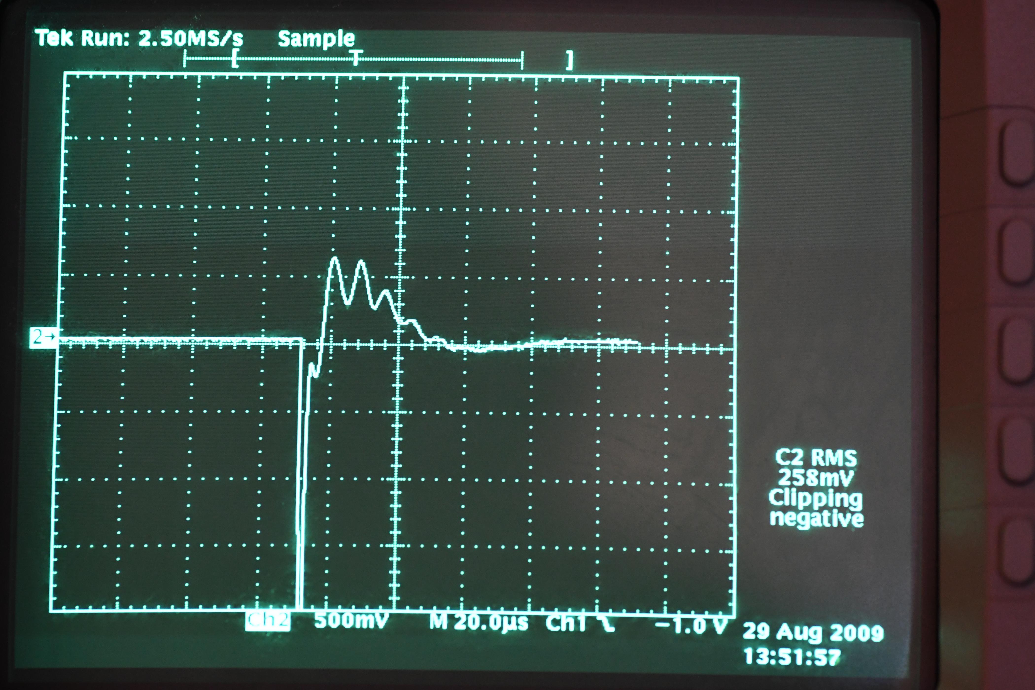

Just to back up a bit...I have now attached a shot of my scope display showing the trace using the recommended.
Cx=.01uF Cs=.15uF Rs=83 Ohms
That is about as good as I can get it using those default values.

What happens with lower Rs values and did you check that trimmer pot is actually changing R value below 80 ohms?
Edit: ah yes you did, as there is 9 ohm result.

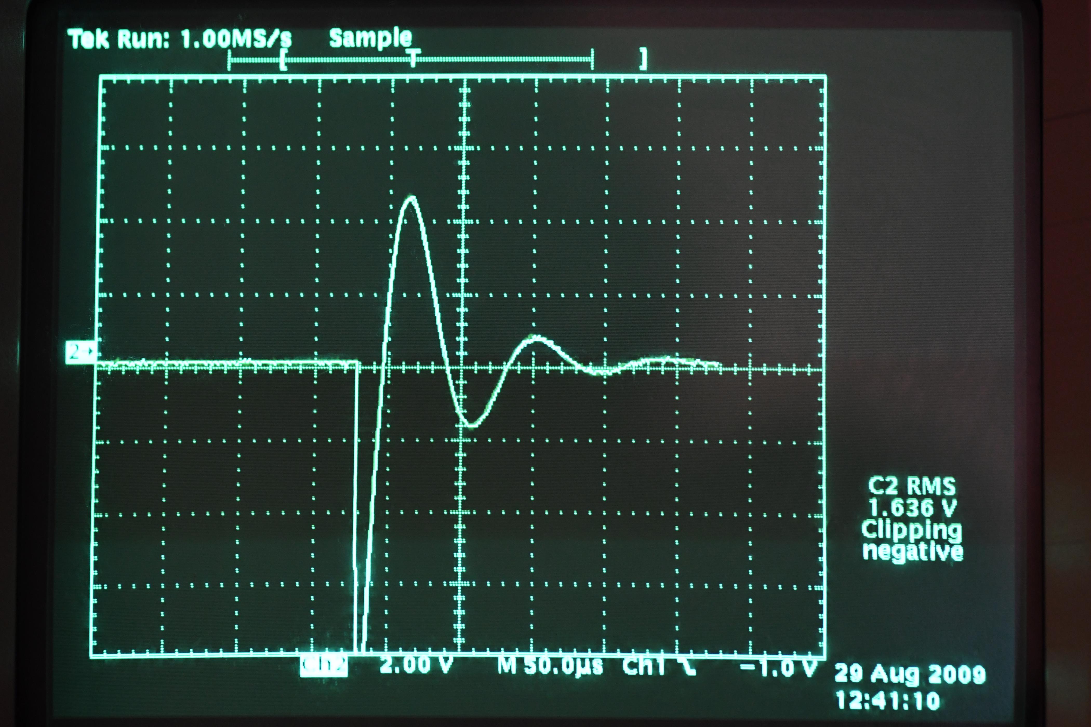

One thing I noticed that is strange is that when remove Cs from the circuit changing Rs still has an effect on the damping. Seems to me it should not as the snubber is now open?
I have attached a screen shot showing my trace with:
Cx=.01uF Cs=Open Rs=70 Ohms.
Again I can alter the trace with Rs even though Cs is removed from the circuit.
🙁Qmodo board just failed....
While result is fine, your transformer is still underdamped. For 500VA transformer, I would expect resistor value close to 10 Ω. Look at the picture from Quasimodo manual: optimal damping is red line. Your result is green line.

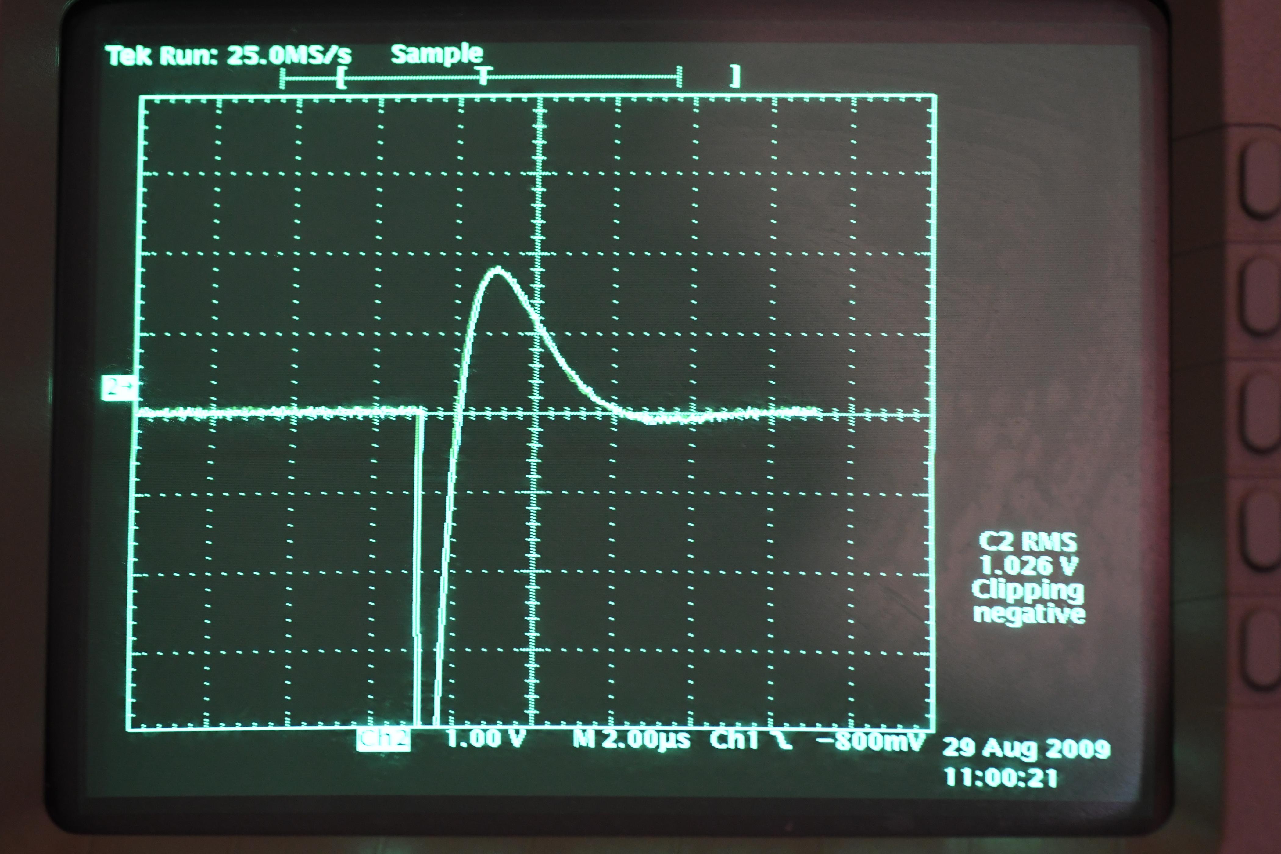

Yup....after replacing U2, I get 12.7...thanks mucho

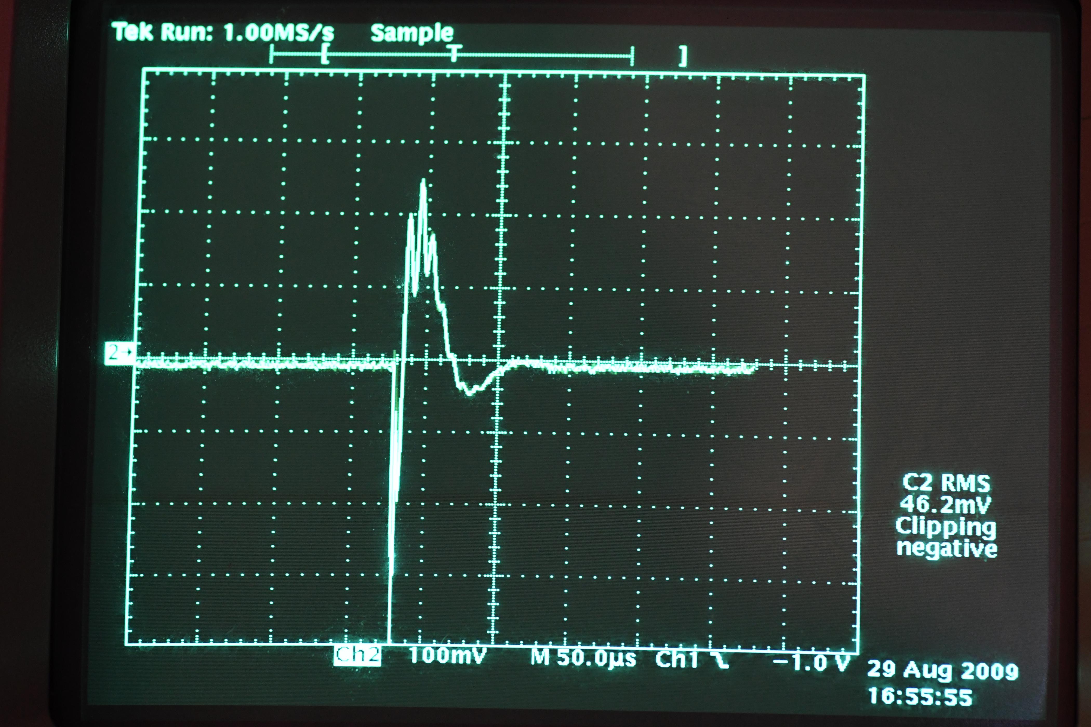

Well I feel really dumb!
I was for some reason under the impression that the .15uF Cs/C3 cap was socketed as is Cx/C2!
After chasing around on the Quasimodo board looking for problems I realized that the .15uF Cs/C3 cap is a surface mount cap and is not socketed. I thought Cs/C3 was located across the header from Cx/C2 on the other side of the header socket.
Now that I understand what is happening I get the trace shown in the image .
Cx=.0047uF Cs=.15uF Rs=60 Ohm
If I use Cx=.0068uF or .01uF I get a similar trace with a higher amplitudes of the peak amplitude.
I am still getting those little ringing peaks along the trace until it settles.

Those little ~120kHz squiggles are worrisome. But the whole waveform is a lot smaller - some 1/4 the size - than it was. (The Tek changed both the H and V settings from the earlier post.😉)
Are you still using the wire nuts and additional 7 inches of orange wires screwed into the terminals on Quasimodo? One of the handy things of those terminals is you can screw the wires of the transformer secondary that you're *ringing* right in to the board. Usually that much added inductance would yield a still higher frequency, and likely much lower amplitude. Still, I'd try it without the added leads.
