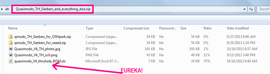

There is a BOM for the low priced board "Cheapomodo" attached to post#1 of this other thread over here
And also, right here in the Quasimodo thread which you're reading now, there are several attachments to post#1. One of them is a .zip archive file with a promising name. When we look inside the archive, pleasant things are seen. Look at the file dates. Cowabunga!
Please, if anybody wants to publish their own B.O.M. or Mouser Shared Shopping Cart or Digikey Spreadsheet or anything else related to Quasimodo: please go right ahead with my blessings, thanks, and good wishes. You might get questions about it occasionally, from brand new thread subscribers.

I'm already having fun with the eureka-file (trying to deduce those parts into a mouser-number...). The CheapoModo BOM is like a cheat-file with all those Digikey-nbrs... Well. Now you got me confused wether I got the cheapo or the 'regular' V4.

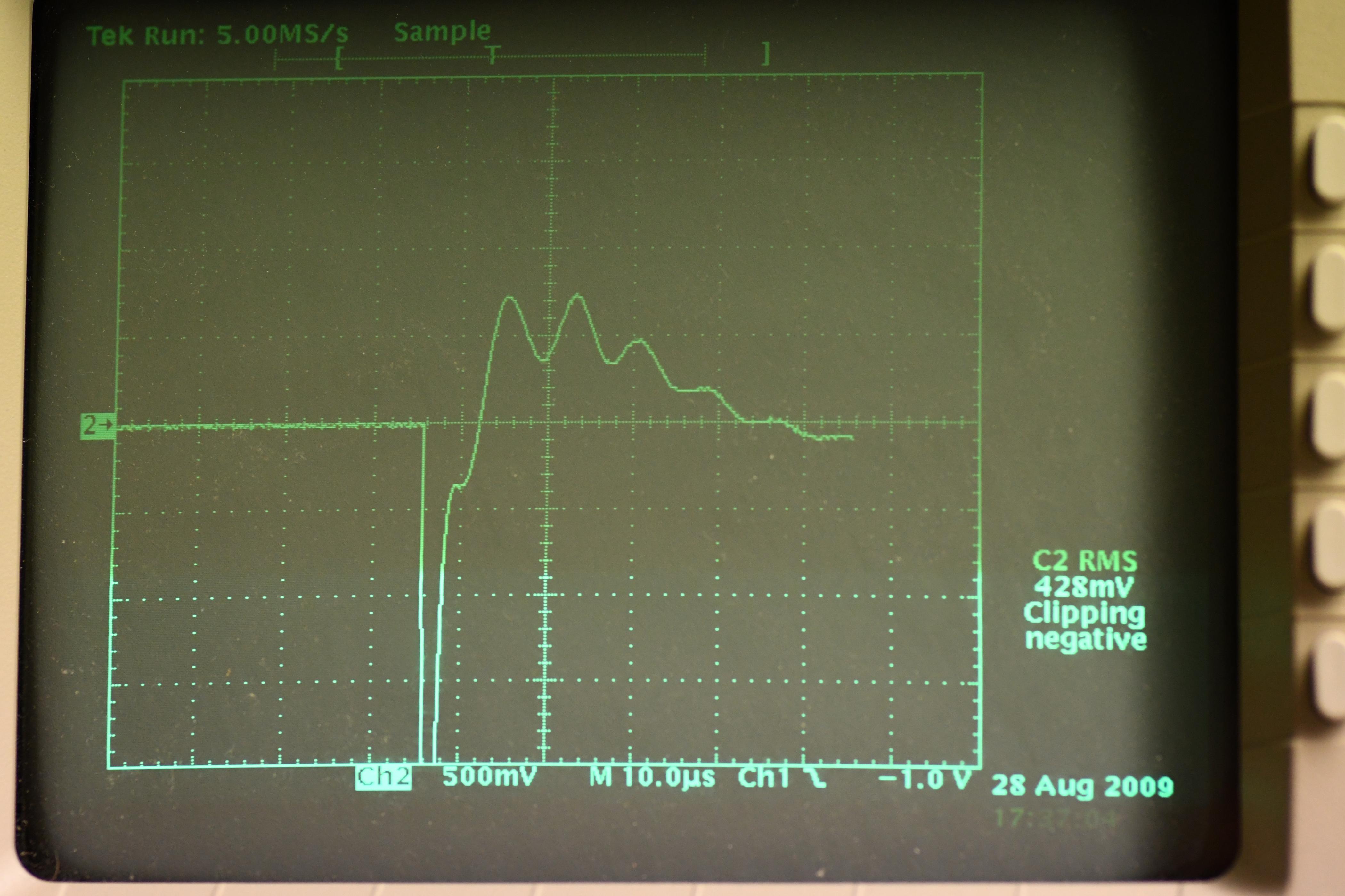

I am designing the snubbers for my Salas SSLV 1.3 regulator boards.
I am using a Quasimodo V3 surface mount board.
I have attached a photo of the scope trace I am getting after what seems to be the best achievable damping.
My final Cx=.0033uF Cs=.01uF Rs=75 Ohm
If I raise Cs much above .01uF I get repeated ringing across the scope that cannot be damped. The amplitude of the ringing is also much greater.
Does my final result look reasonable?
Is the Cx of .0033uF likely high enough to overcome the capacitance of my transformer secondary winding(Unknown) and the 4 MSRF860 diodes in the PS bridge?
Is a 3:1 ratio Cs/Cx reasonable for proper in circuit operation of the snubber?

Yes. I just double checked them to be certain. Also if I increase Cs to the recommended value of .15uF the ringing displayed look like the normal undamped examples I have seen, However I cannot damp the ringing unless I lower Cs significantly. Then I get the trace I am showning in the photo in my post.

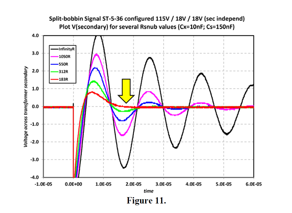

While result is fine, your transformer is still underdamped. For 500VA transformer, I would expect resistor value close to 10 Ω. Look at the picture from Quasimodo manual: optimal damping is red line. Your result is green line.

Is your Quasimodo successfully verified on some other transformer? If not, then it could be that Quasimodo is not working properly.
