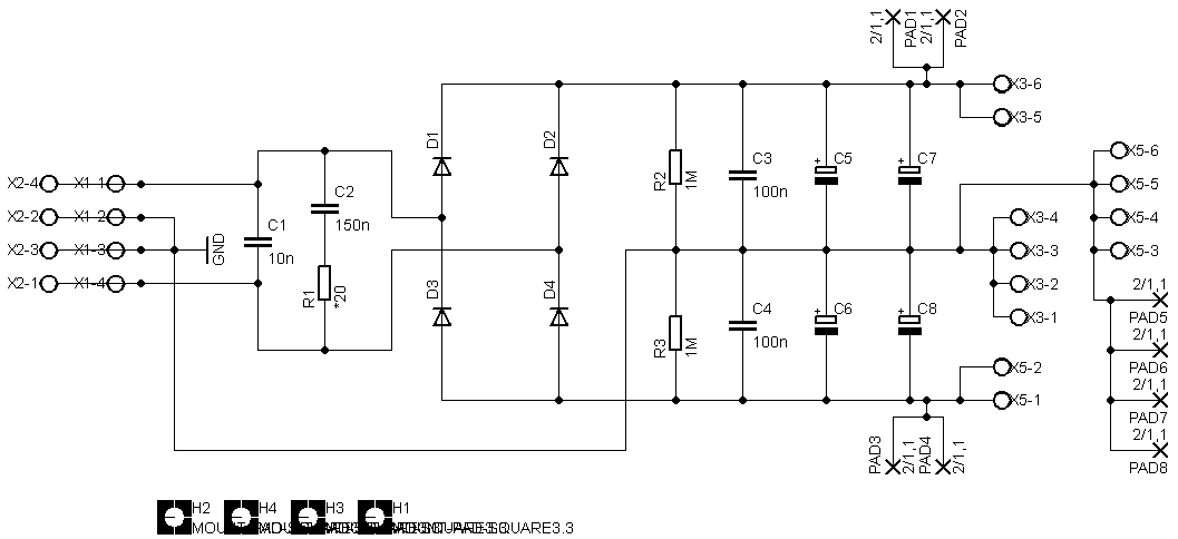

Hi, is there an argument against the following snubber configuration (C1, C2, R1)?
attachment.php
What would be the right connection of the transformer to the Quasimodo jig in order to optimize the component values for it?

Sinigersky, for that particular circuit configuration you are not snubbing across just the section of winding that is being commutated. In your schematic the snubbing current forced by one section of winding being commutated has to also pass through the other secondary winding before it gets back to the winding that is being commutated.
I might be wrong, but I thought in this configuration two diodes "commutate" simultaneously, in pairs, both secondary windings. I.e. D1 + D4 switch off both in one moment, then in a later moment, D2 + D3 switch off, and so on. The two ends of the secondary windings, which are not connected together, should be ringing in a "balanced" manner with opposite polarities, and the snubber (as shown) should be effective for this ringing, too. Or do you see an error in this explanation?

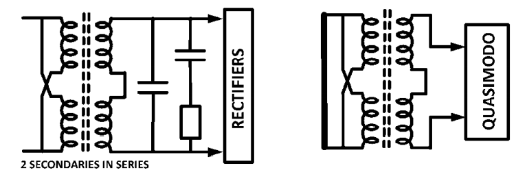

I would have assumed that this configuration is the right one to use with the jig:
attachment.php
The issue is that there is a separate entry in Fig. 13 for the "center tapped secondary" which suggest that two snubber groups should be used. I was trying to understand what is a possible problem with the single-snubber configuration from my post above.
Although it may appear that both sides are balanced, there are always real world differences to winding resistances and leakage inductances, and filter capacitance values, and load currents for each polarity. Those differences can lead to different commutation instants.
But even so, the issue is to follow the transient current flow loop that a particular winding generates as its related diodes turn off - that loop should be bypassed by its own snubber, rather than have to take a long path around and through the other winding.

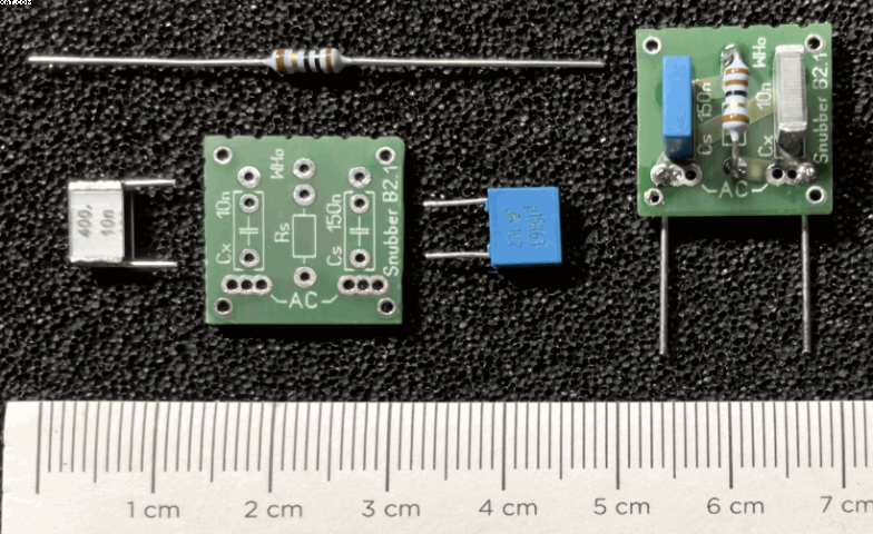

Beautiful! Any plans to make a batch and sell 'em? 😀 (thinking of just the boards)
I'd be surprised if there aren't other fellers out here that'd be interested -- besides me, of course!
But then, it can be a very time-consuming undertaking.
Cheers
Hi Rick,
thanks for the cudos!
A WW group buy would be beyond my time allocation possibilities. If there's sufficient interest, I could ask @Prasi if he's interested to offer it, maybe he'd be interested, as he offers ideal bridge rectifier boards as well.
Greetings,
Winfried
