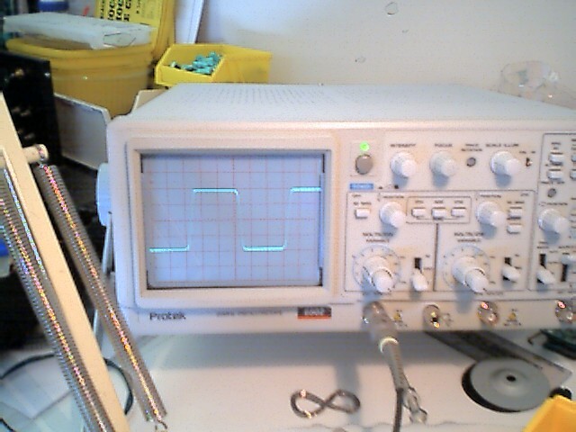

amplifierguru said:Oh and here's the sq wave into 8 ohms at 10KHz. The rolloff is as expected from the 1K and 1000p (polystyrene) input filter at 160KHz delivering -0.6dB at 20KHz and providing substantial filtering of stray hf pickup.
Nice wave, no overshoot, but what's the amplitude? Looks like 'not very high' slew values.
Hi Darkfenriz,
Yes, you're right these were done at 10Wrms - about the average power on music of a 150W amplifier with peaks near clipping.
I will do some higher power tests as soon as I increase my dummy load size from 25Wrms and hopefully improve camera resolution.
Greg
Greg

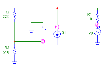

open-loop gain?
Seems to me that this topology requires fairly high gain to drive the damping factor/output impedance down. So assuming rout looking into the pmos/nmos is 10kohms each (very likely to be higher), the output resistance open-loop will be 2.5kohms.
Let's then assume a damping factor of 10 for an 8ohm load. This requires the feedback to be in access of 3000 (~70db) to hit a 0.8ohm output resistance closed-loop.
Greg, so how did you achieve a damping factor >1000 ? and what is the overall gain? I must be missing something......
Thanks,
Richard
Thanks,
Richard

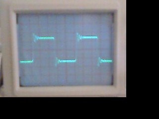

Greg, is this slew rate limiting caused by insufficient current to output MOSFET gate through EF emitter resistors?
Richard,
Yes, you are right, without feedback the amp is voltage-controlled current source. Assume the overall transconductance G1 is 10000A/V, with 8Ohm load (R1) the gain would be 80000. The closed loop gain is R2/R3=44, so the loop gain is 1800. The voltage source in series with load represents the back emf. The rejection of this voltage on the output (node 1) is equal to inverse loop gain, so DF=1800
Dimitri,
It's hard for me to reconcile your diagram of an ideal current source with the definition of damping factor. My understanding of damping factor is merely the ratio of the load impedance vs the output impedance of the amp. Your diagram shows an ideal current source output with infinite impedance. So what is the output impedance after closing the loop? Infinity divided by loop gain = ?
rlim
You should take open loop impedance parrallel with load impedance and divide by loop gain. Your approximation calculation is true for amplifiers with relatively high OL damping factor, say >5. In transconductance amps DF=~ loop gain, infinity parallel with 8Ohms is 8 Ohms.

darkfenriz:
Not true. Transconductance amps typically have low damping factors due to high output impedance, unless you have extremely high loop gain.
