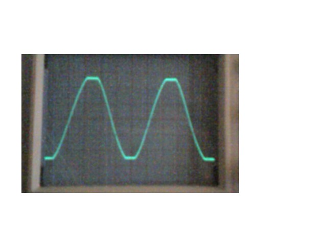

By the way, I've been doing some power tests . Here's absolutely clean clipping at +/- 52V into 8 ohms -

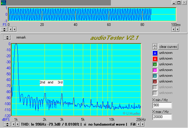

Here's a FFT at 12.5W a convenient level as it equals my soundcard max with the feedback divider i.e. max loopback.
Greg
Hello, Guru
My paper amp is cleaner - nothing for the first 120dB!

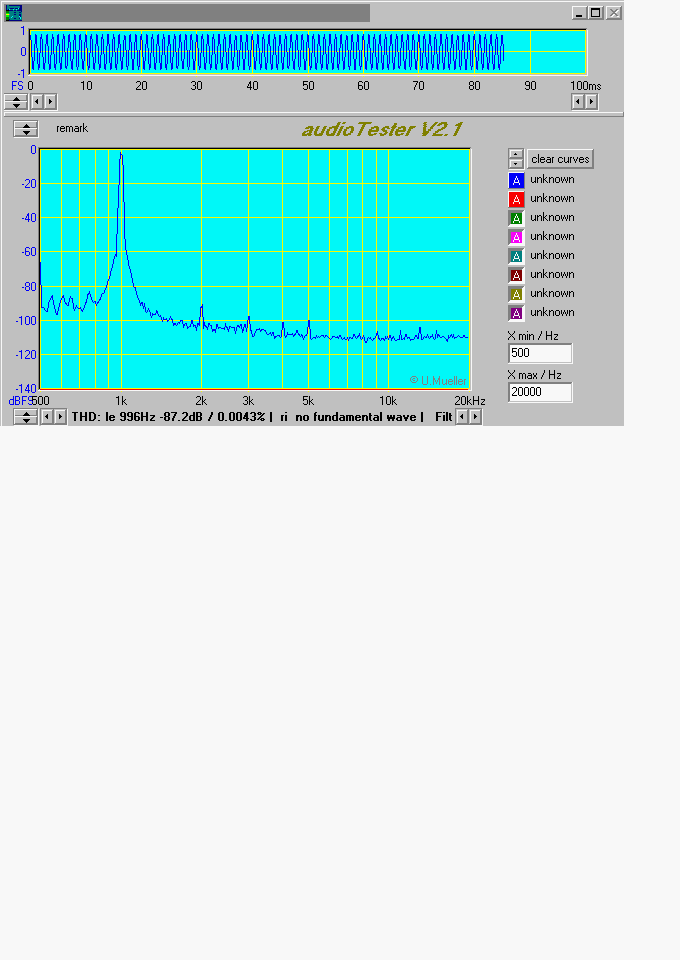

Some further results following on the 100W FFT post. As you're probably aware I was running the output MOSFETs at 50mA each.
Also my test jig has the PS wired to the module with about 200mm of 24/0.2 for V+,V-,PG.
So I decided to investigate the effect of shortening the PS wiring on the (particularly) even harmonic distortion. Shortening to 75mm had no visible effect on FFT residuals indicating to me that PSRR is good and the amp shouldn't be overly sensitive for it's performance to supply impedance.
Then I doubled the MOSFET standing current to 100mA per device (24W c.f. 12W). This visibly reduced the odd orders by maybe 3dB. However the improvement is arguable over the 50mA bias as 2/3 and 4/5 etc were approximately equal. So it's optimised.
Greg
