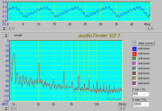

By the way here's the power supply Class AB commutation artefacts superimposed on the supplies due to a 1KHz 100W into 8 ohm output (0dB =40V peak). Just look at the spray of even harmonics. Now if your HF PSRR is declining at a typical (Vas) 6 dB /octave that will emphasize the injected artefacts as frequency rises. These are generated by the AB switching process and are not in the pure 1KHz signal.
Just imagine the piccolo plus artefacts! That's why a high PSRR topology is an audition winner .
Greg

Hi Mastertech,
It's a handy little window, the Audio Tester. It's shareware 30days or 28 euros. I had to build a filter to clean up the signal out part of my soundcard though.
The biggest hassle is dividing the signal down to maintain the 500mV rms for max resolution from the soundcard. I'll have to build a divider.
Incidentally the ref 0dB on my last post was 500mV rms not the 40 volt peak as it's coming straight off the supply, no divider, to the soundcard in.
If you have a stereo amp using a common PS, you can run one channel with the signal to put the artefacts on the supply then analyse the other for it's rejection with no signal. Crosstalk. PSR.
Greg

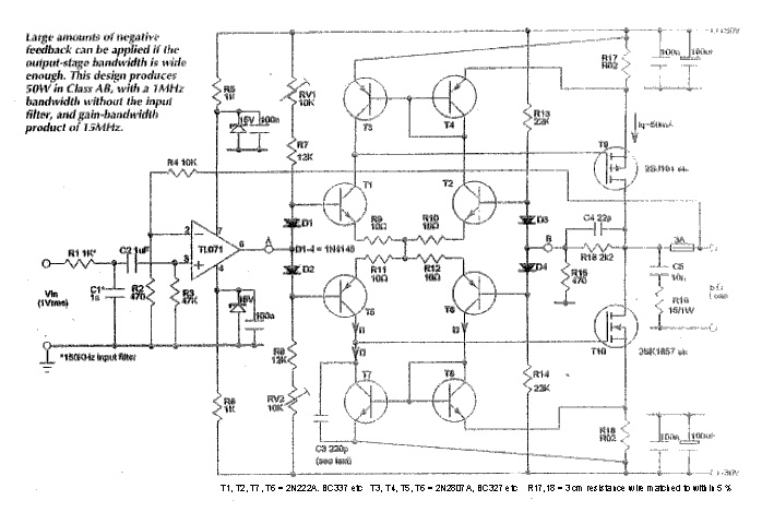

"There are some 7 claims in the patent application covering the bias adjustment, DC offset adjust and thermal compensation."
Hi Greg
I am curious what exactly are your claims:)
The thermal compensation in this circuit looks for me similar.
Regards
Heinz!
  • transconductance-audio-amp-pm23man.pdf
