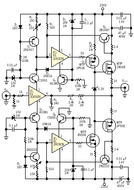

OK let's move on to Ian Hegglun's rather 'acadaemic' looking design. I don't mind the DC operating condition stabilising MOSFET source resistors but this cct drives the MOSFETs frm collector load impedance of the current mirror. Not good. How do they switch off? It really needs an interposed EF stage!
Also look at the input stage biassing - dependant on the differences between Von of a 1N4148 and 2N2222 through 10 ohms to set input stage bias. All you practical people out there correct me if I'm wrong but I don't think this is practicable. :whazzat:
OK, to get the THD down and stabilise for DC drift put it in a second loop with a TL071. Anyone listened to one of these. The input stage in particular. No? Who would want to?
You see the input diff'l is essentially outside the feedback loop and conditions on it only get worse the more you close the loop (more feedback). A much better chip might be OK.
I could go on about high feedback ground currents from the inner loop or clipping behaviour with that chip shooting to +/- 14V into that diff'l stage. But I won't.

TL071 is a really bad choice here.
When the amp clips the TL071 goes into phase reversal and latches to the rail.
This does not sound good.
This basic circuit works better with a slower opamp. Mine sounded much better with a NE5532 driving the CFP output stage (MPSU06/56 and 3055/2955) with about 3mA through the 1N4148 (with 51 ohms in series with each), separate tails on the CFP.
Why not! But also without a driver it will work satisfactorily because the feedback from the source-resistor voltage!
(it works similar to a opamp/bjt currentsource/sink)
You disbelieve: Do a simulation!
OK, not the great "art of electronics" but today you can use cheap arrays and
I will: some "practical people out there" used zeners to clamp always in- and output of opamps. So they don`t go in saturation.
