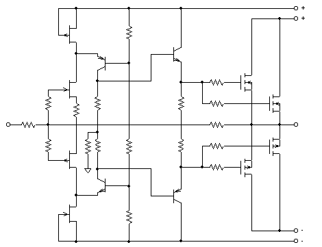

Simple Killer Amp!

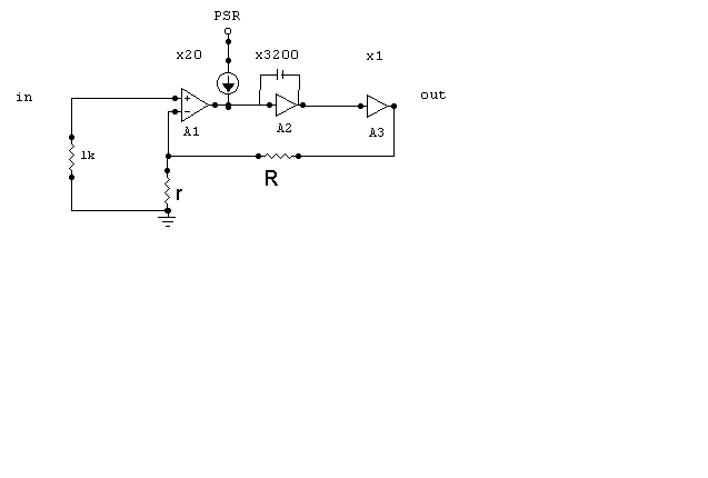

Conventional power amplifiers commonly feature a low voltage gain input differential stage followed by a very high voltage gain stage then usually a unity gain emitter or source follower. This design suffers from a distinct topological deficiency that degrades the sound and is responsible for inferior sound quality.
The typical gain distribution is shown in the thumbnail where the weakness of PSRR of the input stage ( not amplifier) due to the divider with stage output Z vs load Z determines intrusion of Class AB PS artefacts which are magnificently amplified by the very high gain Vas to output, blurring the stereo image detail and spatial info and raising the dependance for performance on the PS quality!
Better sound quality from such a design centres around fiddling at the edges of this flawed topology rather than adopting a new one.
Ignoring the 1K input impedance glitch in the hastily prepared drawing, feedback theory will dictate that this level of intrusion or sensitivity is -
Vs out proportional to A2 x A3/A1 and also to stage load Z/collector Z.
So to reduce this harsh power supply induced output commutation distortion from degrading the sound we need to -
1. Increase A1 without increasing load Z proportionally so CMs are out!
2. decrease A2A3 so the intrusion is amplified less.
So ideally most of the voltage gain should be in the input stage and not in an after injection stage and especially not in a following high gain miller comp stage which degrades load Z as well and results in the typical thumbnail response.

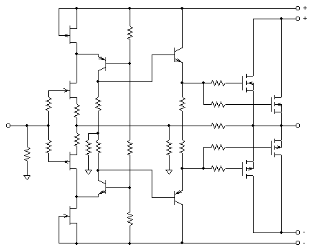

But Greg.....
Your input stage here is still a diff amp!!
The conventional LTP is a voltage in/current out block; a transconductance configuration. It is the current output which normally drives the voltage amplifier. I find myself agreeing with some of your comments, but your block diagram still does not obviate use of a long tail pair.
Hugh
Hi Kuei Yang Wang,
G'day mate.
I disagree with your comment re diff'l amps and find your FET folded cascode impractical to DIY, wasteful of power, requiring multiple supply complexity, ...
Just for some more positive feedback!

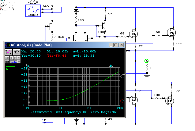

Moving on. From my initial thumbnail pic in post 1, it is fairly obvious that the degradation in PSRR (bode plot) shown in post 2 thumbnail is due to the 3200 x miller C paralleling with the A1 load Z causing the atrocious -30dB at 10KHz. While 2 pole comp instead of the miller C can help, real improvement can be obtained by reducing the gain of the Vas e.g. with R to ground. This intuitively raises the signal level at the injection point relative to the PSR injection. This is probably why the low TIM followers perceive a benefit in loading the Vas.
It becomes fairly obvious that we are just fiddling at the edges of a flawed topology and that the Vas is 50% of the problem.
Greg

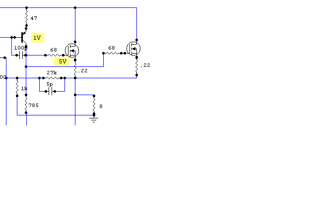

Au contraire Kuei Yang Wang,
I find the dill'l input stage perfectly acceptable but I flexible on your complementary SE inputs (mostly needing a servo and have higher THD) and it's the EF or SF output stage that's the other 50% of the problem!
They, in combo with the Vas, are wasteful of supply voltage , and in a power amp that's power. More heating - larger heatsinks, larger x'former for a given power, higher voltage supply C's . Typicall 5V of output power wasted and more with 4 ohms like sub amps where power is a big issue.
But also it's the drive - they need to be driven full swing as they have no voltage gain. No Vas , how to drive them? Simply and from a low impedance that can pull them off for speed.
Greg

Hi Mikeks,
Every topology has it's shortcomings but the pedestrian conventional diff'l-Vas-EF/SF has more than it's share - and in particular, in an energy efficient world of the future (should've been yesterday!), the waste of 7V in an output stage or a 300VA transformer when only a 150W is needed or 30,000uF when only 15,000uF is needed because of PSRR weakness cannot be entertained. Hopefully the days of the audio snake oil salesmen are nearing an end and good design will out.
I would rather listen to the amp below (as I am now) with PSRR shown as I know I'm listening to the music, not the power supply.
That's 40dB or 100 times better than the prev. example and less expensive to build.
:D :D :D :D :D
greg
